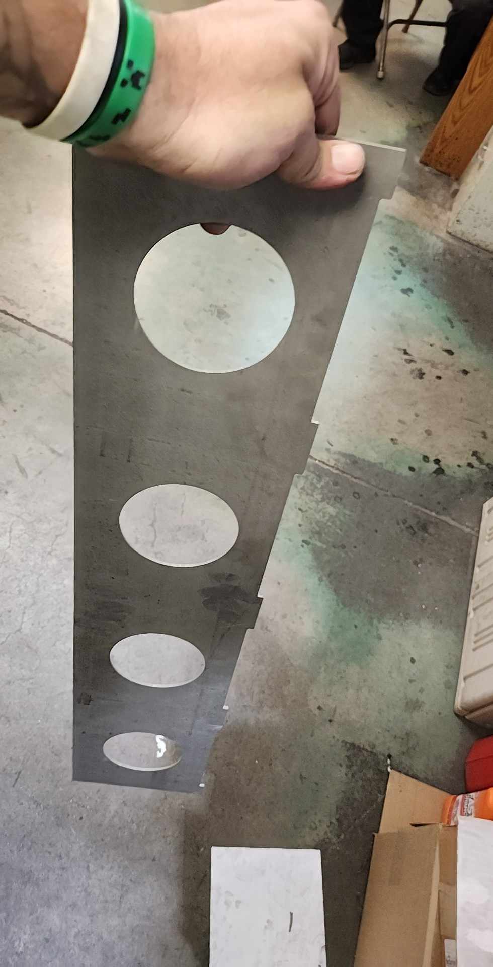

Dry fit was on wednesday - its being welded up as I type this. There are two of the baffles, and there is a 1/8" plate being welded onto where the sender goes so there is threads, tapped to 10-32. Vent and output are AN6 so I can AN6 to barb fitting. He says he put the mounting flange holes too close to the bend on the drivers side so it MIGHT be 1/4" off (will be fixed when I do the tank fitting on the drawing), inlet is a barbed piece of stainless. Should be ready for pickup on Sunday where I will sand it, prime it and bedline it
What volume are you expecting out of that?
I was also told to specify. The baffles are 1/8", and the mounting brackets are also 1/8" while the actual tank part is 14ga. the baffles weld to the bottom in 5 spots, and 3 spots on the sides. so structurally - im going to blow my back out tryna wrestle this thing in by myself

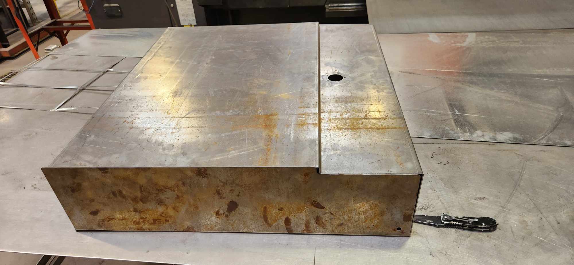

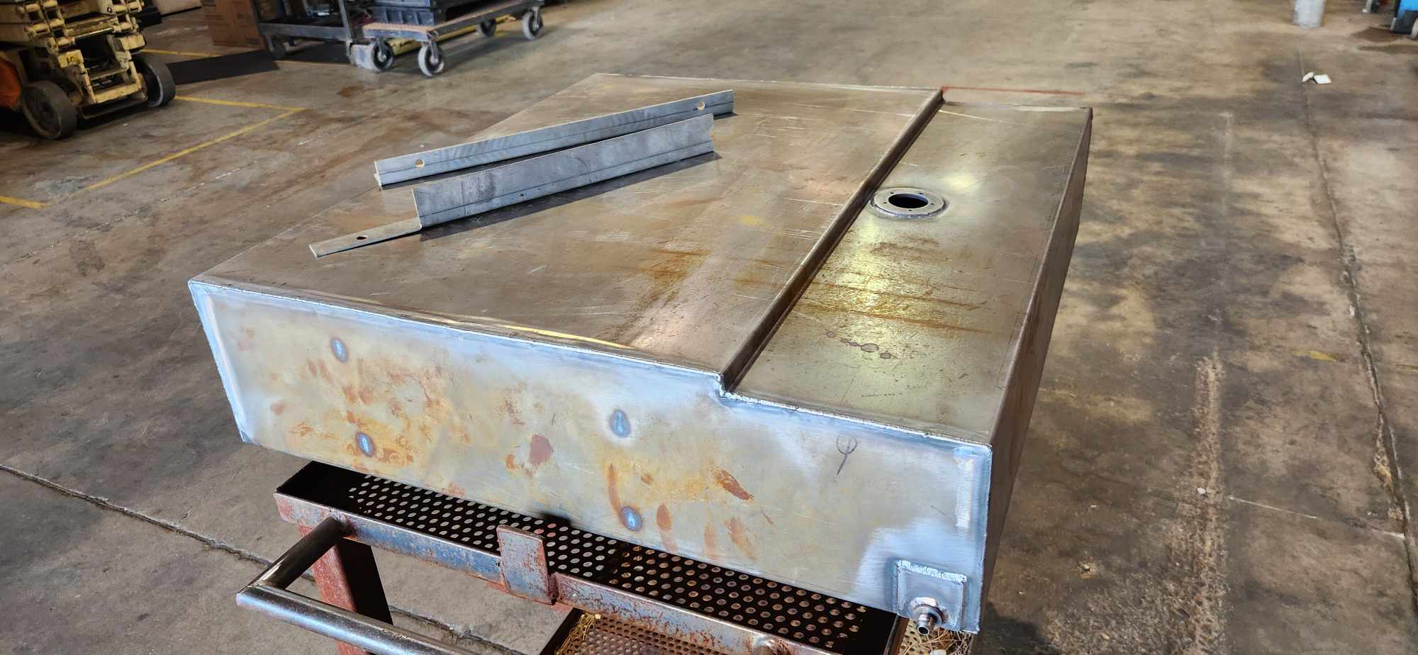

Well he came up this weekend. Tank is amazing. BUT. We had to cut the tow hitch out. To then find out the filler neck is off, so he took it back down the mountain to move it the 4" back, update the drawings, and will be back next weekend where I dont care if I have to weld the damn thing to the roof, im going to have a fuel tank in this and start driving it.
couple pictures of the adventure. Tanks fully tig welded and fits in there so perfect. V2.0 will just be a rectangle though, and smaller in each direction, but deeper to get the same capacity, but much easier to install. Fuel sender flange bolt pattern was also not correct on the internet, so he has the old tank to measure all the junk to make 2.0 better
Any reason beside $ you went with CRS steel???
Being steel I can make repairs to it if need be in the long run, it can take a bonk from rocks off road. I kinda approached it with a list of things I want it to be able to do. One of them being weldable, because I have had the mounting flange on an aluminum tank break off from a flippin RAIN GUTTER when going through an intersection, it was a PITA to have repaired because I am just a lowly MIG wielding peasant. For the inlet he refused to just do a piece of straight tube and said it HAD to be barbed. so its stainless barbed fitting, with 309 filler to weld to the 14ga steel. The AN fittings because then I can adapt it to fuel injection without too much effort and super easy to repair/replace unlike that weird fitting that was on the original tank you apparently need a security clearance to know what the heck it is (1/4" NPSM which you can only order online and its $4.... with 20$ shipping), and I can put a 6AN rollover valve on the top fitting, and then plumb the vent to the neck like the original design does (not that it will do much considering the design of the filler being lower than the maximum fuel level from factory), cost was definitely a factor as well because if I want to be able to offer it to others to save a good chunk of money from that other tank option thats out there, I cant pick something thats not cost friendly, but of course have it be expandable/modifiable by the end user in the event of variations such as the STUPID tow hitch setup on mine that is in the scrap bin now.

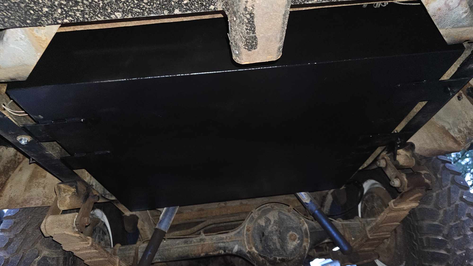

Alright so solution for my tank was to bolt to the lower frame rails until 2.0 is out. Brutus now runs and drives without running out of gas in 20 feet.
