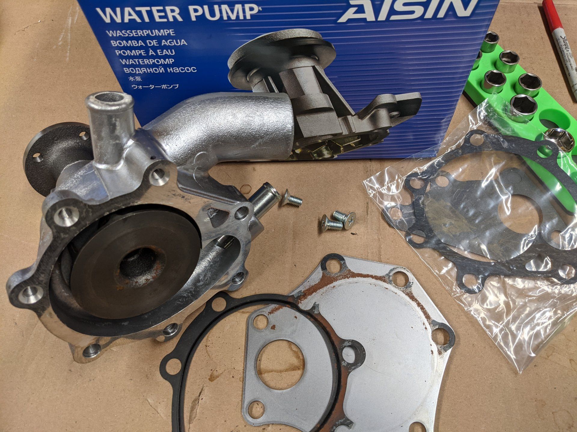

Adding to this thread that I referenced and found very useful since I'm about to install this new water pump and wanted to know where to use FIPG.
Removing the back plate was pretty hard and I was wondering if perhaps the gasket came pre sealed but....no. Glad I opened it up and that it came with an extra gasket, don't think it was going to seal very well for long as it came already rusting under the gasket.

What’s the Aisin part number of that one?
