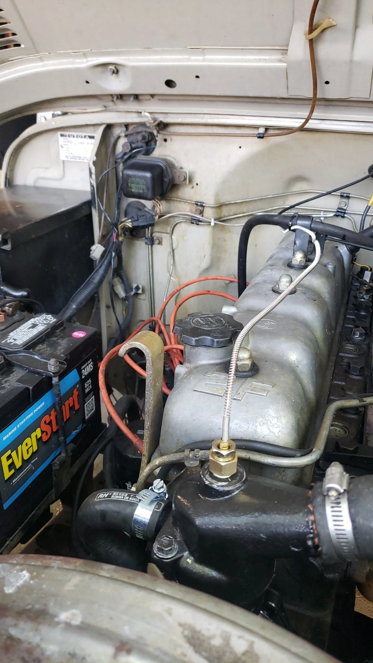

Sorry it's been awhile, no, it is not overheating anymore. I did run a secondary thermostat in the top hose which began to leak the other day so I removed it and replaced it with a silicone top hose. No issues now. By having that secondary thermostat giving me an actual digital readout of the temperature that helped me know if I was really overheating and not. I don't think I was really overheating. If I was it was only because there was air in the system and it just took a couple weeks to get it all out. Once I got it out there was issues with my gauge so I had to fix it. I wanted up restoring my whole gauge cluster painting and everything
2nd tstat?
I installed a temp gauge to make sure. Super easy.
