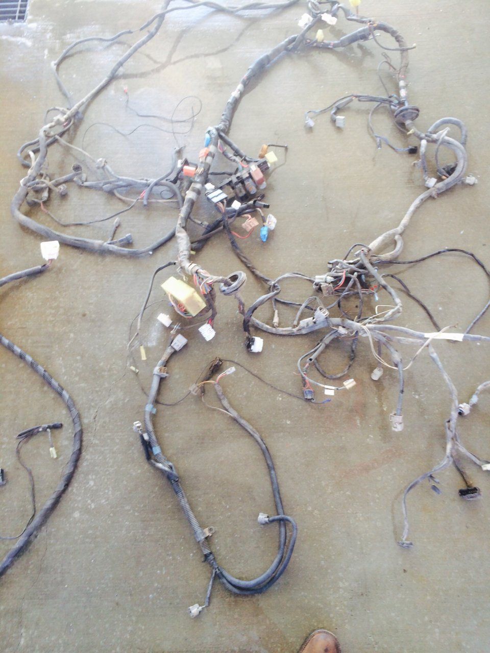

Dirty harness
Not as dirty harness
Appears the PO was fairly good at hacking into the harness, which kinda sucks hunting when hunting for the obvious.
Now hunting FZJ7X schematic.

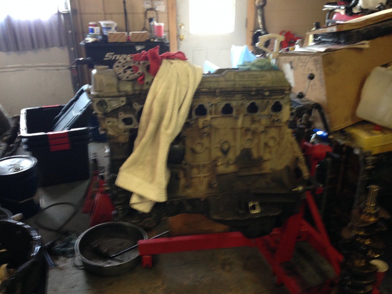

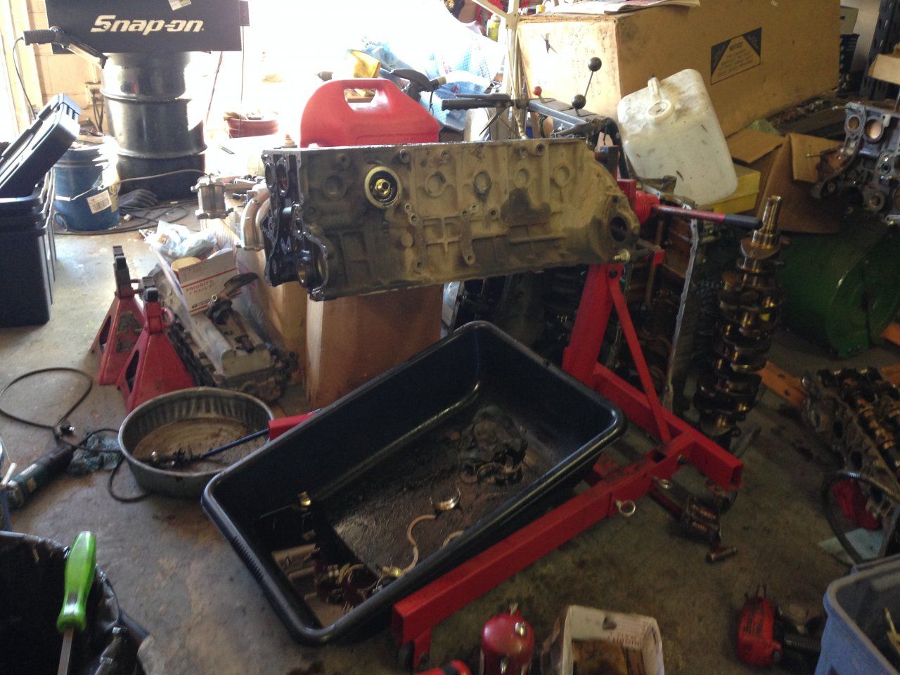

Rebuilt 1FZ-FE long block (OBD1)
