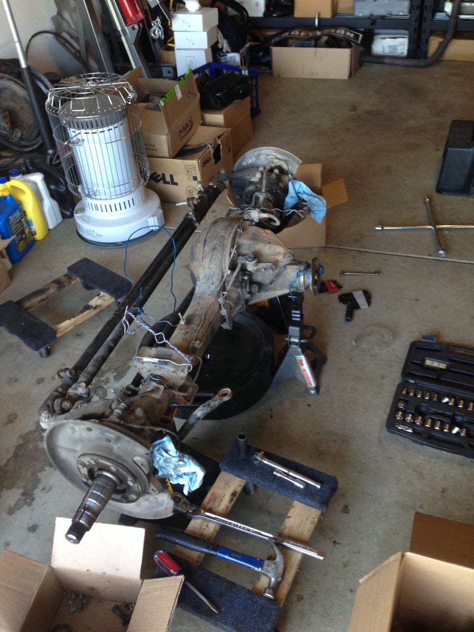

Does anyone know if the shift fork rides on the same splined area of a rear cable locked diff shaft, as it would on an elocked shaft?
Reason I ask.
My uber 80 axles have the splines machined down in that area, to aid in extraction in the event of a twist or snapped shaft, and trying to determine viability before sending axles off to be built.
