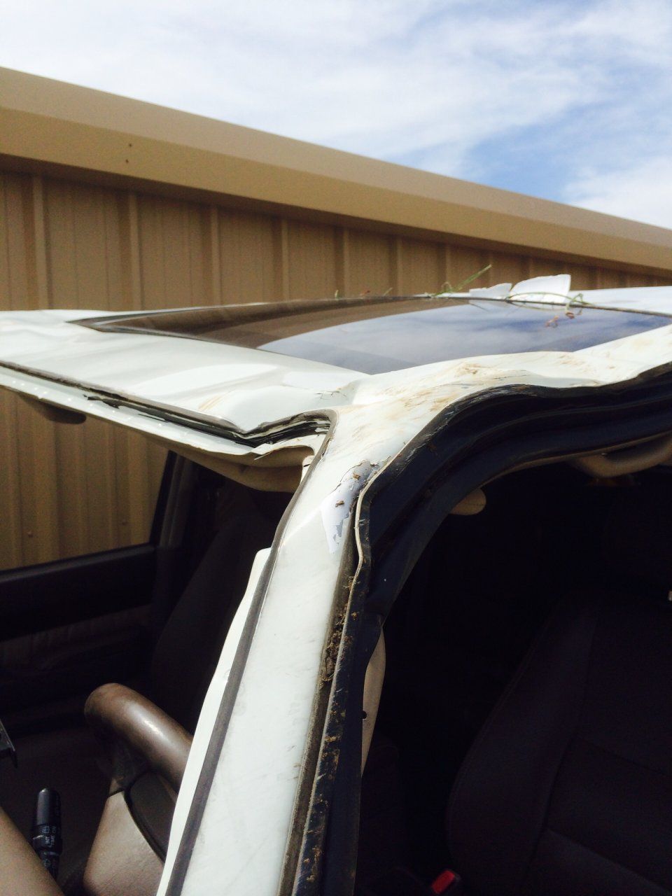

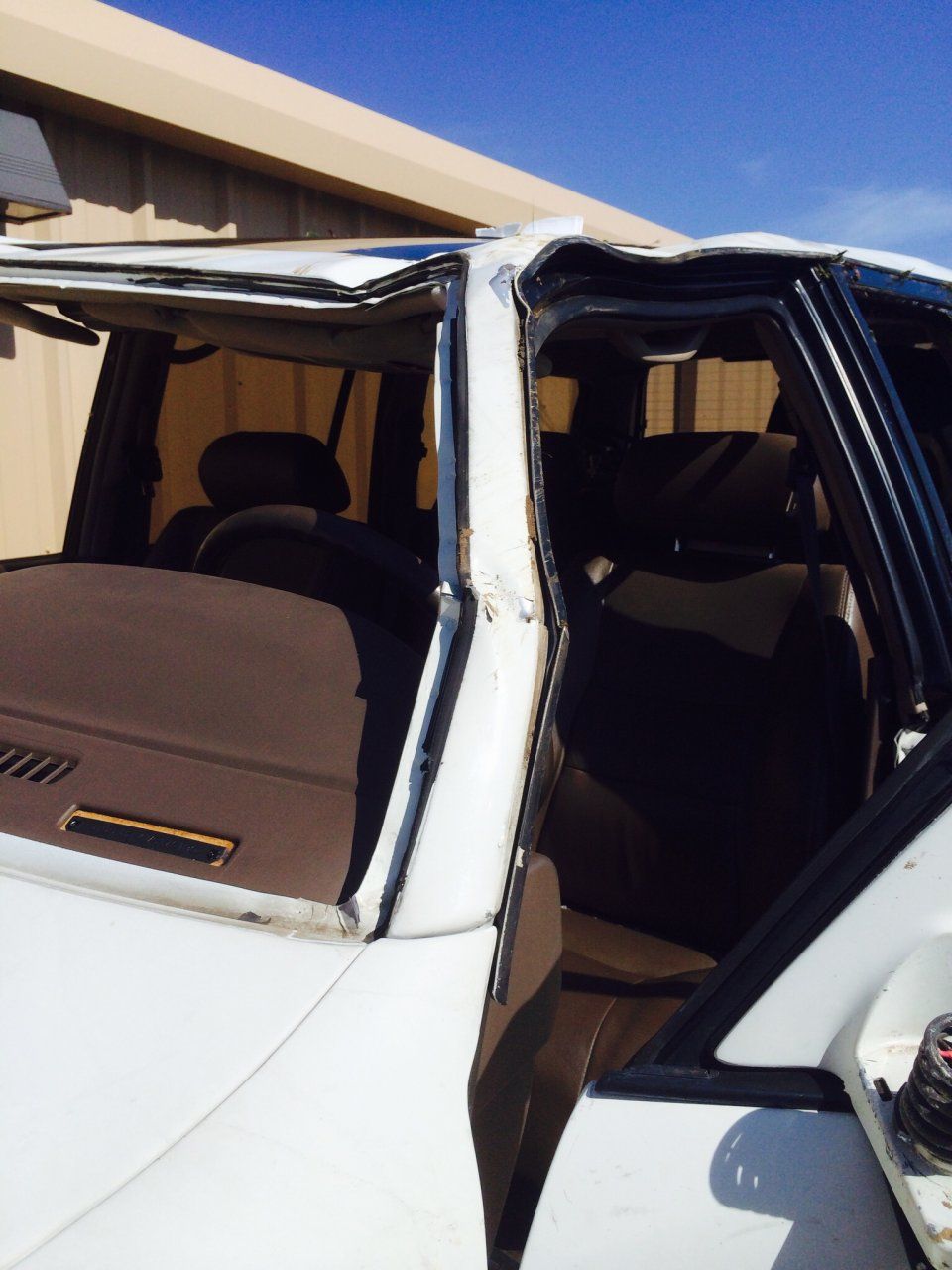

Too many dents in the 80, huh?
I did try to buff them out....

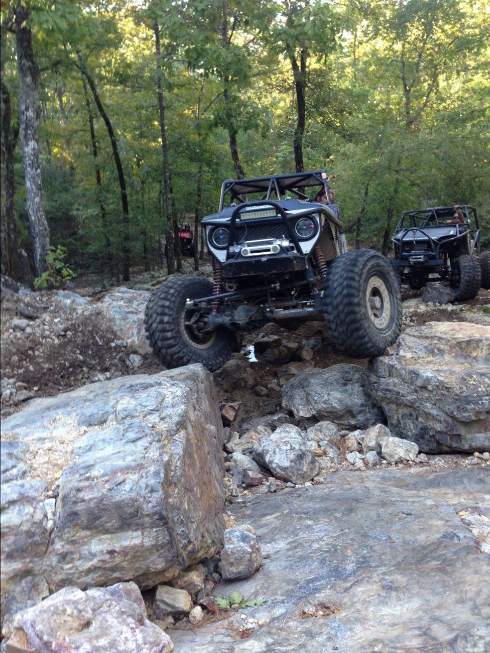

As for running with Georg, I couldn't even keep up with his son (Garrett is the one without the hat below).
Guess the flip down windshield is a bigger benefit if one has flowing locks of hair?
