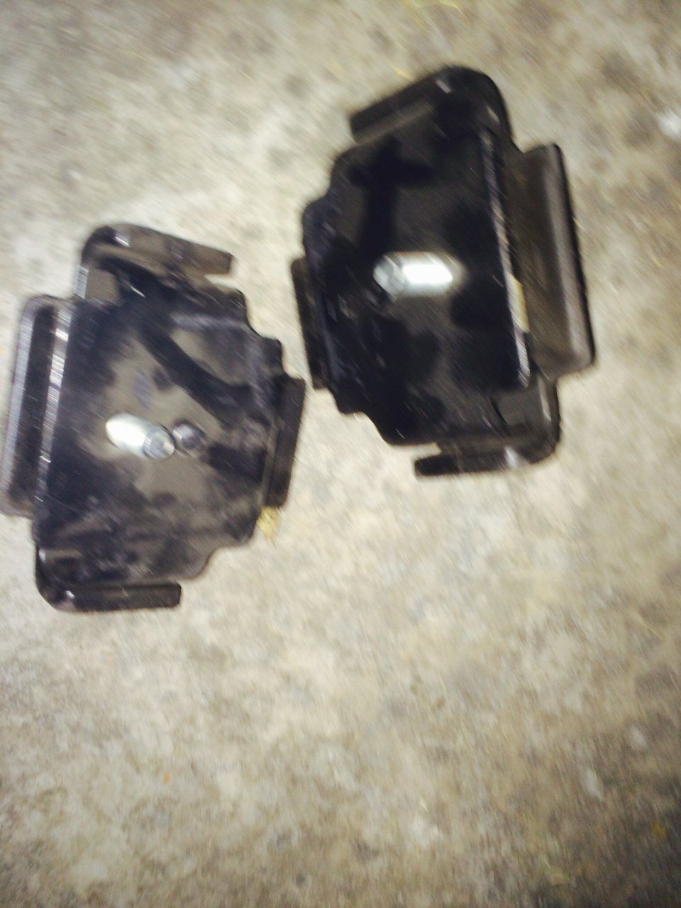

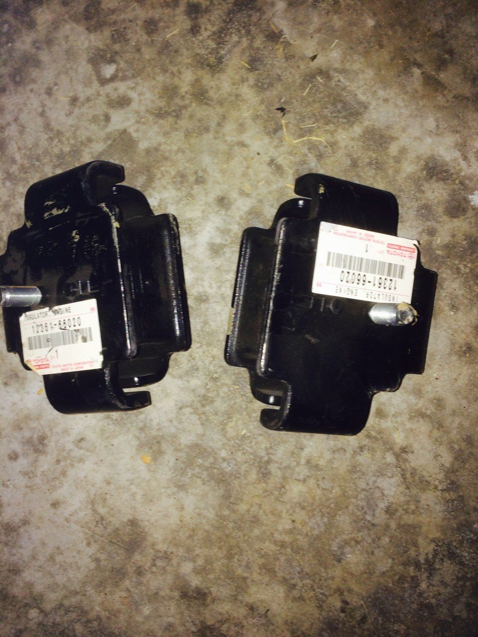

Been a thousand times easier, from a procurement perspective, to have, first gained the knowledge of driveline orientation, then utilized 80 series mounts and brackets, if not fabbed, to achieve, but, after a long trip from UAE and molestation by Customs.
View attachment 956435 View attachment 956436

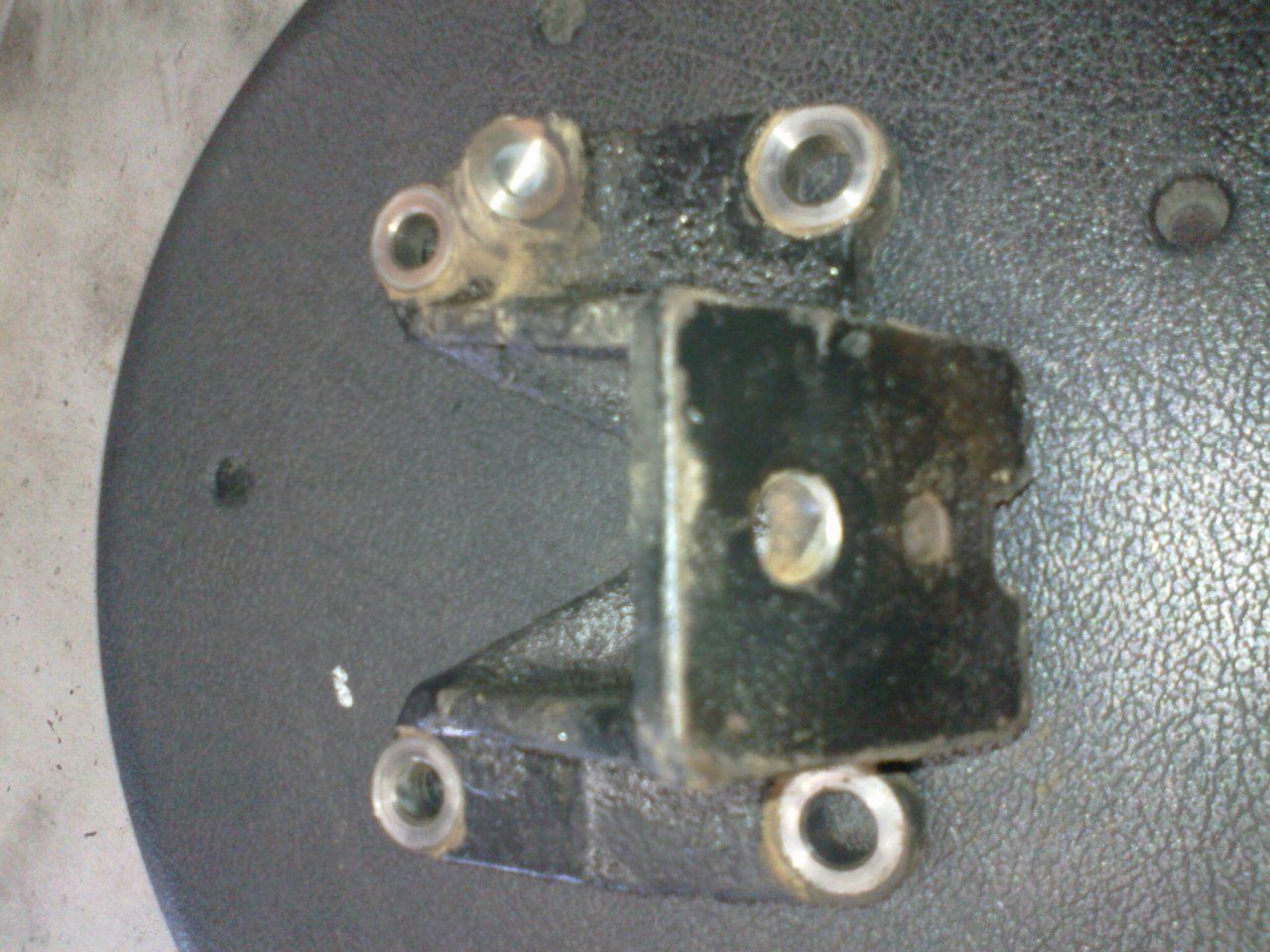

Found the single NLA engine bracket that was posing a problem, from an FZJ75 in Oz....along with a few other bits, but later on those.
Balance ordered from @Akella.
After all of this, don't think the cross member will remain much after the initial goal of getting the 1FZ in and running is achieved.

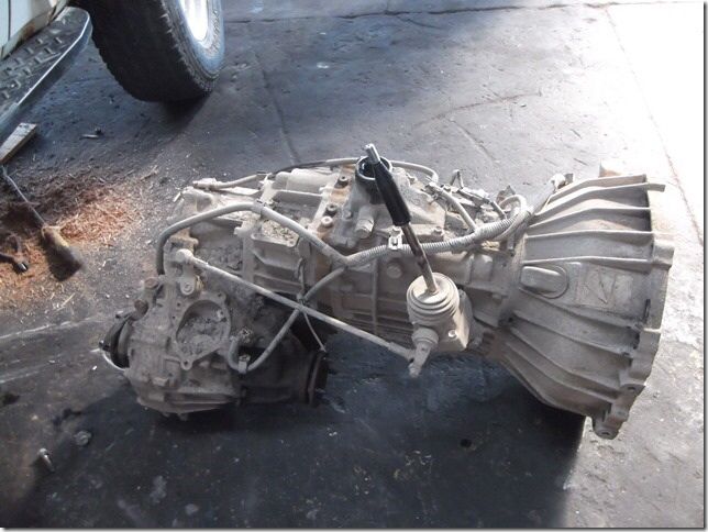

Previous gear calculations were incorrect, but still not 100% clear on which MT better suits this "build" :rolleyes:
37s/5.29s
H151F-1st 4.081:1
HF1A L - 2.488:1
Crawl Ratio - 53.88:1
H150F- 4.529:1
HF1A- 2.488:1
Crawl Ratio- 59.61:1
H151F/HF1A
Final Ratio 2/4H
1st-21.59:1
2nd-12.14:1
3rd-7.89:1
4th-5.29:1
5th-4.7:1
Calculated RPMs at 75mph 3,175
H150F/HF1A
Final ratio
1st- 23.96:1
2nd- 13.03:1
3rd- 7.88:1
4th- 5.29:1
5th- 4.29:1
Calculated RPMs at 75mph 2,922
Not concerned about the high RPMs, since the 1FZ can hang all day at either. Hopefully inches of deadener inside and out can lessen the drone.
With the lower 1st and taller 5th, the H150F appears the clear cut winner, but, as all are aware, blissfully ignorant, so throwing it up for opinions on which bodes better.
