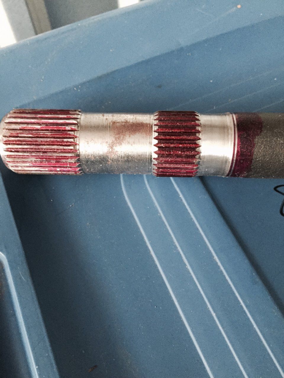

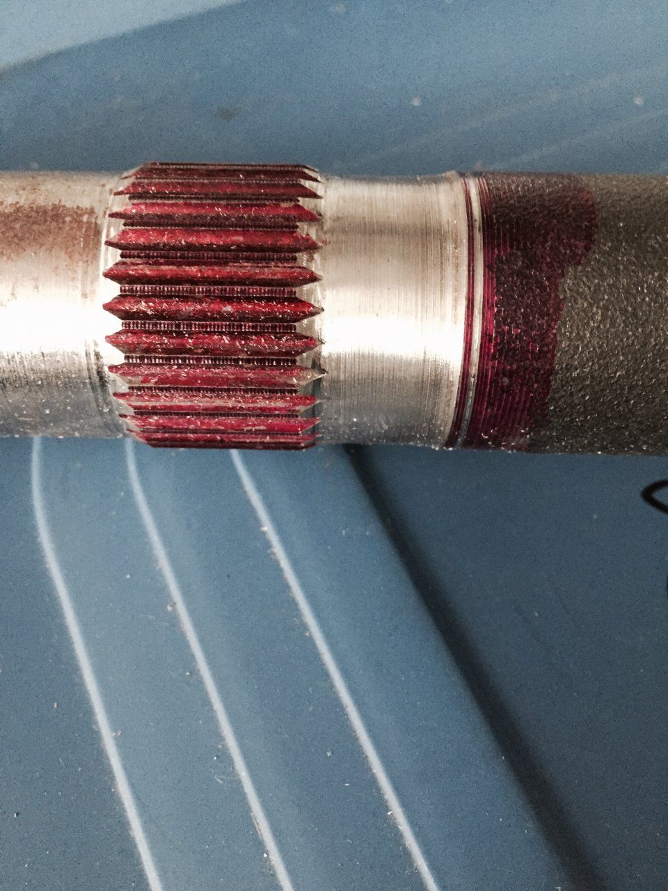

Yes, same principle of the elocked axles but cable actuated. The same side and all. The shift fork and collar ride on the same side as the rear 80 series elocked. I would assume the same mods that apply to the rear elocker can be transferred/applied to the 9.5" cable locker.
The long splined shaft is the right side on the rear axle (shorter one) and left one on the front axle (longer one) as you will have both 9.5" cable locked thirds on this 73 .
Now, a question for the experts, would machining down the splines would make the axle shaft weaker?....I have no clue, hence the question.
Assumed the same, but have been known to err on issues that I knew, for fact. Ha.
Would machining down the splines would make the axle shaft weaker?....I have no clue, hence the question.
The debate abounded on the 80 board, as usual, :rolleyes: but feel the theory sound, as a means of extraction, without any negative effect on axle strength, since the spline are extruded from the axle shaft, so removal of doesn't lessen the shaft diameter.
I've two that were new, (larger than OE 80s) splines removed in the same manner, then cryo'd, that I'd intended for the 73 axles (one spare....just in case.)

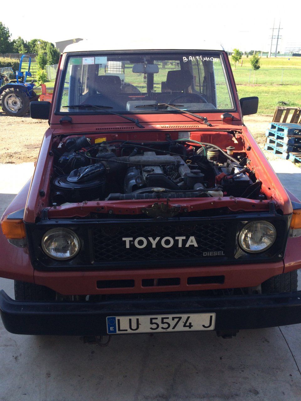

Time of death 12:08.....

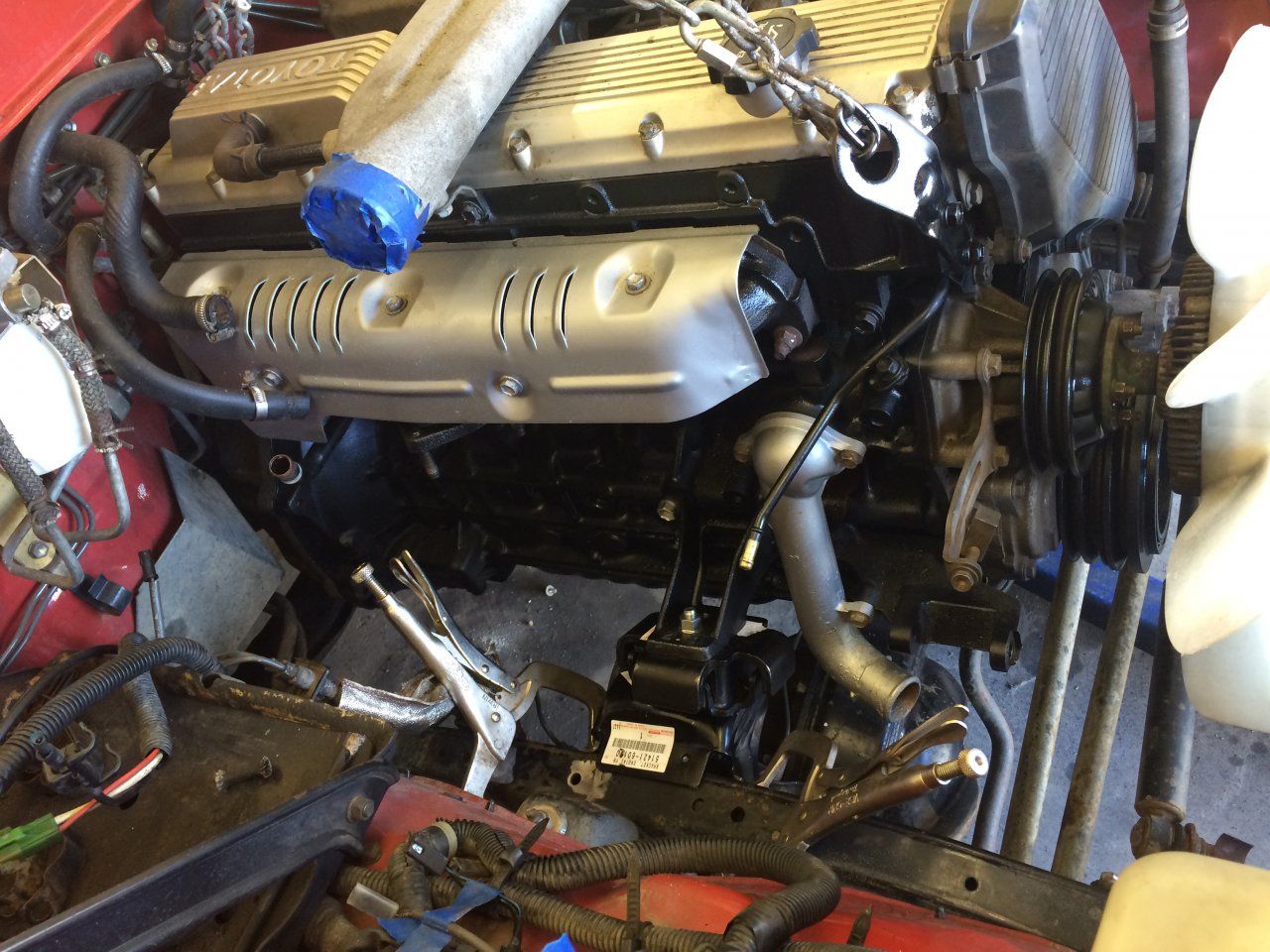

Hadn't had out in sometime, but decided a good day to degrease in preparation for surgery.
Ran good....well, as good as 4 of 5 cylinders can, so pushed my luck and headed cross town to pick up a few parts at a local shop of known Cruiser affiliation.
Luck ran out, so going home, after the tow and crawling back into bed.

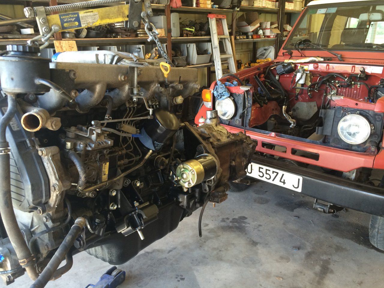

I don't think anything will ever get the engine running again, but it was her swan song run as a VM'd 73, anyway. Apart from the tow bill and the wasted time, I'm not too disappointed, knowing full well her days were numbered.
Surgical arrangements have been made for her transplant from a slightly different donor than previously mentioned in thread.
Don't want to jinx it, so keeping a lid on the variant, but it'll remain Cruiser powered. :)

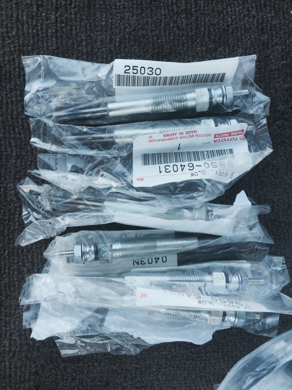

Not much more to add, at this time, except the arrival of these new fangled spark plugs that are supposedly good for an additional 6MPGs.
Hunting a plug adapter, dizzy, and new plug wires, now.
