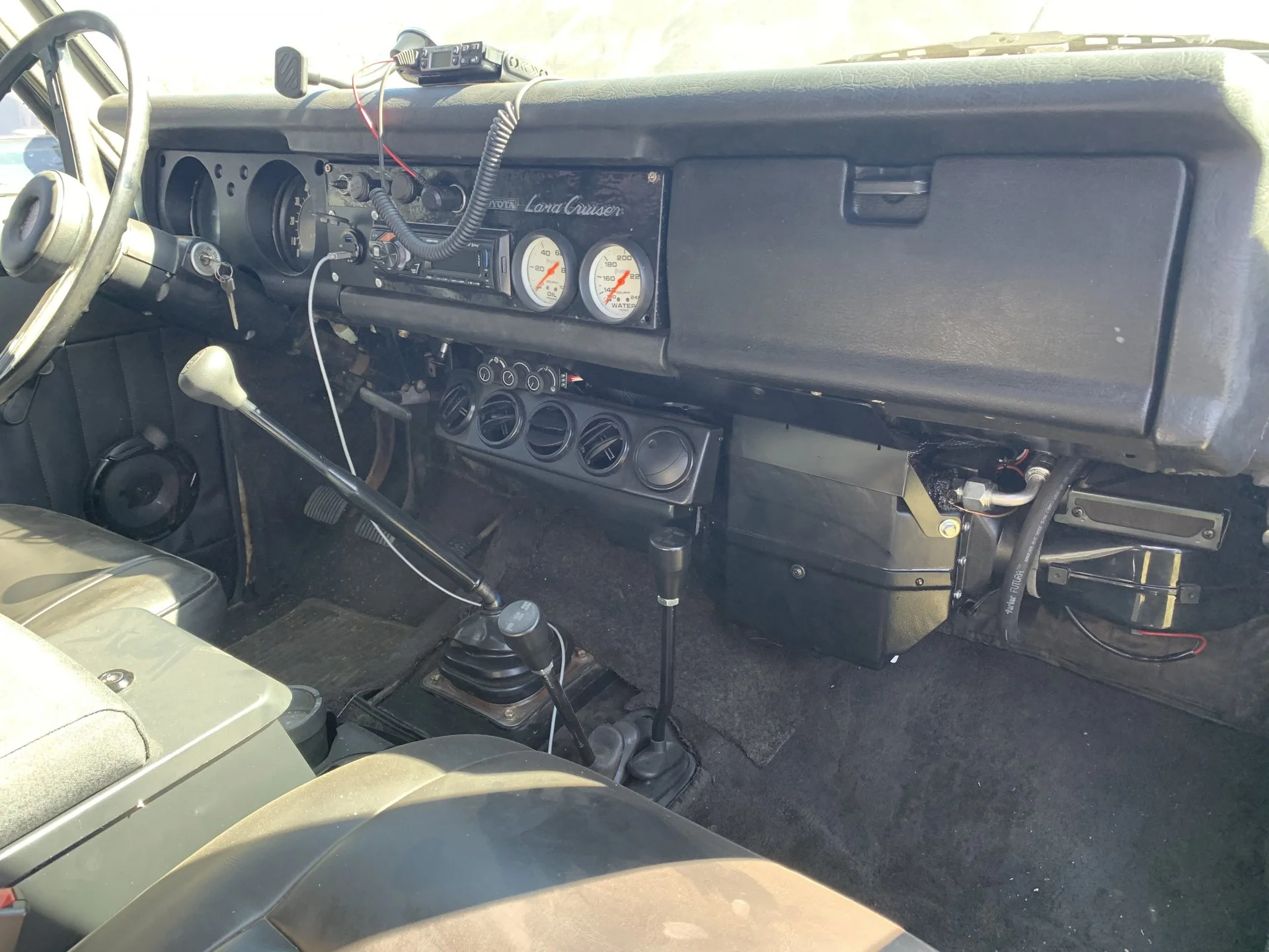

Here's what a few of us are running....
I'm guessing you have details about your install with these systems on your build thread. I'll see what I can find there.

I installed the Classic Auto Air custom cooler IV system. My thread walks through the install around post #575.
