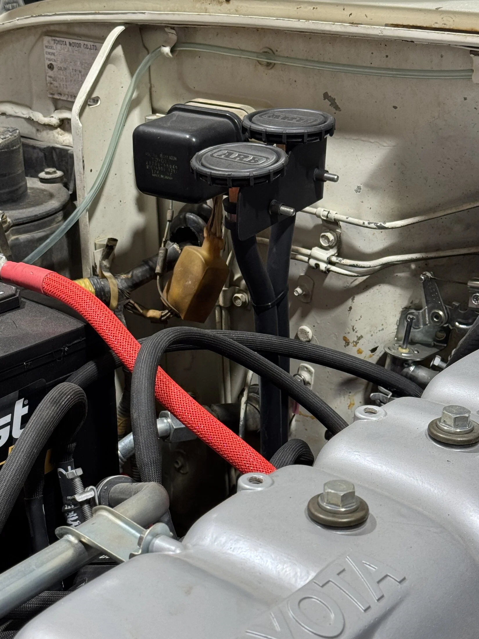

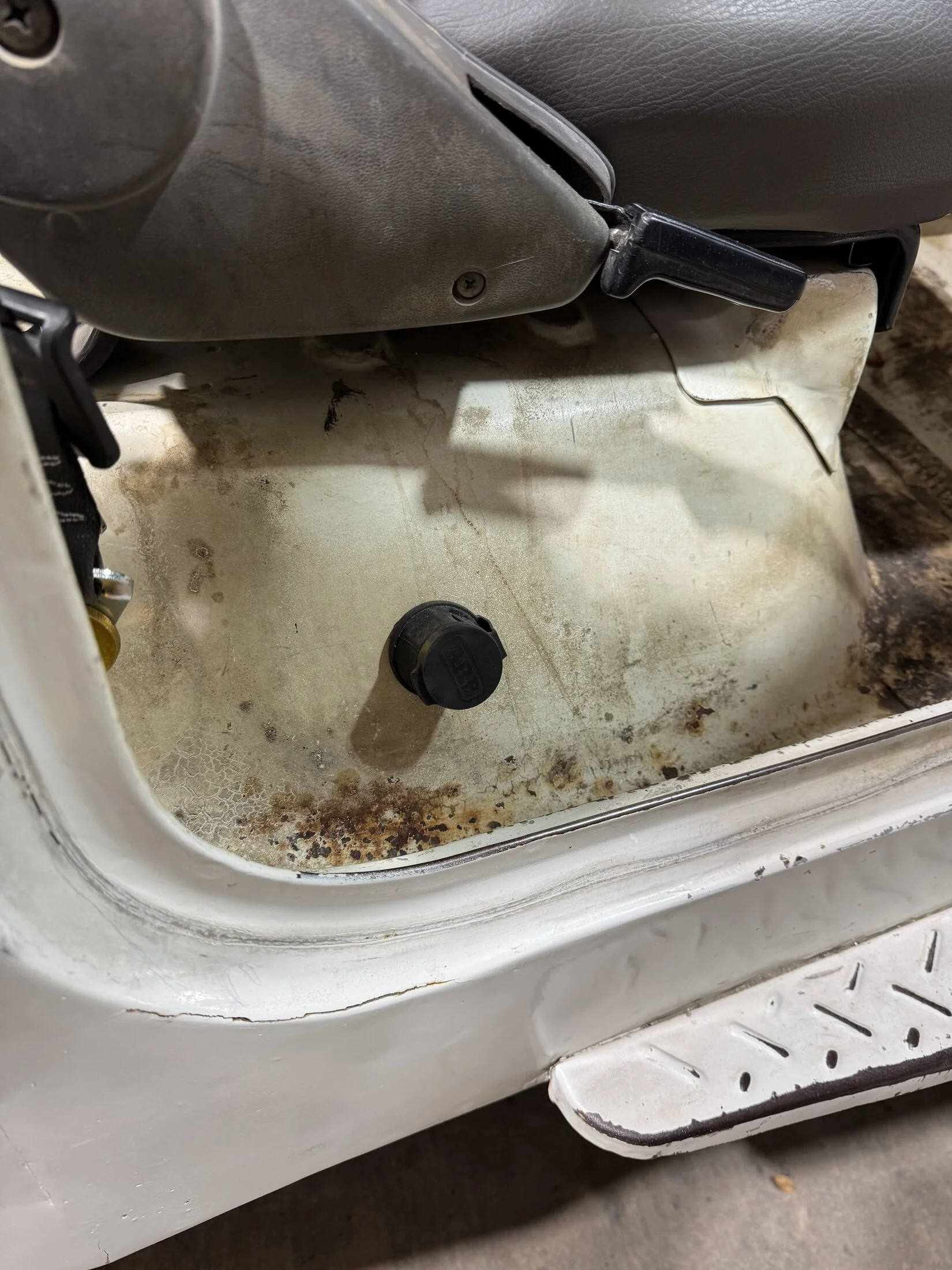

Diff breathers

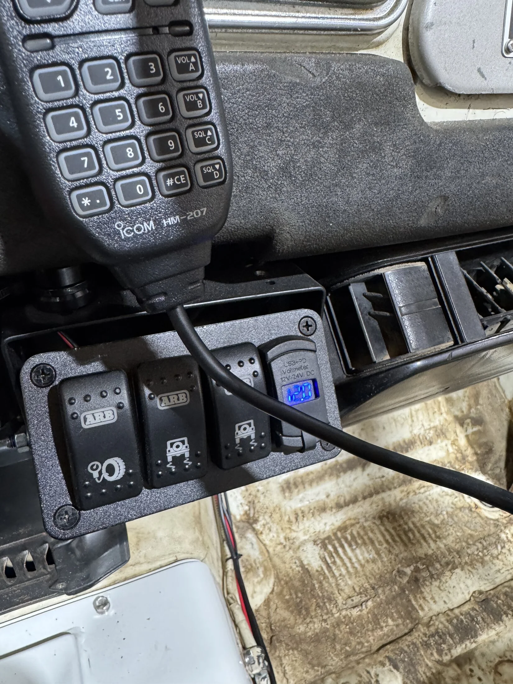

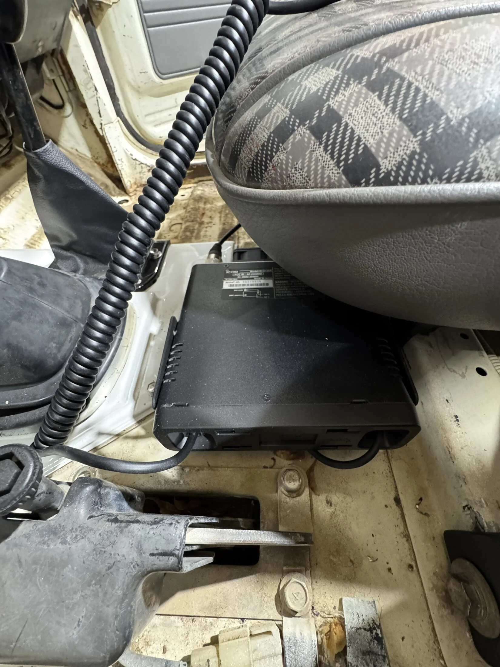

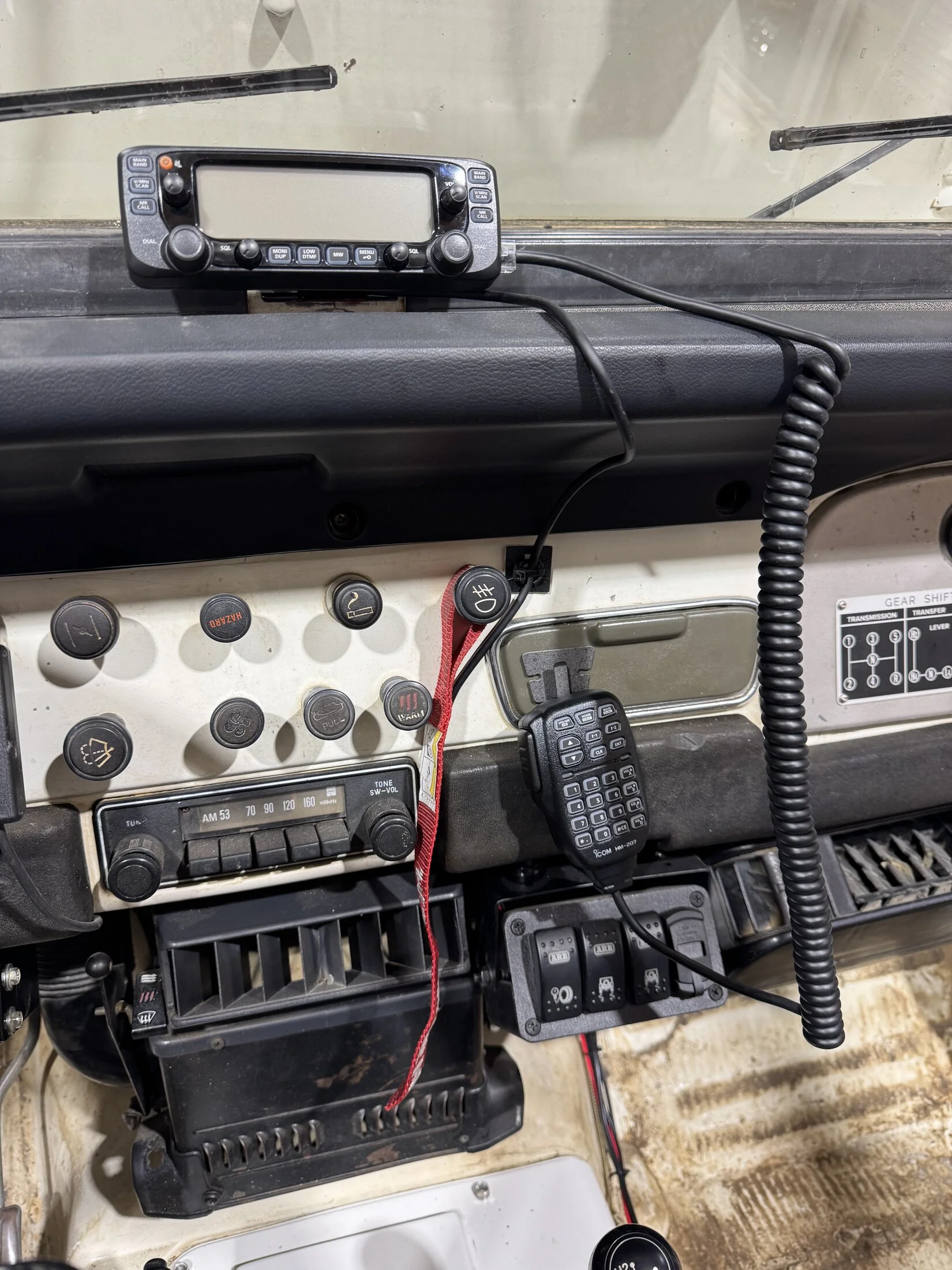

Some kind of ham radio with a remote head
This panel has the ARB stuff plus a 12v for a phone

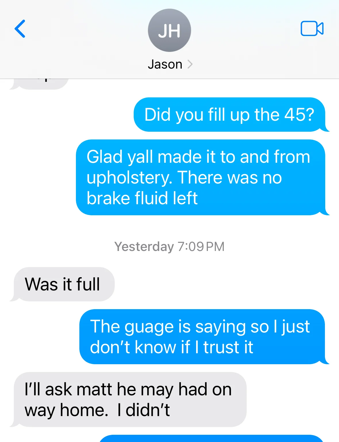

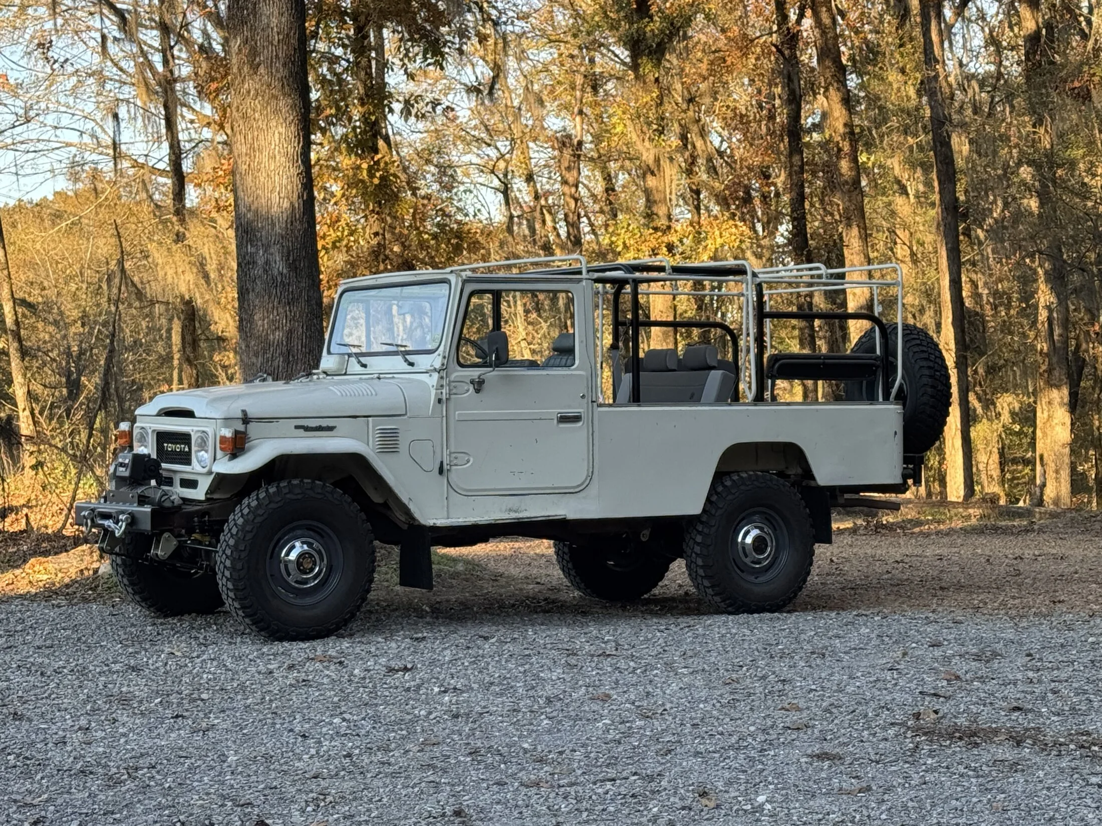

One thing was it had a leak in the front brake line that did not drip unless you used the brakes.
Seems the 30 kilometers they drove it to and from the top place has it all gone. I saw the empty cylinder and figured out the issue.
I had to make that right and a couple of other things before I took it for a spin.
But first…..I noticed the guage was showing full. I thought I remembered I had only put 4 gallons in for startup and my short test drive
I thought I remembered the guage working the I added the new cluster so I figured he filled it up.
I made it about 4 miles and ran it out of gas. Has to ride the strap home behind a Jeep
Looking great in her out of gas stage
Added 5 gallons and hit the road again
Buzzes right along.

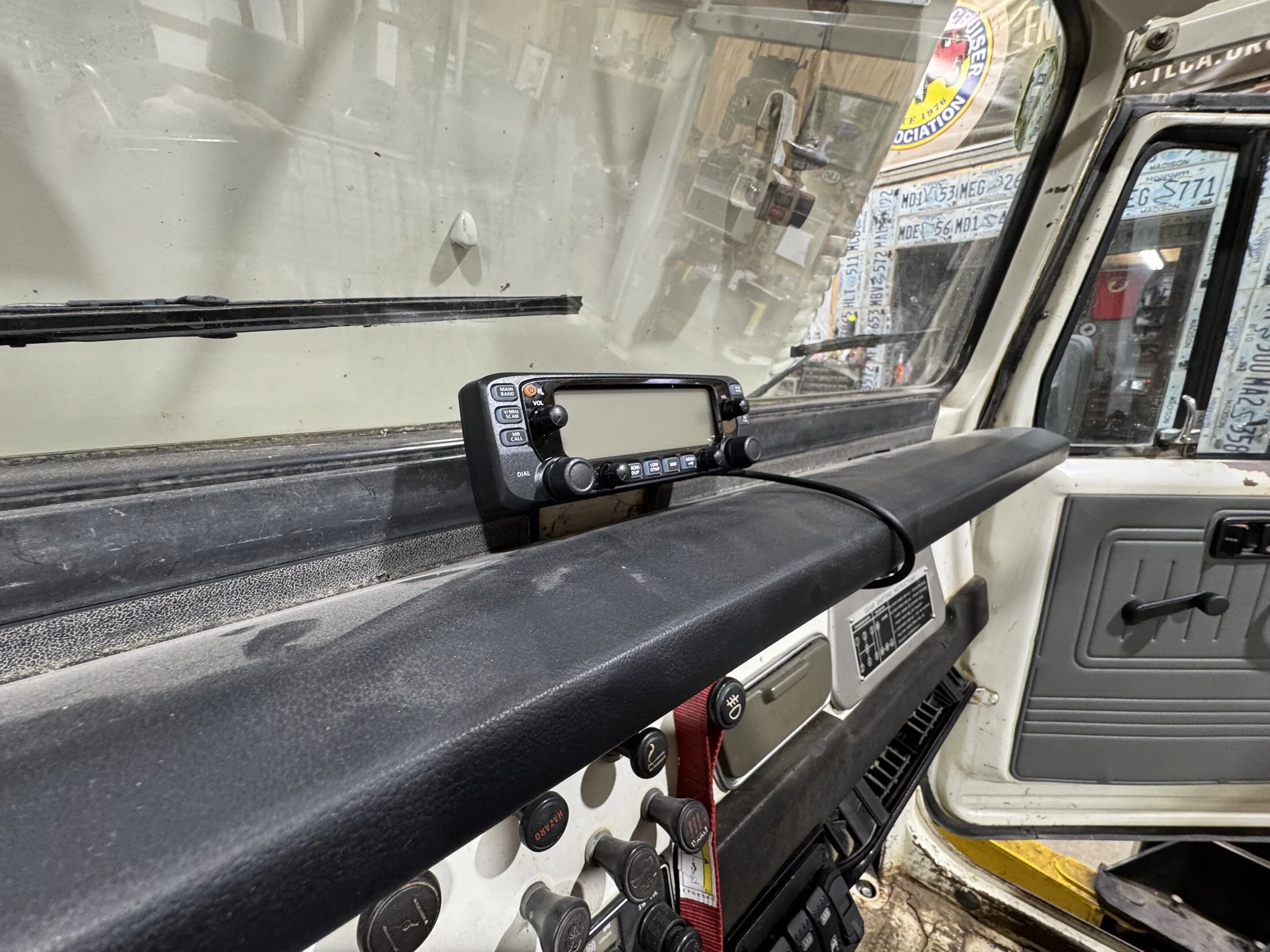

Amazing. Hey @wngrog how did you mount the radio above the dash pad?
A little bracket to the windshield frame. I’ll get you a pic

Diff breathers

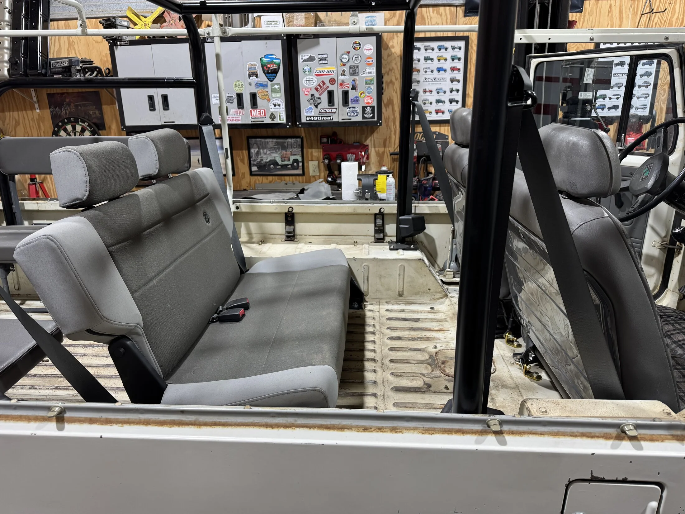

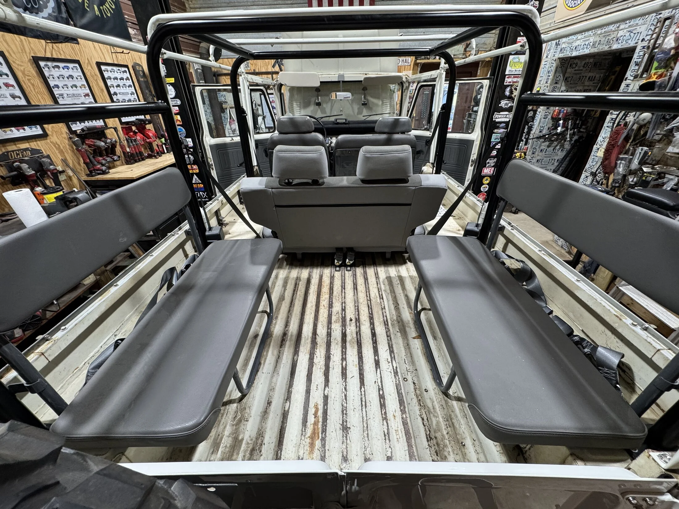

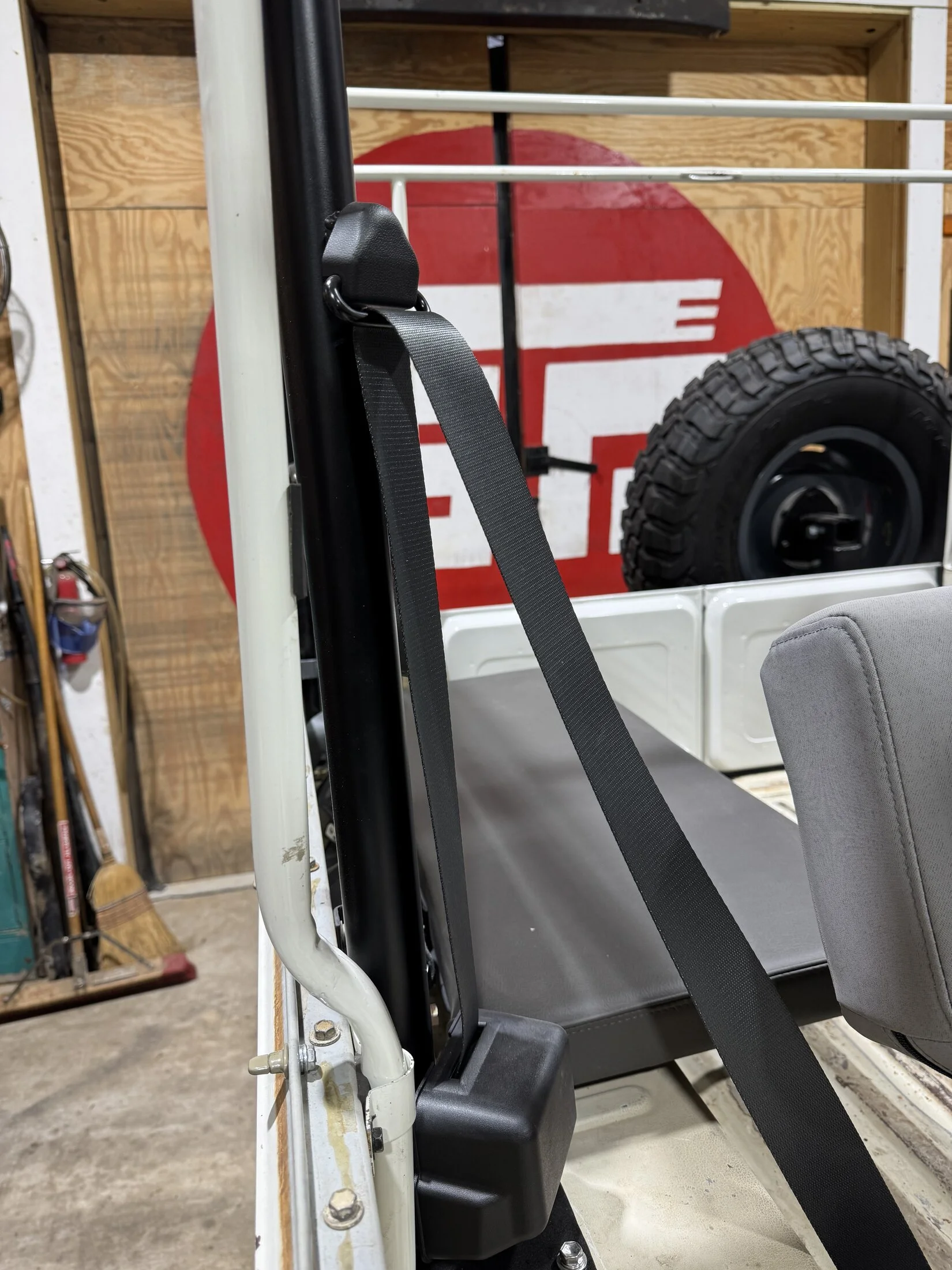

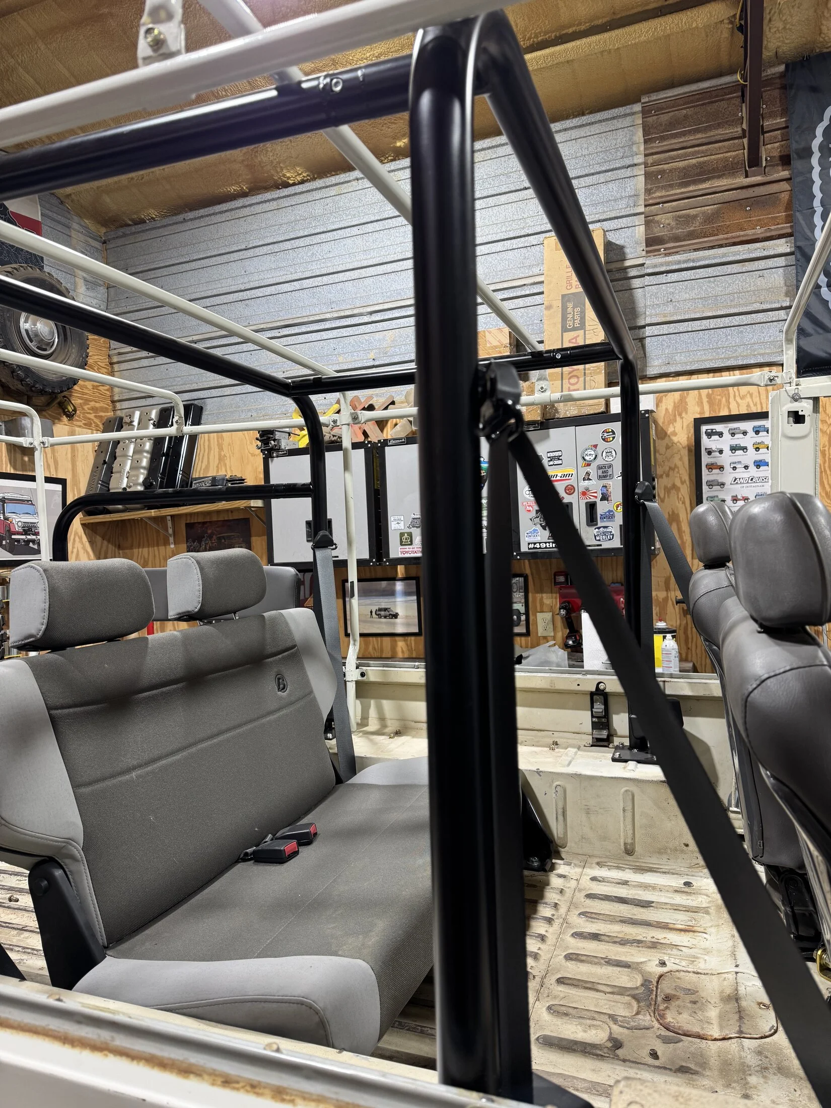

BeStop flip and fold seat with Seatbelt Planet belts all around to a custom cage
Still has a set of rear jump seats as well
View attachment 3784475View attachment 3784476View attachment 3784477

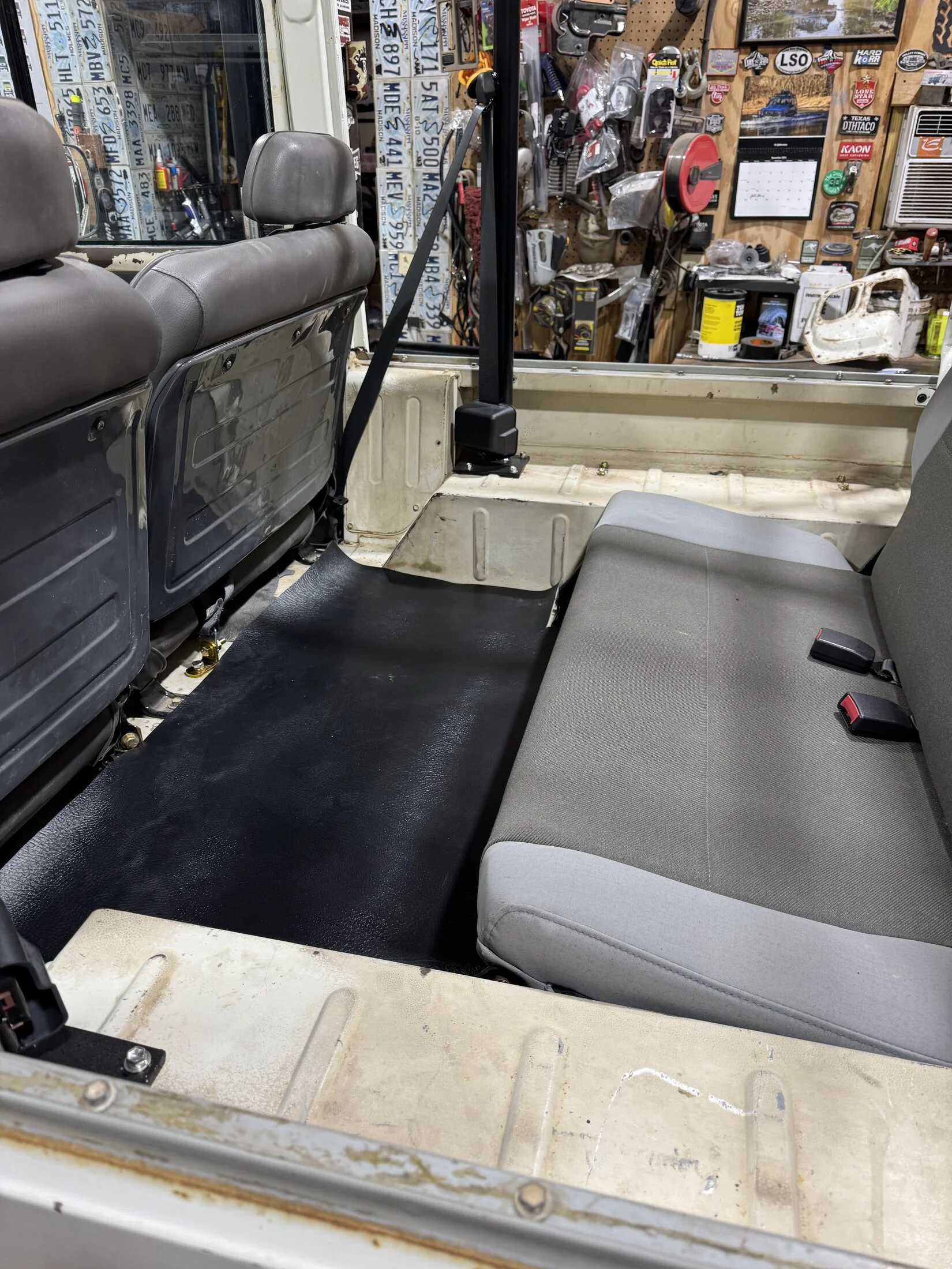

Does this set of rear jump seats come from a 70-Series Troopy?
Awesome jobe done, enjoying following along!
They are just 1/2 of the ones that came with it. We cut the long back piece in 1/2

The oil drain plug was leaking so I had to drain the 20/50 and I reinstalled a new OEM plug and gasket. Added a little Locktite 567 to the threads. Refilled with the same oil. It only had
About 40 miles on it. No crap came out. It was nice and clean.
I had to rebleed the brakes because of the leak fix I did Monday.

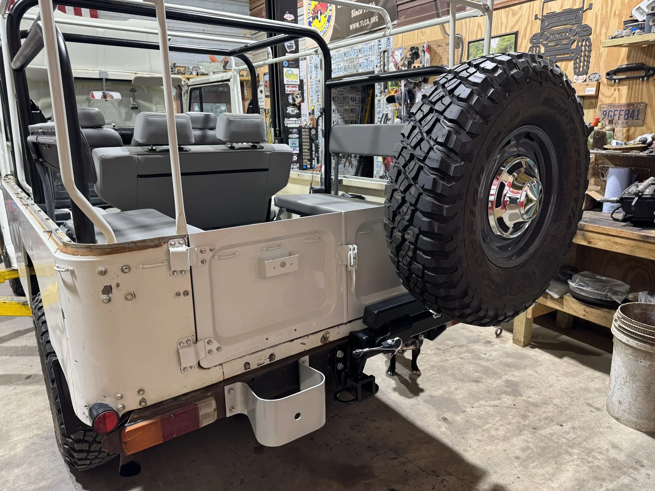

I also added a passenger side tire carrier so the early style 1/2 door will open without having to swing out the spare. The tag bracket is at PowderKeg
Added a set of SMG stainless door pins

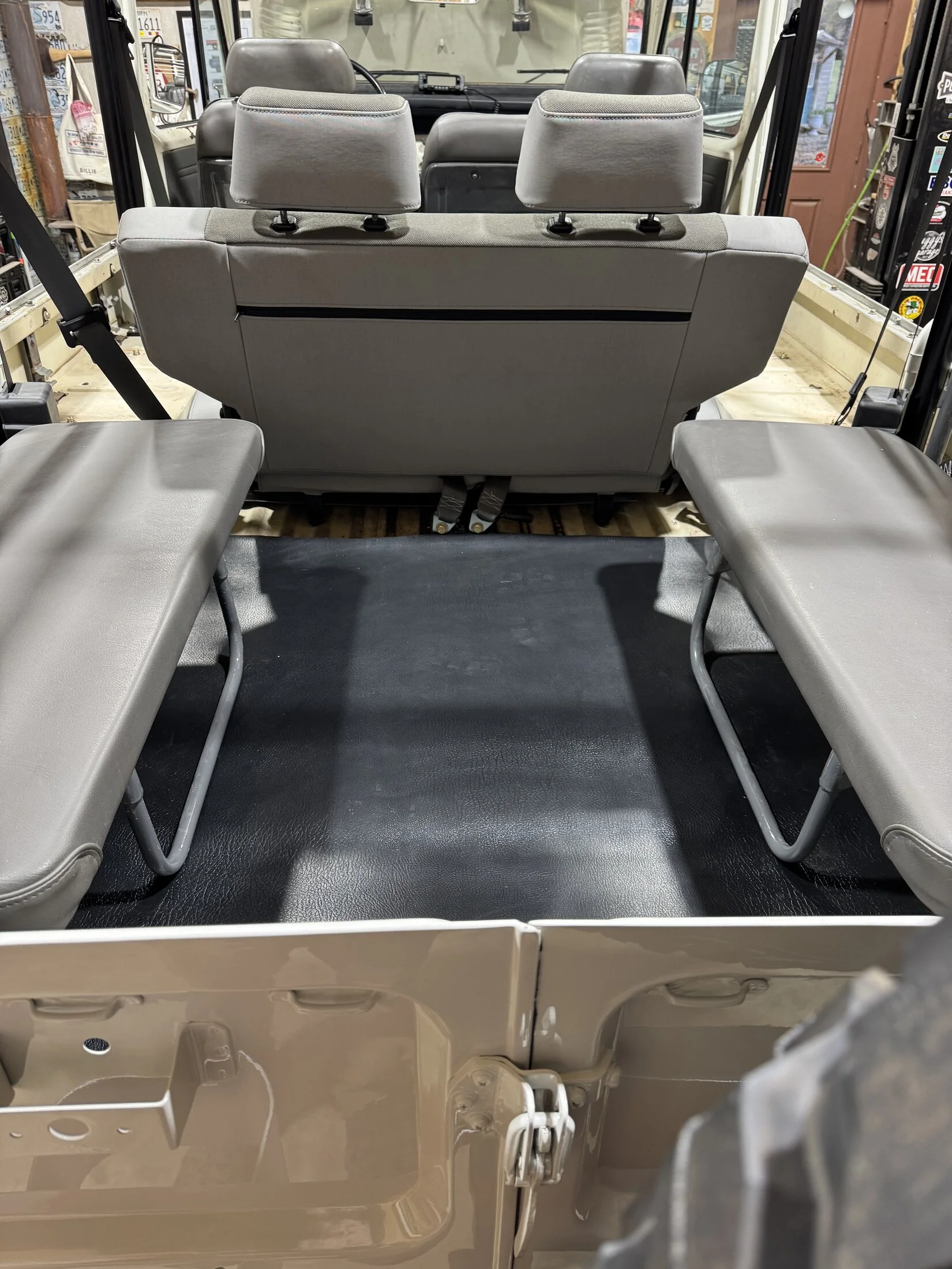

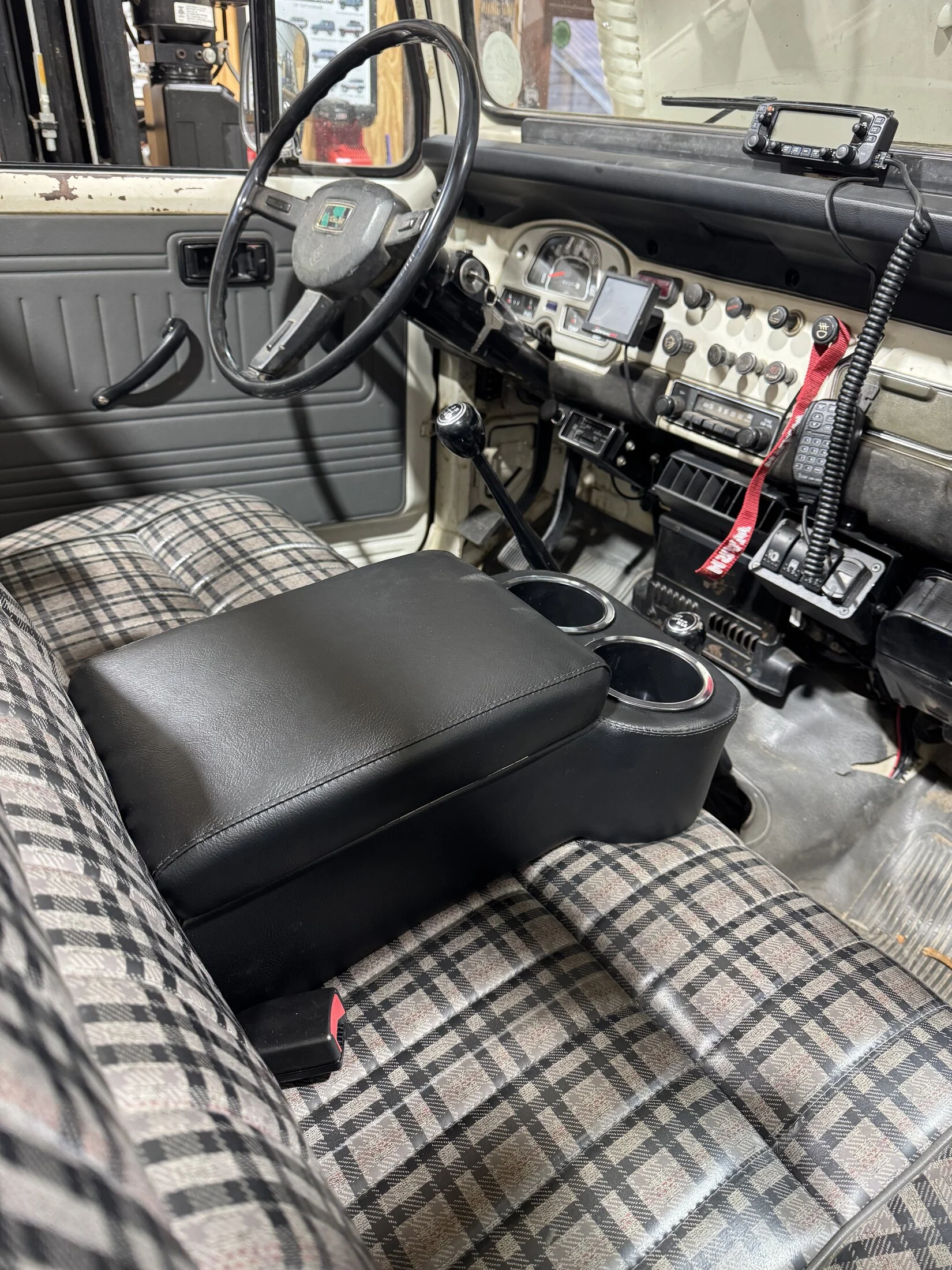

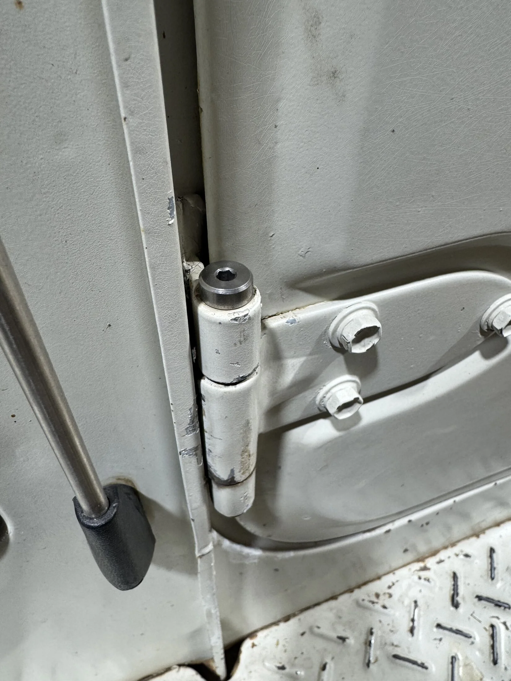

Added a cool console/cupholder I got via Holley … bought myself 3 of these for all my bench seat trucks.
Carved up a City Racer floor mat to fit the new seat setup
Lots of small things going on. It’s too cold to drive it.
