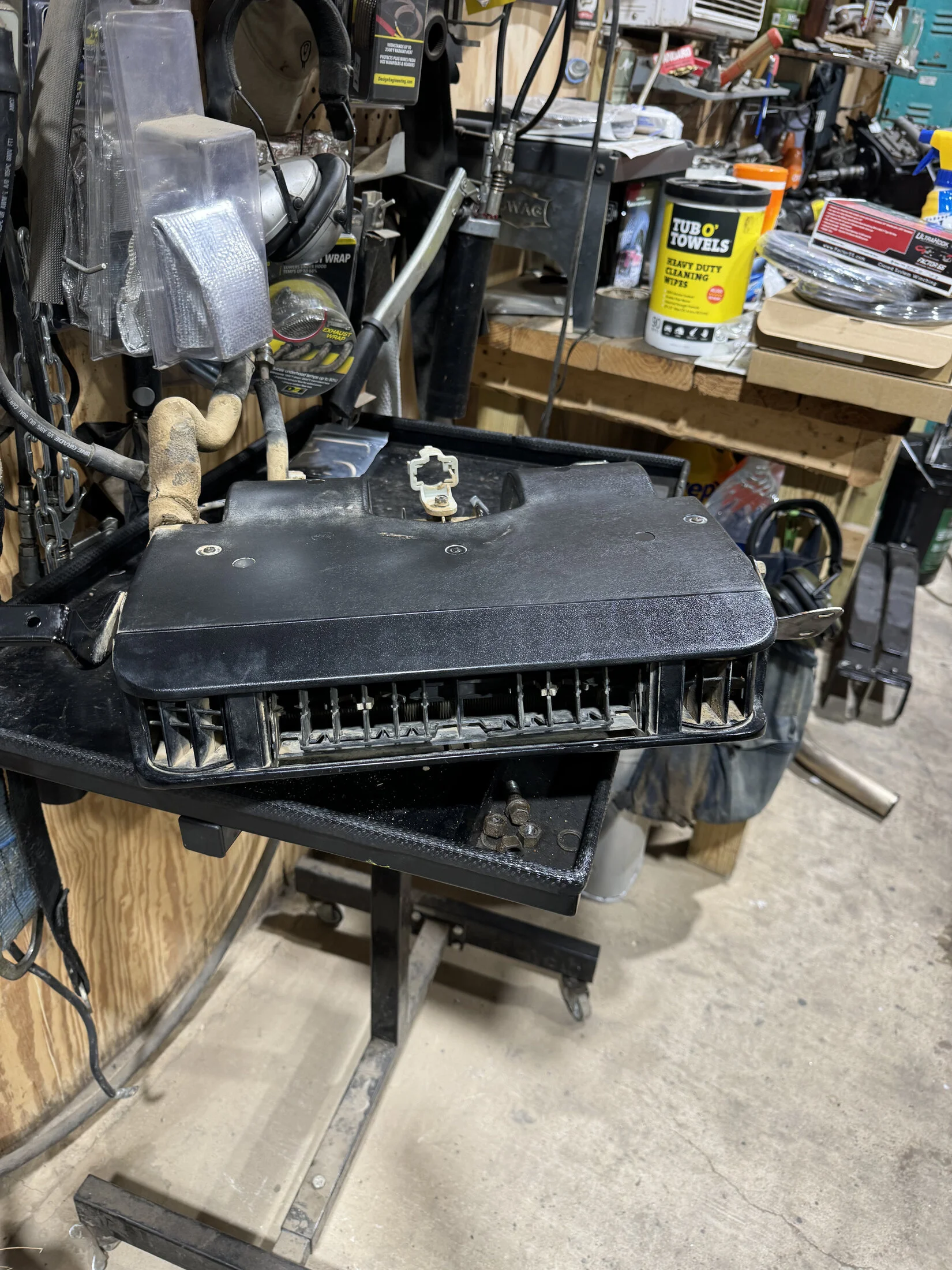

Anyone with experience with a 40 series AC.

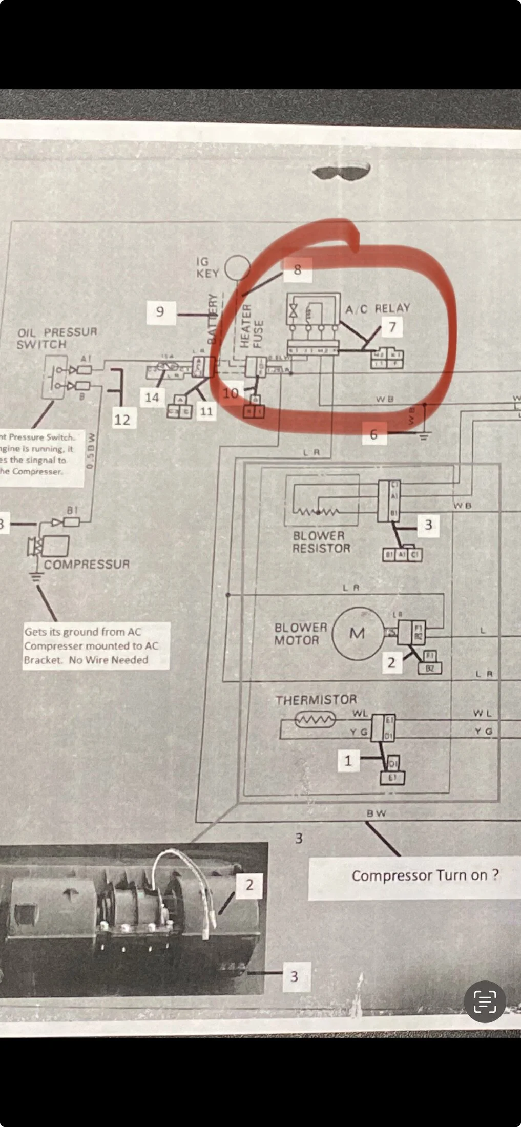

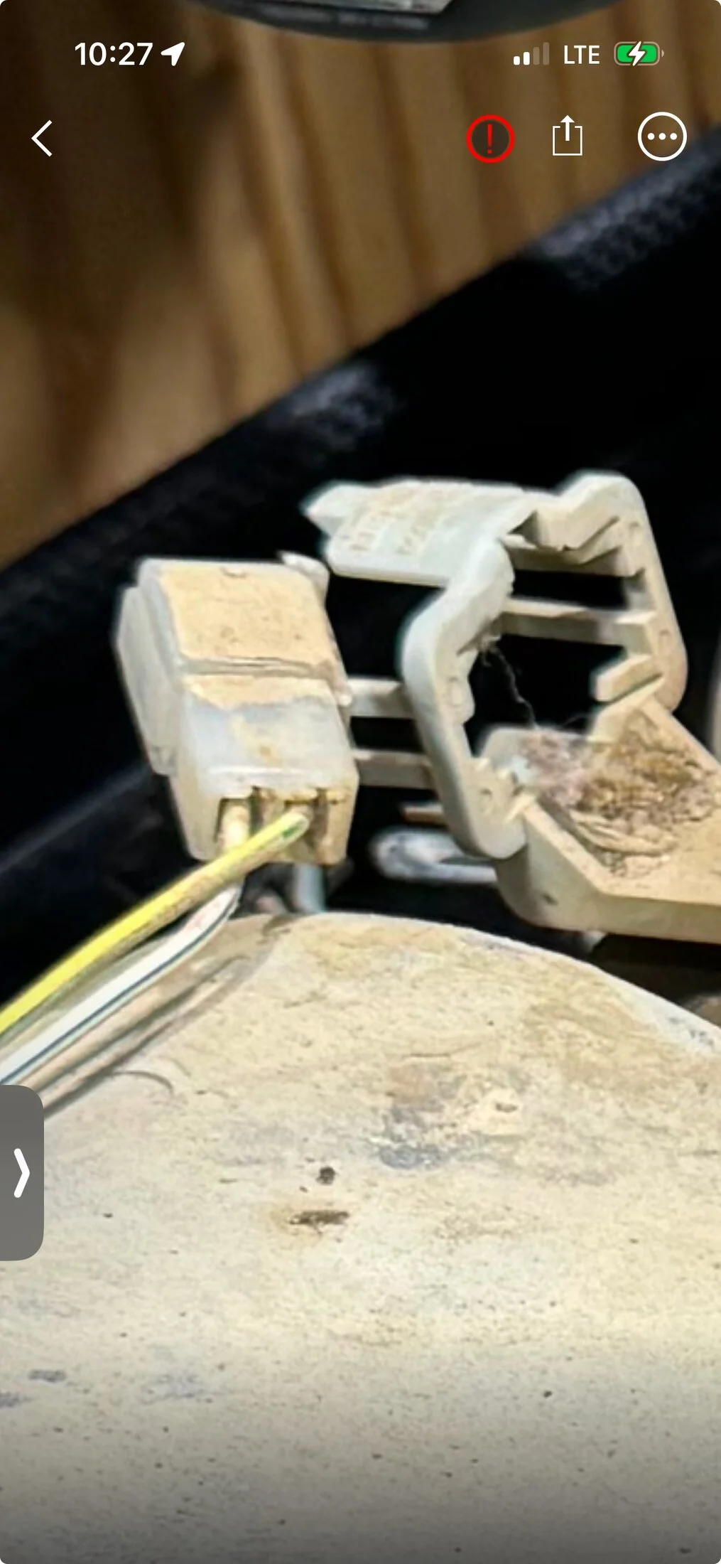

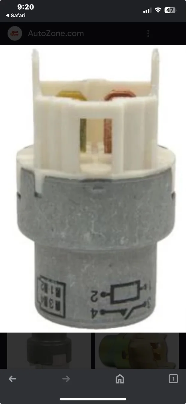

Where is this relay located on the truck? Jason suggested this relay may be bad but I don’t see it.

httpswww.ebay.comitm176583340600chn=ps&_trkparms=ispr3D1&amdata=enc3A125TTwV_MTZefo25OnMSQ-g2...webp
Why would the relay be bad? Relays literally never go bad. Especially Denso relays. They are solid state units. Unless shït is fubarred upstream—. Which very well could be the issue.
Tossing rocks brother.
Since I am good at dumb questions, have you actually located the section of wiring that it plugs into, as we both know…previous owners have worked magic with screwdrivers and dykes
ADDED EDIT: diagonal cutters (dykes). who knows, maybe it’s an east coast term….?

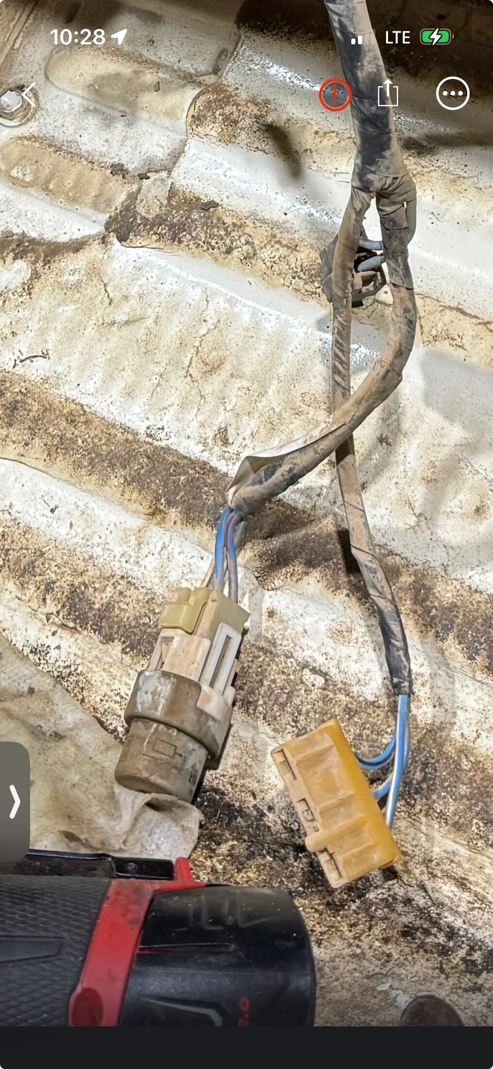

Short of pulling the AC harness completely out I’ve traced all of the wires I can see yes.
As I said earlier, there was a toggle switch there I’m sure now was being used to signal the AC clutch.
I can’t find this dang relay.

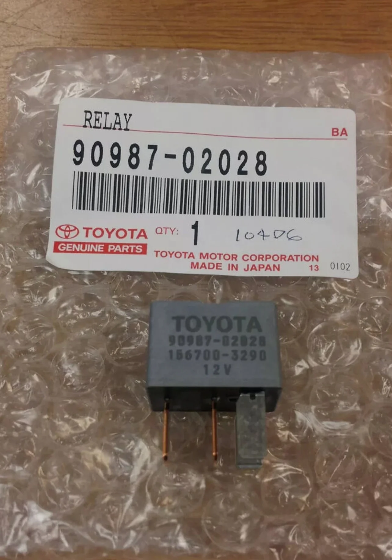

Are you saying you need one of these relays? I think they're still available. If they aren't, I may have one in my parts bin I can send you. Would have to look this weekend.
No, I’m saying I could not find it visually so I went back and looked at pictures I saved when the unit was out and there it is.
I’m traveling but when I get home I’ll see if I can fish it out

Found it. Now to see if I can access it without pulling the unit out and losing my charge.
Just feel/listen for it’s clicking before you do anything. Those relays are loud
