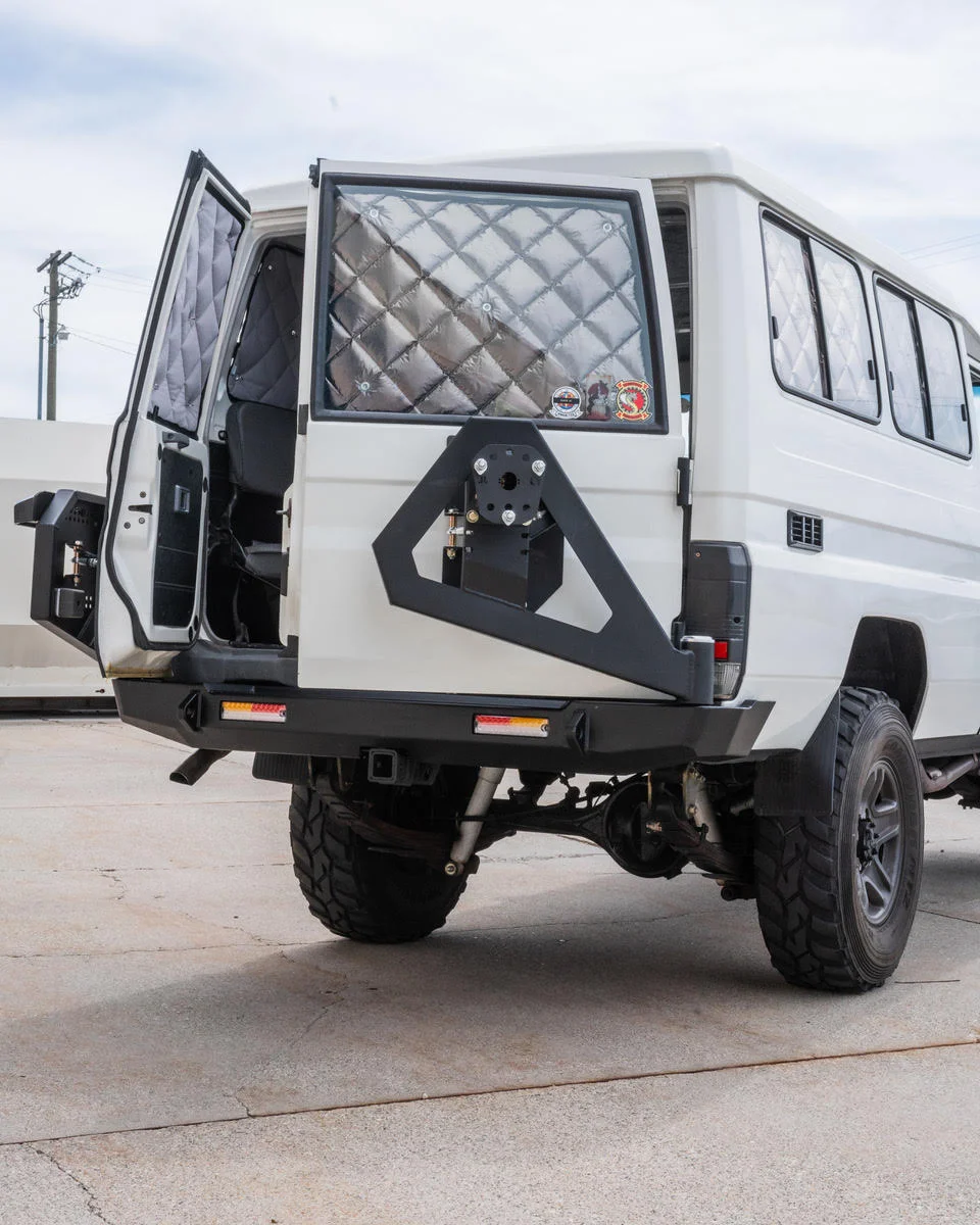

Updated rear bumper pics (was Project LXXIV)

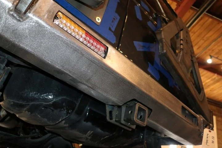

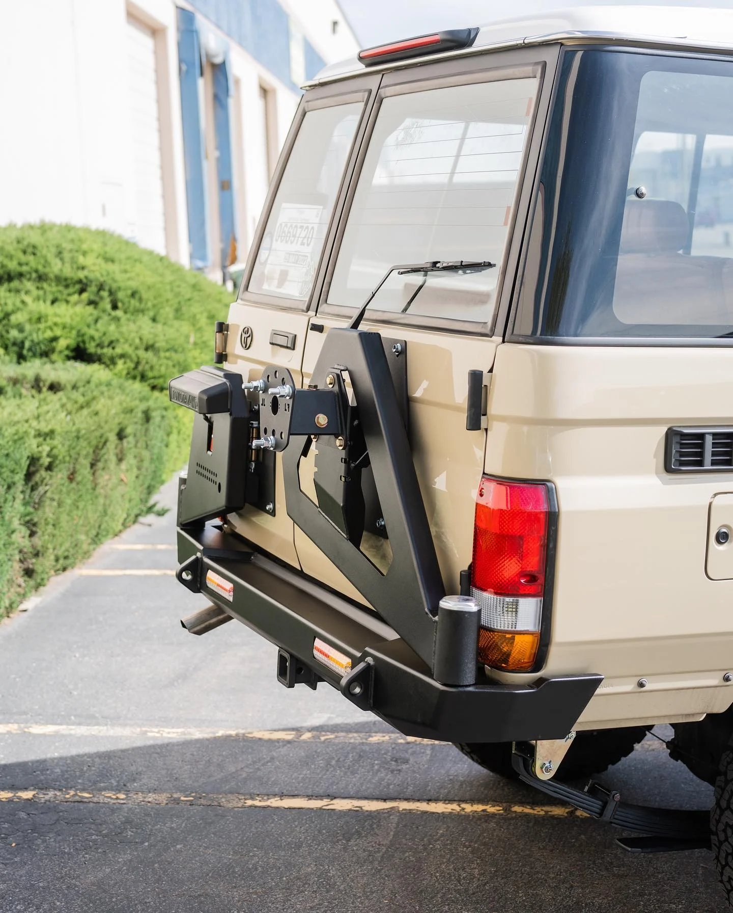

I will follow up with a question. After switching over to these LEDs in the bumper from the stock incandescent bulbs, I'm getting what I now understand to be "hyperflasing" where the turn signals flash faster because of the reduced resistance on the circuit. Has anybody found a LED flasher relay in 24V that's a direct replacement. I'm seeing a lot of options in 12V.
Also the red lights in the bumper come on as running lights but don't do anything when the brake pedal is depressed. Brake lights in the bumper were working before the new one. Is it at all possible this is related to the LEDs as well, or is it just another electrical gremlin manifesting itself? Haven't really had a chance to investigate yet.
the hyperflash is the result of LEDs being used. Give Rob Smith a call or email. He has a Relay that will solve that -or- load resistors need to be used to simulate traditional bulbs. (This option reduces the advantage of led use).
as far as the running light and brake light issue; sounds like it’s not wired correctly. Post #6 can help you probably.
I figured out the brake lights today. They grabbed the brake light voltage from the wrong cable. Re-wired some things and working like a charm now.
I’ll reach out to Rob about an LED flasher relay, thanks for the info!

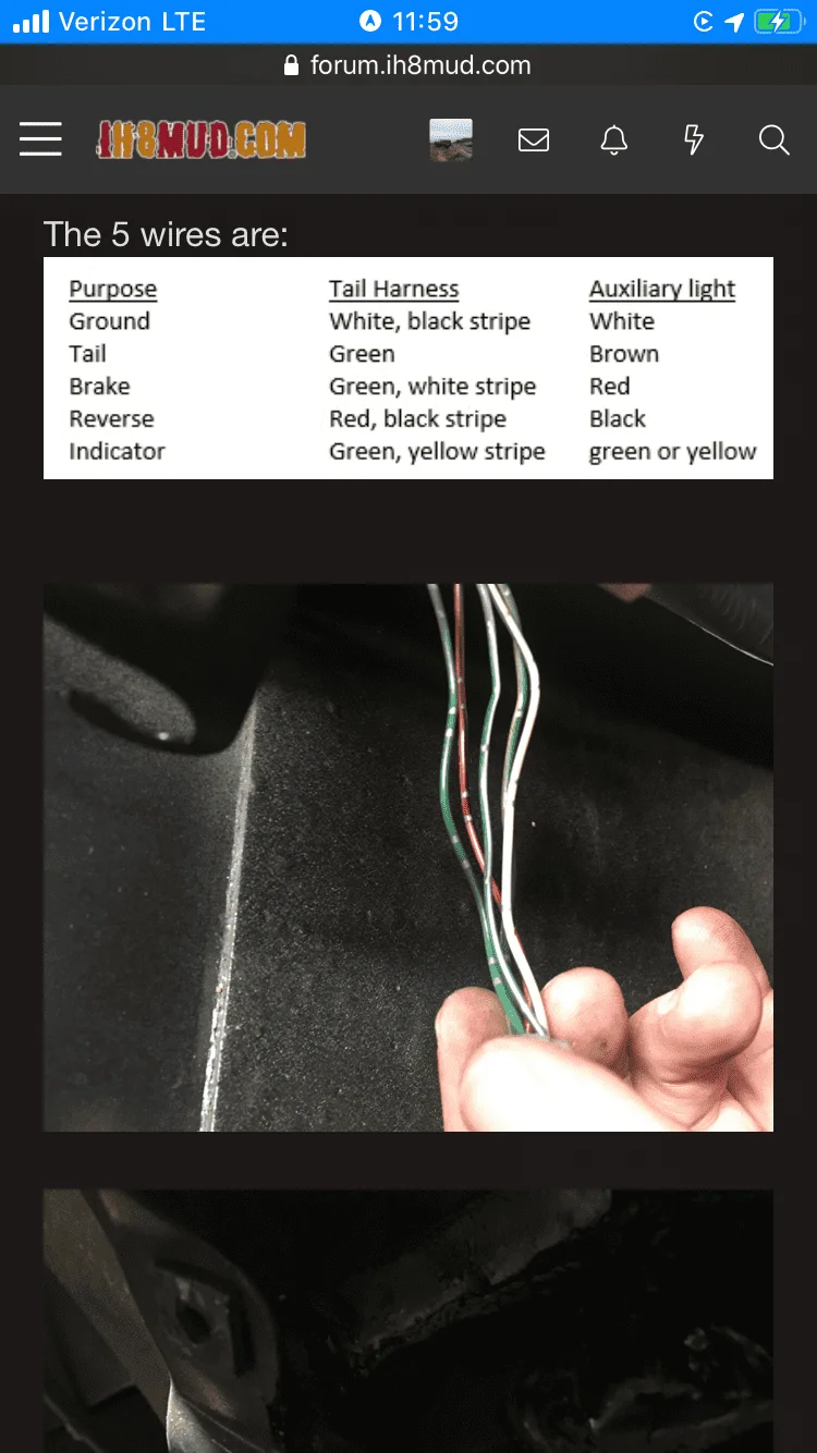

You didnt happen to write down the color combos did you? It would be good to have it documented here and i dont want ot take my bumper off to do it since i forgot

mine was already wired by the PO for trailer lights, i made a harness off that , but obv the colors didnt match. Its an option to not mess further agreed.

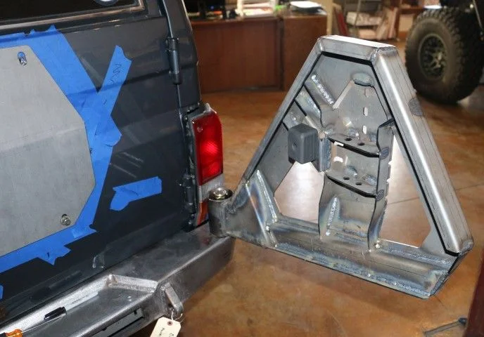

(The original prototype bumper, we were very happy with how this turned out)
This project started many moons ago with our Project LXXIV, Steve @ LCD and I worked with ExpeditionOne to develop a rear bumper with their high quality flavor and our specs and design criteria. Many iterations later and a production run is near.
I signed off on the final prototype a few weeks back and we should have it back from powder-coat ASAP. We'll verify fitment, assemble hardware kits in-house, create instructions and roll into some production units. It's been a longtime in the making but the end product should be worth our investment. CruiserOutfitters & LandCruisersDirect will be the sole distributors of these bumpers (front is also available, minimal change to the LXXIV build) and pricing will be competitive. There are some great bumper options on the market for the 7x these days and I love the fact there are so many neat ways to outfit and personalize these Cruisers. We simply hope to provide another option for those bumper shopping.
I didn’t write it down sorry. I also came off an already bastardized harness that was cut into for trailer lights.

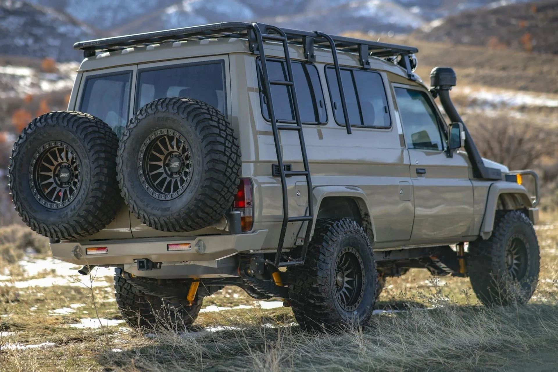

Another local customer has installed a handful of these on his troopy projects and just finished this 1UZ powered troopy with our paint matched rear sporting dual spares :cool:
It’s been waaaaaaaay too long since I’ve chimed in on this thread. We continue to ship these bumpers to homes around the globe. Unfortunately, lead times have been longer than we have wished but that means they keep selling :D
We recently installed front and rear bumpers on a local customers FZJ73. we took the opportunity to add a ton more detail and photos to the instructions (much needed) and will have those finished and shipping with new bumpers later this summer.

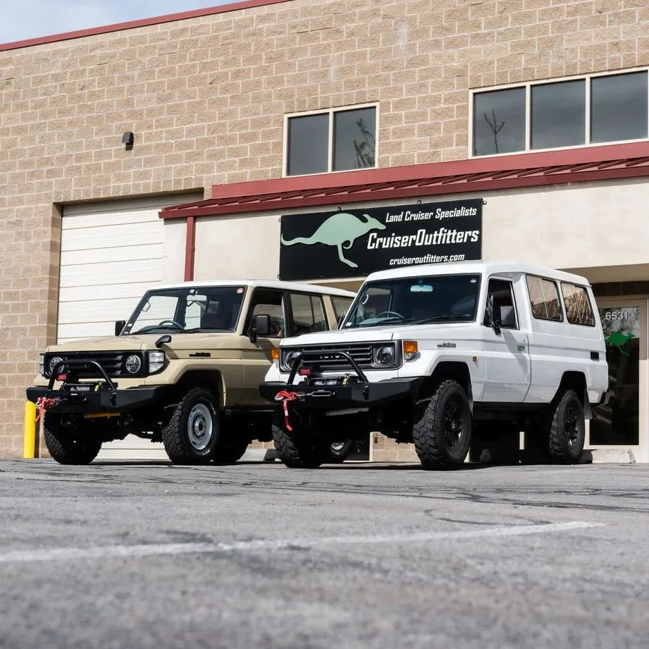

I'm hesitant to share too many pictures and drum up more attention for our rear bumpers that are still on perpetual back-order, full disclosure :D
However these two Cruisers we built a few weeks ago turned out so tidy :cool:
I saw both of those trucks when the family visited the museum. Super sweet. You decorated them well;)
