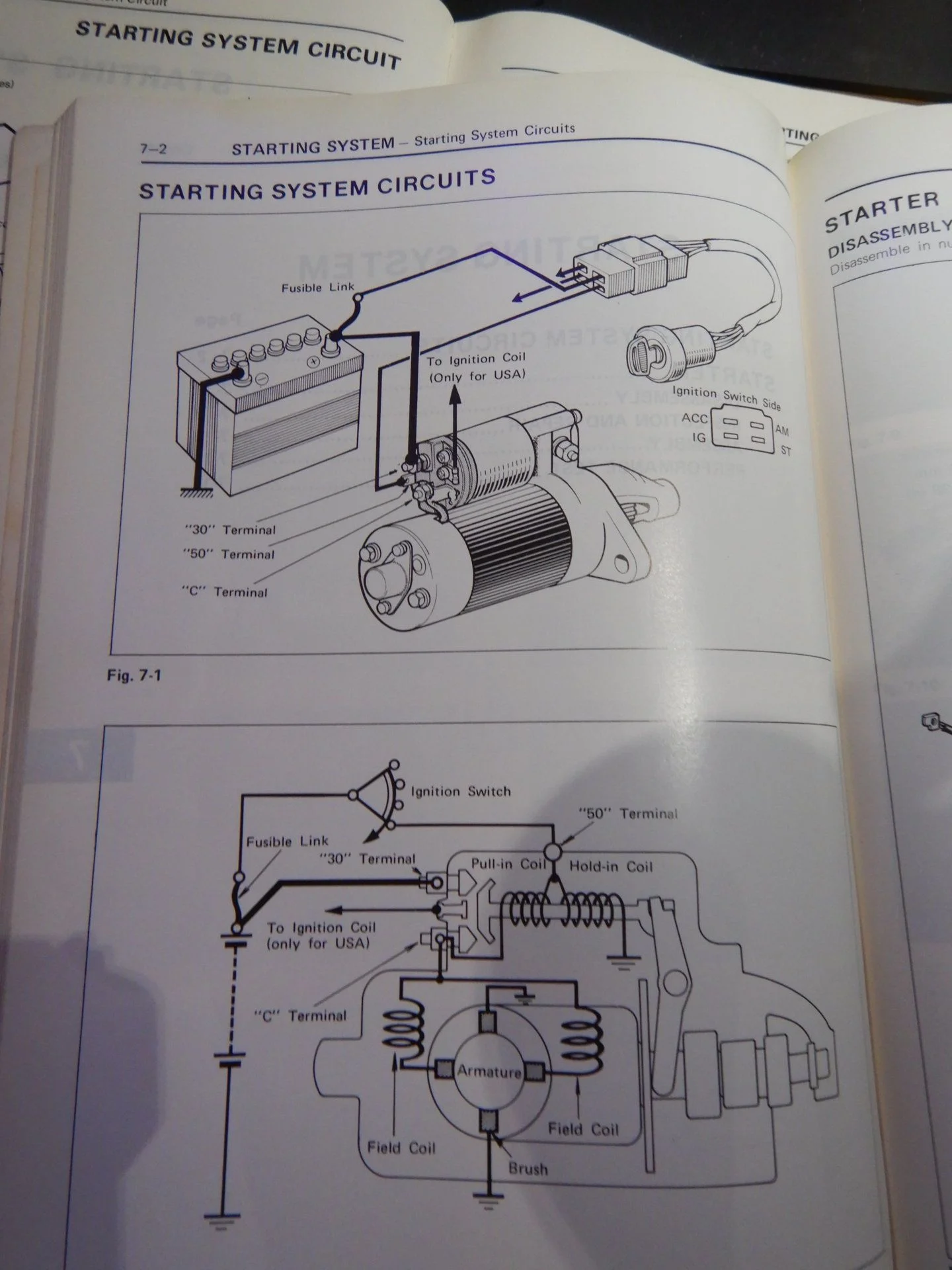

The 74-78 USA starters have the additional terminal for ballast bypass. A Denso reman by Remy (#16224) is available @ rockauto.

-84 indicates that it is a remanufactured part.
-71 would indicate forklift part.
It makes no sense to pay $245 for a starter and some hardware when the 2.0kW 28100-60070-84 starter is readily available from any Toyota dealer for less than a $100.00 :meh:
