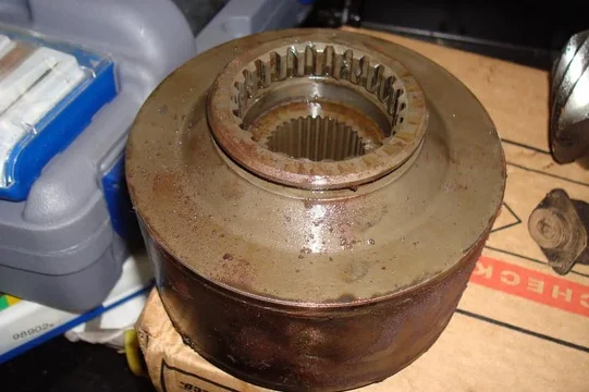

So when I bought my truck I was a newbie and not knowing a lot I bought one with the VC that was seized. There has been talk on Mud about it not causing damage and I want to show all that it can and does cause damage. I had typical tire scrub/skip/chirp on the front wheels when I made a tight turn in a parking lot.(due to the seized VC). I also had a pretty bad whine above 20mph. It eventually broke teeth off my ring and pinion. Here are some pics. I also have the bad VC if anyone wants to dissect it and see the failure mode, total failure or partial failure etc.

NO, I did not have the lockers on. And I did NOT have the center diff locked. It acted the same as if the center diff was locked though. Center diff locked or not it drove very similar. I don't know how long the previous owner drove it this way.
I didn't drive it very long this way either. During my first few weeks of ownership I changed the diff fluid to see what condition it was(Black) I then a few weeks later tried the Heavy Oil Stabilizer from Lucas Oil to see if that helped the nasty wine I had. During that second change of front diff fluid is when I found the first gear tooth. I then took it somewhere to be looked at and quoted for new gears and the second large tooth was found. You could feel the gap where the teeth missed and I was sure I would snap a few more so I stopped driving it, and now I have 4.88's

There is/was nothing else wrong with the truck it was 100% stock, running boards and no rust or dents nice leather etc. I don't know what else it could be. Plenty of oil in the diff too. The new VC completely stopped the binding.

On a HF2AV xfer case, a binded or seized VC will transmit (or lack thereof) to the rest of the driveline and cause damaged.

Gear whine caused by the VC. I ended up needing a new carrier too.
Now it's 100% with a gear change and new VC
Draw your own conclustion but with the change everything works as it should.
When you turn a vehicle on pavement, even if it's just a shallow turn, all four wheels need to be able to turn at different speeds. So the differential side to side is not enough. You HAVE to have a differential front to rear or it will bind, when all four wheels have equal traction on the same type of surface.
Pavement is one of the highest forms of traction short of getting a tire wedged in a rock, so I can possibly see breaking parts in a tight turn. When you're off road, in dirt, gravel, or whatever, the tires have a lot more give to slip, even if the center diff locked.
However, that said, the gear whine does lead me to wonder if there was other major issues going on with the diff and I do wonder if the locked up VSC was more of an aggravator rather than the root cause of the failure.
I think the VC binding up caused enough fource/pressure/binding, through the drive train to damage something in the front diff which in turn damaged the gears and carrier or maybe through the gear engagement offset off? Still the VC caused all the damage. As far as I can tell. Nothing else has been changed and the problem is gone.
