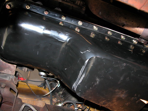

I *finally* got my oil pan re-installed. I was in serious procrastinate mode with it... for some reason I was really relucatant to just dive in and get the damn thing up there. First I dawdled until my local Toy dealer had FPIG in stock.
Then I had to find some studs and grind slots in the heads to make it easier to guide the pan into place.
Then I finally just did it. Next time it will take me about an hour. This time it took me several months. :o

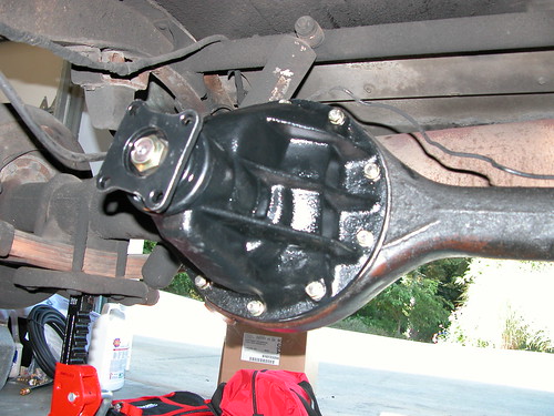

I also got my "new" rear 3.73 3rd member installed. I ran out of time to put the rear axle but that should go quick.
Next up is getting the front 3rd in place and to start re-assembling my front hubs.

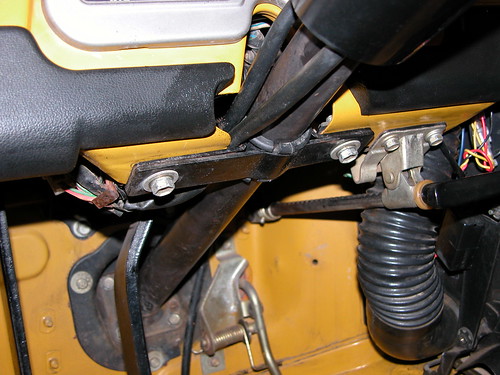

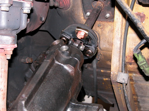

  • New rag joint installed and power steering box re-mounted. Steering rod & wheel secured (PO had installed the bracket holding the rod backwards. sheesh).

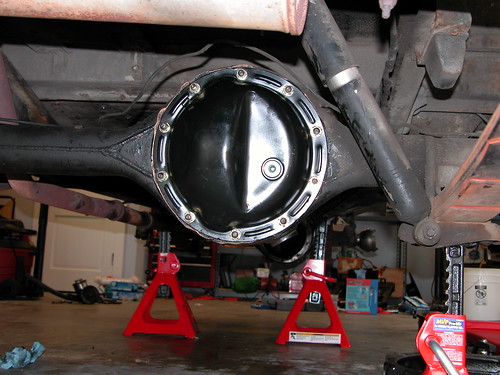

  • Got the rear axles and the rear diff cover on. Just need to put some diff oil in (what weight do people recommend for a daily driver?)

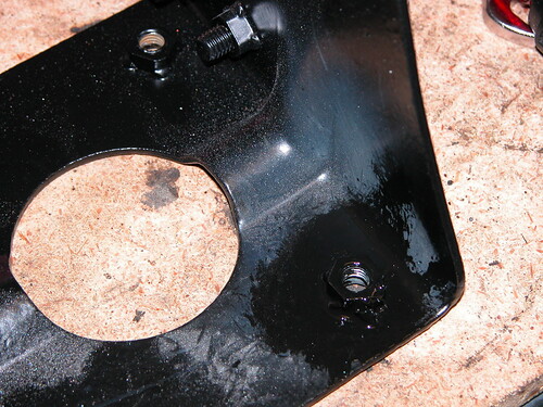

  • Bull came over with his portable welder and gave me a quick lesson on how to weld. *I* then welded a nut onto my battery tray bracket that I had ground off due to a broken bolt. Fun stuff. I gotta get some schooling on welding.

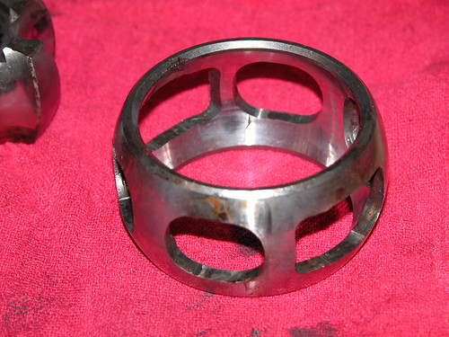

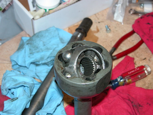

  • Pulled the birf joints apart so I can re-pack the bearings. Like an idiot I didn't realize there were snap clips holding them together. It took Bull's intellect to point this out. We ended up breaking the inner C clips..new ones on order.
TEQ said:
the steering shaft looks like it's touching the bracket at 5 o'clock . Is the box bolted in place? Does the shaft touch while you turn the steering wheel?
Shane
Shane
it's darn close, but does not actually touch. the rod has very little play in it and even when I try I can't really get it to "grind", so I think it's ok.
I can't remember, but can you loosen the 4 bolts at the fire wall and slide it over a hair to get a little more clearance? Im thinking while turning you might get a vibration.
Is the a 40 box? So you shortened the shaft in the middle by 1 and 1/4 inches?
I may slide it over a bit as you say. Thanks.
The PS box, PS pump, PS pump bracket, and PS lines are all from an unknown source. They were installed (i am assuming) by CCOT in '94.
I put the box & shaft back in just as it was before I took it apart, with the exception of the new rag joint.
The box is NOT a FJ40 '79+ box (I know because I tried to replace it with one and they were not the same).
The pump is also a mystery. See https://forum.ih8mud.com/showthread.php?p=1173147. I also asked a bunch of FJ60 folks and they claim it is not a 60 pump either.
I am dead in the water with my steering system until I can ID this pump and find a replacement... I plan on having you refurb the tank ;)

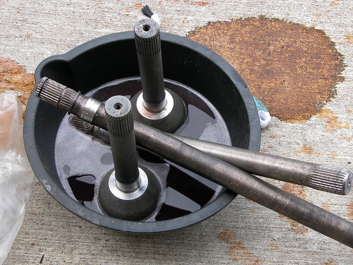

Got the axles apart and removed the bearings and races. After cleaning them up I noticed that there's quite a bit of minor surface rust here and there on all parts. The FSM says "inspect for wear, damage and rusting". Well there's no wear or obvious damage, but there is rust.
WTF am I supposed to do?
1) Ignore it (the rust is minor, move on)?
2) See if I can dremmel the rust away?
3) Replace these parts?
My instincts tell me the rust is totally minor and can be ignored. If I had not read the FSM like a good boy that's just what I'd do...
Also: The FSM says the use "molybdenm disulphide lithium base grease" when re-assembling the axle shaft bearings & races.
I have some "MAG1 Hi-temp disc brake wheel bearing grease" that says it is "...state-of-the-art lithium complex grease."
Do I have the right stuff, or do I need to go hunt for something more specific?
You and that "dremel" Scotchbrite will be your friend. rust sopts wipe off with scotchbrite. Pitting with edges is bad.....
