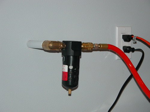

Today I fitted my air compressor to in-wall plumbing I had the contactror build into my garage when we built the house but I hadn't gotten around to hooking up yet. It's nice having the noise of the compressor on the other side of the garage...

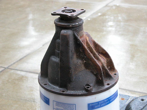

My goal today was to make use of my new die grinder to wire wheel the rust off the 3.73 rear 3rd I bought from Yoda.

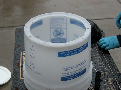

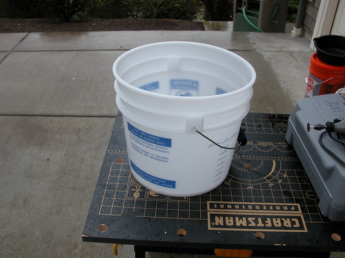

I wasn't sure how I was going to support the 3rd member while doing it, but eventually came up with a pretty creative solution (IMHO). I used at 2.5 gallon bucket (half height of a 5 gallon bucket) that I bought at Lowes (like Home Depot but better/worse) as a base for my work.
I cut the bottom out of the bucket using my Dremmel, leaving enough lip for bolt holes:
I thought I might need to bolt the 3rd in place on the bucket, but as it turned out the damn thing is heavy enough that it was really solid.

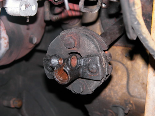

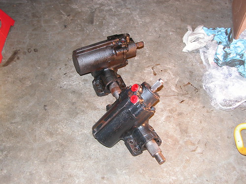

Last night I got the old steering box off. Had to do the dance with the steering column (removing the 4 bolts in front of the brake pedal and the bracket that holds the column up) which I wasn't expecting, but it wasn't too hard.
I think this thing should be replaced. I think it's designed to break off in an accident? The rubber on it is pretty crusty and there is a bit of play in it (contributing to my steering play?). Should I replace it?
Turns out the rebuilt PS box I bought was the wrong model. CCOT put a mini-truck box on, and I bought one from a '79 FJ40. Oops. That'll delay getting the steering back together....
Maybe I'll just rebuild this box.... I saw anothe thread that indicated it was not too hard. Anyone know what gasket kit to get (given this is a mini-truck box)?

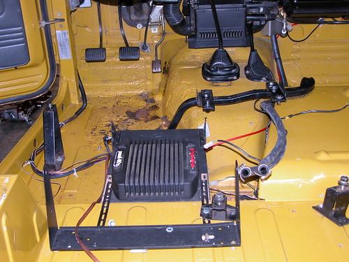

  • Removed the driver's seat, fuel tank cover, and cleaned up under there the best I could. This is all in preparation for installing my tuffy box and the refubished heater Shane (aatlasx) is building for me.

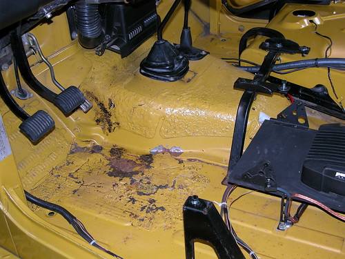

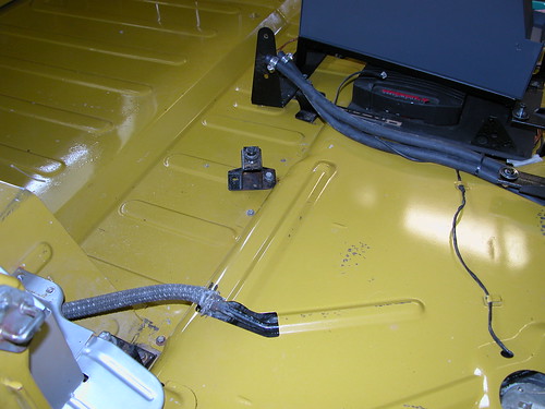

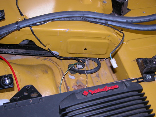

Two Quesitons:
  1. How do I deal with the minor surface rust on my floor without stripping and repainting the whole floor? (2nd to last picture)
  2. The hole in the floor where the gas line goes...what should I plug that with? (Last picture).
1. Scrape/brush off the loose rust/paint. Treat it with phosphoric acid (Jasco metal prep, available at Lowes). Touch up the paint.
2. Why plug it? Is there an extra hole there? There should be two hoses going through there.
HTH.
Todd Bull.
TEQ said:
[*]How do I deal with the minor surface rust on my floor without stripping and repainting the whole floor? (2nd to last picture)
[*]The hole in the floor where the gas line goes...what should I plug that with? (Last picture).
