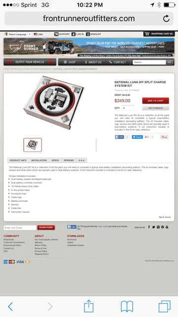

@S.CarolinaFZJ80 how do you like the National Luna Dual Battery system? I'm torn between it and the IBS system and the much cheaper TMaxx systems.
It's actually been pretty good. Originally I thought otherwise but I it turned out to be a bad battery due to parasitic draw and sulfatation. Once I tracked down the drain and replaced the starting battery, it's been superb.
The panel mount monitor is not in their kit and has to be purchased separately.
Is this the kit you have? It appears to come with the panel mount monitor.
