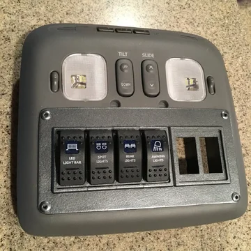

All this talk about electrical and wiring has inspired me to get off my rear and work on my set up. I'm about finished up with an overhead switch panel in the cavity left from the sunglass holder. The panel will house switches for all lights and eventually an ARB compressor and rear locker.
Before
After

How will you handle the ATRAC? I'm sure there are posts out there on this subject, but it seems like it would be a monumental pain in the rear to put a locker in a newer 100... Out of necessity, I missed the opportunity to do something creative with my drivetrain, but I've been curious.
Shouldn't have any issues with ATRAC other than it not having to activate as much with the rear locked. ATRAC is computer controlled oscillation of the ABS system to prevent wheel slippage, there's nothing mechanical behind it in the differentials. The 100 series trucks with ATRAC are true open diffs on each end so dropping an ARB style rear or front locker in shouldn't be an issue.
The biggest headache will be pulling the 3rd and taking it to a gear installer to reset the gears. :cheers:
