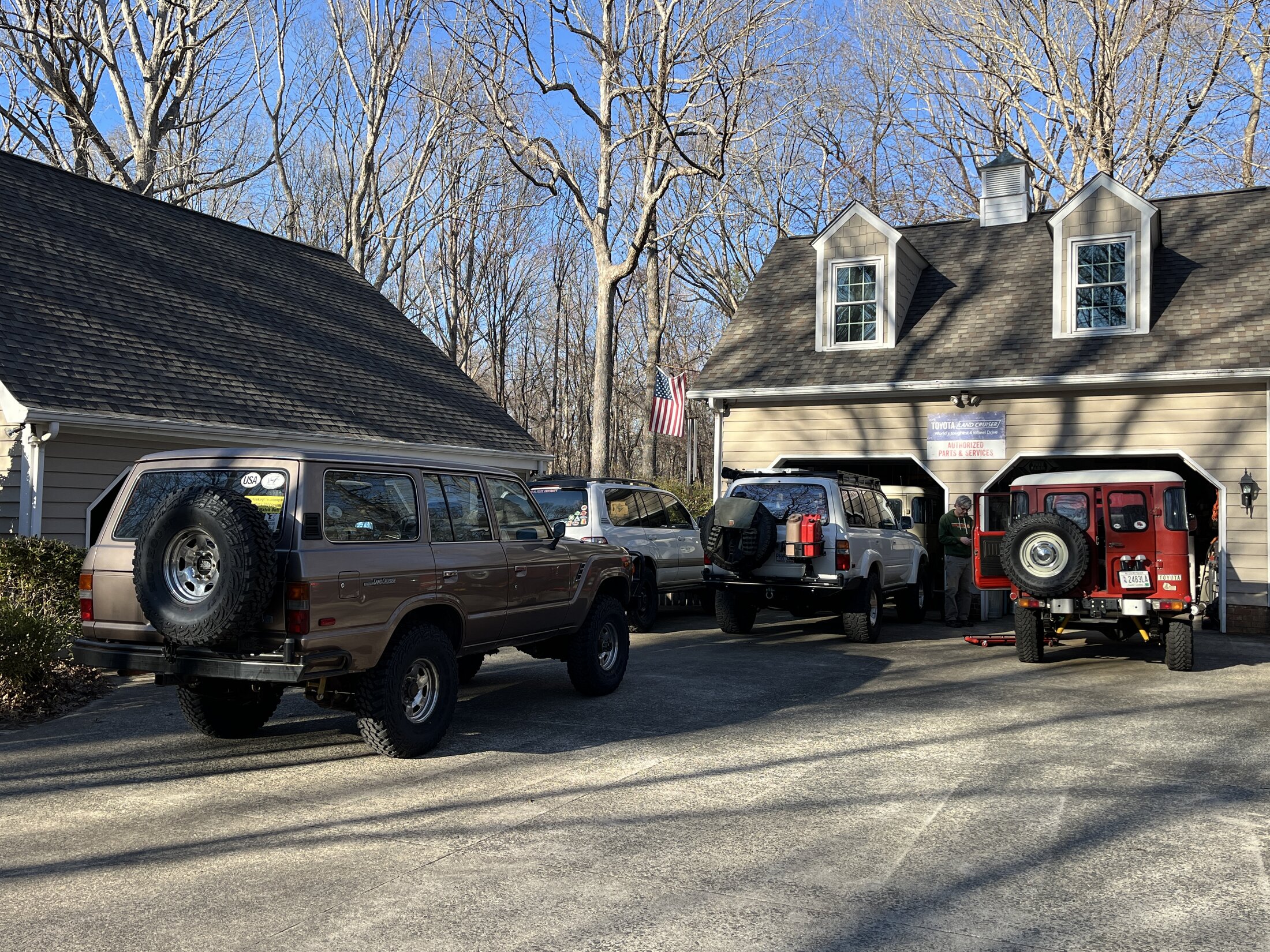

Light wrenching yesterday. Brake fluid flush on @FJinTegaCay Miller’s 40 and centered the steering wheel on @pkniland Patrick’s 60.
Light wrenching ... is relative. With the required tools / space / knowledge / expertise, it can be.
Looks like you have a great Cruiser space (with an outstanding group of Cruisers in the space). Kudos
That barn is the Taj Mahal of Land Cruisers...except that it's not a tomb. So maybe not the Taj Mahal. But extremely sweet!
I wish it were bigger. (That's what she said.)
Size can work against you too!
My case for example. My bride found her dream home in '05 and it happened to have a 40ft by 80ft brick out building that matched the house. It got better yet when the loan appraisal came in that the out building was a freebie (i.e., we had negotiated such good price that house & land more than covered needs for the loan). This was all great.
But 3200 sq ft of unheated/uninsulated shop is not easy to work in with temperature extremes. The cost to upgrade with insulation / heating-cooling /floor coating / ... a 3200 sq ft building adds up very fast to non-trivial sums. My lovely bride is not a fan of non-trivial sums. Her current feedback to funding requests is sell Cruisers until you have enough money to cover the shop upgrade costs.
Looks like I will continue to sweat like stuck hog in the summer and freeze each winter.
