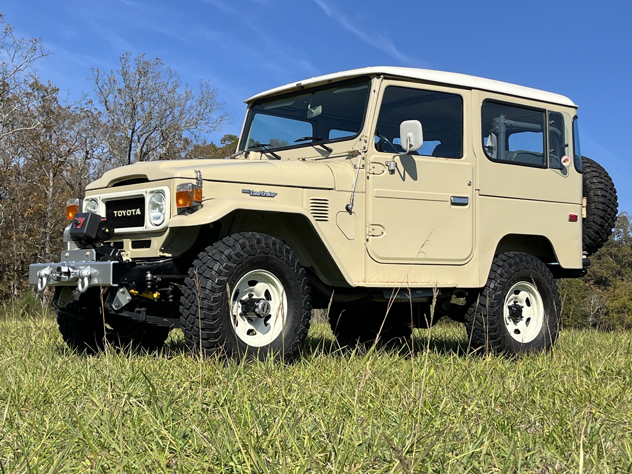

I posted a while back about my ‘82 FJ40 having low compression in two cylinders. As it turned out, the head gasket did blow between cylinders 4 & 5. Pulled head for a refresh. New HG. Old truck lives again.

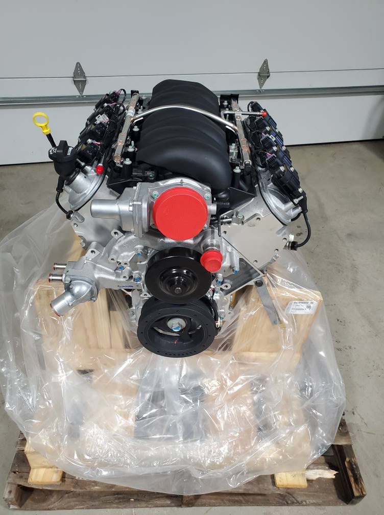

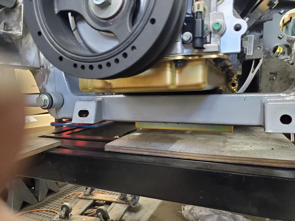

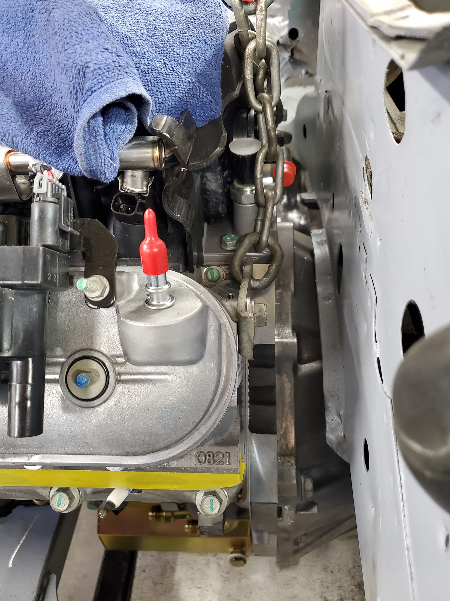

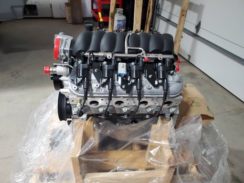

The engine and trans are sitting in their final spot. Had to remove the rack and that will be lowered a bit. The tunnel will only need attention on top ad the trans and bell housing fit well. I'll have to do a little creative work on the fire wall for better access on the bell housing top center bolt. Two inches between front top of intake and the hood. Plenty of room for shorty headers. Steering shaft might be tight, will not know for sure until new location for the rack is determined. Hoist is now removed as is leveler, sitting there on it's own.
Engine and trans in place has me smiling ear to ear.

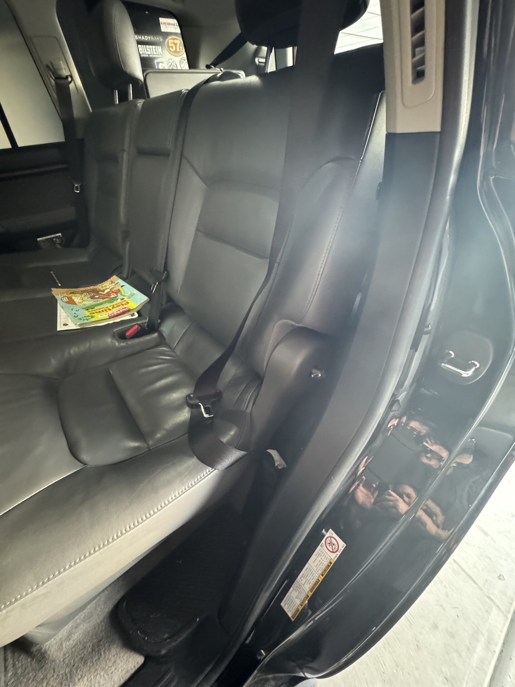

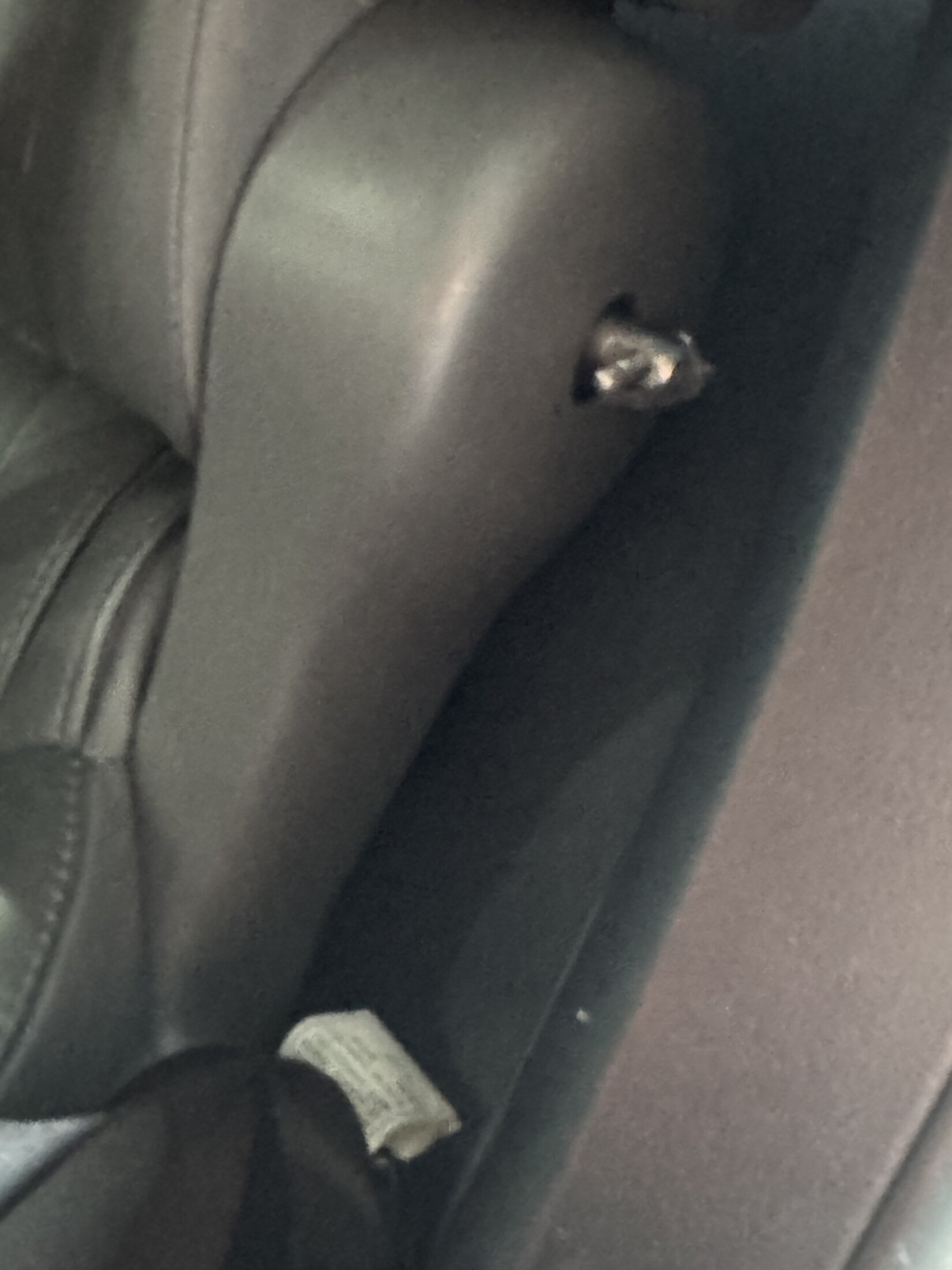

The 2nd row tilt release handle broke on my 2011 200 and I am having a hard time identifying the part number. It's the handle, screw, snd the plug. Ive seen diagrams but I cant seem to figure it out, hoping one of yinz can assist.
@bloc can you help with this part number?
Gray left side handle should be 72526-60090-B0
Bolt 93240-56025
Bolt cover 72329-60080-B0
