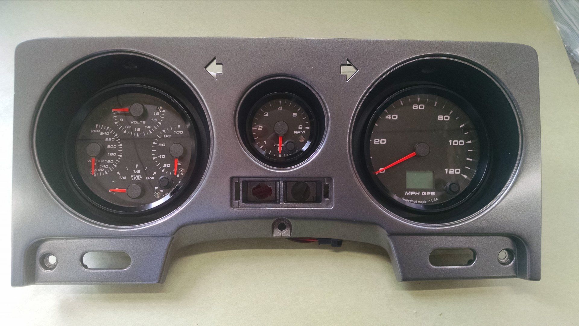

Don't know what the whole theme of the car is. But from that picture, the copper bezels look good.
Just when you think you have seen everything. I had a text from a customer today "Why are my gauge rings copper" I ask what he is talking about, he tells me the bezels, the gauge bezels are copper colored. So I called him, "Bored today are you, nothing better to do than hassle me on a Wed afternoon"
So he sends me a text with this photo. DAMN, those bezels were black, I have a picture of them when they were just installed. Notice how the tach bezel looks antique brass on the bottom. I called SpeedHut and they are aware of the problem, a UV issue with the black coating. The Tach is not getting as much sun.
SpeedHut is sending me new bezels, but they have not figured out a solution yet. I'll be painting them black and sending them to my customer, after I set them out in the sun for a while. I have four sets of SpeedHut gauges sitting here in the same color.
Strange, but I kind of like it.
I bought cheap black tire valve covers from Walmart. The UV light turned the black into a bright polished copper color. I loved them however over time I've lost 3 out of 4 of the valve covers and apparently the new ones don't change color :(

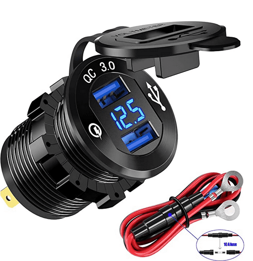

so i purchased a little USB charger port to replace the cigarette light socket in the rear of the center console on the Ferd.
shows battery voltage and works pretty good.
ok, driving down the road i get a TPSM error. everything seems fine, i pull off at the next exit and check the tire pressure all good. hop back on the road and everything is fine the rest of the trip. (didn't plug my phone back into the charger). long story short i figure out the after about 25 minutes of driving with my phone charging (or any other device) will cause the TPMS failure. after some internet searching the USB charger is so noisy when in use that it jams the signal from the rear tires and after 20 minutes of no signal the error happens. if i unplug a device from the usb port the error goes away within a couple minutes.
go figure....

You can likely fix that with a cheap inductor choke for audio components. Worth a shot if you want to keep it.
I did a bit of light reading on this issue during a droning call today:
Seems lots of folks report Skiva brand chargers are a solution. Doesn't seem they have the hardwire style you are after, but for "cigarette lighter" adapter to USB port, they offer a couple but they are pricier than what you see all over Amazon/truck stops/etc. Ferrite choke(s) on the charging cable seemed to be a partial solution, but I'd personally rather find a permanent solution (charger) after thinking about it a bit.
