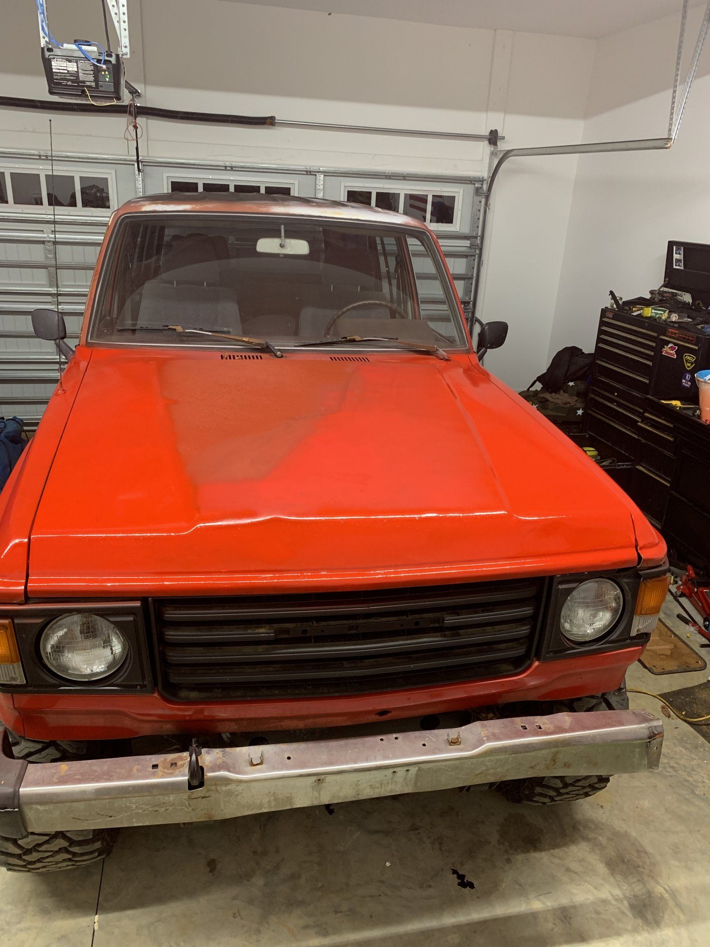

I’m preparation for being down one arm for a month and a half after my shoulder surgery I shifted gears to improving the shop lighting, tool organizing and compressor set up to be able to paint the truck. Or at least get primer on it before my surgery.

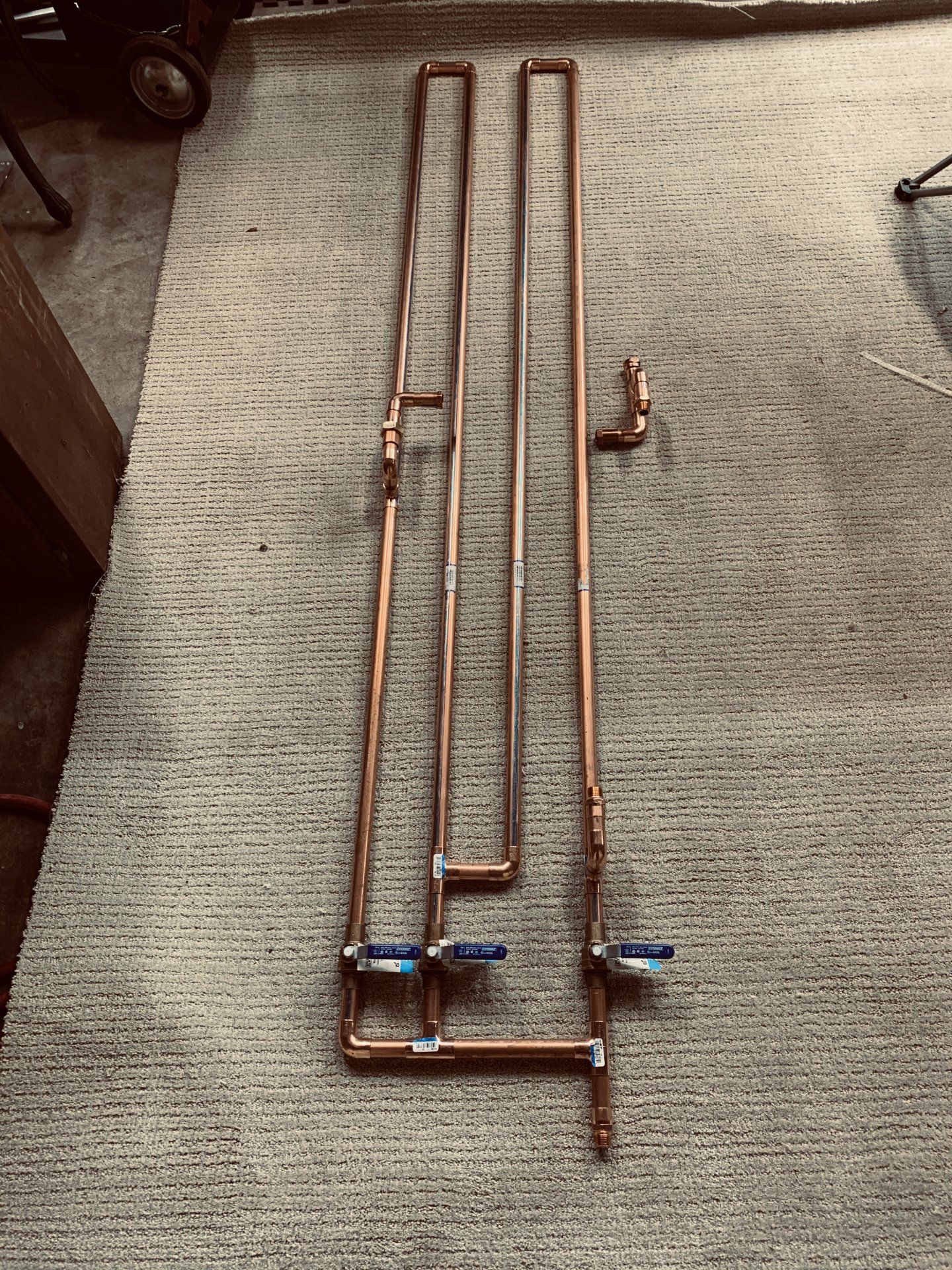

Found the plans for this compressed air dryer with auto drain and put it together tonight. Will solder it tomorrow and should be ready when the filters and auto drain get here later this week. Hoping this helps with water issues and let’s me spray my trucks. For now going to use the 30 galling compressor I currently have but plan to upgrade to 220 volt bigger compressor at the end of the year.
I built a similar copper manifold for the air system this year, made a HUGE difference in the amount of moisture in the system. I was shocked at the amount of water that it removes. My system then has a canister water remover at the blast cabinet, all air goes through that and then out to the air outlets. I also have one more canister at the outlet I use for painting. There is rarely any moisture in that canister at all.
The big difference is the copper manifold. Keep in mind that the canisters remove water, not water vapor so place the copper manifold as close to the compressor as possible to condense that vapor into water. The fist tube, closest to the compressor on my set up is noticeably warmer to the touch than the fare tube where the air enters the system.

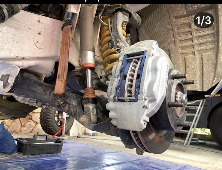

Can someone help me build down travel limiting straps and weld on mounting points for the 100? Jumping speed bumps is not nice on the down travel now. 🤣pic from 200 series dakar truck.
limit straps
You need to figure out your mounting positions and the length from those two points. Mounting them is not complicated.
