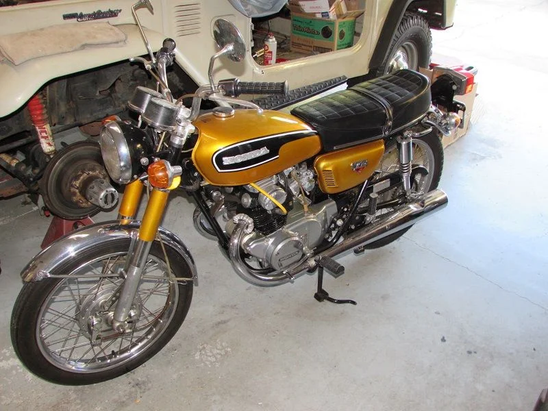

I took this out of storage last week so I could get to the mower. Took it for a ride around the block.

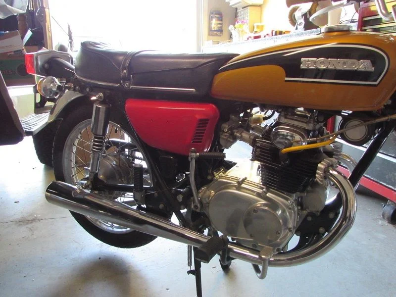

I have been looking for a side cover for about 7 years now. It's almost impossible to find these. Plenty of left sides out there. I guess people over the years crush these when trying to kick start it. I finally found one about a month ago, put it on the back burner with the 40 in pieces. Just test fitting here. I will take the left side to my paint guy and let him match it. This is not the original paint, so I'm not messing up an original. I still have to find an emblem for it as well. No hurry just when I get to it, couple years maybe. :)

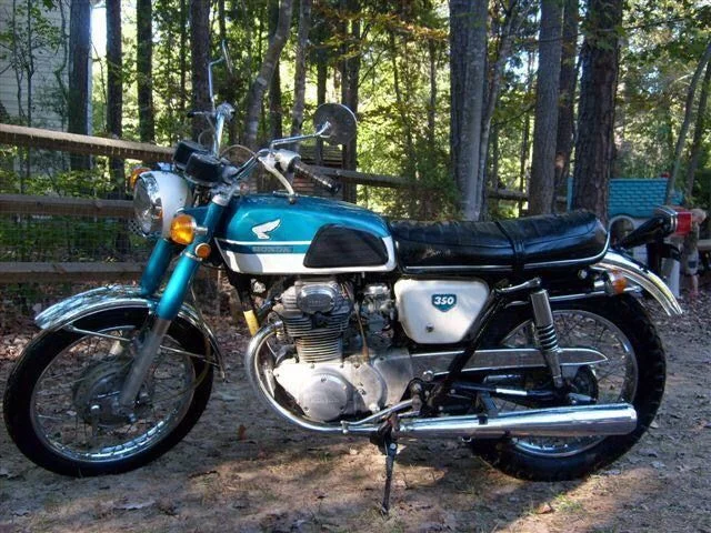

@lowtops. Here is my old '69 CB350. I sold it a few years ago.

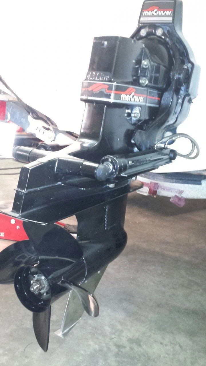

Anyone who has ever had a sterndrive boat for any length of time knows the "Birfield" of boats ... replacing gimbal bearing, along with bellows, water pump, and trim senders.

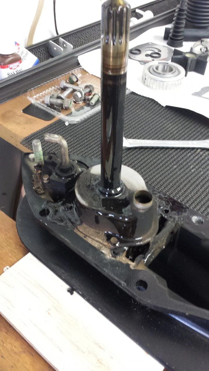

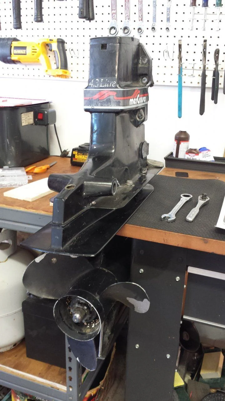

Step one .... pull lower unit.

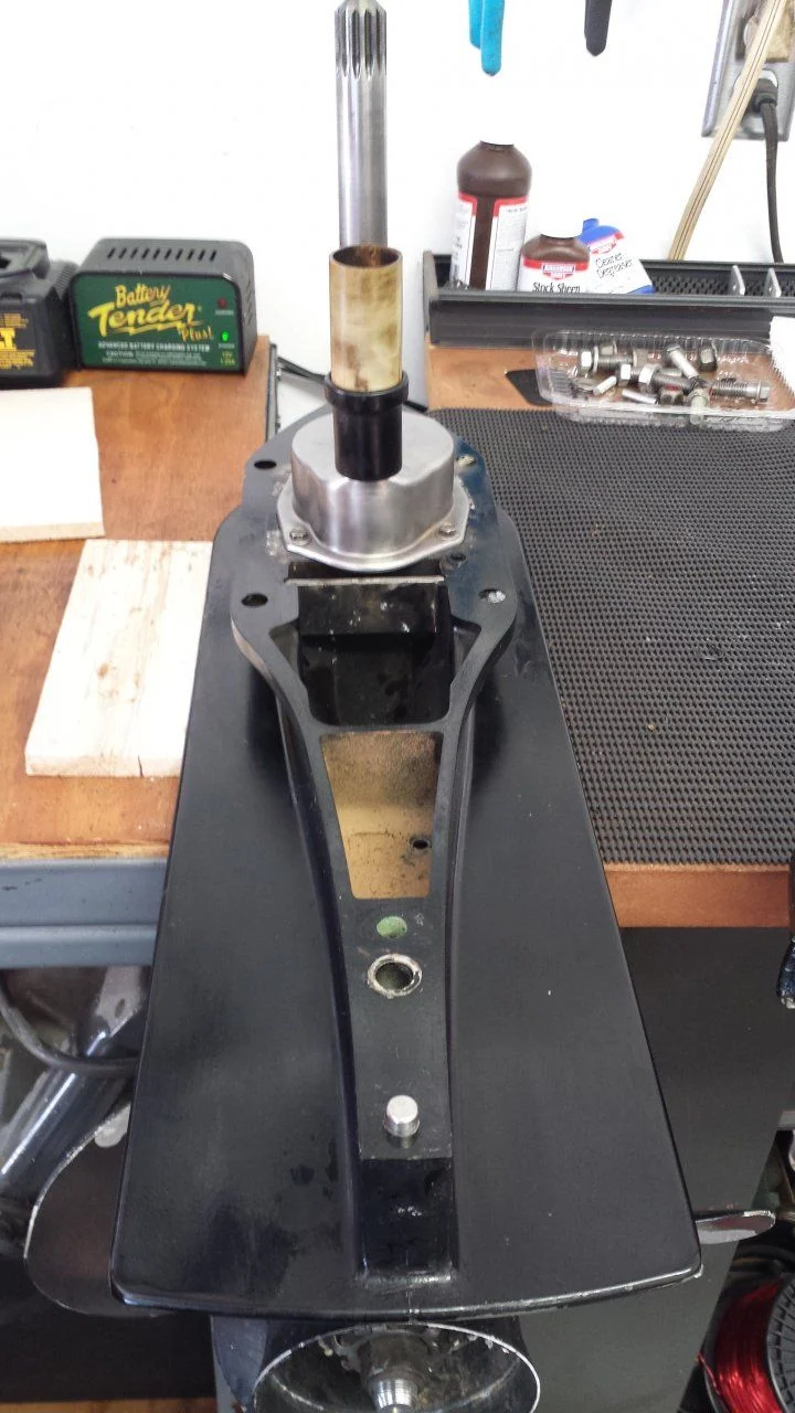

Step two ... separate lower unit to access water pump. Replace impeller and backing plate.
Cleaned up with new impeller installed.

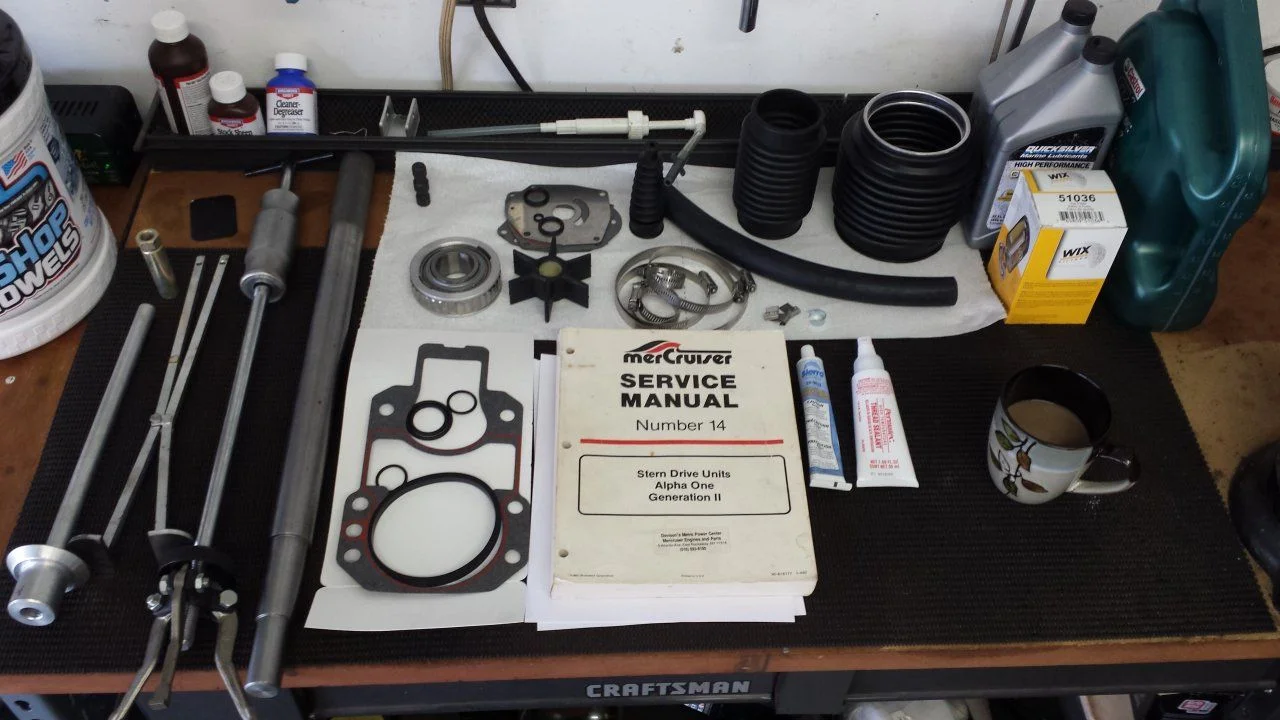

Next, on to the gimbal bearing.

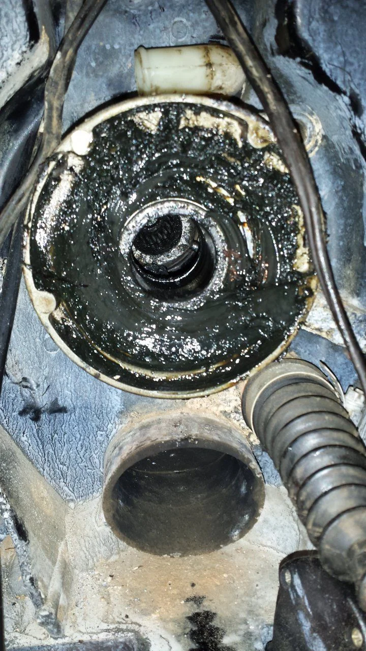

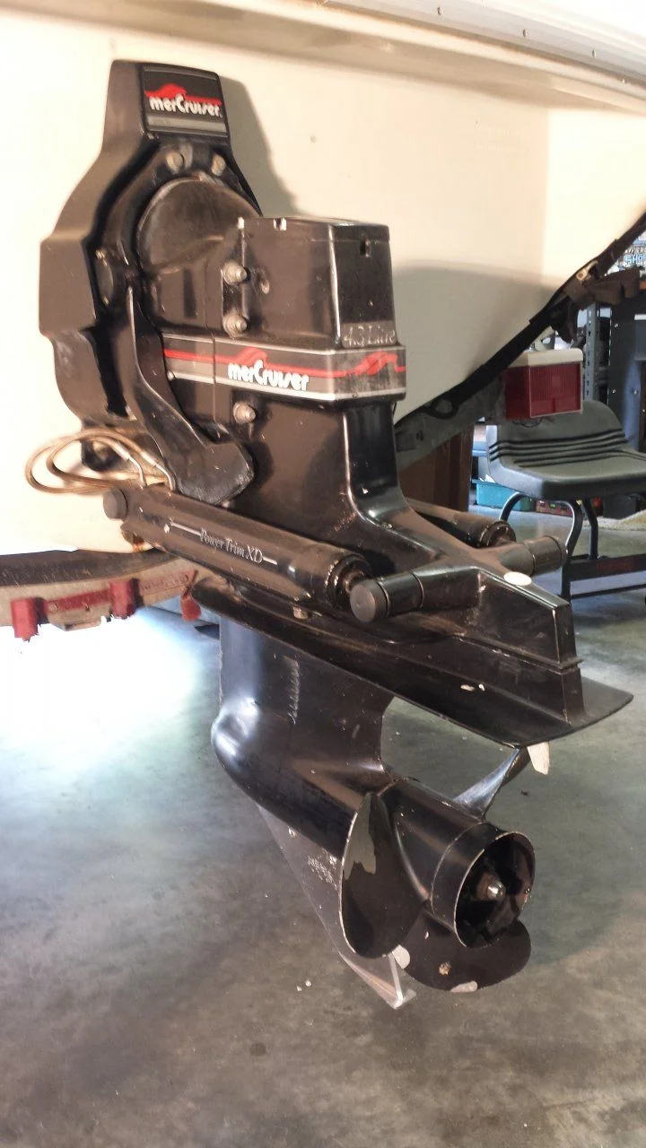

For the gimbal bearing .... pull out shifter cable, remove outdrive bell housing, old bellows, and old trim senders. Then slide hammer the old bearing out and drive the new one in.

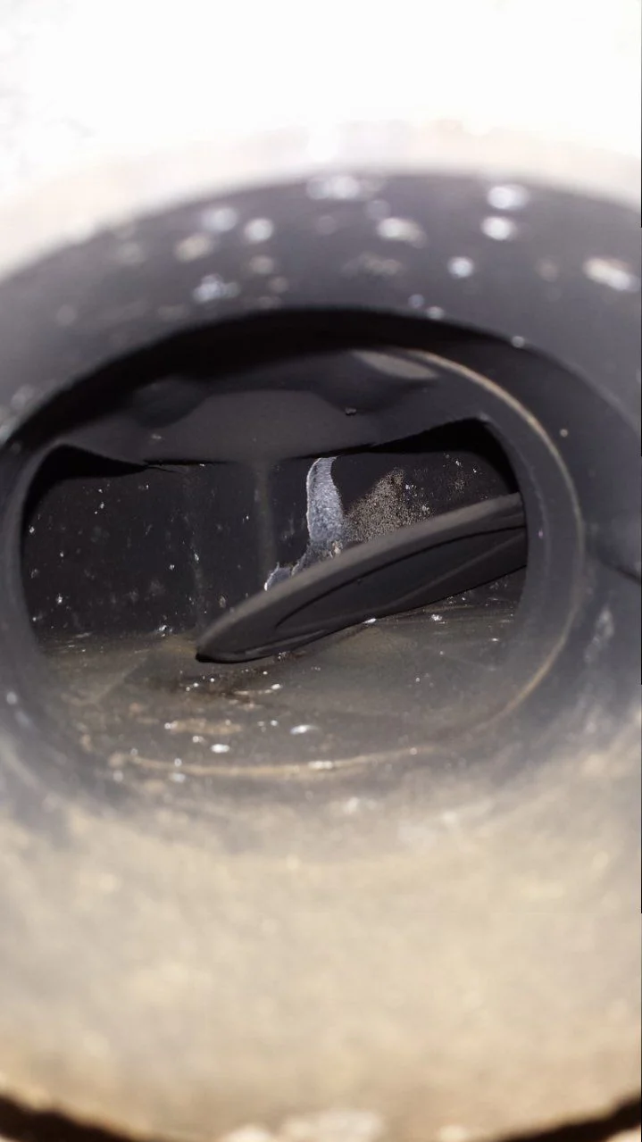

While in there it's a good idea to remove the old exhaust flapper stuck in the exhaust because the previous owner let it overheat which caused the flapper to fail and fall down the exhaust tube. Fortunately it was lodged in such a way there was no real obstruction.

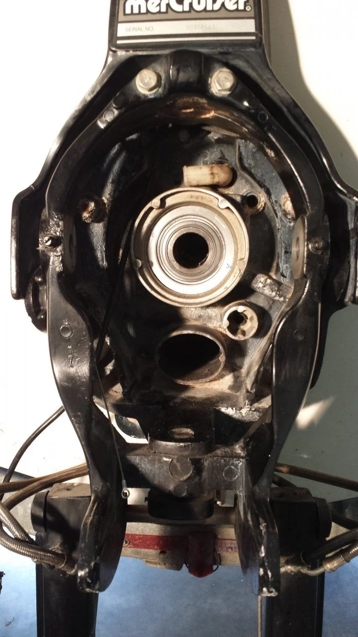

Cleaned up with new gimbal bearing installed. Sent a picture to the wife reporting my progress to which she replied it looked a little "suggestive".

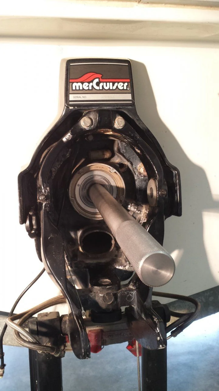

So then I sent her this one of the bearing alignment tool. :D

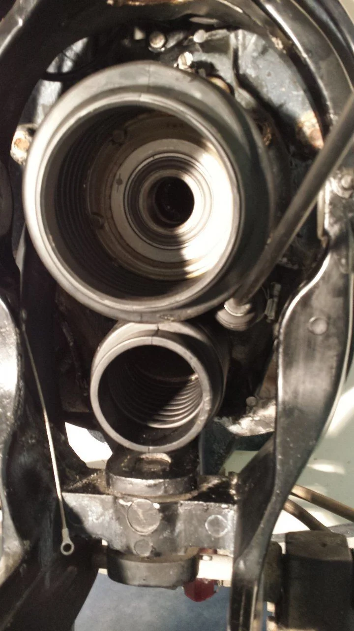

Install new water hose. Then time for new U-joint, exhaust, and shifter bellows. These are the guys that will sink a boat if they crack or rip or, at the very least cause the gimbal bearing to fail.

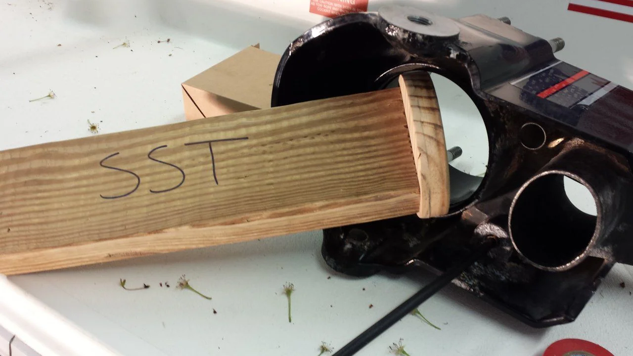

After making use of bellows lock ring insertion SST then it is time to bolt lower unit back up and make it look like it all happened in a cool 2 hour job done over a couple beers. Total time?? More than I wish to confess.
