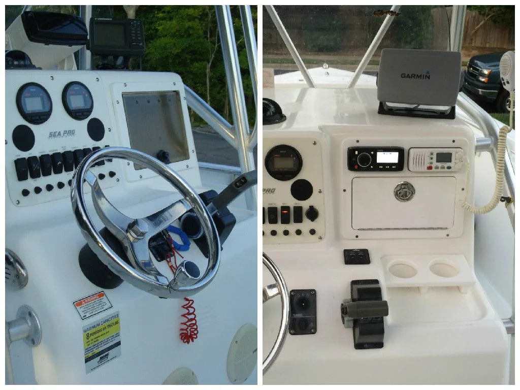

Ahhhhhh, boat projects :D Don't get me started! This was my dash and electronics redux last year:

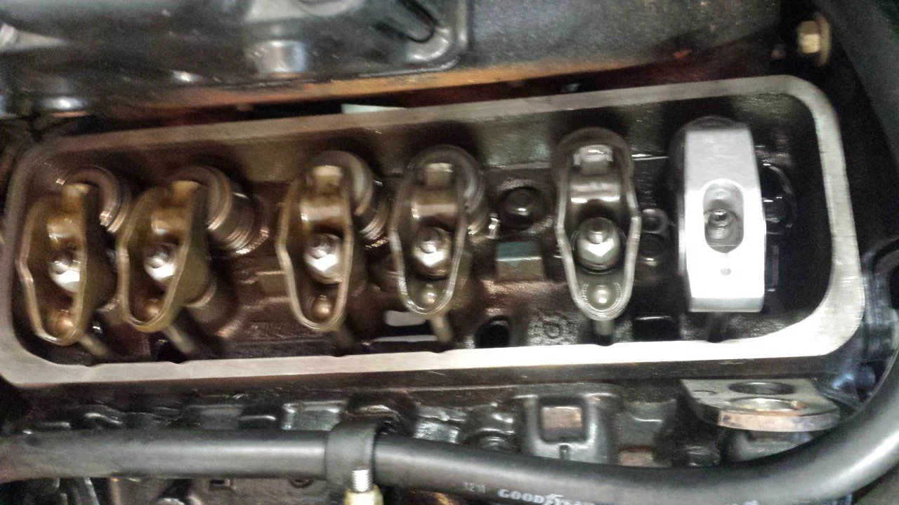

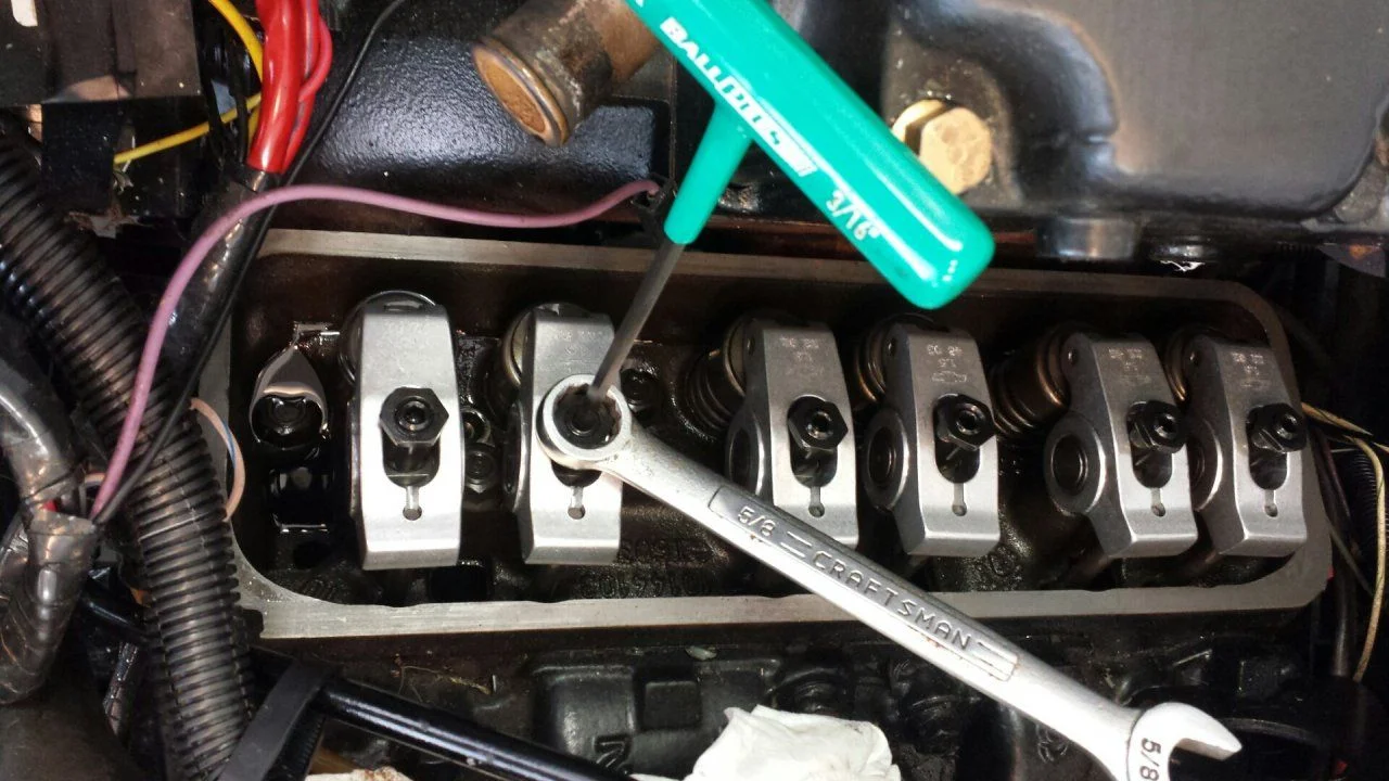

Funny you should mention that. I did just happen to have a few extra horses sitting on the shelf. Bolted up some 1.6:1 full rollers today in place of the stamped 1.5:1 stockers.
Still looking for 4 barrel intake and carb to compliment the now installed "pseudo-cam".

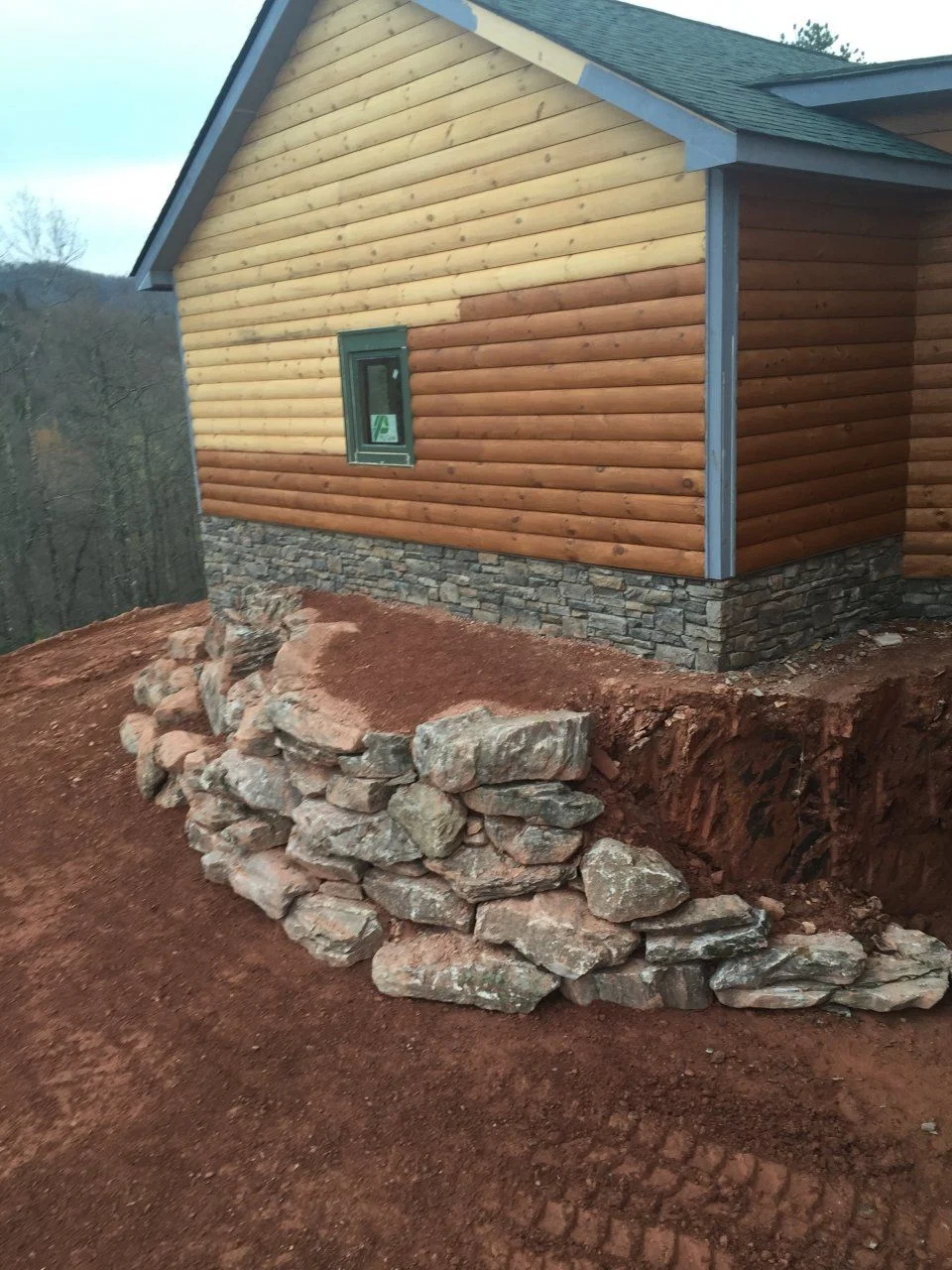

why would you dig around the foundation like that just to add material back? looks sketchy.
It does look strange, hopefully the foundation is pillars going deep into the ground (and not shown) and all we can see in the photo is just the skirt filler, not structural, otherwise a big rain could lower the house about 2 ft....
Backfill is not structural. In fact it is the opposite in this case. The former basement wall was built to both carry the load of the house but also as a retaining wall as well. The basement walls are built with both sides clear and then back filled. My guess is that the owners wanted it dug down so they would have some sort of a yard when complete.
Some hoity toity designer had grand visions of sunken and secluded stone patio with disappearing waterfall for ambiance :lol:
That and I brought my crawler to work this week haha
That ground level shown at foundation is 26' below virgin grade and the poured footings are 6' deep with a 6' step down for that part of house even though a slab
And Stan is on it too.... Trying to create flat ground on the side of a Mtn

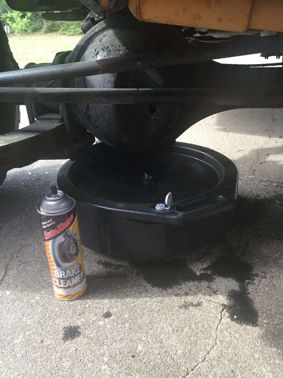

Okay, besides the FJ40 art that my vehicle has betrothed to the driveway... Which my wife will be ecstatic about... What's wrong with this picture?
If you guessed the straw is missing from the spray can, you're correct! It's inside the differential now. Yes. I know.
Okay, seems like the gears would chew it up and be done, but I'm sure it will need to be removed... So. Can I drive it to @dbenke 's house? Should I disconnect the driveshaft? Can I just refill it and forget it? I can't see or feel it...
you can drive it,as long as it not in 4wd the front axle wont turn.not sure how we want to approach this.
front has no diff cover, so the third would have to come out, axles have to come out, etc.
we have alot of work already scheduled, we might have to work late.

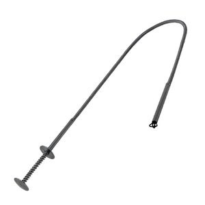

Go pick up one of THESE at your local auto parts stores ($5.99 at Auto Zone). With it, a flashlight and some patience you should be able to get it out of the drain plug.
Okay, cool. It has no fluid in it, but as long as the differential isn't turning, shouldn't be a big deal. I will leave it in 2wd and hubs unlocked. If we run out of time before we need to move on with someone else's car, we will save the front axle for another day.
Thanks, David! Yeah, I have one, but if it's possible, it will require a better fisherman than me... I tried fishing it out but I don't think the tool ever grabbed hold of it.
