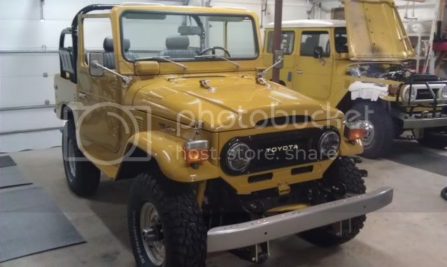

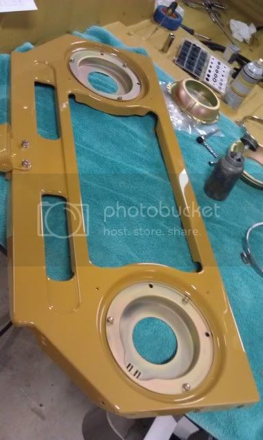

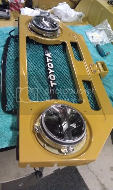

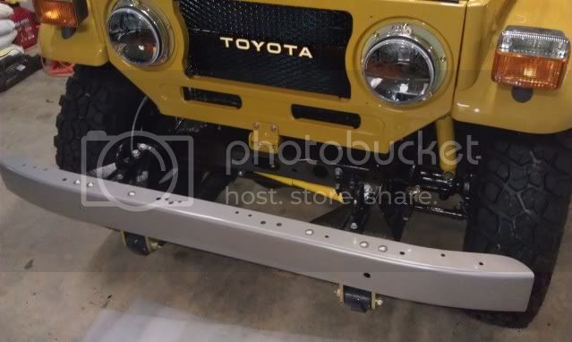

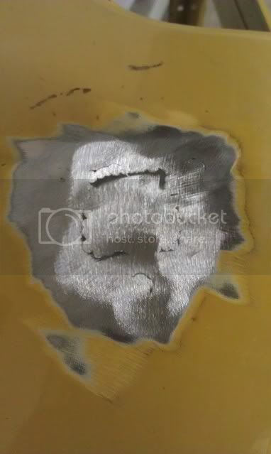

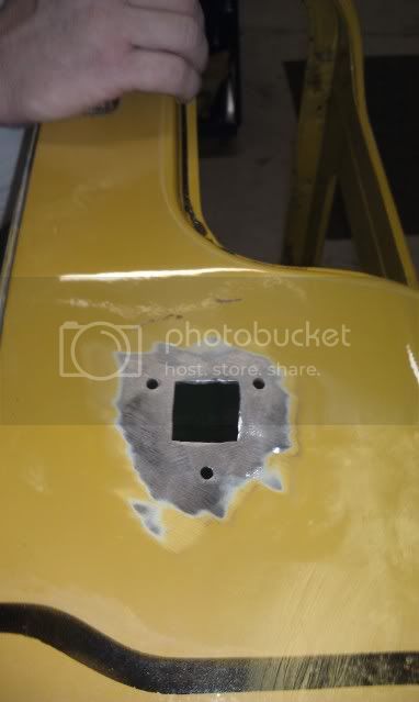

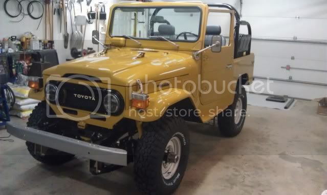

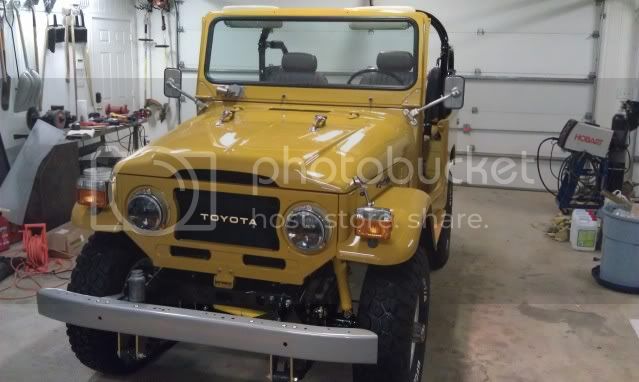

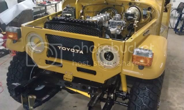

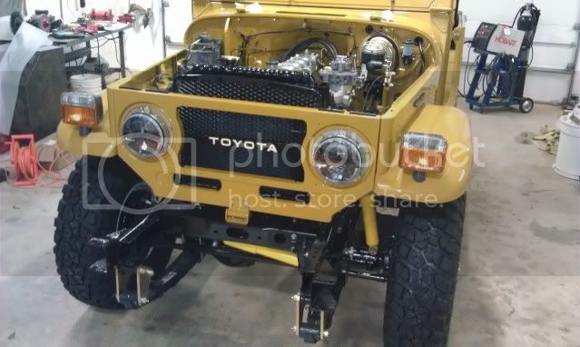

Zinc plated headlight buckets powder coated grill, hood latch, new Toyota emblem and hood rubber. Led headlights. New Toyota bumper.

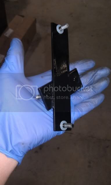

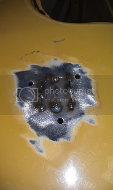

Installed rivnuts into headlight buckets for the beam adjustmentbecause we couldn't seem to get the plastic clips from Toyota.

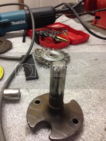

I hear you on the headlight adjustors, I finally found some that was close, I would have to look it up were I got them, sold a few on ebay for next to nothing and kept a few for my rig here is a pick of them

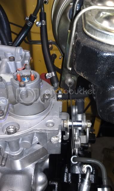

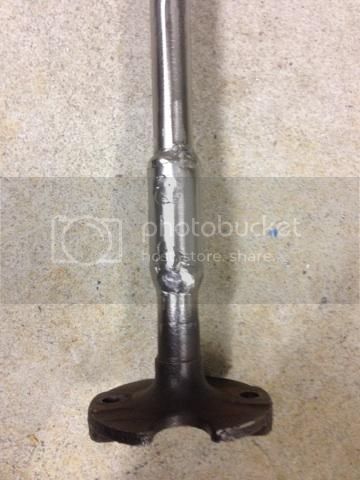

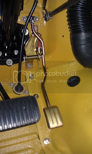

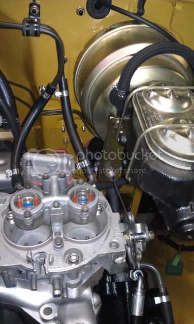

throttle pedal modified for the fuel injection and replated
made new hard fuel feed and return lines from the tank across the firewall to the throttle body

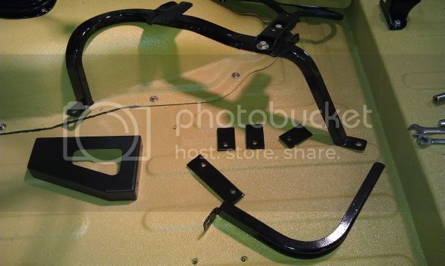

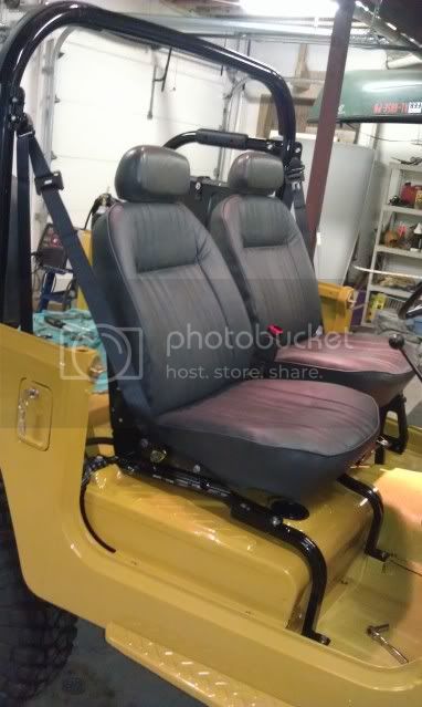

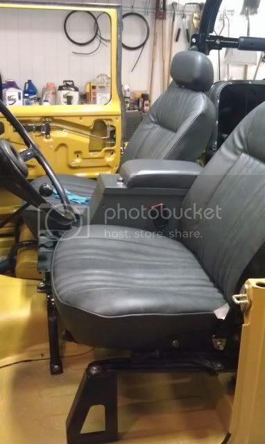

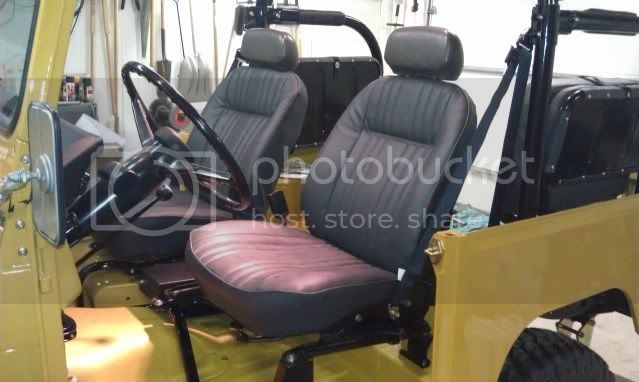

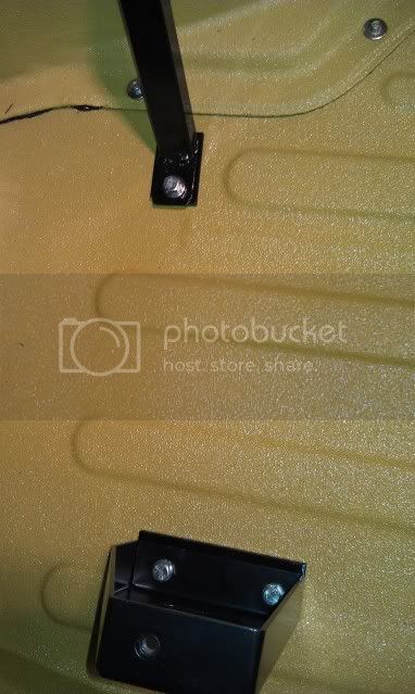

driver seat extension kit from metric tlc and powder coated seat brackets. i made 1/4'' shims for the fronts to lean the seats back slightly

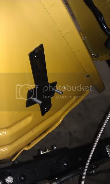

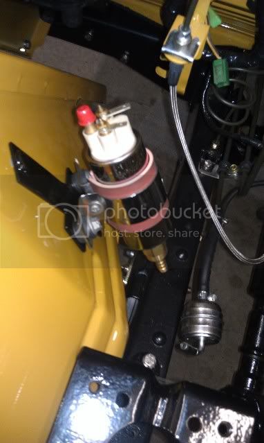

made the bracket to mount the fuel pump on the passenger fender. it uses existing pick up points so i didnt have to drill any holes.
seats are in!

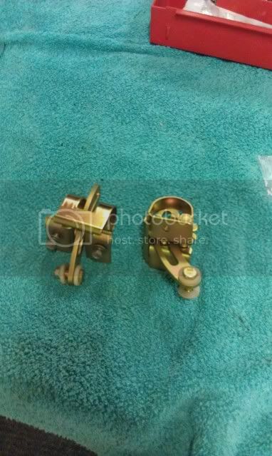

replated limiters

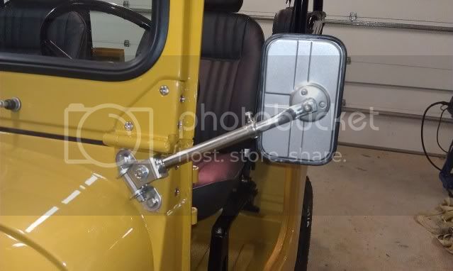

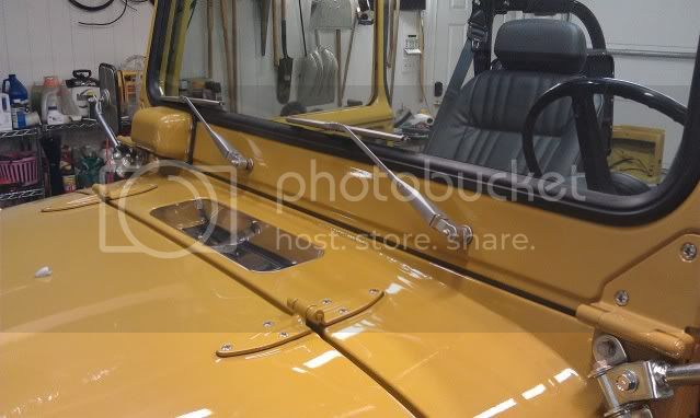

opted to go with windshield hinge mounted mirrors instead of the door mounted mirrors

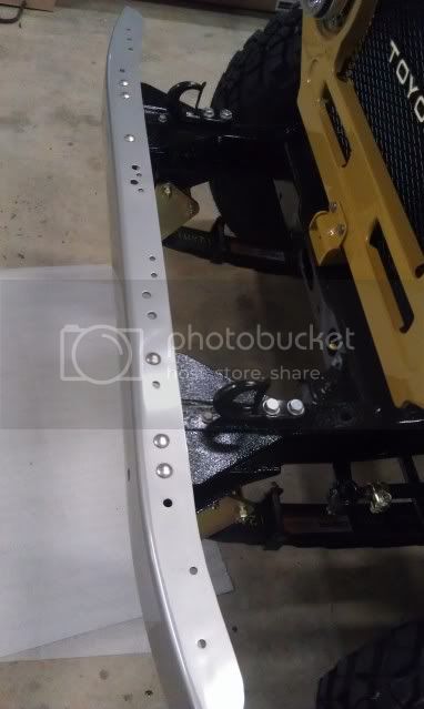

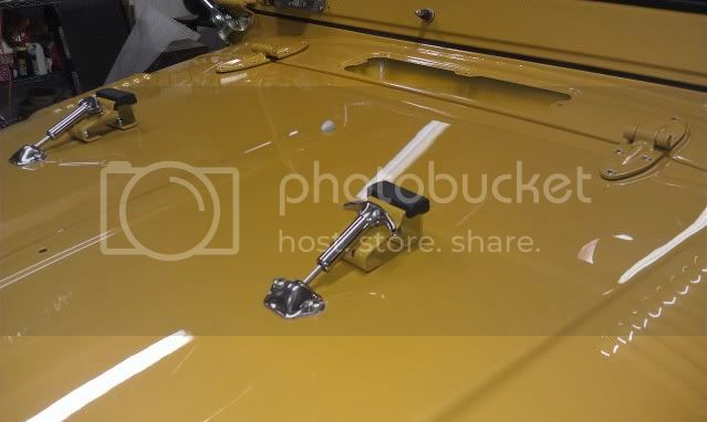

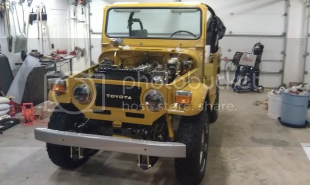

stainless hood hardware on. and new toyota wind shield bumpers

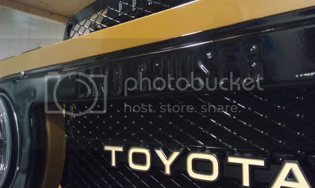

headlight bezel will be WHITE but went a head and powder coated it for a good base coat. Stamped "land cruiser" :)

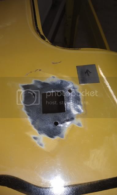

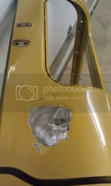

previous owner at some point had a cb antennae. patched it up

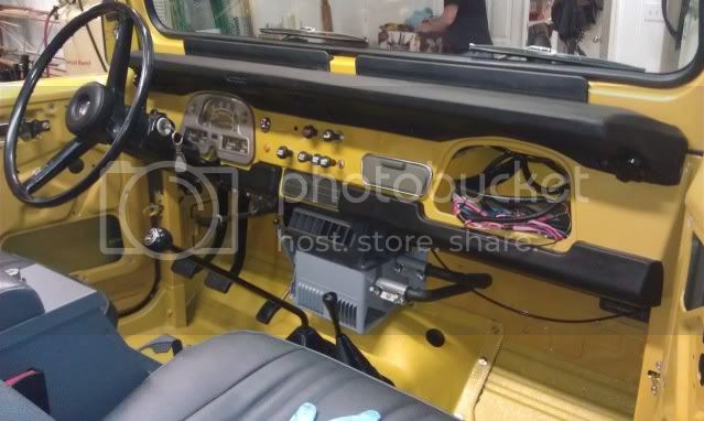

new lower dash pads from spector. new dash pad from fj goober (here on mud) heater hose support brackets powder coated pewter.
stainless cowl vent block off. since these arent operational on a 75 we just blocked it off so it wouldnt gather debris. wipers on with new toyota blades and wiper motor cover on as well
tuffy console installed

Is a heat exchanger not required for the mini truck p/s cooler?
not sure what you mean exactly. This truck has factory 40 power steering and not a mini truck box. i did make an oem style cooler by bending 3/8 line and mounting it on the frame in front of the radiator.
