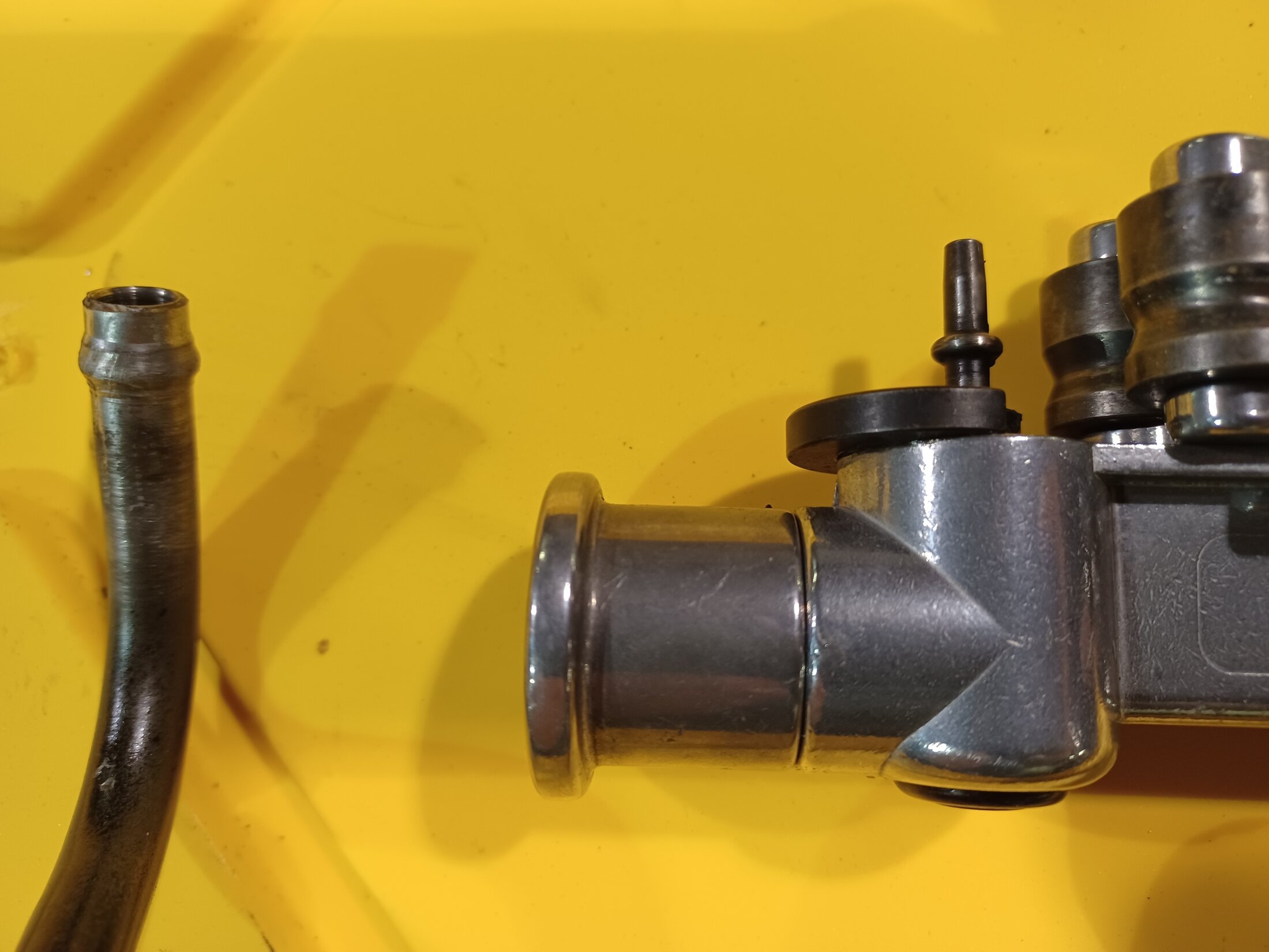

I picked up a tubing beader for small ID tubes. It came with three dies (3/8", 1/2" and 5/8"). I have only had the opportunity to bead some 3/8" steel tubing so far. I found it easy to use and the results are what I needed when I ordered this beader.
Close up of an example bead and the 3/8" die.

Very capable tool, but I have to admit feeling rather foolish in buying it.
~$250 for a beader that I will probably have limited use for.
To help with this consideration, I have made sure that my local friends with nice shops know that I have this beader for small diameter tubing. My hope is that they will be borrowing it for their occasional projects, so it will be money reasonably well spent.

Wish they made one for 5/16 line. We have been using a bubble flare brake line tool.
Understand. I made some test specimens using my brake flaring tool. Then test installed the specimens with 3/8 inch hose and clamps. I found the resulting connections difficult to work with and marginal overall, so I was concerned I would have issues later. Purchasing the beading tool was the step I needed to make.
Good luck with your 5/16 line applications.
I went back and checked. There is a model with dies for 1/4 and 5/16 tubes available.

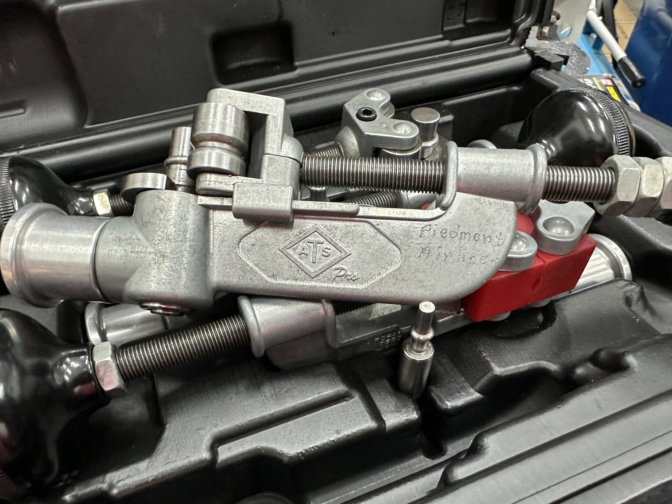

I purchased a similar kit years ago. It was used but in almost perfect shape…had been in service at Piedmont Airlines.
