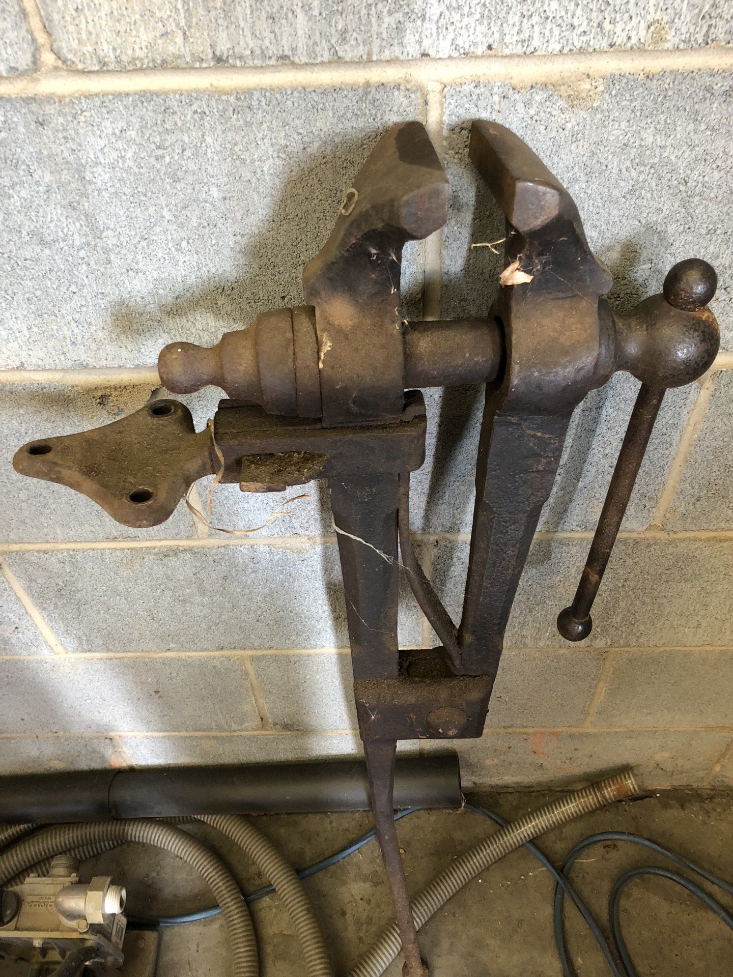

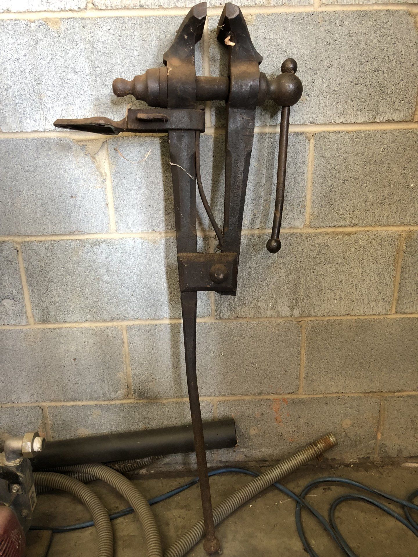

so do you bury the post in the ground or mount it to a plate or something?
Plate gets mounted to a workbench and the post sits on the hard floor of the shop. IIRC, that post is bent and should be straightened before hard use.
Absolutely right Johnny. Mounts to a bench then the leg goes to the ground but the leg should be on a block of wood instead of concrete in order to absorb some of the shock instead of sending it right back up through the vice. Supposedly these things have unreal clamping force and will take a beating that would eventually destroy a normal bench top vise.

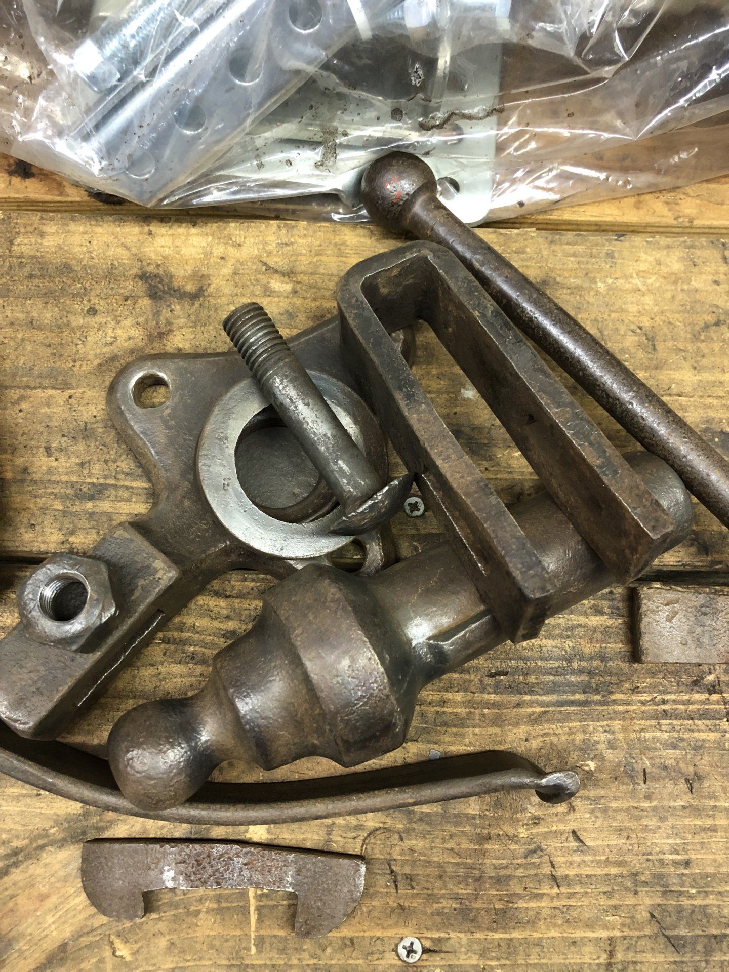

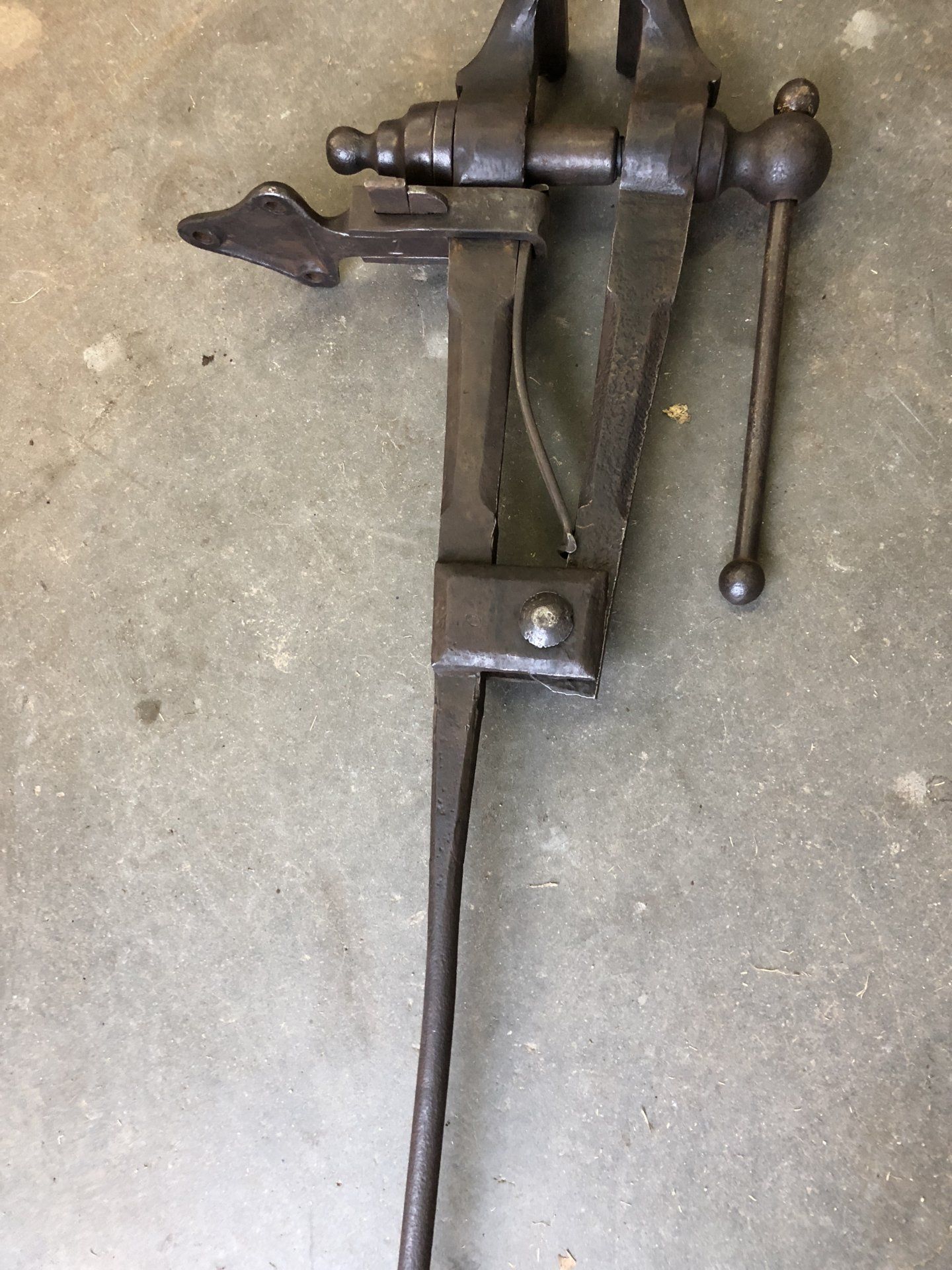

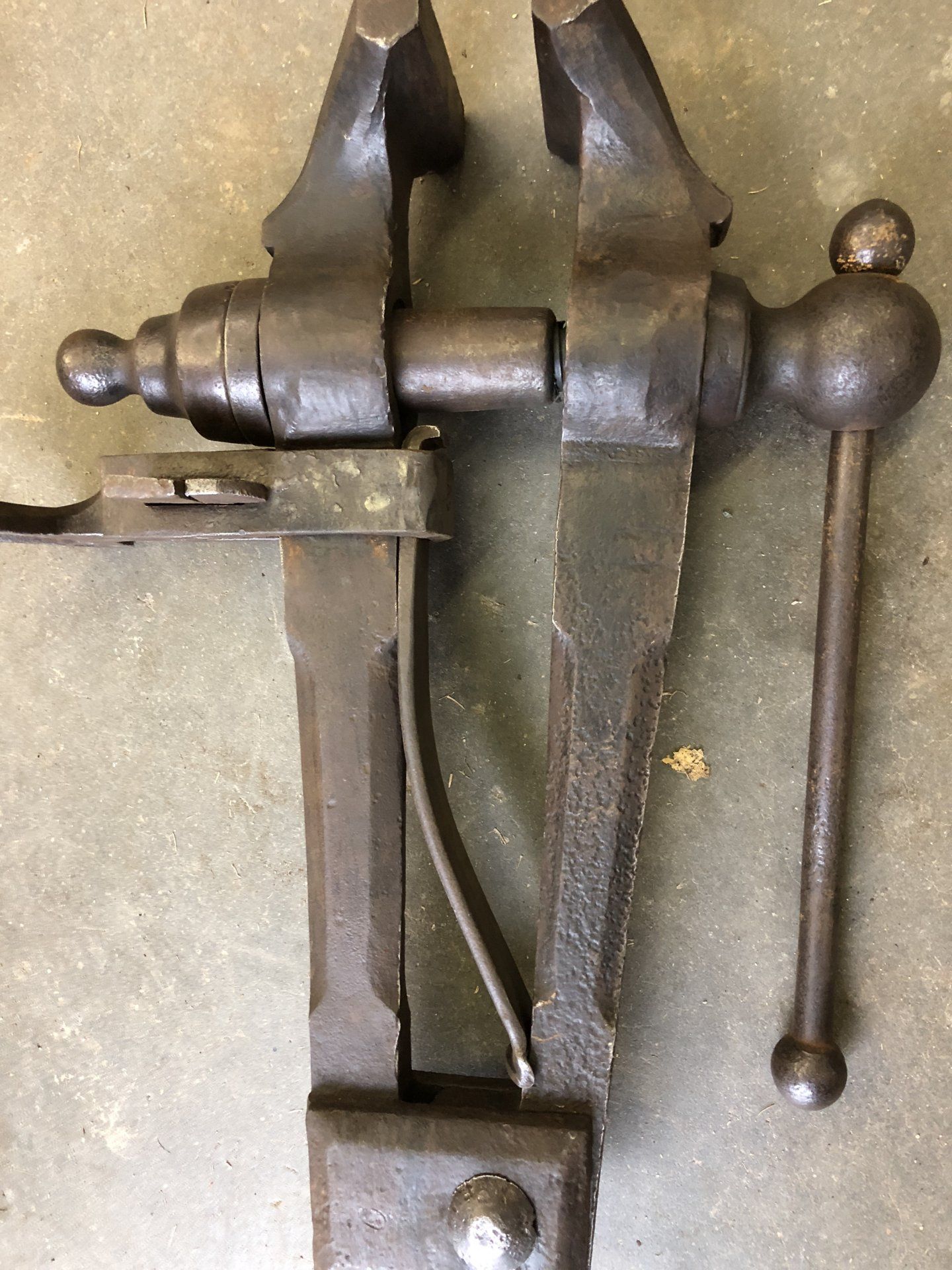

So it was a rainy day today and I decided to clean up the old post vice. Not a big project but a fun one. I didn’t want to clean it down to like new metal and paint it, just full disassemble, a quick going over with a wire wheel and a light coat of oil. Can’t wait to put it in the garage if we ever finish with this gous build LOL
Couple more
