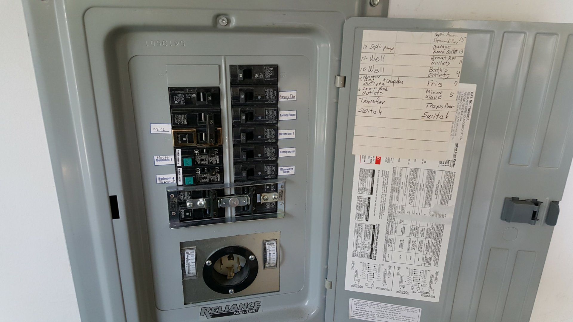

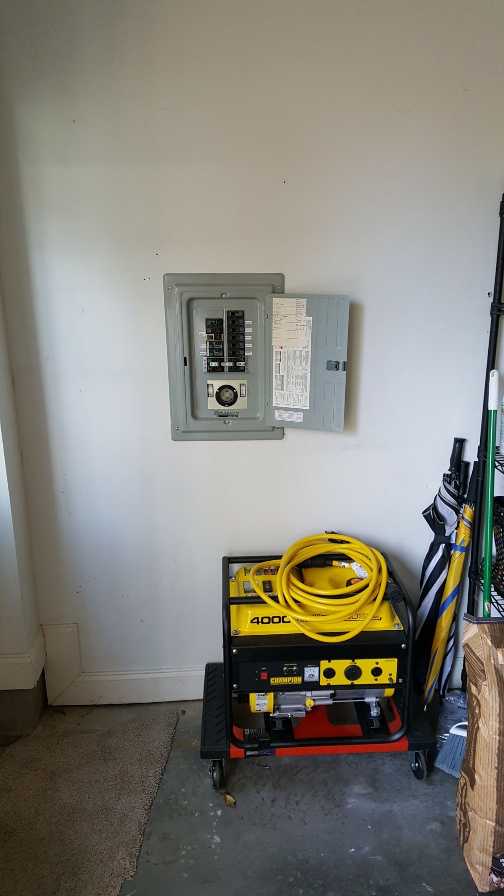

All great points.
I have two panels - both basically split the house in two and are used all the time in normal mode.
One is in the garage and is also for Generator IN with critical circuits that use the generator when power is off. I throw the bottom transfer switch and this isolates my house from the power company and then the circuits above are run by the generator.
I was thinking I would install another 220V below this panel for a welder, etc. Wondering now if maybe I could this outlet as 220 OUT when not in back up mode? For all I know it may be HOT now. . . . .

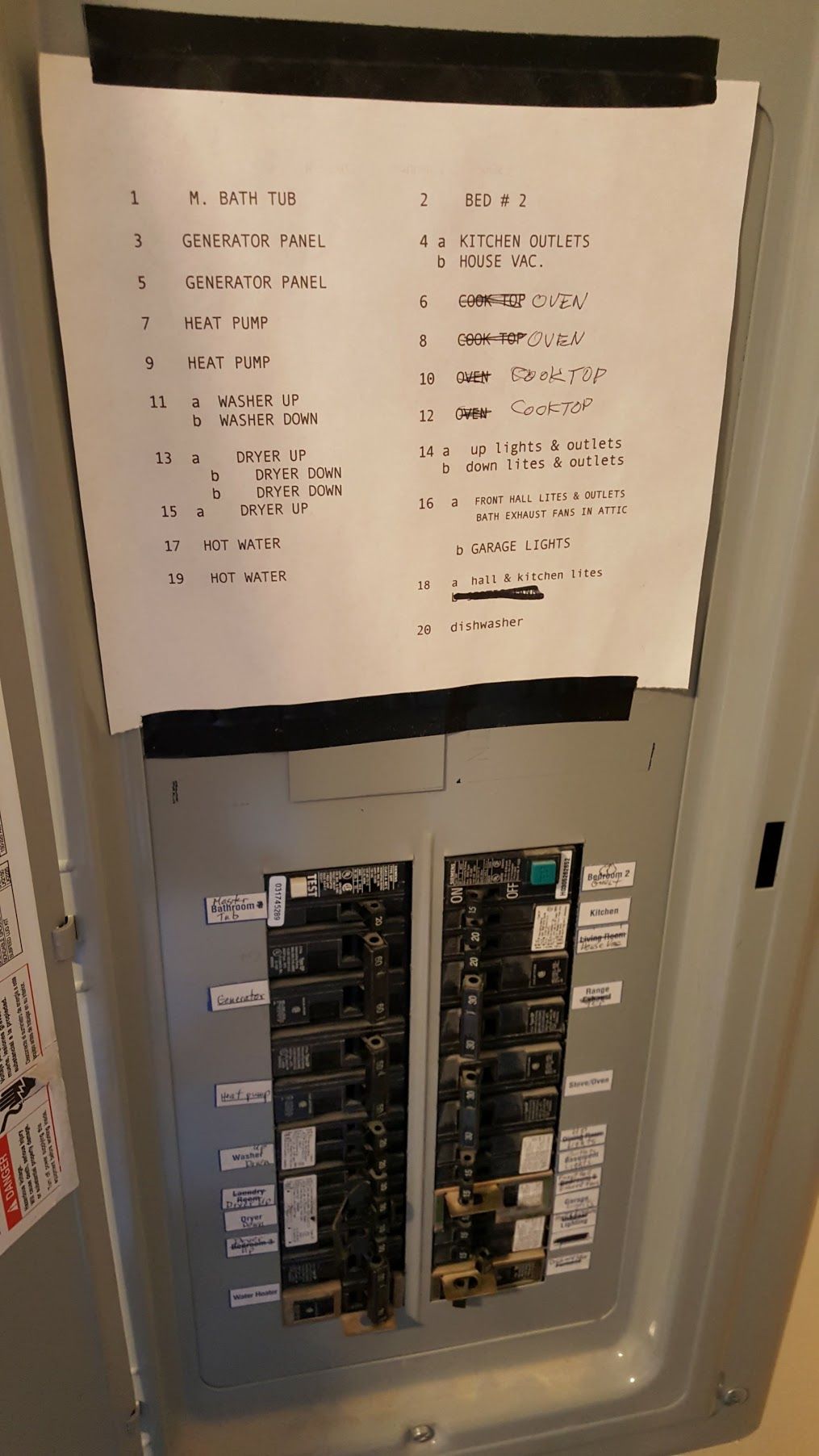

And the rest are in my laundry room. I think we discussed using that 220 for the welder too :) Forgot till now.

Yours is the smart and by code way of getting GEN power into the house. Your lockout switch that connects to GEN power and pulls you off the grid means that, no, it is not hot if you are on the grid. (Code would never allow for a plug with a male end to be hot).
