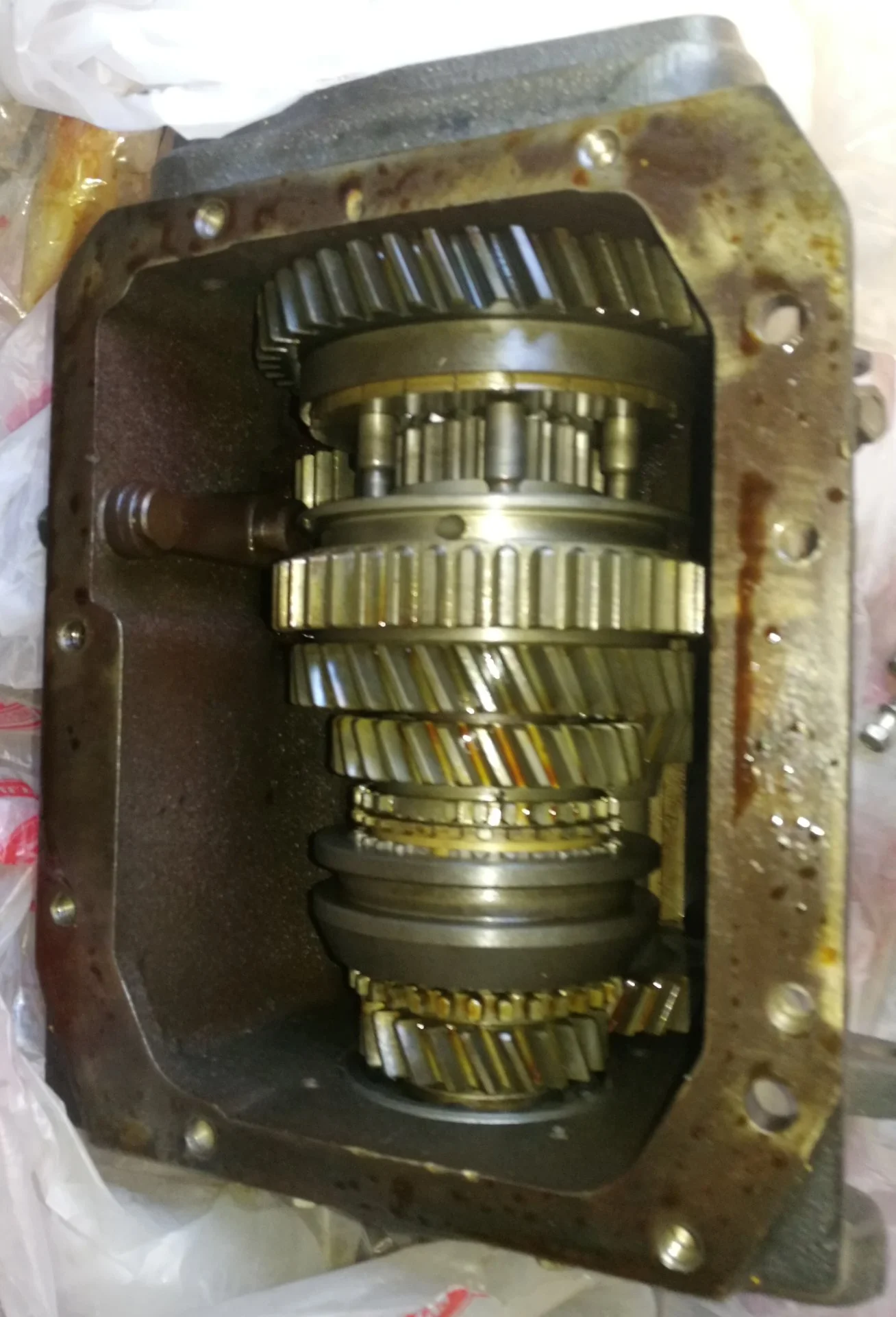

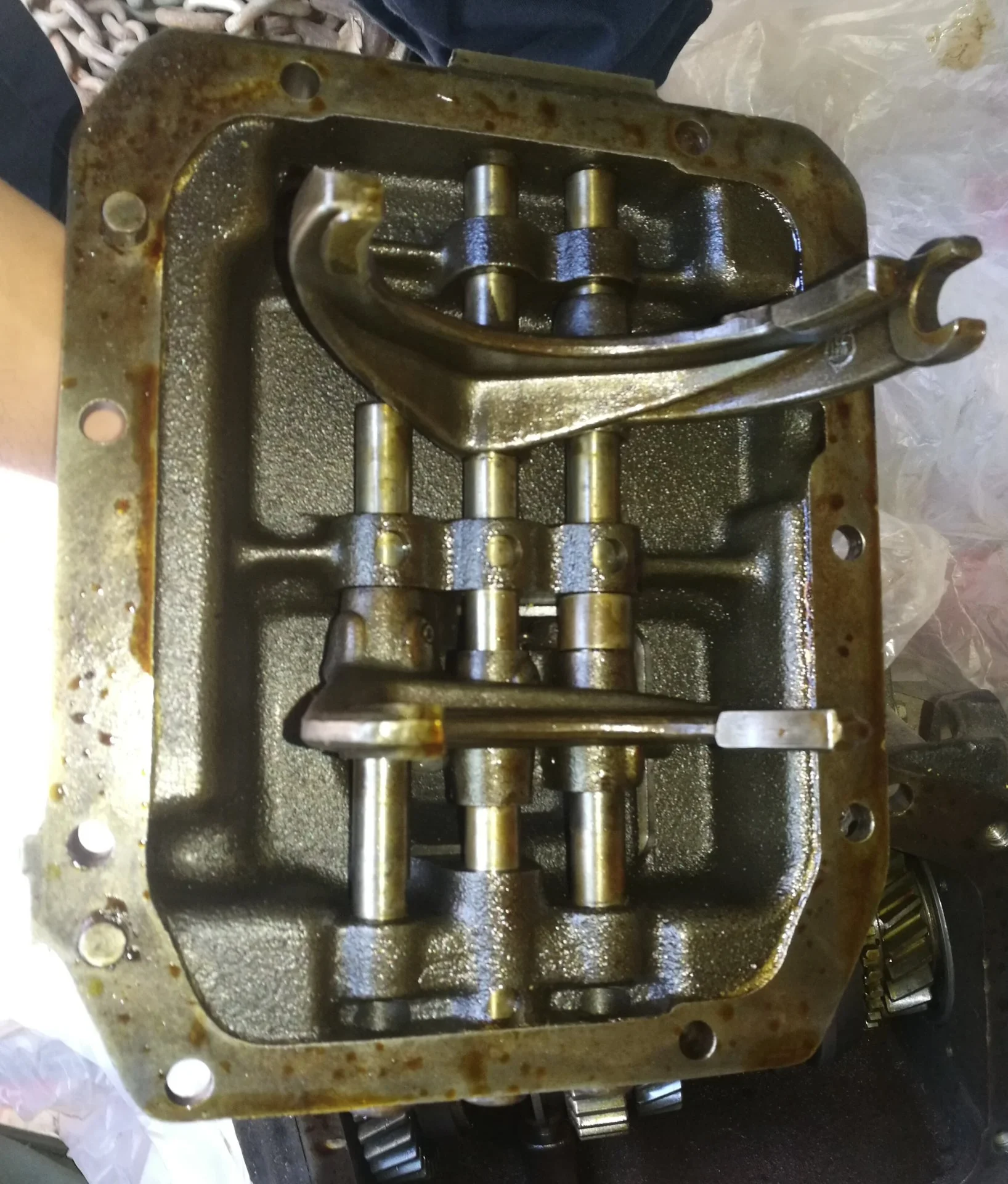

I'm asking because my 4-speed is an early h-41 and the tranmsion cover is a 1-piece slab of steel with only a single hole large enough to allow the floor shifter cane to fit through. In the pictures provided earlier in this thread, it shows a later style 4-speed transmission that comes apart in 2 pieces and you can remove the top-plate and attach the "4 on the tree adapter".
I can provide a picture later on how my transmission top-plate is. Otherwise, I might need to source out a later 4-speed top-plate to attach on my h41 and then use your "four on the tree adapter".

The inside of your cover is different too. None of the forks match. I rebuilt one of those for @mrtodds77 in Simi Valley last year, and while I didn’t take pics, I remember it was VERY different.

So perhaps even if I were to get a later style 4-speed transmission cover that comes in 2-pieces, the forks might not even line up, since the internals of the transmission might be slightly diffrent and render the h41 useless with a later cover.
The only noticeable difference I noted when looking at the internals of the transmission is the early h41 transmission "hub sleeve" is substantially wider than one for an h42. Other than that, they look the same. This is of course with me comparing photos on the internet.

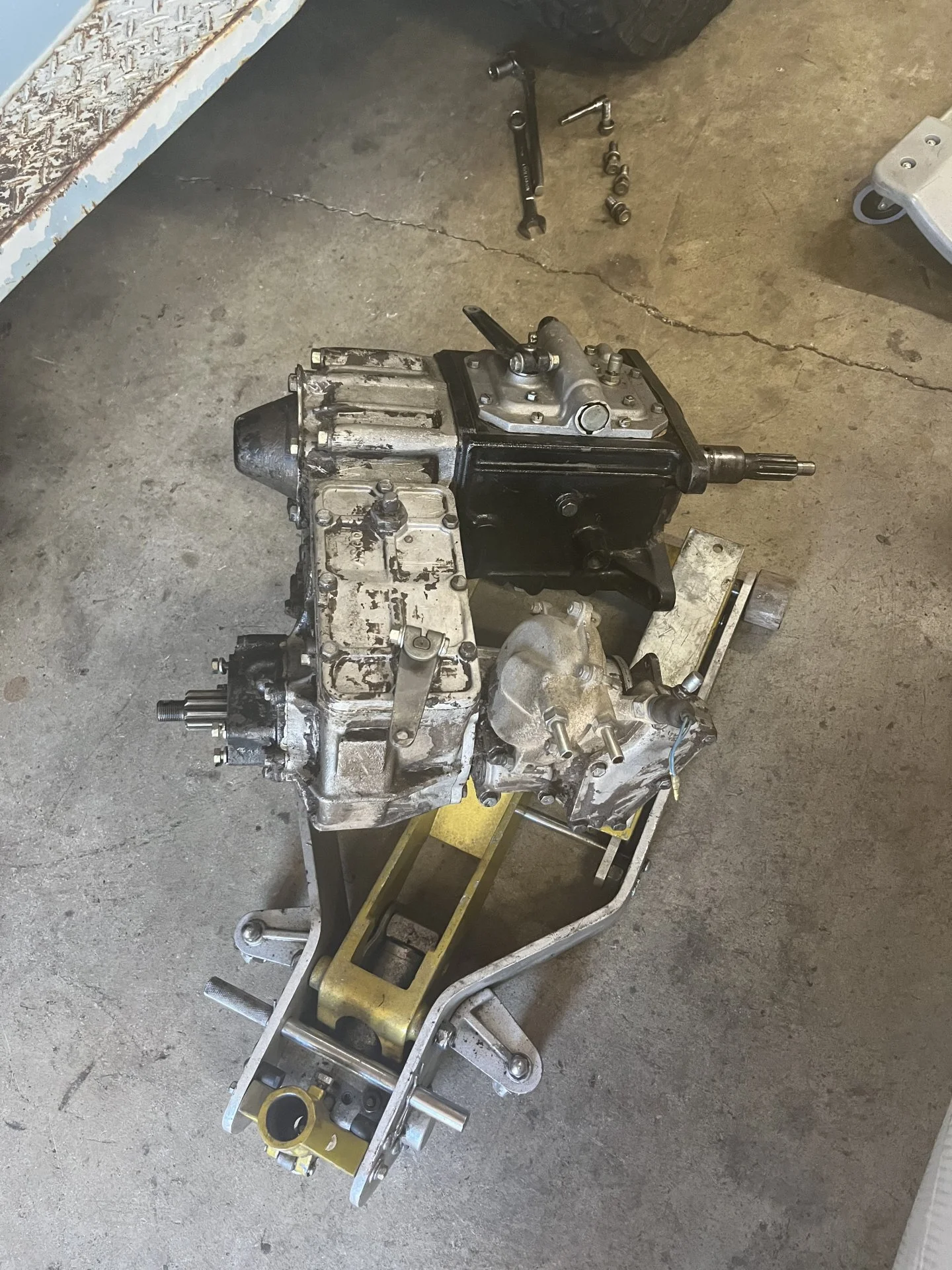

Been a few days now but the adapter is in my hands. I finished rebuilding my 4 speed today and test fit the adapter. Hoping I’ll get time Wednesday or Thursday to pull the 3 speed and install the 4 speed with no t-case to start checking fit of everything.
Wow, the time got away from me.

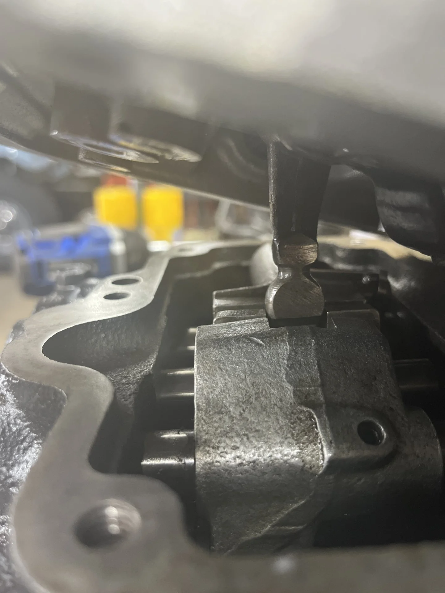

3 speed is out, shifter is mounted on 4 speed and can go through the gears easily. The 1-2 shift gate is a little tight for the larger shift pawl of the 3 speed but I think it will be fine. Maybe a slight beveling on the leading edges may be needed for easier shifts, we shall see; I haven’t compared it to the 4 speed part yet to see if there is actually a difference. The 4 speed bellhousing is mounted on the 1F. More to come later this week.

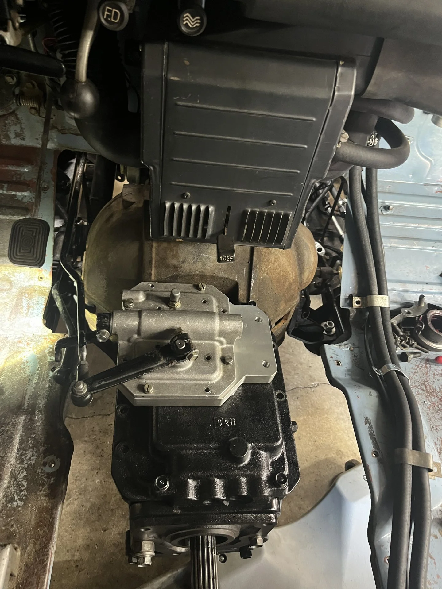

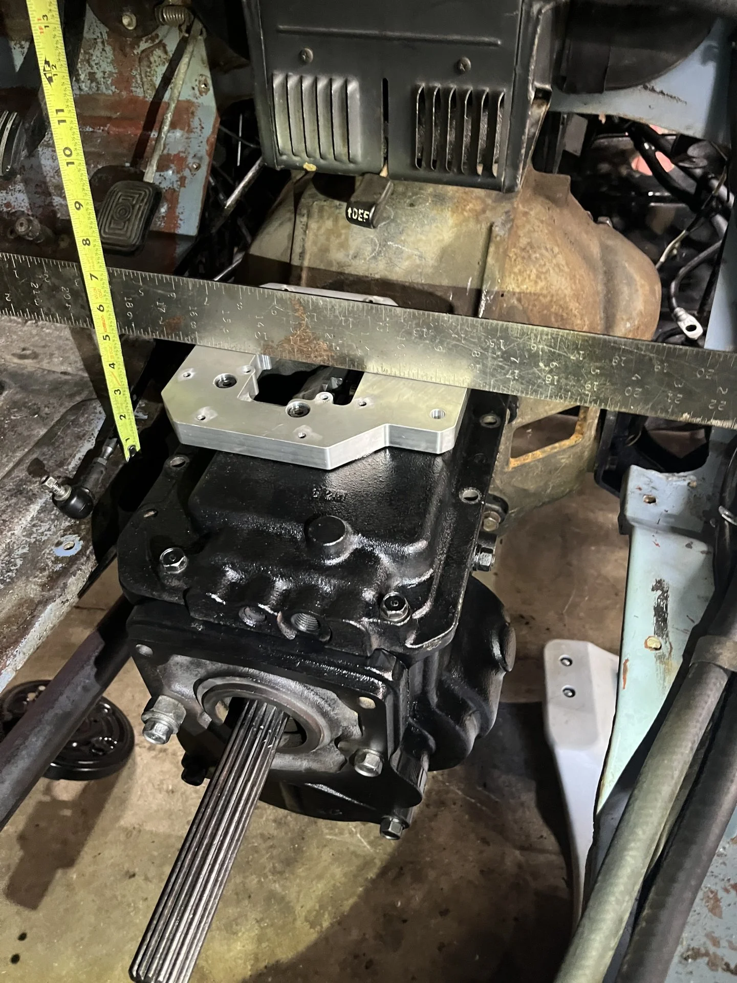

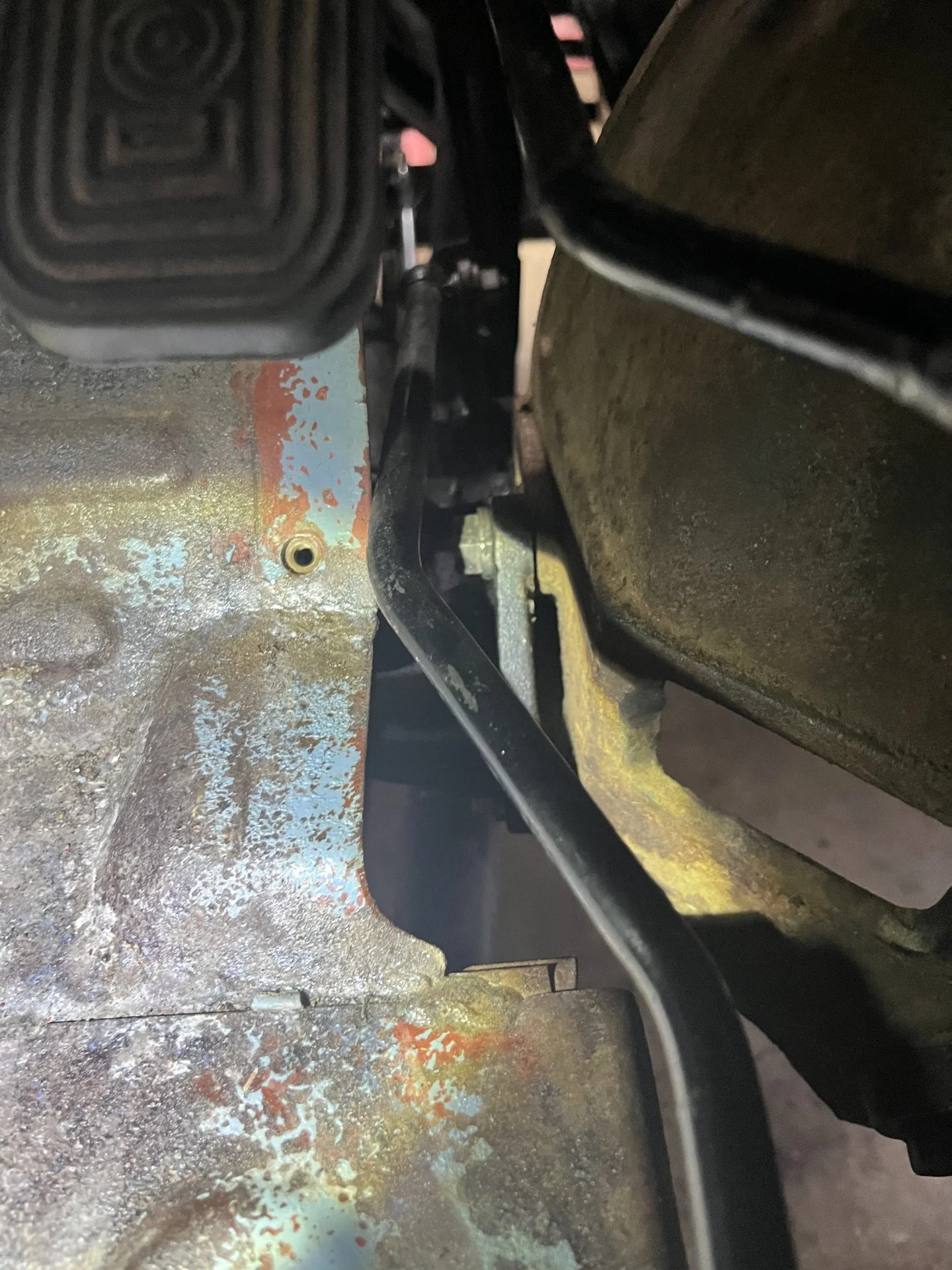

I had some time before work tonight so I was able to get the seat, tank and tunnel pulled and the 4 speed bolted in with no t-case yet. Just checking fit, clearances and linkages for now. This will all be coming back out to clean and paint the bell and install the clutch and t-case.

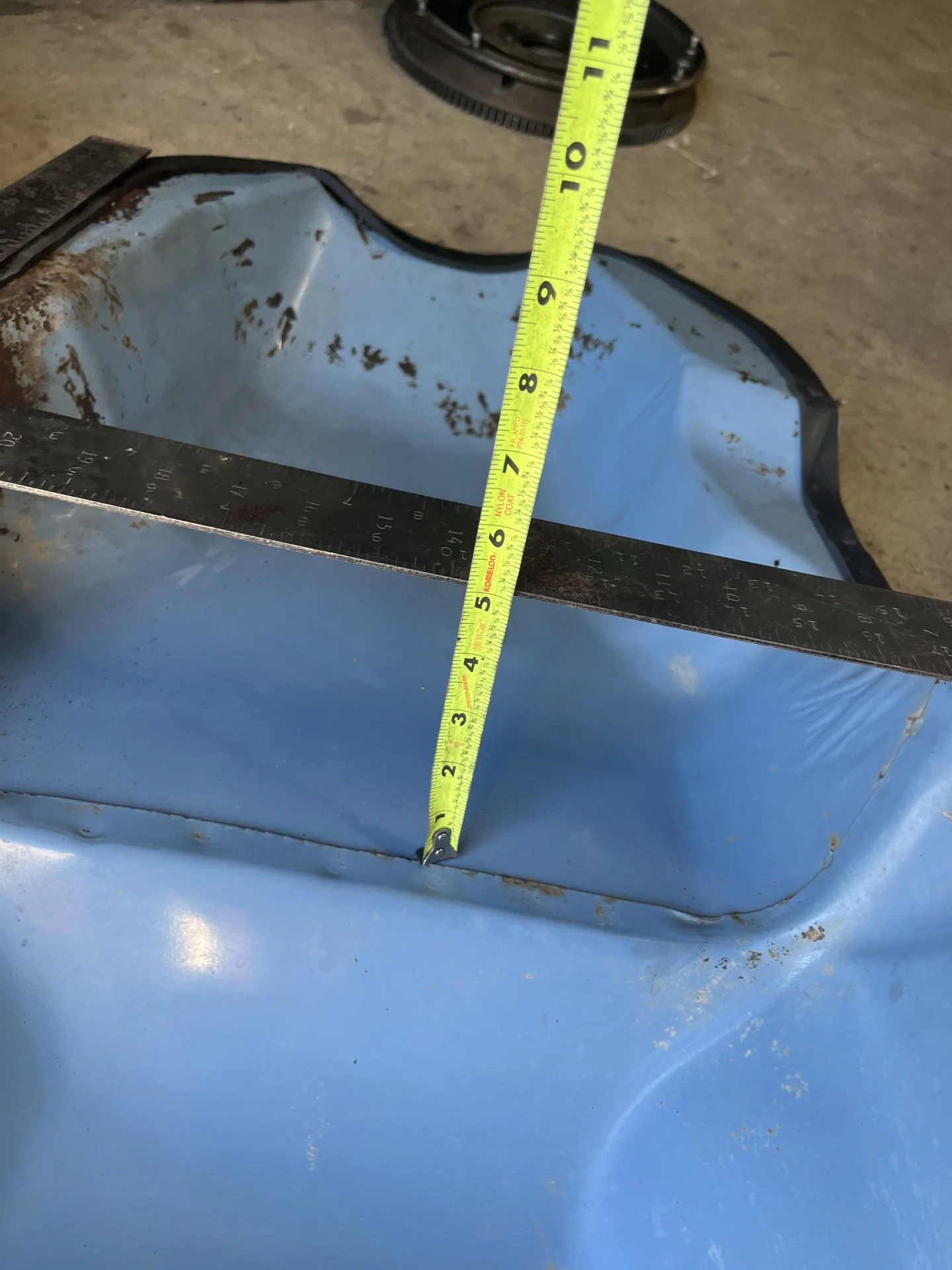

So the meat and potatoes. The overall height of the whole assembly with 4 speed is about 2-3/8” taller than the 3 speed. The tunnel has to come up 2” at minimum. 2” leaves 1/2” or so of clearance between tunnel and shifter assembly which seems sufficient.

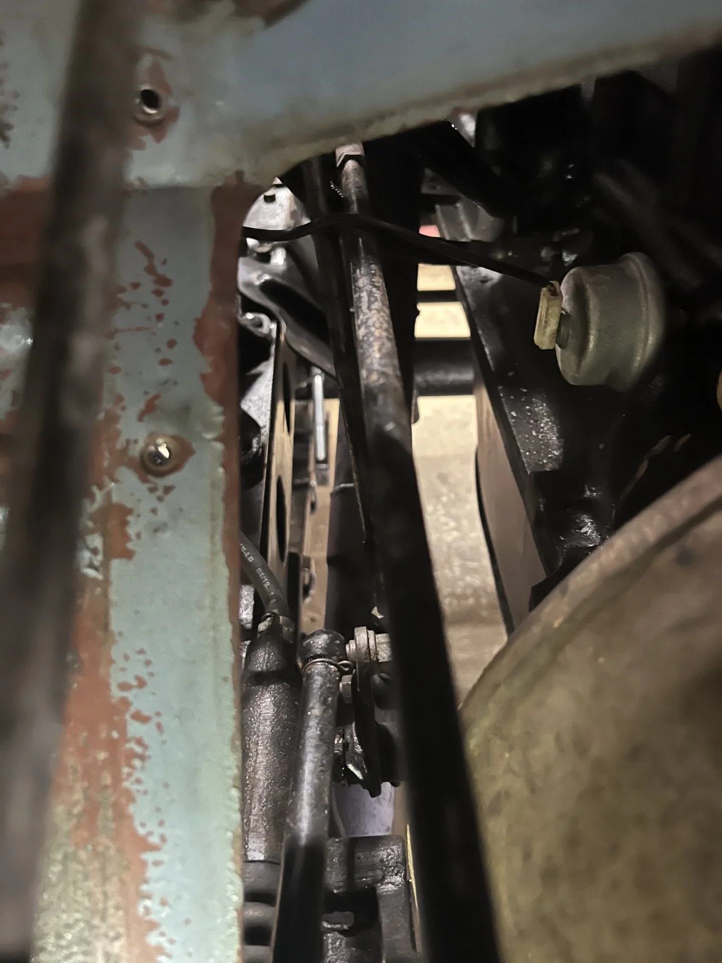

The linkage rod to the shift arm out of the top (gate selector arm) looks like it will be fine with no modifications. The linkage rod from column to gear selector pivot (hard to see in pic but it’s the vertical rod in front of firewall) will need a slight dogleg to clear the gate linkage rod. The linkage rod that attaches to the arm for gear selection on trans needs the stud turned around 180* and I think it will work. Going to make some temp rods to see before modifying mine.
