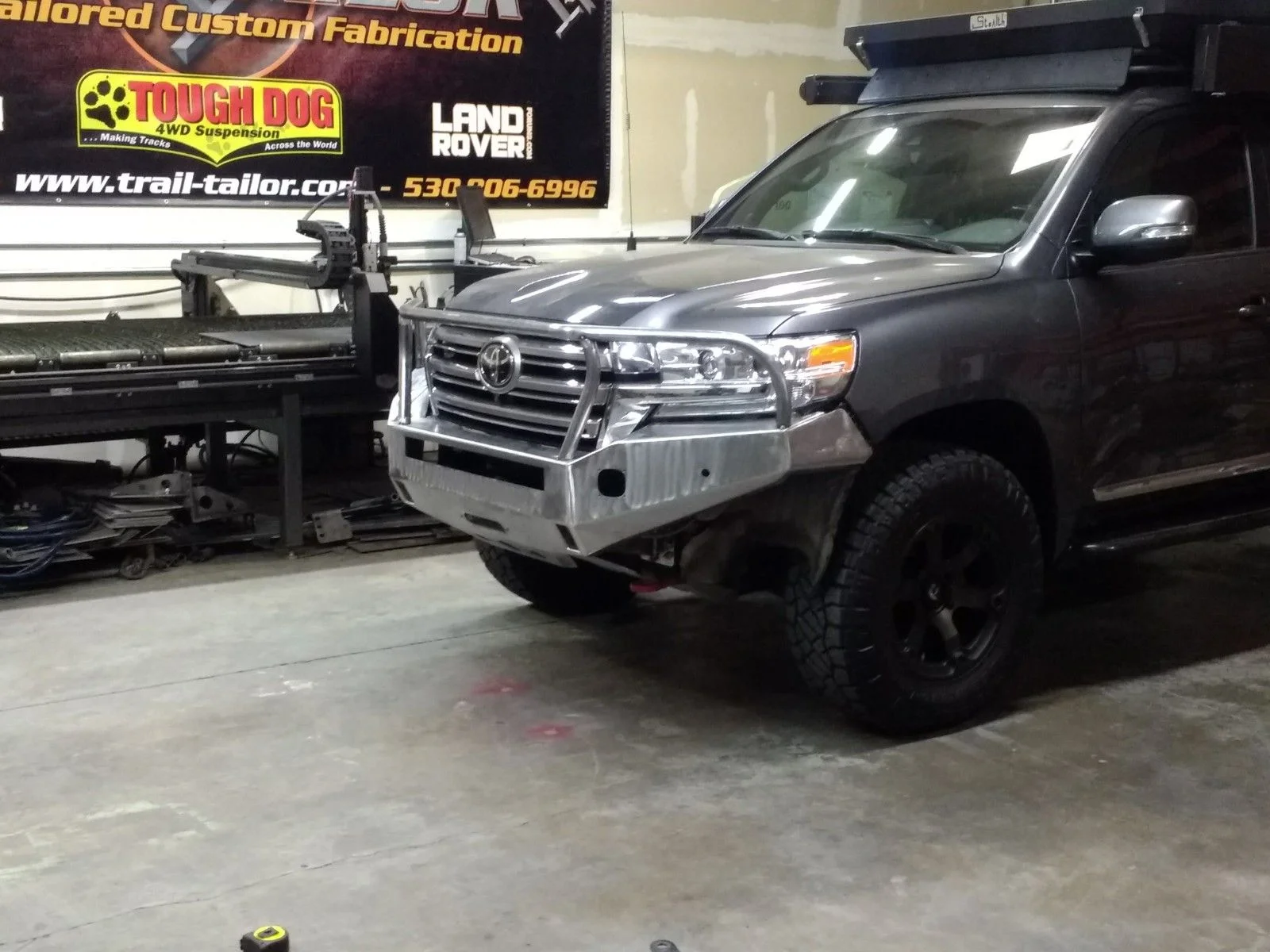

Someone asked for a distance side shot of the Gen 2 bumper. If my math is correct it is 1.625" further out than the stock bumper. I could have made it the same as the OEM dims but with a couple of guys wanting a bull bar.... I had to get some depth to add the bars.
All orders are cut, bent, tacked and /or welded out in various stages currently. Busy morning on the table.

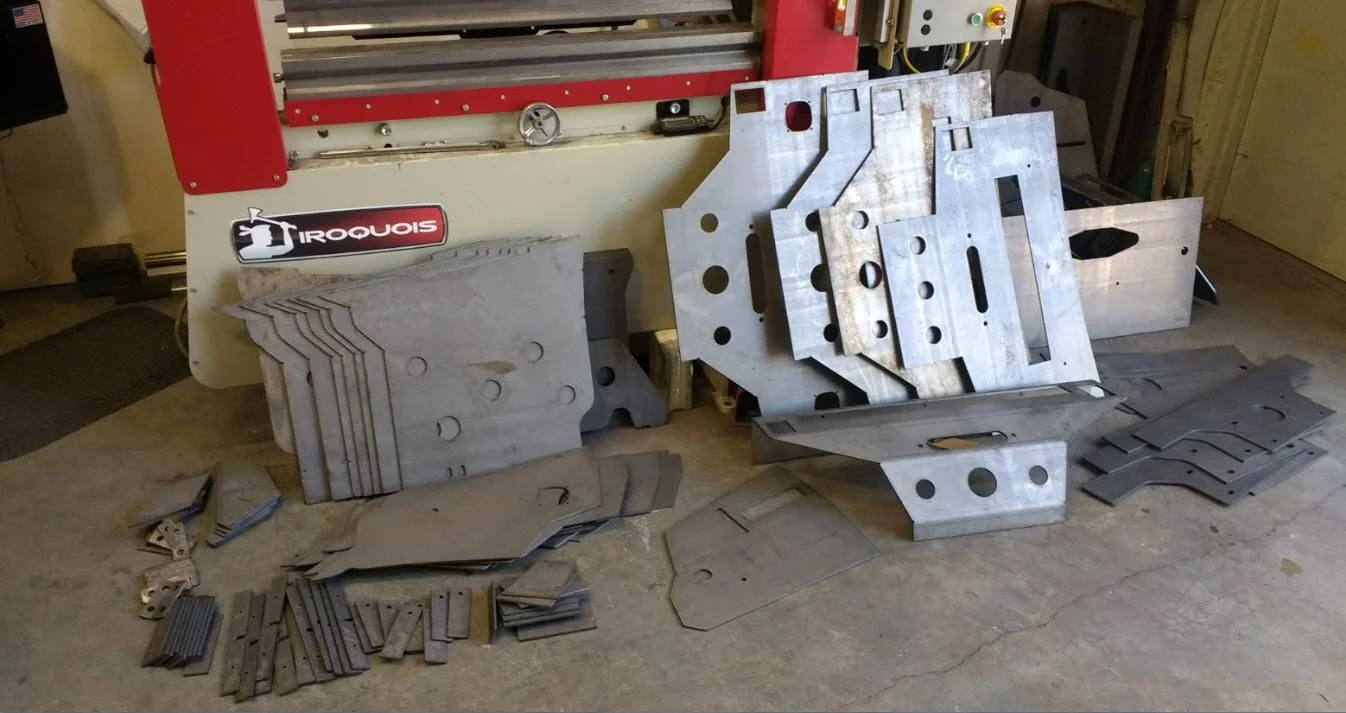

About 170 bends and these will be ready for production.

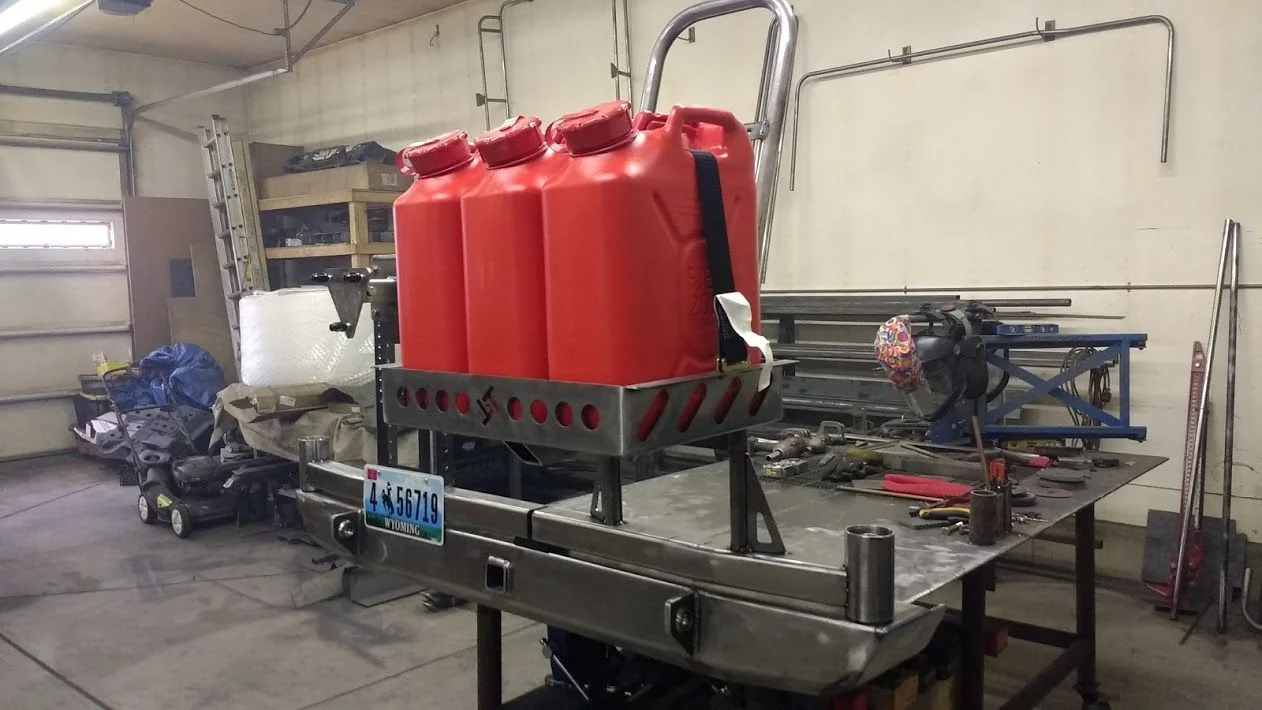

You're the first to request a ladder. I can make one where the jerry cans are removable from the ladder. Similar to this that I use on the earlier series bumpers I build. I'd want to make it from plate instead of tube to blend/flow with the style.

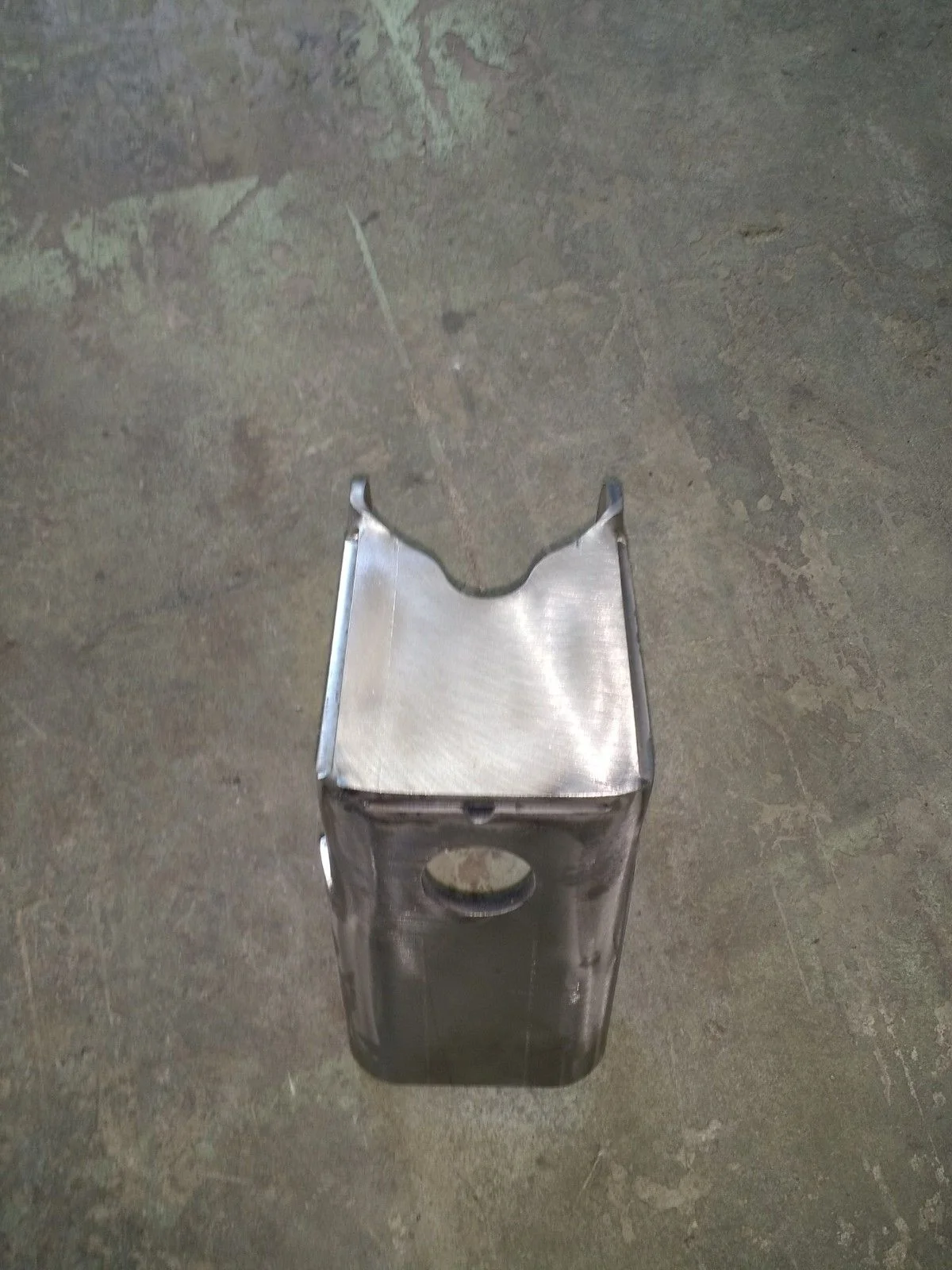

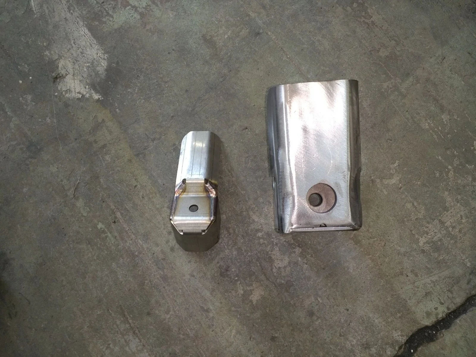

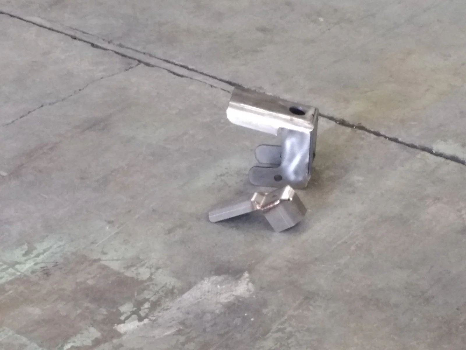

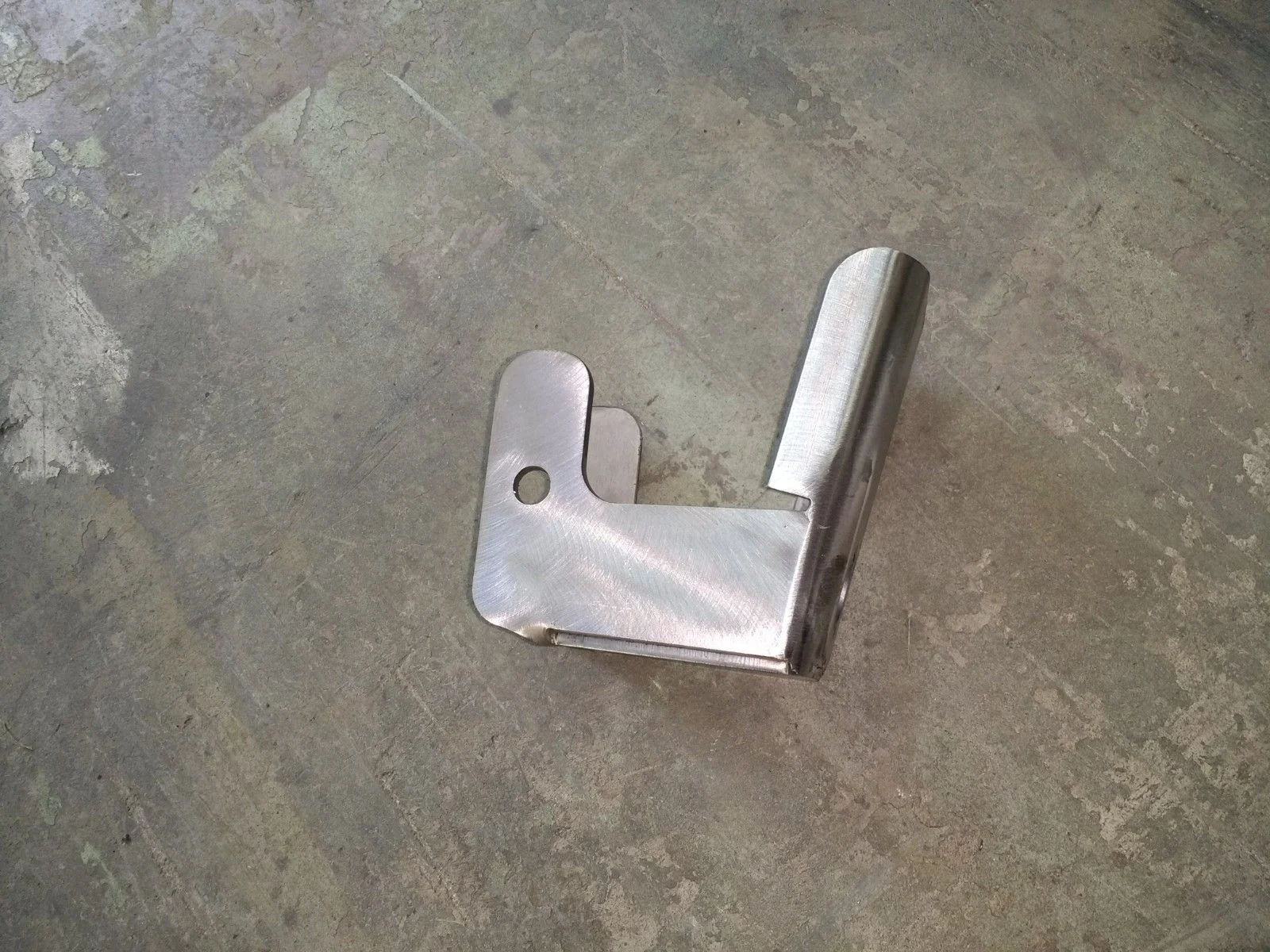

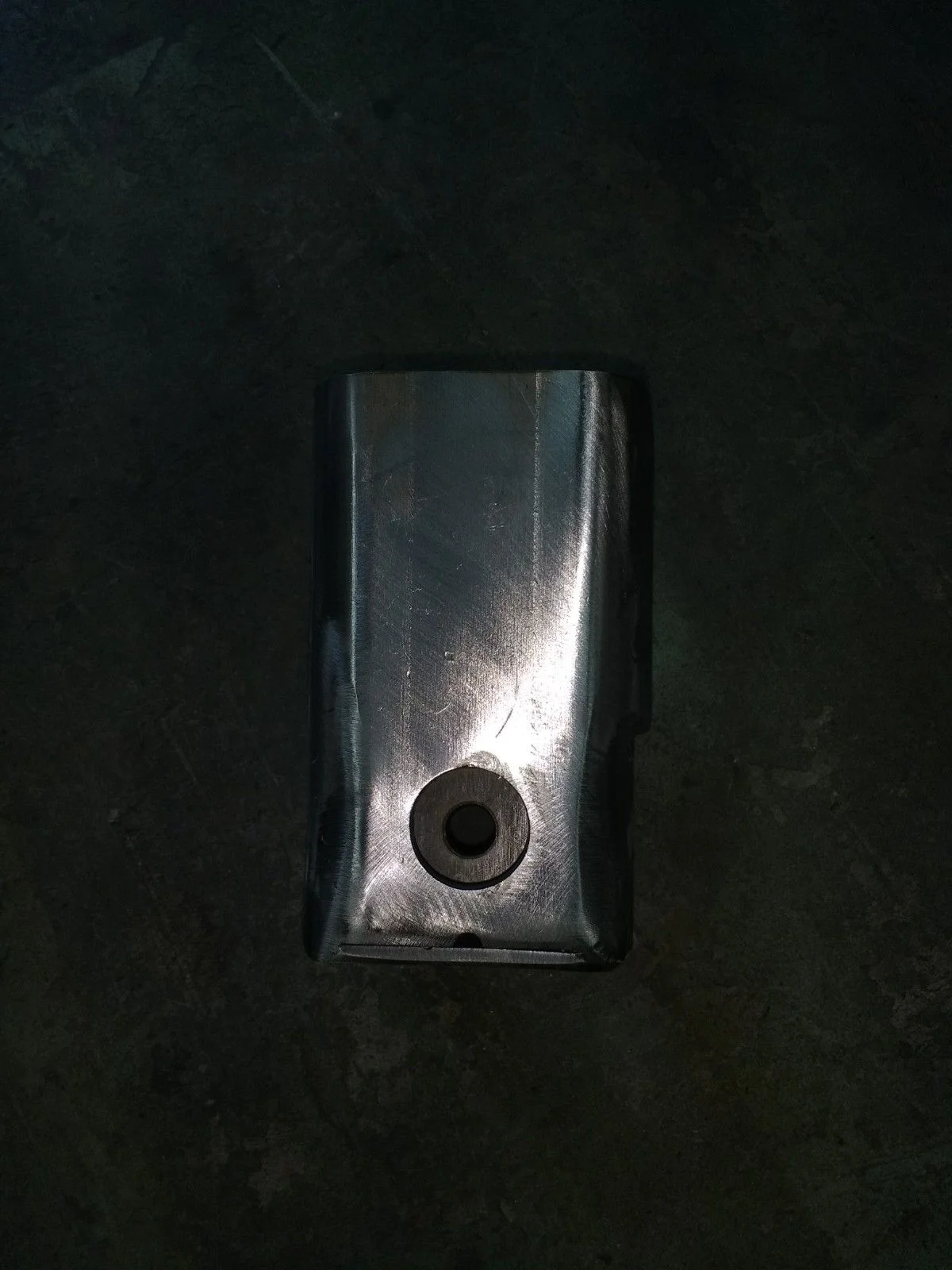

@indycole wanted a set of rear shock guards if time allowed. Since I was out almost all last week I got to draw a bit... had time while waiting for one of my bumpers to cool before pulling it out of the jig.
A customer sent me a set of the ICON guards for a 100 series and we just started laughing when we went to install them and never went through with it. Most that install these end up with shock damage.
I'll get this test fit to see what needs to be changed. Since the Tough Dog shocks are a 2.8" main body with a 3.25" out cover I made them fit the largest shock I had.

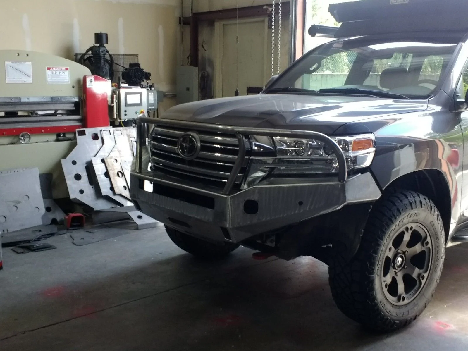

Gen 2 front base was welded out today. I'll get it mounted back up tomorrow and get the bullbar bent and welded tomorrow and sent to powder for @indycole

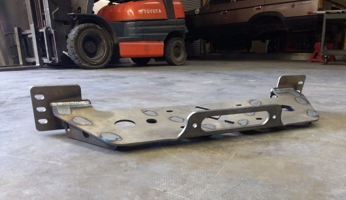

I may have missed this somewhere in the many pages but were there any pics of that 2016+ hidden winch plate install with the bumper back on?
