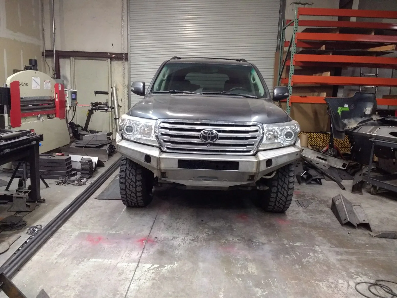

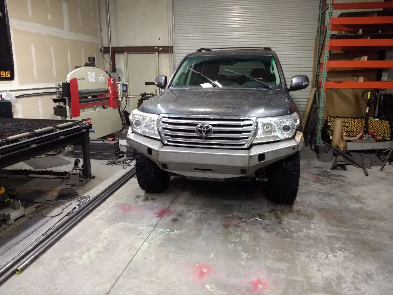

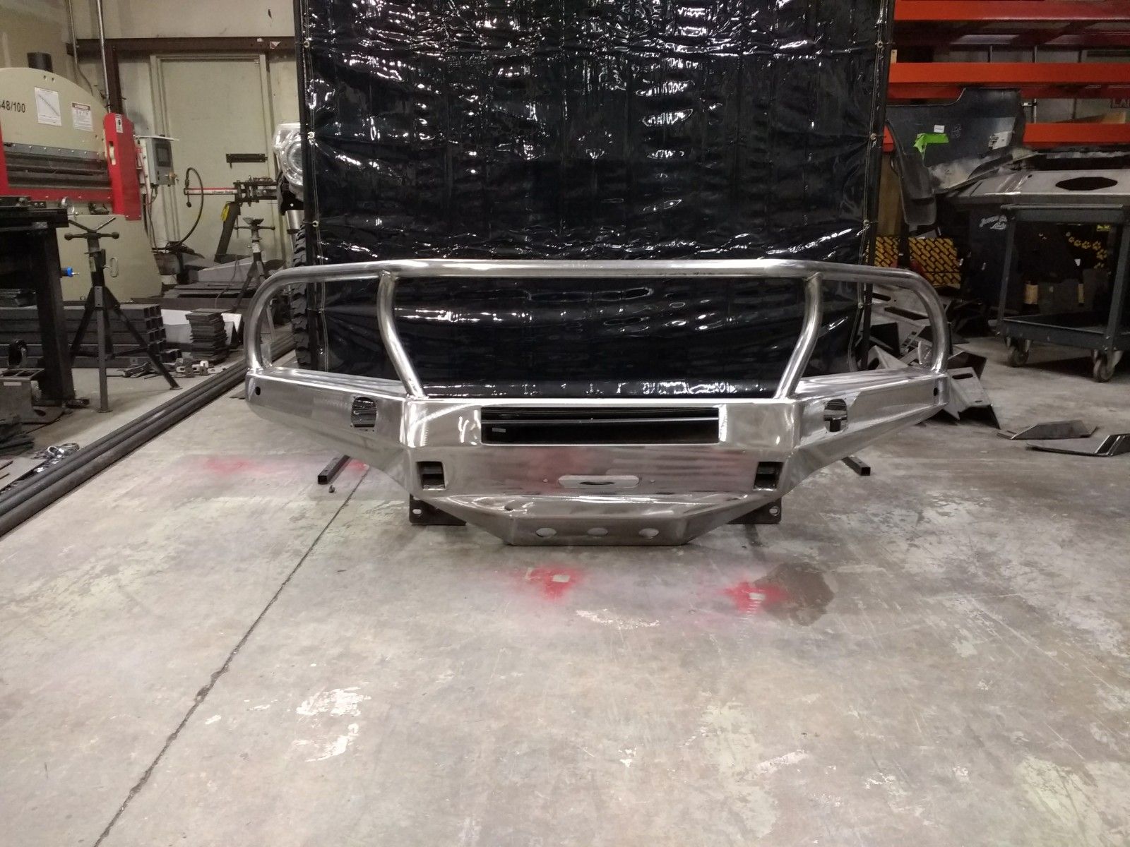

Seriously beautiful work! I even dig the look of the brushed steel. I wish there was a way to keep that look too! Everything from the attention to the curves on the grill and then again on the fenders. Pretty amazing!
Just powder it clear.... HA! .... YES, Clear powder is a thing now.

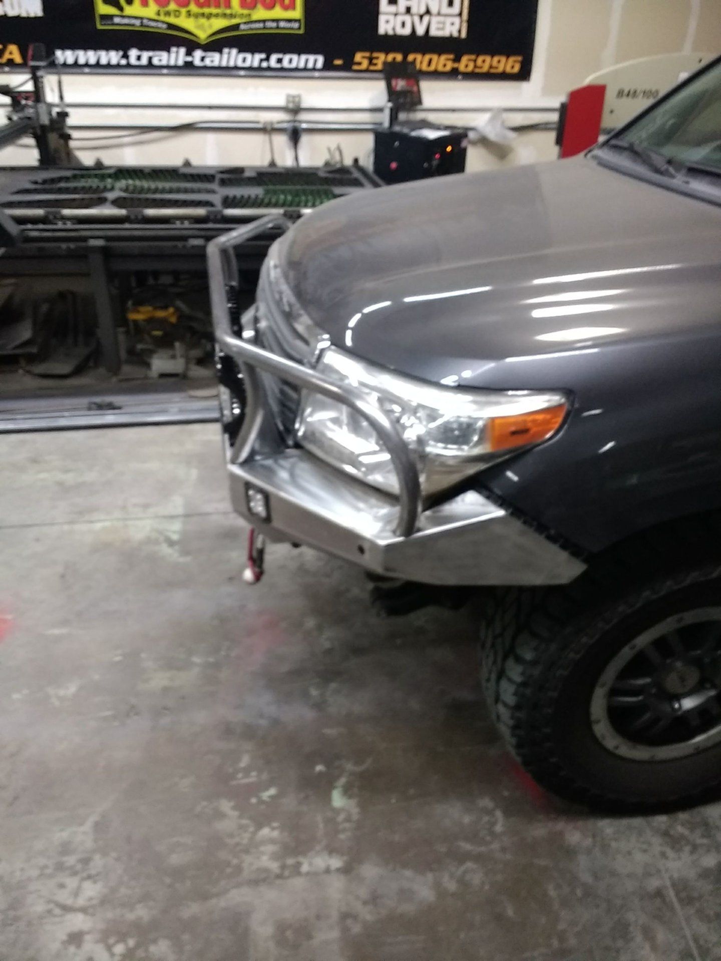

I generally don’t like bull bars but these look nice. I’m still sticking to my no bull policy tho.
Whack a critter, and you'll come around. ;)

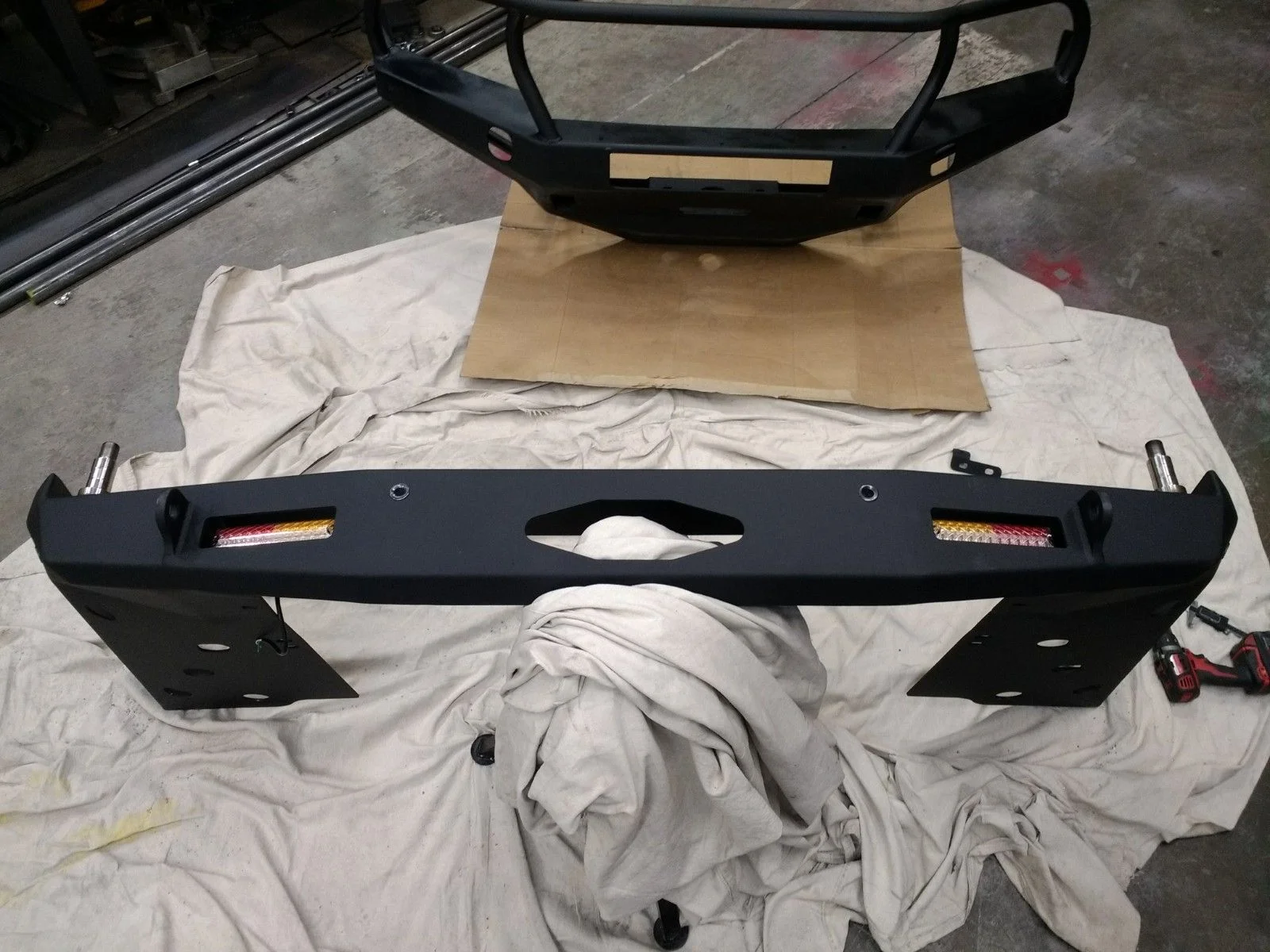

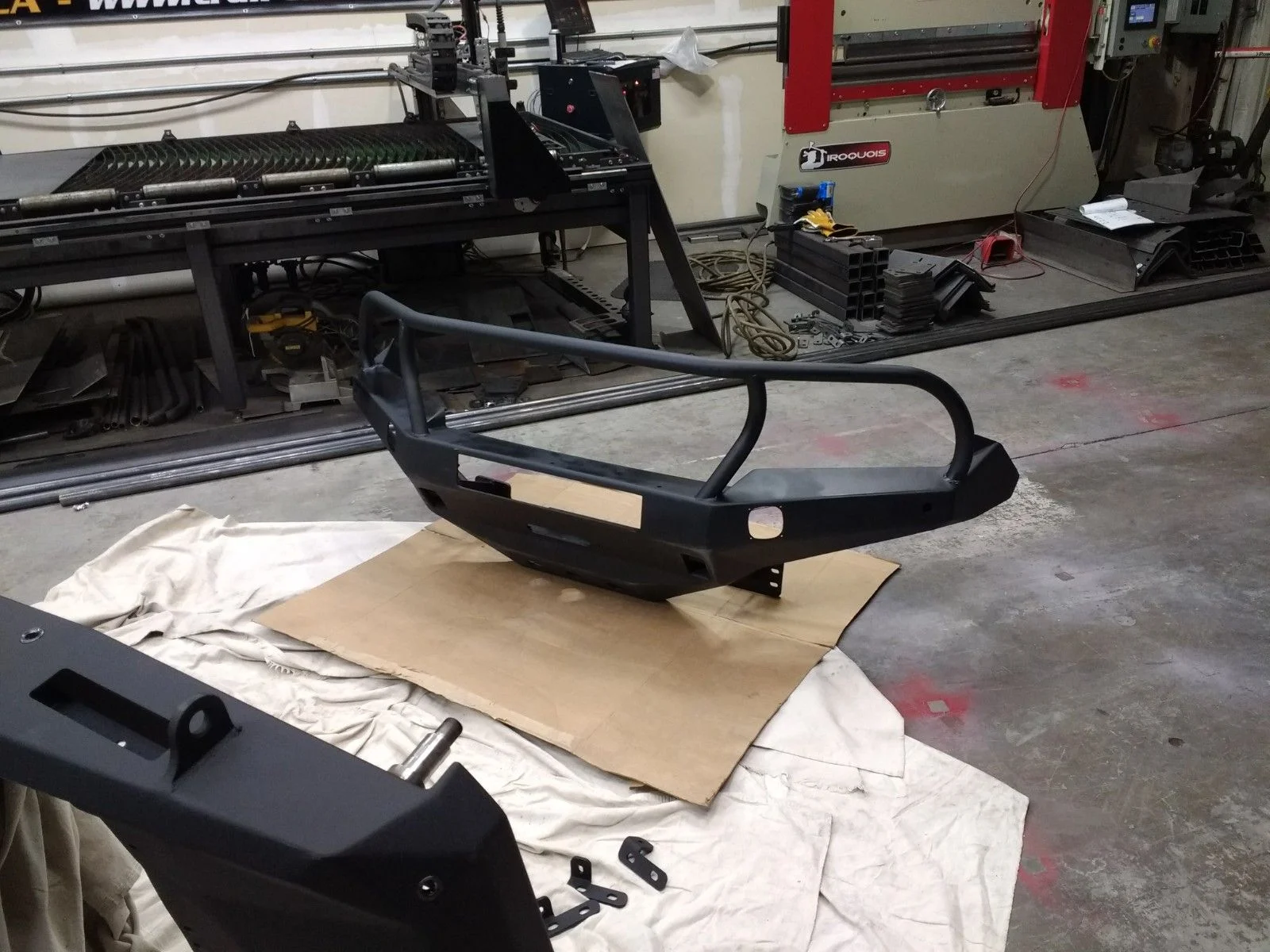

Wait you finished welding yesterday and it’s already powder coated? Do you have a powder coat genie?
Rears were sent in on Monday and the front was picked up yesterday morning. No genie, just proper service..... When everything is working correctly.

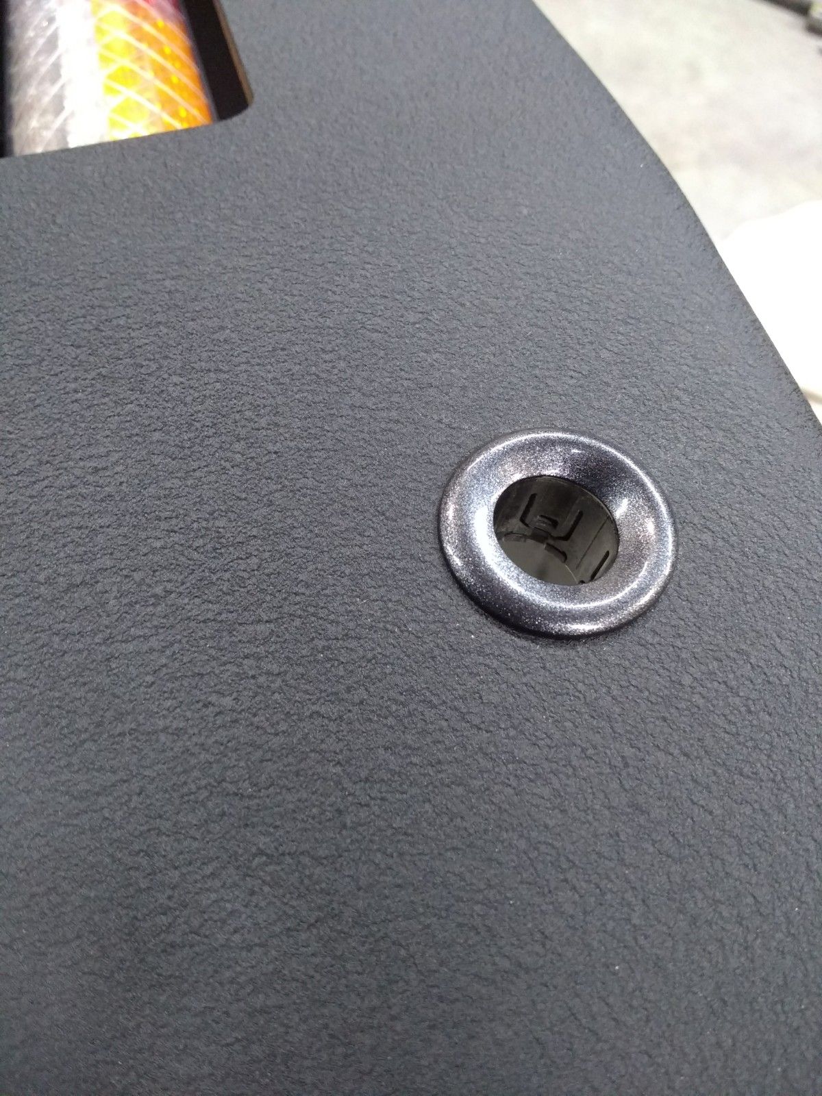

My only suggestion is to move the outer most sensor holes to the rear of each side. By having them on the outer curve the stock sensor cable doesn’t reach. I had my cable extended 8” so I could reach the holes and connect the sensors. Just so others are aware if they try to connect the cable...
With my internal design that would mean bringing the end ones inboard almost 10" from where they are now/ or 1.5" inside the tow points. They entire wing end is side and cross braced and can't get a sensor in there and if you could it would weaken the stiffening structure for the spindle/ swing arm.
So, either delete the outers, move them inward to a point they are uber redundant or extend the harness. All the bumpers will come with a crimp on harness extension, if I don't install them.

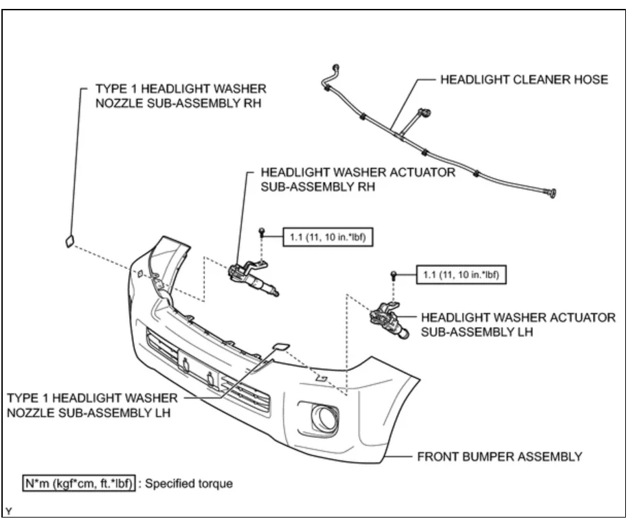

Wondering if the headlight washers will fit the new front bumper. If not I'll live without them. I grabbed one with my fingers and pulled it outward by hand today and it doesn't seem that complicated. It looks like it's just a slot in the bumper and it's held on by one bolt, but I can't tell if it's held onto the bumper or onto the body. If it's the bumper it seems like worst case would be a single screw. I'm assuming it's actually the body and therefore the body/bumper flex would break it. Anyone know?
