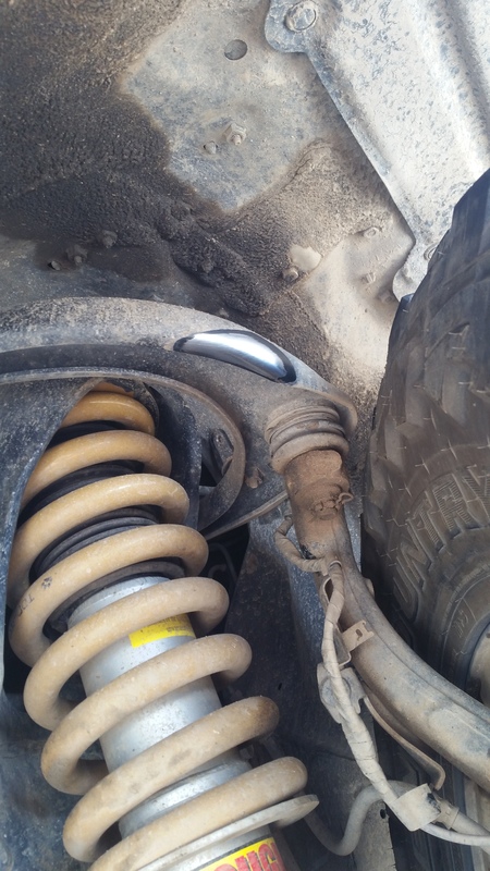

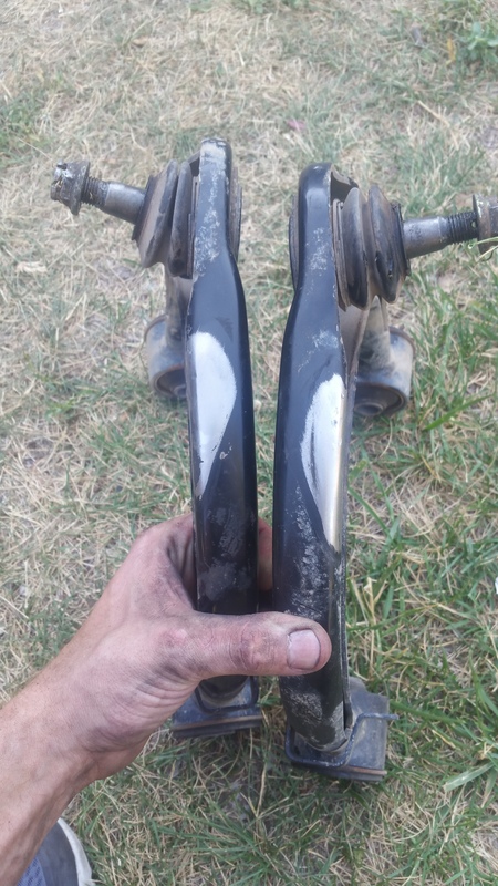

The UCA rubbing has gotten to my nerves when at full lock in parking lots, so I ordered a set of SPC UCAs.

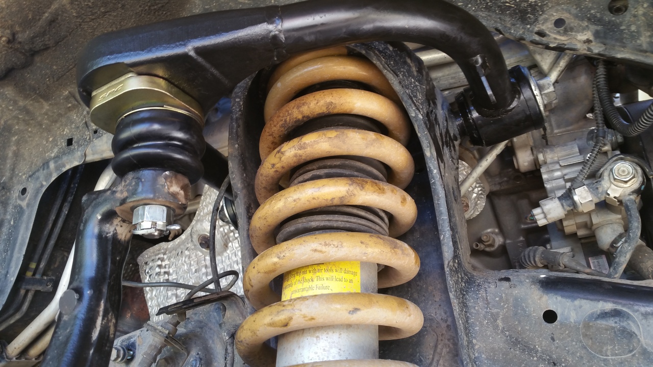

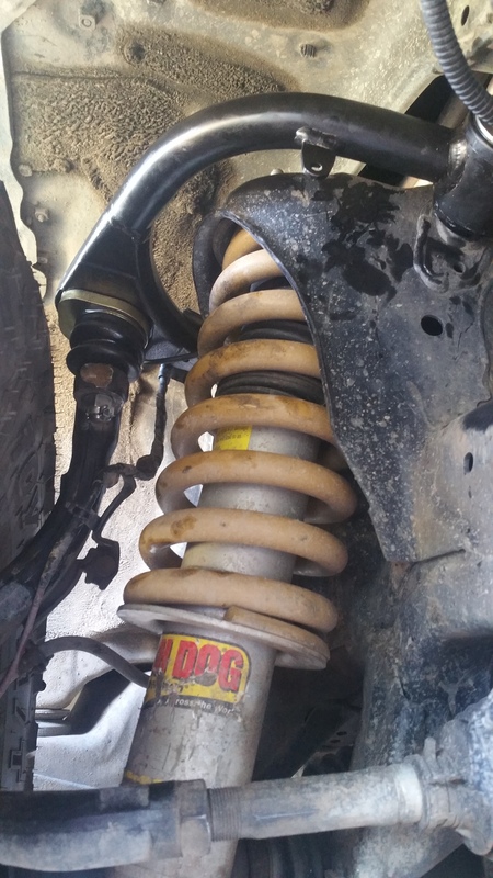

SPC UCAs are in. Easy install. Only "pain" was removing my 2nd battery to fish the PS bolt out. Went with the 0* castor and fully out camber setting. Pics were taken prior to tightening the top nut so yes, they aren't cambered out in the pic. NO MORE RUBBING! :)
Not pictured, threw some POR15 on the sliders where I scraped to the metal. I'm good to go for next week.
