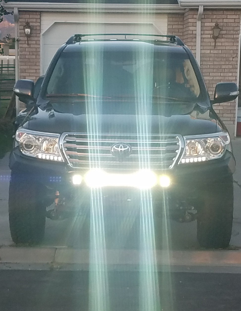

Definitely blinded myself taking these boring driveway pics. I'm still seeing LEDs when I blink.
She'll light up a trail for sure... WOW!
Looks really good IMO! ;)

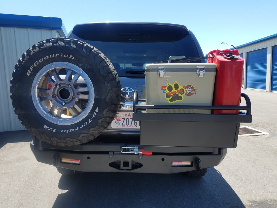

Hey tony, what factors helped you decide on which side you wanted your spare tire on? And did you do move your backup camera?
Jason did it automatically but that's what I wanted anyways. Maybe he can chime in on his own reasoning.
My thinking was: the gas tank is on the passenger side. That's 190# in fuel plus the tank/hardware itself. Putting the wheel on the passenger side would just compound the weight on that corner. I didn't feel any weight imbalance while on the trail so maybe it worked.

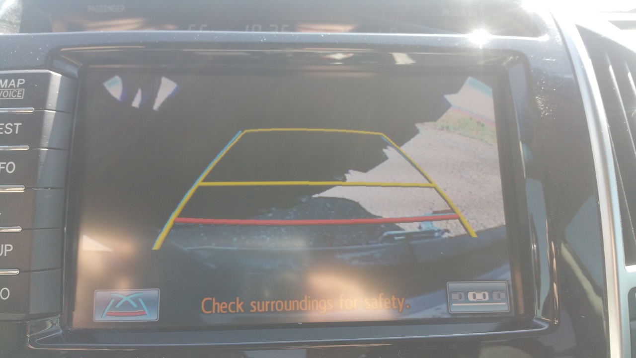

Yeah I'll have to move the camera. Here's a pic of the what I see. Once I see something on that bottom corner I stop. I haven't hit anything yet:
Plan and simple... When I look over my shoulder when passing or backing I don't want to see a big tire blocking my view.... Some say that if you have a flat you'll swing the tire into oncoming traffic... I say, I'll pass thousands of people before I need to change a tire AND why does the swing out need to be open the entire time you are changing the flat. IMO, its a response that piss poor planning and design has come to be regurgitated for the seller. I've had guys demand the tire on the passenger side... BUT, I recommend against it.
Also, if your suspension can't handle the drivers weight and a tire on one side.... You need a new suspension....
I want the most visibility and safety at all times and the tire on the passenger side just doesn't provide it.

Nice, yea I like your reason for looking over your shoulder to look out the back.
I have been going back and forth for months now, and I think you just solidified it for me. Being able to look over my shoulder, out the back is pretty important. Plus weight for what I'm going to carry "should" be close from left and right carriers.
So I'm going to hang my spare off the passenger side, but because on the other side I'm doing to do 3 water cans, then a propane tank on top of that, so that will totally block looking out the back, so if I mount the spare at the height of @Willy beamin rear bumper, I could still do the turn over my shoulder and see out that corner, maybe, guess we'll find out.
Good stuff, sometimes, I just need to hear it from someone else to make sure I'm not crazy. Nice pictures Tony, I'm hoping I can make my way out and run some trails with yea!
Edit: humm, no, I think Jason is right, I have no choice but to put spare on driver, maybe I put propane tank above the spare? No that's sounds terrible. Back to the drawings.
Understandable.
I'm carrying only the tire (no fuel/water, cooler, toolbox combo) 90% of the time. So that corner is a few hundo lighter most of the time.
Either way, whatever works for the driver. Outside of the backup camera I rarely notice the spare in its current location. My mind is generally occupied avoiding Utah drivers and listening to Lithium on SiriusXM wondering where my youth went.
