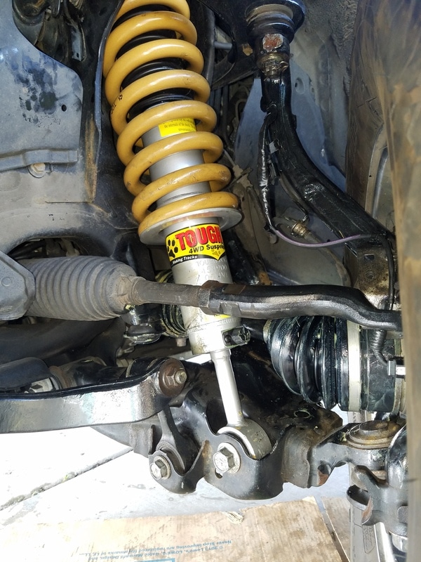

Moly splatter everywhere and a hosed ABS wire but the CVs are re-booted and all is well. I need to blast off the extra grease at a car wash. Also I had to re-wire an over-tugged ABS/Speed wire. I guess I'll order a new one but it's working as of now.

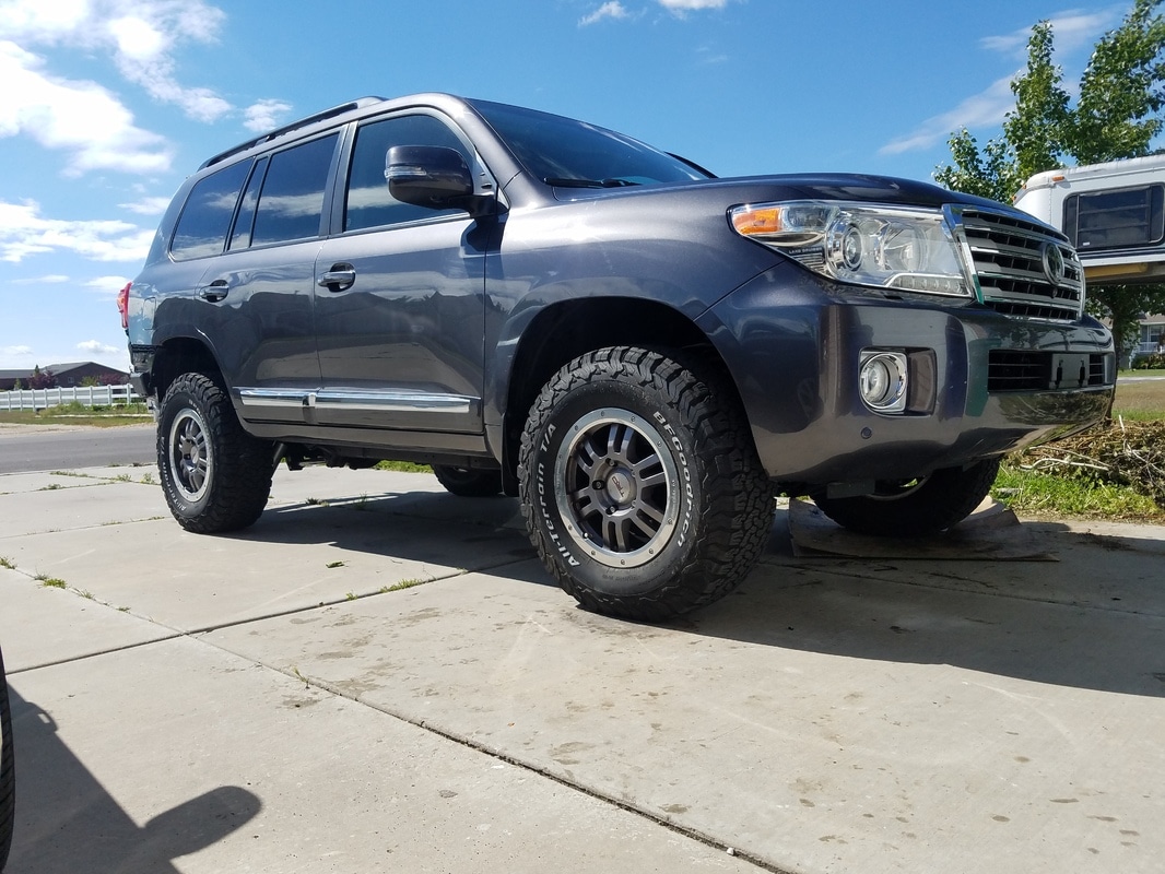

Here's the final sitting spot, it'll still settle a bit. Mind you this is with heavy springs in the rear so it's a little high and stiff in the rear. Otherwise it rides great. Sooo much better than stock. I'll get a solid review once the bumpers are on and it's weighed down as it's set up to be. Hopefully before the 4-day weekend coming up. But the weather is suppose to be nice this weekend so maybe I'll do a quick ride up near Bear Lake.

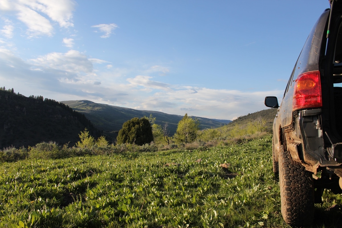

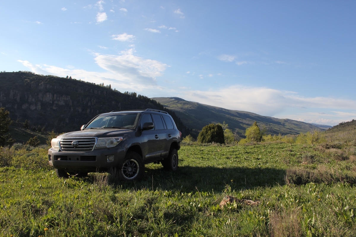

Decided to drive up near Bear Lake. A few of the trails were still blocked off and/or snowed in. I went down a trail that's far too small for the big 200. Plenty of pinstripes but whatever, now people will know it's not a mall crawler. They'll buff out.

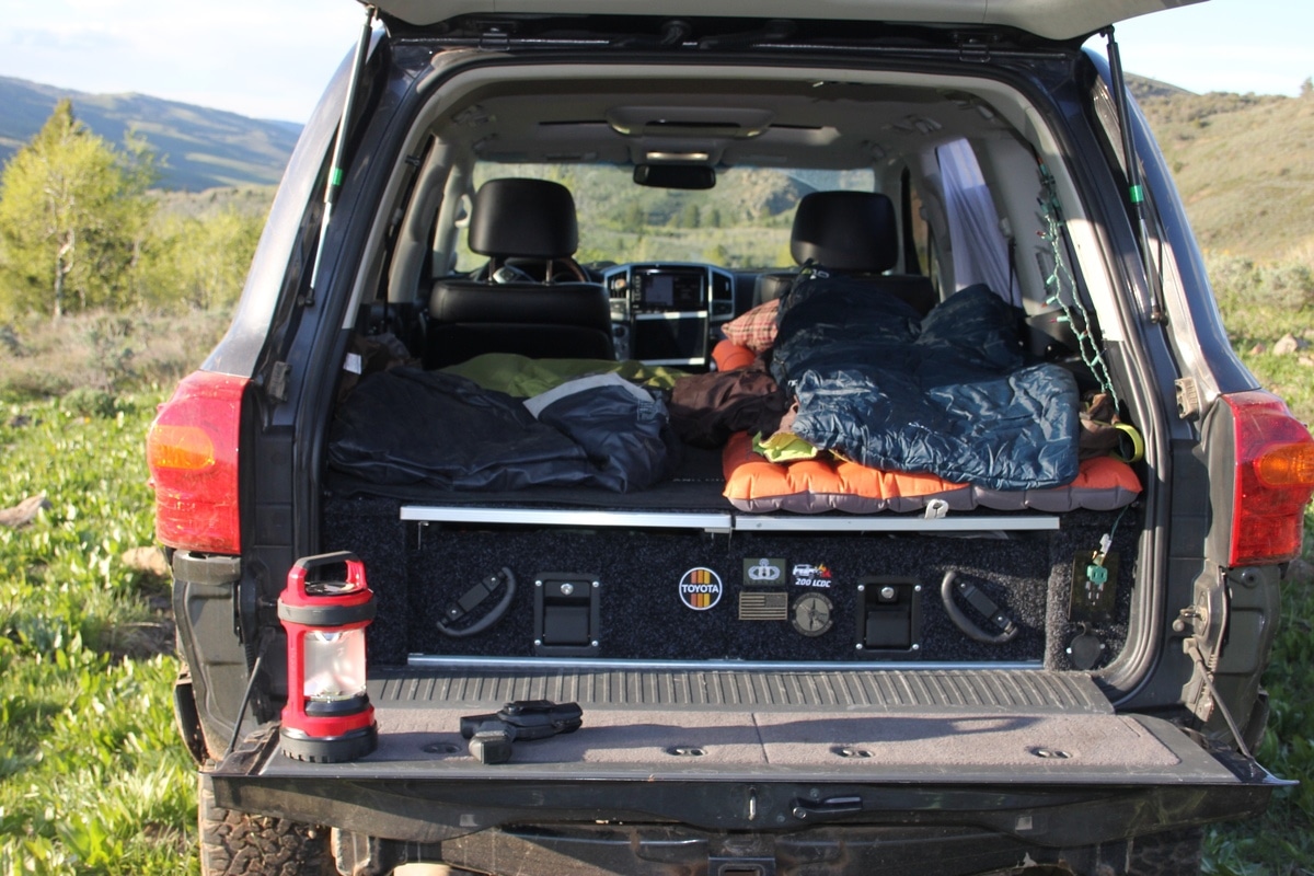

Found a nice spot and decided to stay the night.
The suspension worked great. Washboards are a bitch but that's as to be expected.

T - if i missed it I apologize, what rate springs are you running front on rear to handel the additional weight
Enough grass and weed talk... get back to the build
Mediums for in the front (up to 660# I believe, could be off on that, I'm not near my computer) and heavies (up to 1100# constant) in the rear. The rear is surprisingly docile for a heavy spring. I think the big bore shock keeps it comfortable enough for daily driving.

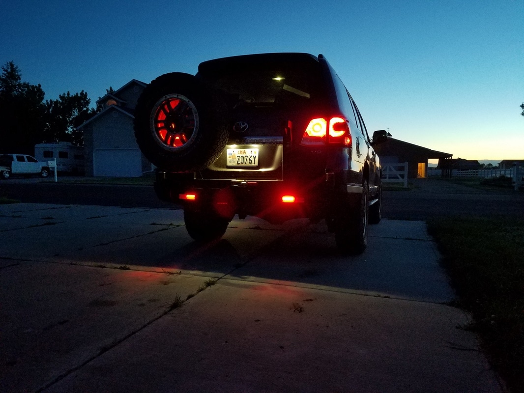

As for the build, sliders and rear are done and installed beside the small bits (camera relocate, parking sensors, work-light wiring)
About to start on the front which (should) be fairly easy. Preview from last night as I finished wiring the aux bumper lights at nearly 10pm. Now my spare is a Jack-o-Lantern

Your COs are for bumper with winch and 45mm adjustable shocks and the rears springs are constant load 660-1100# with 45mm adjustable shocks.
Not sure about the 200 but I like to run my 100 with the 45mm adjustables at stage 6-8 on highway/DD and 2-4 off road, pending how I'm loaded.
