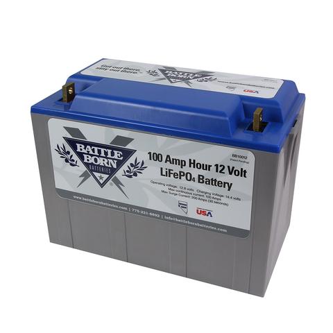

I'm sick, lathargic and miserable, the only thing to make me feel better is spending money like a lady on things I don't need. Lets how this thing does in place of my conventional 100aH AGM with twice the usable capacity.
Yes, I'll be running a Redarc BCDC1225D with supports LiFePO4 bulk and float charge (among other features) and my GoPower Inverter/Charger supports up to 16V bulk charging.

The RVing community has been really taking to the Battleborn 100ah battery. That's a crap ton of battery capacity in that little package. Way more than I would think necessary? They also have a 50Ah version for about half the price.
They have their own BMS built-in on board. Pretty sure this can be dropped in on a vehicle without the need for additional BMS or voltage booster upstream.
One thing that may concern me is the underhood temps potentially prematurely wearing the batt?

I've drained my 100aH AGM to the point of it being unusable in one night of camping, well before the sun came up. I have high power requirements due to equipment.
As far as I know the BMS won't boost voltage for bulk/float. Hence, Redarc.
It has a thermal safeguard built in.
I already decided if I have temp related issues (which I don't foresee), I'll relocate it next to my inverter/charger.

Curious what your heavy battery draws are? In my mind 100aH is a lot of capacity. Enough to run my whole RV at least 2 full days with heavy use for a family of 4. Not criticizing, just interested.
