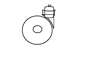

On the outside of tire, using t-straps. Swappable per side. Like so
The propane can I'll be using, that Jason has of mine, is this. But the cheaper $45 tank might work too. I wanted aluminum for corrosion resistance and light weight.
https://www.amazon.com/gp/aw/d/B004FPZABU?tag=ihco-20
That’s the one that’s on my swing arm. It’s pretty good, had to sand some sharp edges but the weight reduction was worth it to me.
