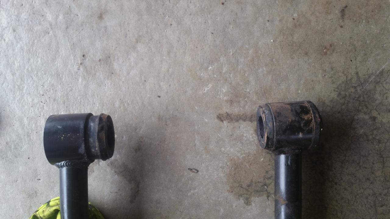

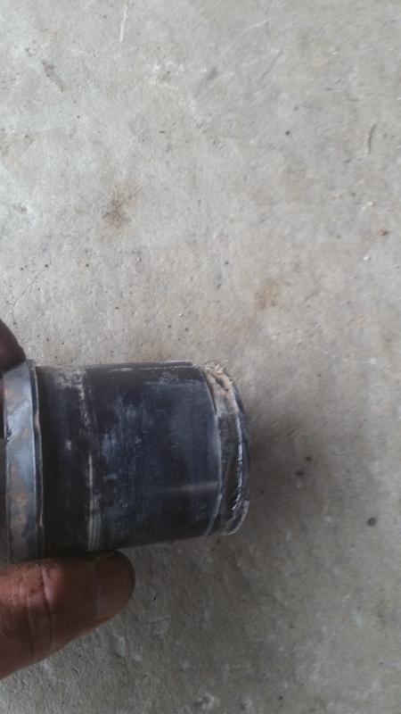

Noticed my UCA was shifted forward and the bushing was exposed. Looks like the bushing collar broke off. Weird stuff. Plenty of moly was put on during installation and everything was in the proper orientation (washers and whatnot). I emailed SPC, hopefully they'll give me a new set of bushings. Otherwise I'll add those to the maintenance order list.

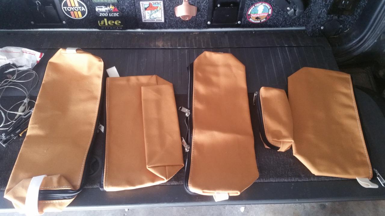

Every man likes storage, be it boxes or bags full of tools or various equipment. Blue Ridge stuff is nice but I didn't want to sell an organ just to buy a canvas bag.
I bought these from @cruzerDave to replace the horrendous bags I bought from Harbor Fraught. Nice, quality, fabric, great zippers and they don't cost a fortune. The only complaint is, I want about 5 more bags but he's out of stock. :)
The sockets and box ends are tied together with paracord, not just thrown in there.
Great action shot, and glad you like'em! I've more on order, should have them shipping by end of the month.
If you want more I suggest you order them now... ;)
Looks like you robbed a bank;)
Edit: not a knock at all, I really like those for the reasons you mentioned. I'll be ordering some - the old husky steel box from HD is way too noisy.
I might need to do this soon. All my tools and recovery gear are stuffed in one of these. Amazingly I've been able to squeeze sockets, a tool kit, shackles, ropes, wrenches, etc in it, but getting rid of the plastic cases for the tool kit and sockets (which take up a lot of space in the bag) would be a big help.
