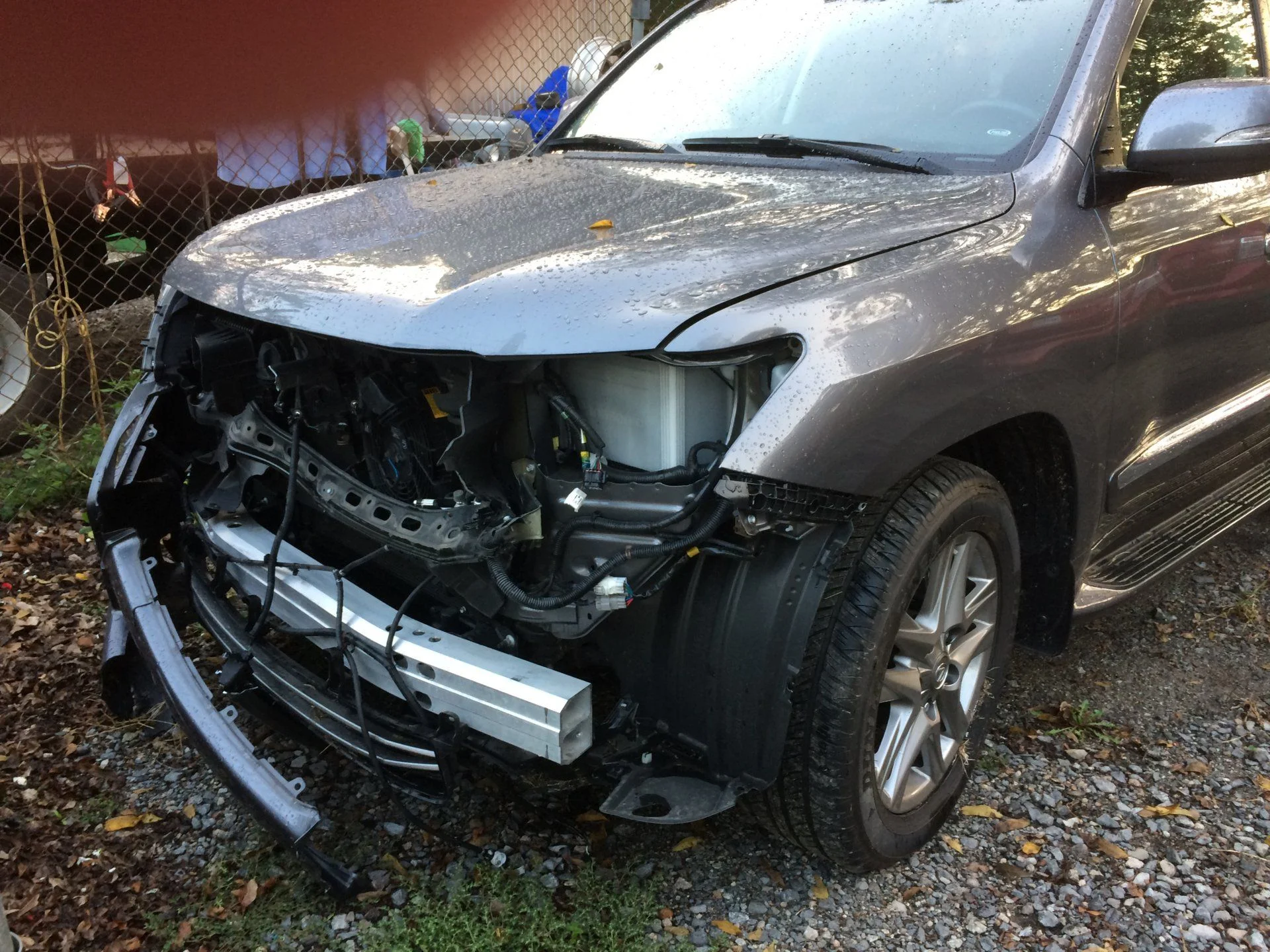

I weigh about 240 lbs and the wife is 120 lbs and I might have 50 lbs of stuff in my LX. On trips about 250 lbs of stuff so total 600-650 lbs. I bought these at the 285/55/20 size instead of going with the much cheaper 275/60/20'. The 285 tread width is over 1" wider then the 275's. Should make a big difference in wet handling and braking. I got these after a lot of research after I hydroplane on the stock Dunflops during a huge rain storm while on a freeway through Arkansas. Other drivers hydroplane off the road when and where I did. :(. My front clipped the side of another hydroplane vehicle while I was doing 360's in the mud in the median, $19k in damage and no sheet metal was even damaged, just the plastic front, headlights and radar, also got a new radiator because a fin was dinged. Glad they used a OEM replacement parts.
