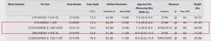

Michelin makes the LTX A/T2 (Not "AT2") in P-Metric, LT-Metric and ISO-Metric sizes. You have asked about the ISO-Metric size "275/65/20."
Is that really what you mean to ask? I don't think so.
It only takes an extra second for you to correctly state the size tire you have, but in order to check to see if you really know what you are asking, I have to research on the Michelin site to confirm your question - then I do my thing and calculate the correct recommended pressure.
On the Michelin site (Truck Tires, Car Tires and more – Michelin Tires) I find that your tire is really the LT-Metric size LT275/65R20/E 126/123R. Correct?
In that case, the Recommended Cold Tire Inflation Pressure for the LT275/65R20/E 126/123R Michelin LTX A/T2 tires on your 2013 LX570 is 36psi F/R.
By now, you (and probably other readers) have come to the conclusion that I'm just being a jerk. Well, maybe so. If I were a real jerk, however, my response would have been:
Sorry, in order to calculate the recommended pressure for ISO-Metric tires I need the Load Index for the tire and whether it is SL or XL.
But I resisted that impulse.
I really don't mind calculating pressures for you folks, but please, state your requests completely and accurately - it makes it a lot easier to get you a complete and accurate answer.
Sorry for the rant.
HTH
