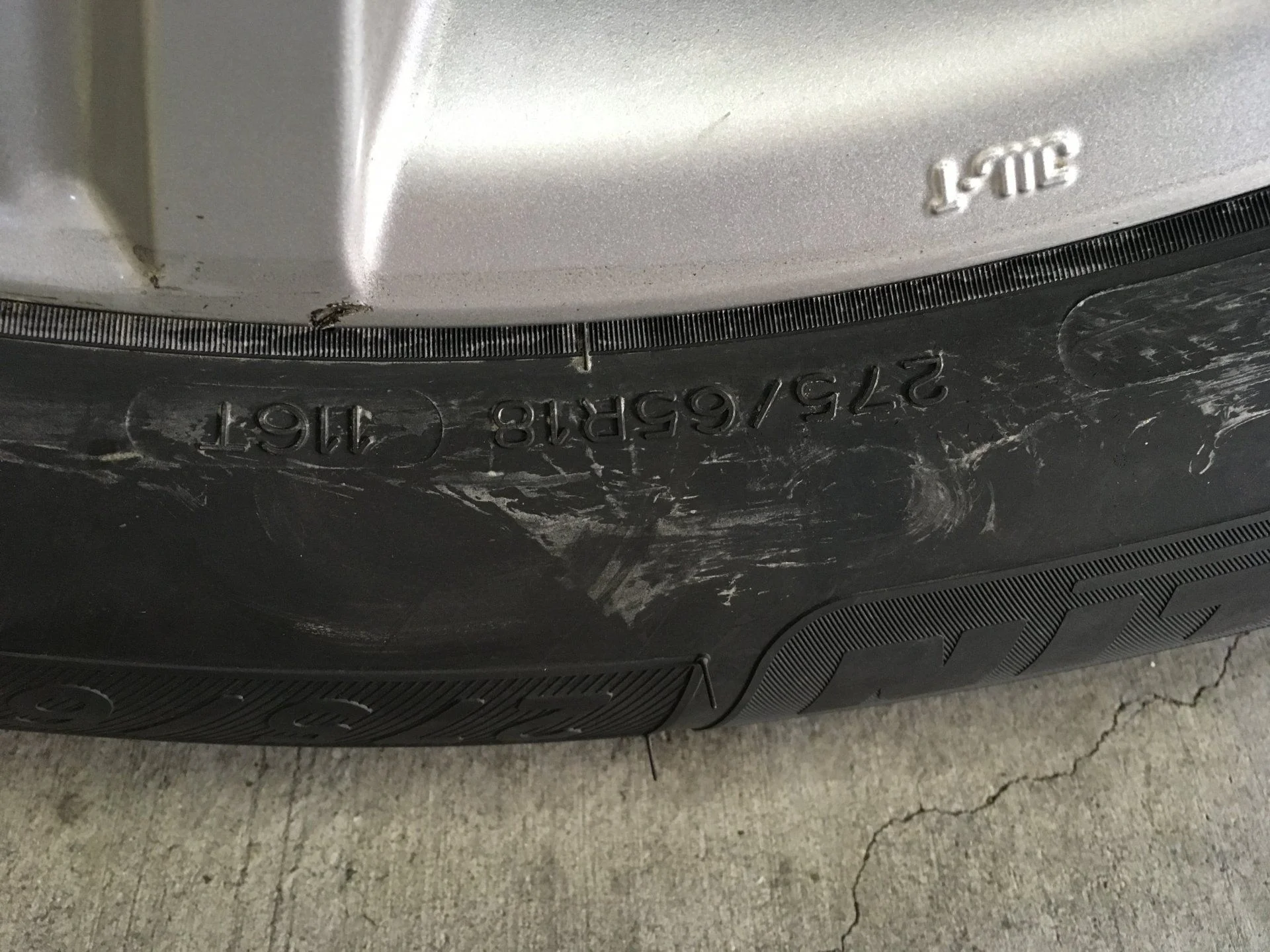

Correct, I just purchased a set of 275/65/R18 Michelin Defender LTX M/S 116T SL. The guy at Discount said to not go P-metric and go to LT. So I did.
I guess I never really considered the PSI needing to change based on the type of tire...So when I read before that you mentioned it’d be at 45PSI I was confused and shocked over the “increase from stock psi”. But this makes sense.
I’ll be increasing to 45 PSI once all the neighbors wake up on this Labor Day, and I can turn on my compressor : )
Happy Labor Day everyone! BTW.
PLEASE CHECK THE SIDEWALL MARKINGS ON YOUR TIRES!
Michelin Defender LTX tires with the 116T Load Rating you say you purchased are NOT LT-Metric tires, they are P-Metric tires.
If your tires are indeed LT-Metric, the sidewalls of your tires should have imprinted on them: LT275/65R18 123/120R Load Range E. If they do, then the correct cold tire inflation pressure is 45psi.
If your tires are P-Metric, the sidewalls of your tires should have imprinted on them: 275/65R18 116T. If they do, then the correct cold tire inflation pressure is 33psi.
THIS IS VERY IMPORTANT!!!!!!! You must correctly identify whether you have LT-Metric or P-Metric tires on your vehicle - Michelin makes the Defender LTX M/S in BOTH types. I will also send you a PM directing ypou to this post to assure this is not overlooked.
Please post back what you find.
HTH
Well son of a........
Guess I’ll be calling Discount Tire on Tuesday to discuss this with them. The salesman said go LT, I agreed, and now I have different tires.
I’m glad I posted this and am now looking more closely at things. Inflating to 45psi would have been bad news bears!
Yes, your tires are P-Metric and the Recommended Cold Tire Inflation Pressure for your tires is 33psi. Very glad we got that squared away.
