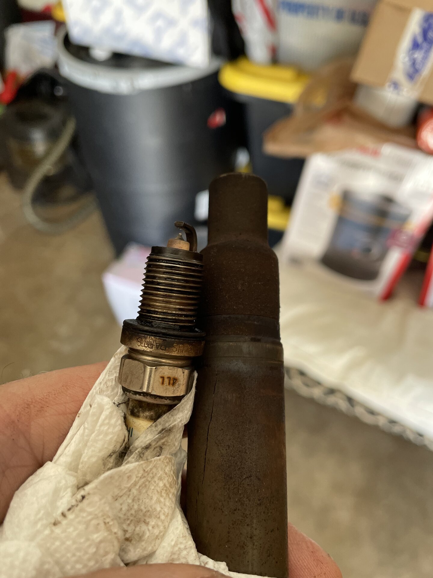

Thanks to this forum I decided to look for my cold start up tick by looking at my plugs. Found it! More than likely saved many $’s.
I am not sure when the plugs were changed but all but 2 I would consider loose.

I see cracks on your ignition coil, too. How many miles are on the plugs and coils? Any other cracked coils?
;) So glad the forum help you, to be aware: When tick heard, spark plugs need investigating.
A sure sign of loose spark plugs. Is the halo & charring, as you show in OP picture.
