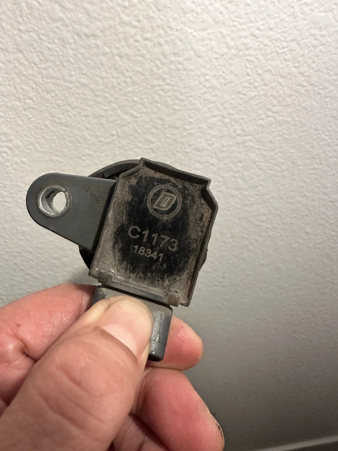

His is also an aftermarket coil burning too hot...
I don’t have data to back it up but it seems to be more common with aftermarket coils. I just ordered a set of Denso coils & plugs from RockAuto for my Tundra to hopefully avoid this scenario.
