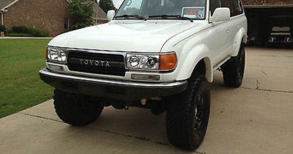

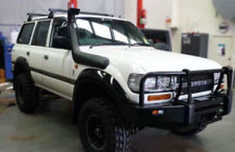

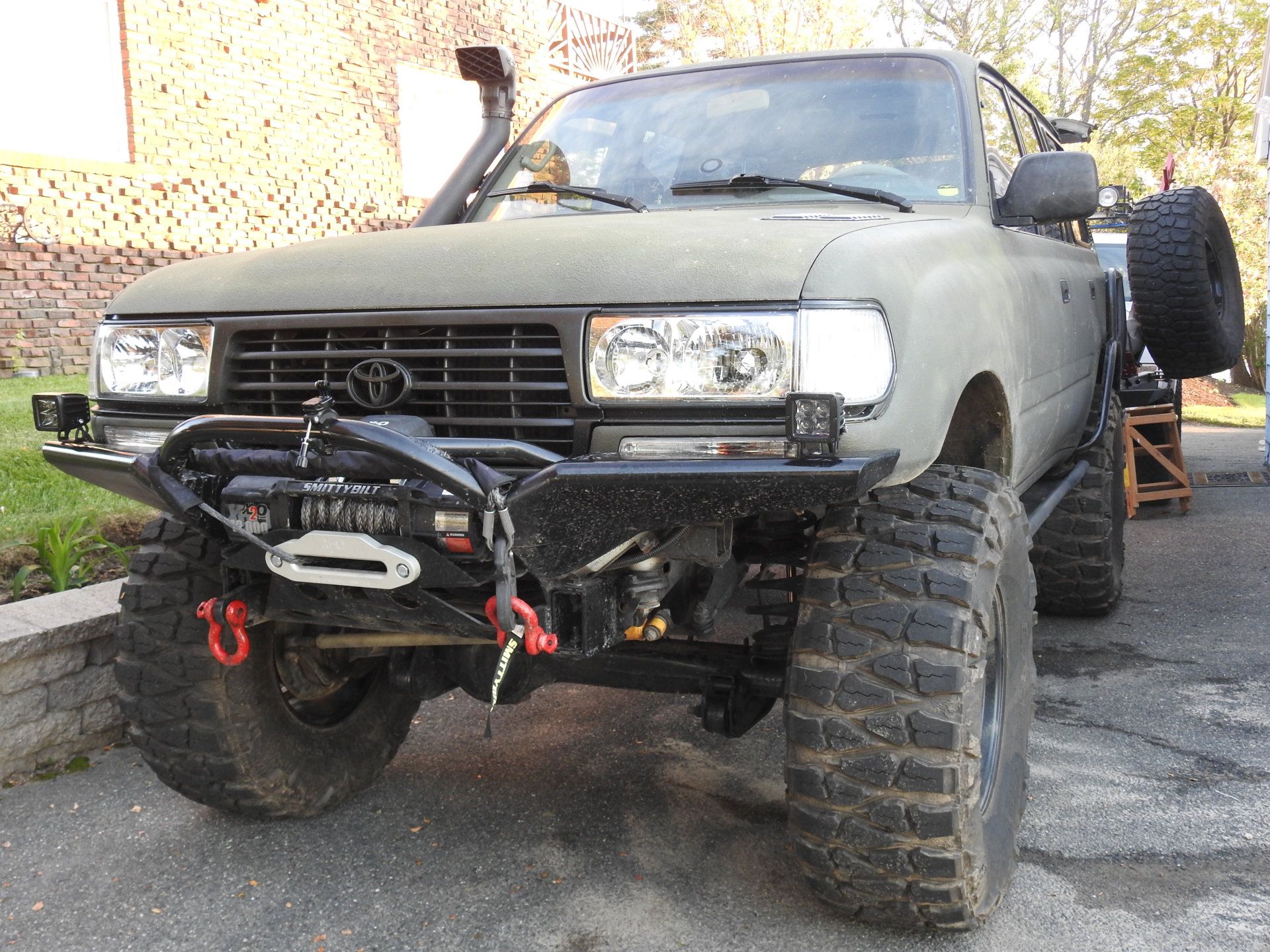

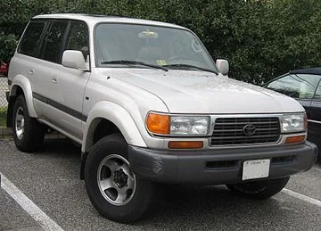

Greetings Guys and Gals, Some of you may have come across my Mercedes Diesel Swap thread ( sorry for no progress) or read about it as part of My 3 linked daily driver build thread . If not, that's okay. Pertinent Info, During my swap I had to enlarge some areas of the core support for intercooler tubing. The passenger side saw the removal of the bottom inner headlight mounting spot. The passenger headlight as it seems fairly common, was in pretty beat condition. The upper 2 mounts were cracked, the outer barely hanging on. So, 4 mounts, one missing mounting spot on a good mount and 2 broken mounts = 1 solid mount. I need either A: A new/good used Passenger headlight, B: A set of Euro Clear DEPO's since they dont seem to offer factory lenses, or C: the 80 series Dual headlights/ Quad light look.
all pictures taken from the internet of things, not my own.
Stock
Depos
Quads

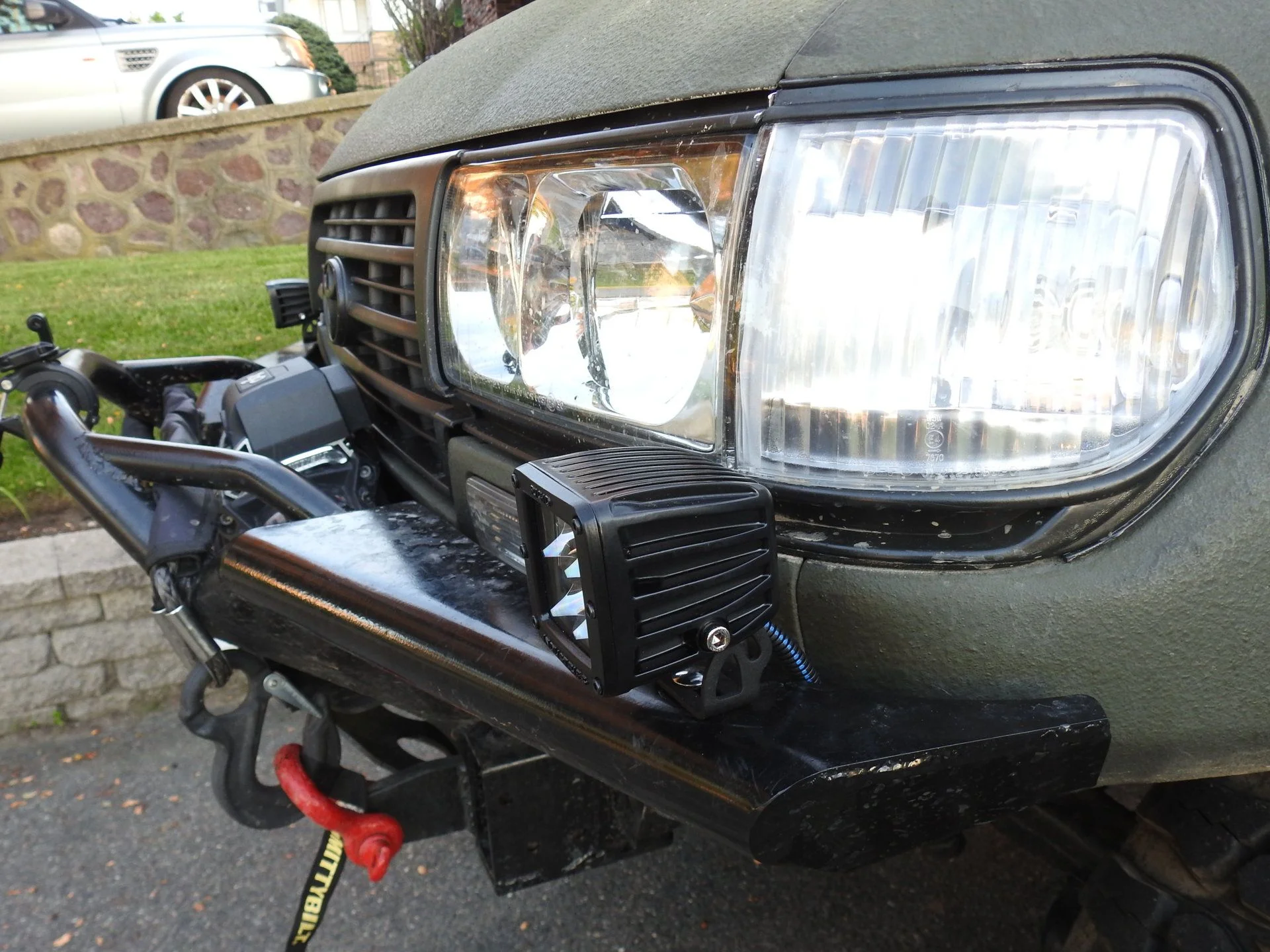

depos with the Susquehanna harness for proper use of h1/h4 filaments and switching logic...
I'll be hooking this setup up in the next few weeks. Really looking forward to the results. Susquehanna was great to deal with btw.

I swapped out HIDs for depos and put killer bulbs in them awesome so far after 10k miles

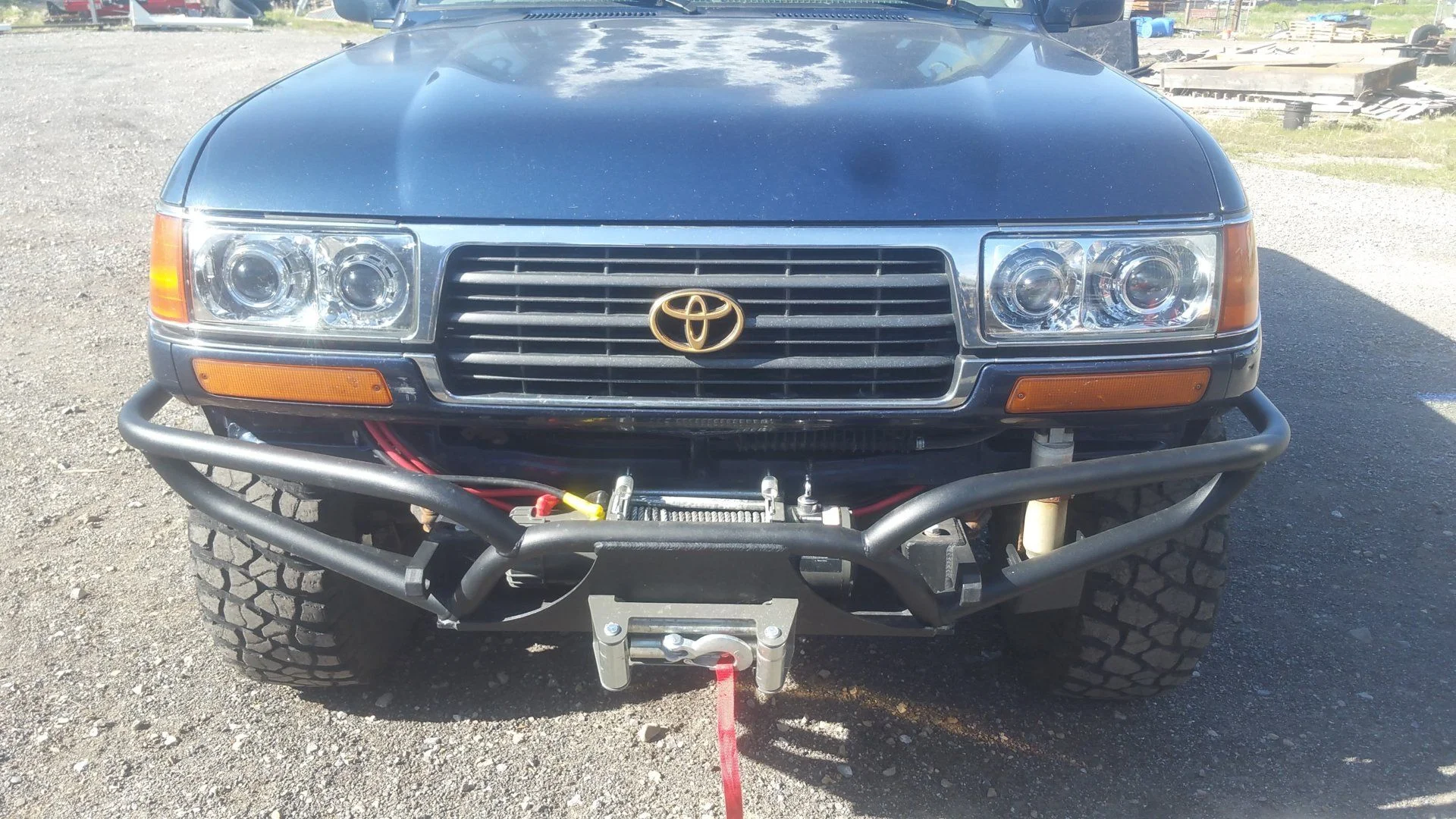

I tried the Depos, both without and with the H4 harness and wasn't impressed. I decided to just go balls deep and did a quad bixenon retrofit into the Depos using Morimoto H1 7.0's and D2S 4.0's both with 55w 5500k bulbs. It was a lot of work and definitely a couple bucks, but if you're serious about lighting, THIS is what you want.
I swapped out HIDs for depos and put killer bulbs in them awesome so far after 10k miles View attachment 1563982
What bulbs are you using? The first set of bulbs I used in my depos were pretty good, but I've since had to replace them with cheap ones available at autozone. I need to get back to having some nicer ones in there
Which harness did you use? This seems much easier the retro fitting HID.
I didn't want to ruin the Depos I have
i believe it was the hl28202s harness. if you call and talk to the guy, he'll remember the correct one for the cruiser.
