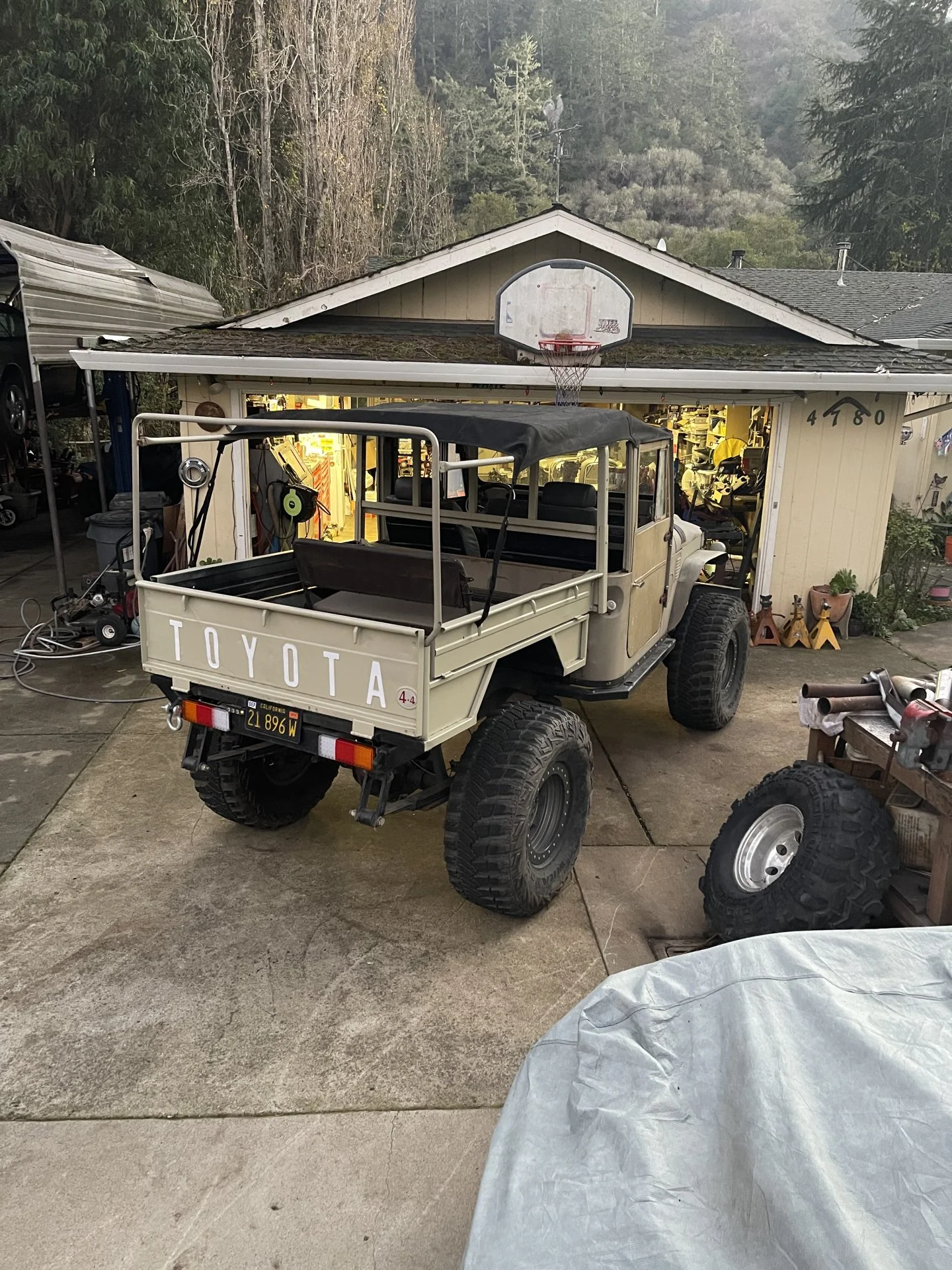

I am a soft top junkie,so the rig is getting some safari outback treatment. Sourced some bows and doors, after a few hours of tinkering, things are coming together. The bimini top I have had for years, its for a 40, but works ok!

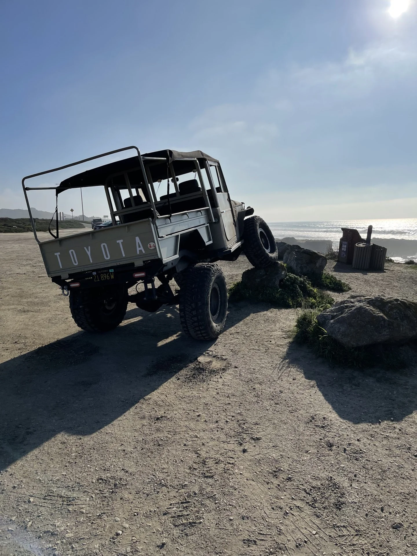

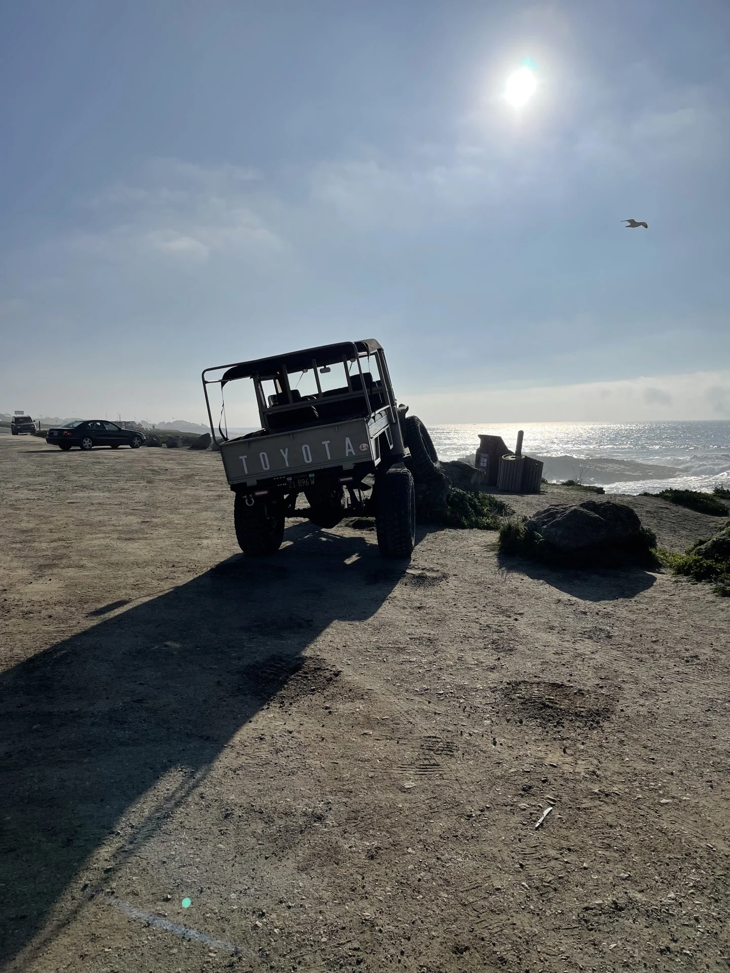

Just got back from a Rubicon trip! Rig was unstoppable, my 14 year old ended up driving most of it including lil sluice!!We drove up 4 hours to icehouse, camped 3 nights at different spots, and then out tahoe side and drive home! The worst part was 100 degree temps in sacramento in an open air hot landcruiser!! Cant wait for the next adventure!
I'm jealous of your time on the Rubicon! The truck looks great on the trail. Cool to see your boy taking the wheel. Is he interested in helping with the mechanicals of the truck? If he wasn't before, he probably is now after getting all that seat time!

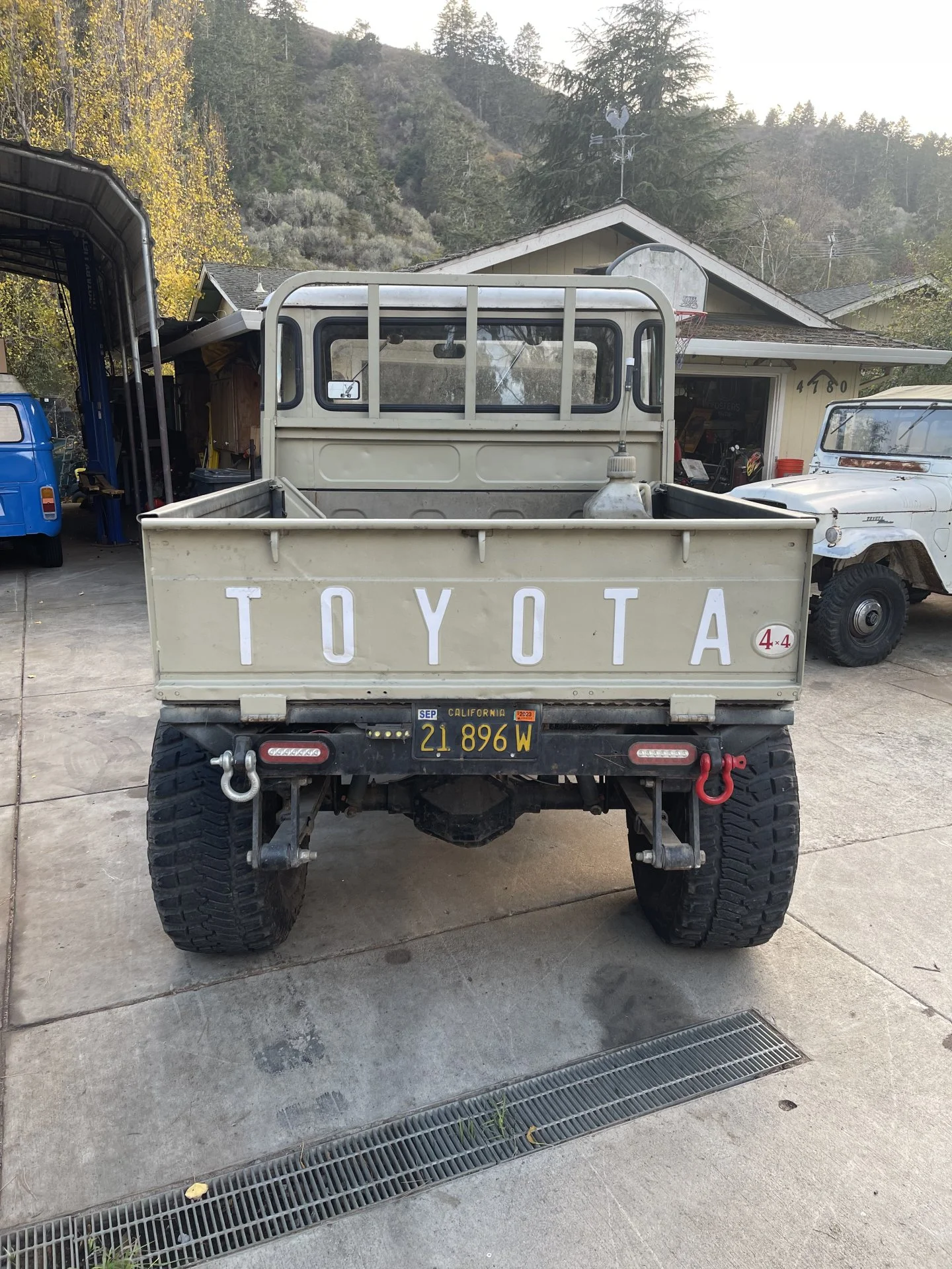

Didnt have time to make it removable so I welded it back on, literally took me 20 minutes and glad I did! It has plenty of rock rash! Im afaid Im not going to able to drive anymore, my kid just took to it like he has been wheelin forever( well he has been driving since he was 9 on the property)

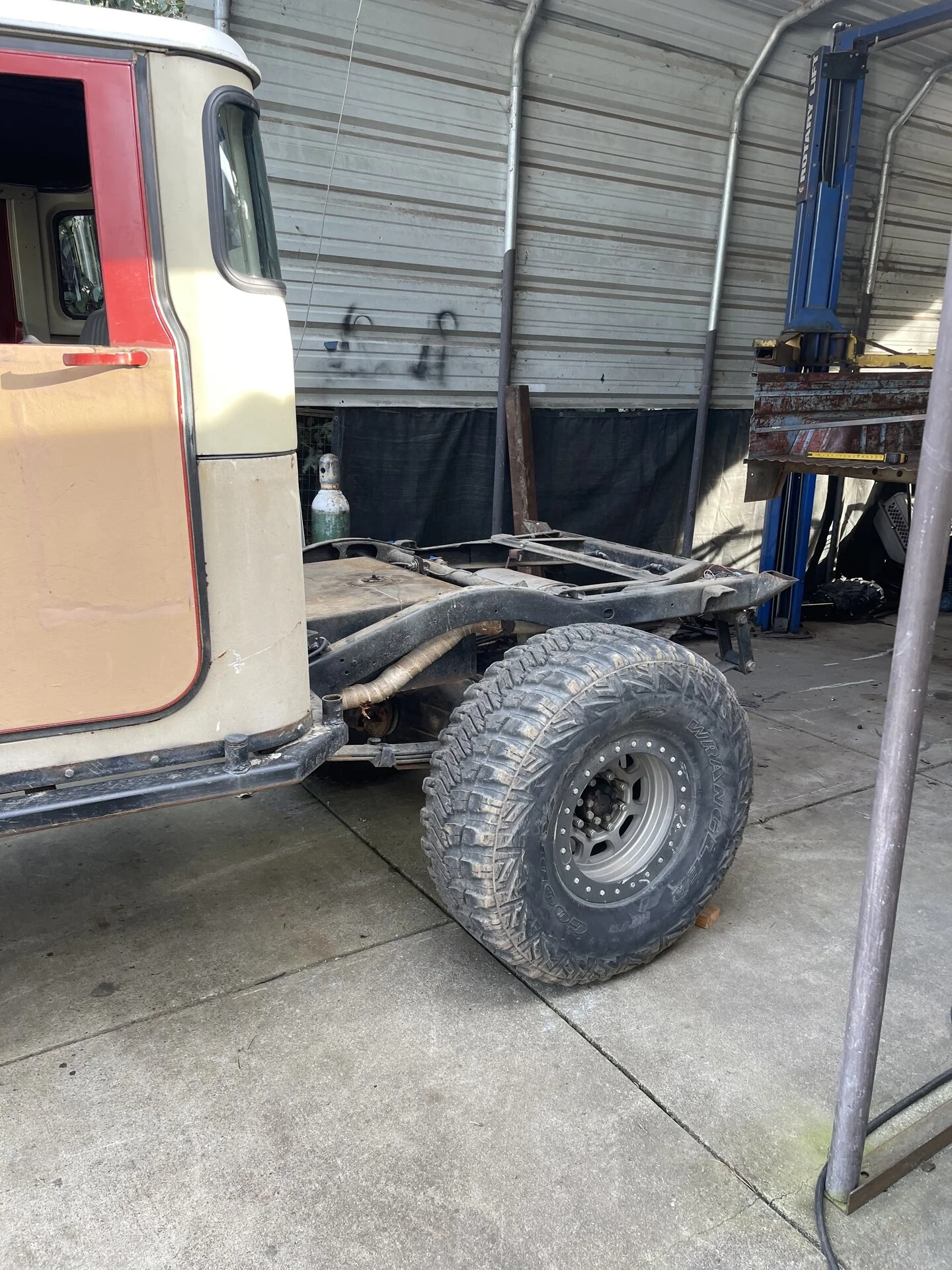

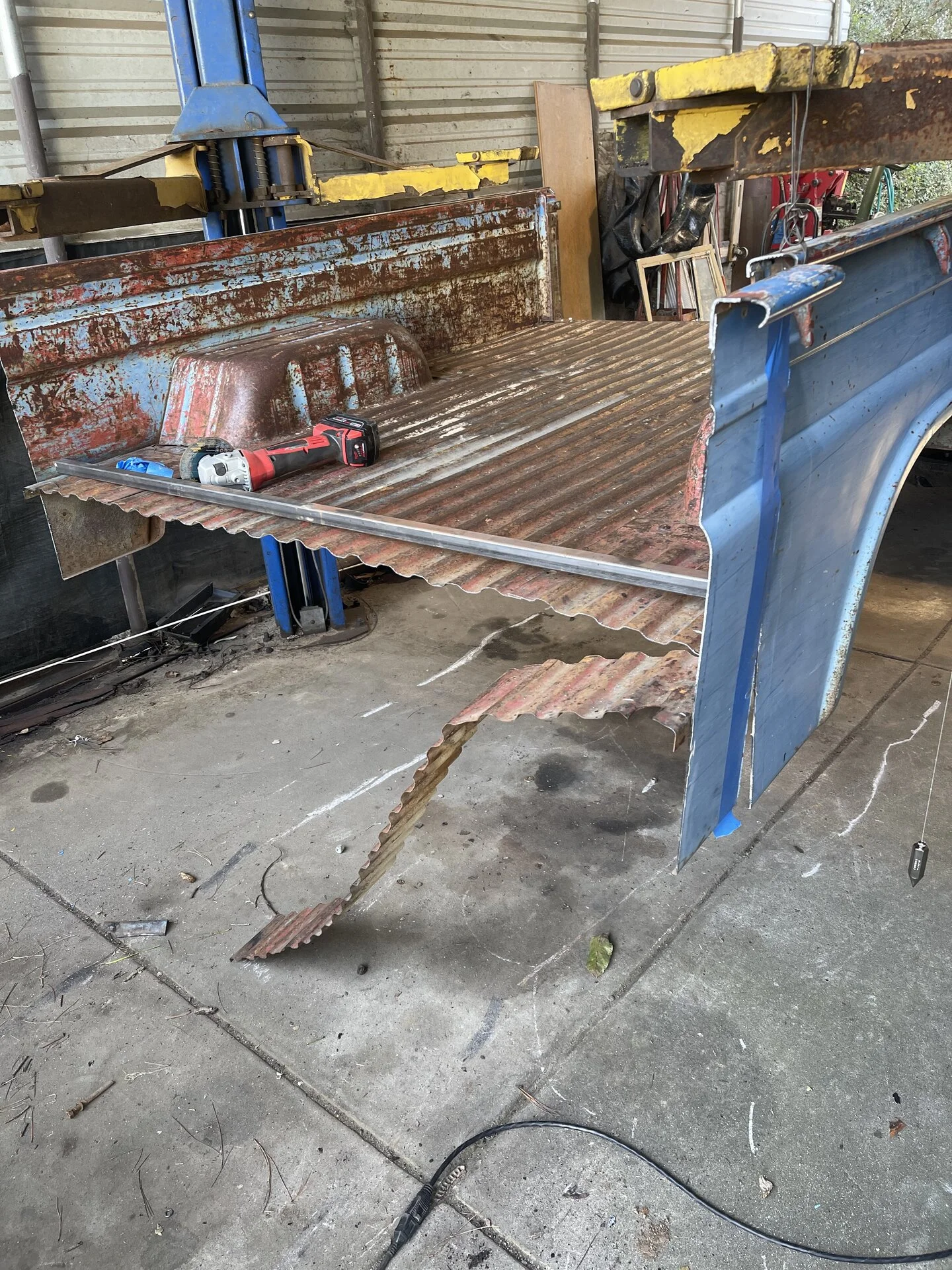

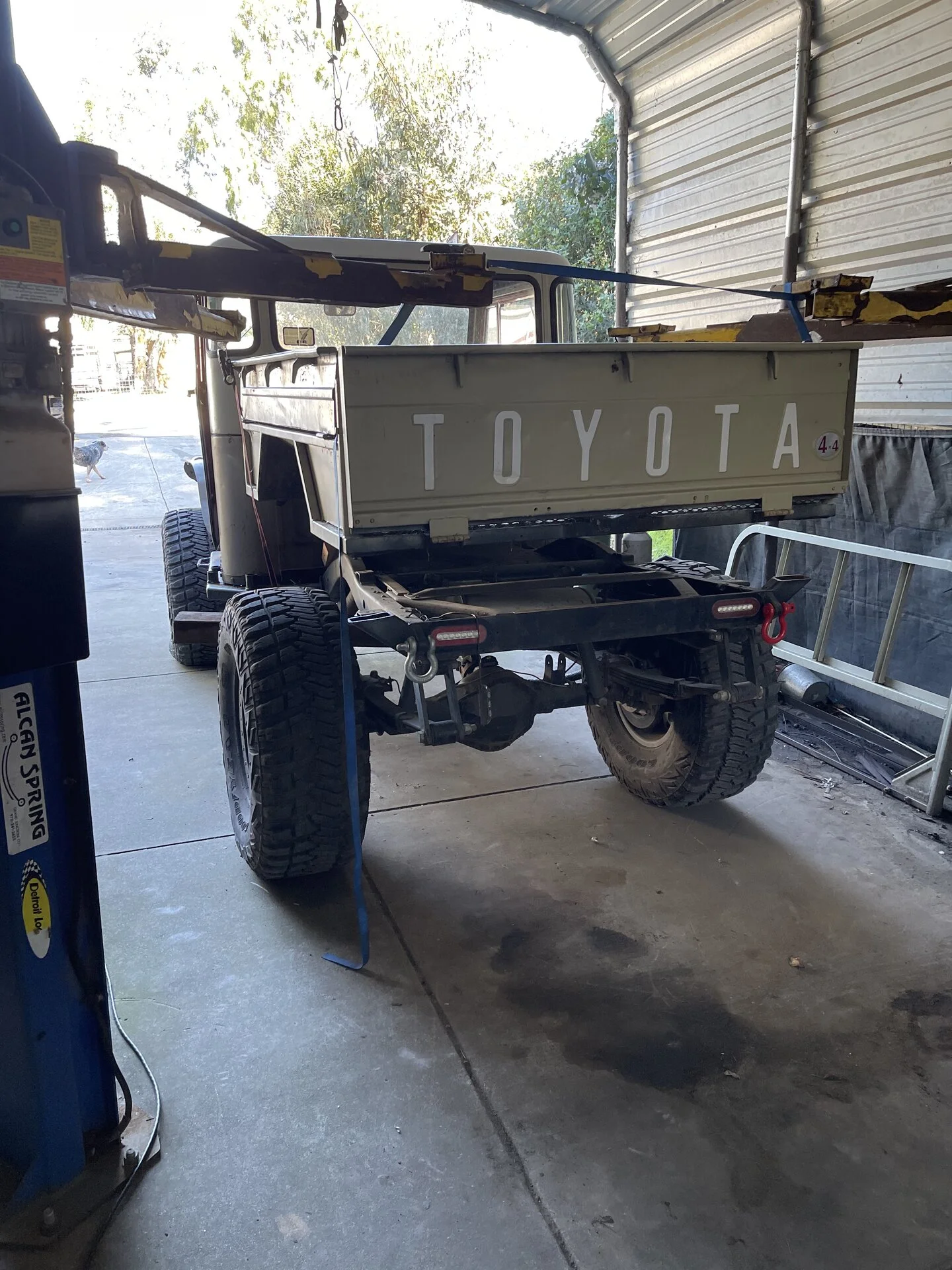

More changes!! Sourced an oem bed, been wanting one since buying, as I just love the look of an lpb. Wheelbase is 112 so a little shorter than a stock 45 lpb(116) So out came the sawzall and cut off wheel!! Ended up taking 6” off the front to align the wheelbase. Also helps with overhang as this is still going to be a rock crawler! A few hours under the knife today!
