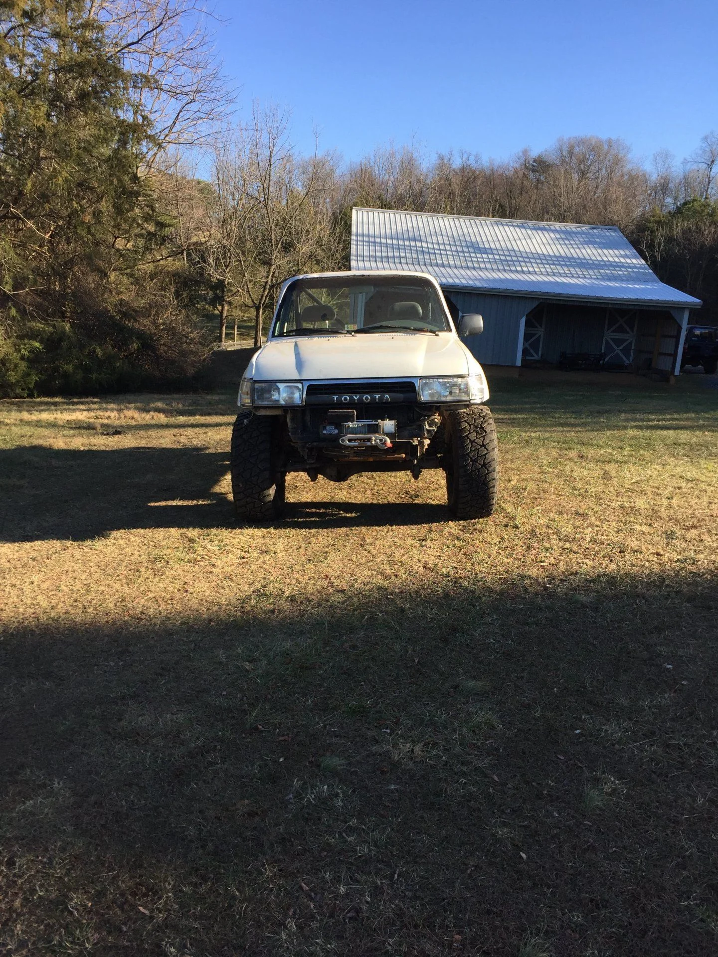

I guess I never posted a "finished picture of the front end. Trimmed and pieced it all back together so I could go wheeling.
I've still got to finish it up with a bumper.
I'm probably going full "ute" with this thing in the future. Stay tuned for more s***ty fabwork!

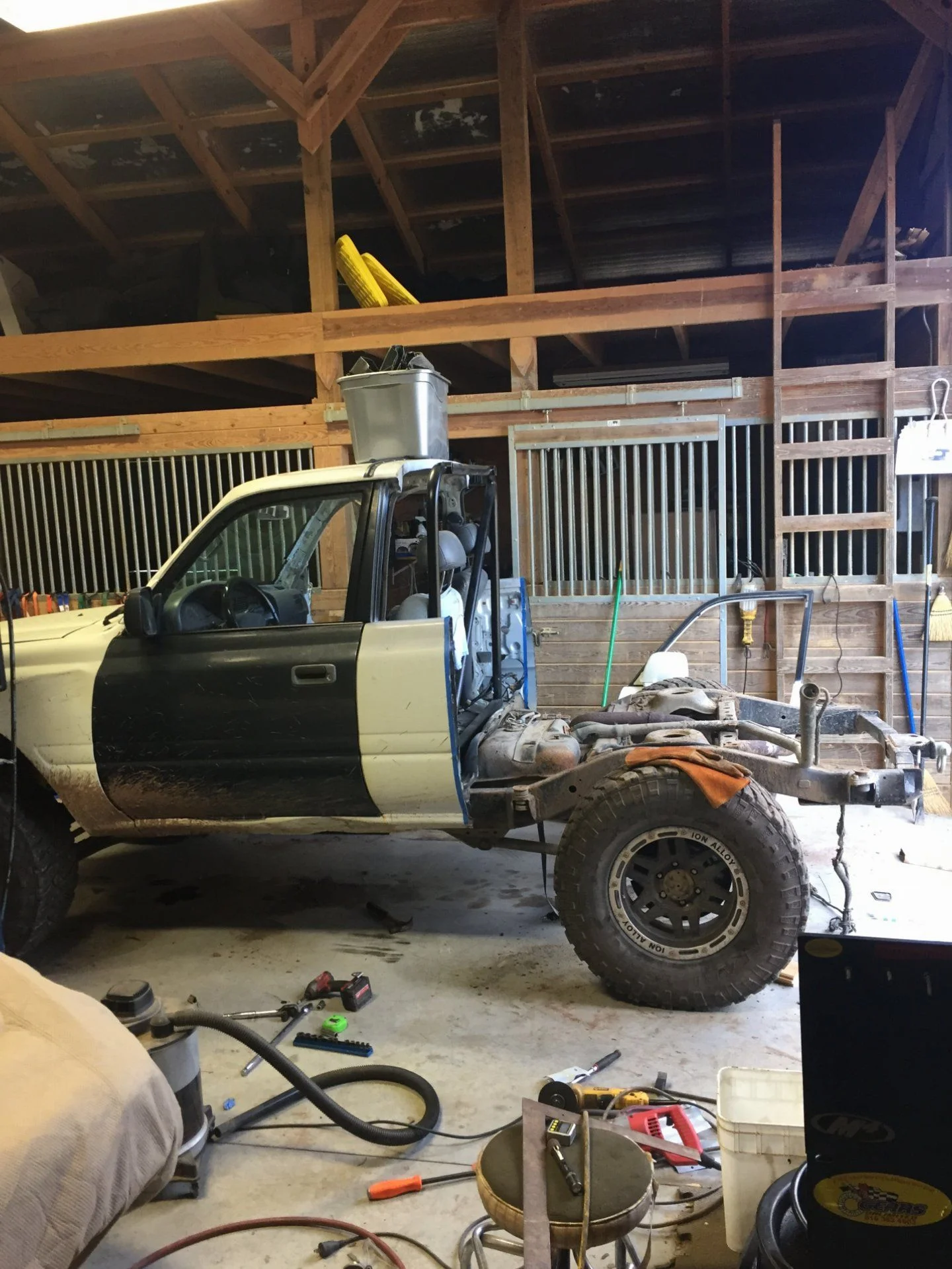

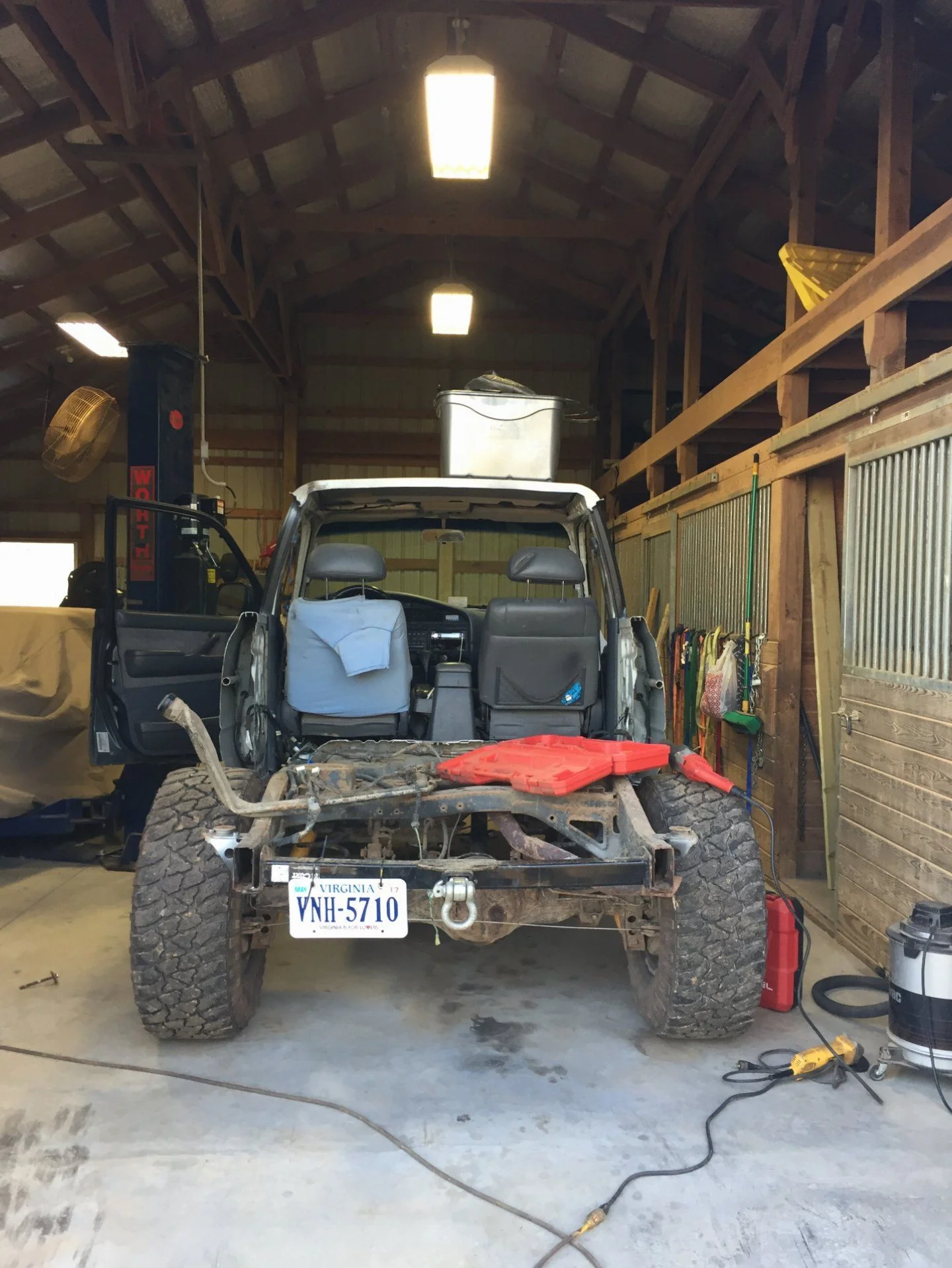

Dat door tho...
Looks good, right? I had a four hour round trip on the highway and a day of wheeling and it was ~30*F outside. I had to settle for one full door so I didn't die. Still had a half door on the passenger side and no back. It was a long trip.

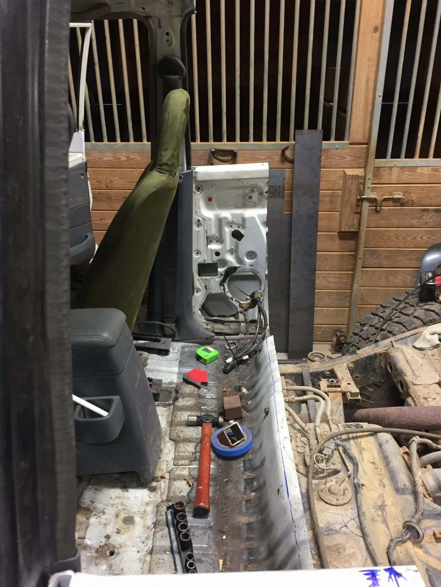

Somehow a full door fits perfectly on the drivers side. The windshield fits. But the passenger door is off by about 3 inches.... I've got a good body sitting in the field so I'm going to cut the top off it and weld it onto the Trash. I need to be able to run full doors for winter time beater duty.
What color is the spare body?
Same color as the door. I guess I could replace all the white sheet metal with the navy blue stuff. But I already have so much effort and care into the chopped white fenders. And I'd lose my stickers on the passenger side fender.... :(

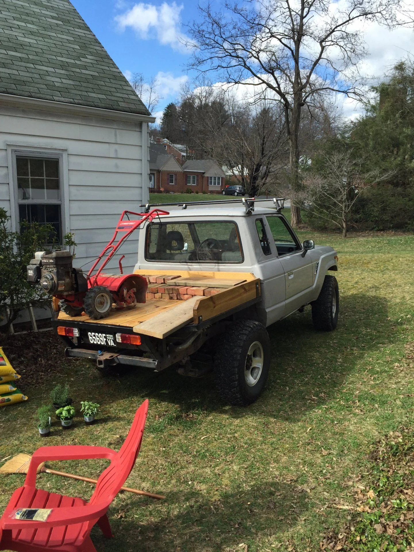

I vote lumber flatbed :o
I vote lumber flatbed :eek:
I'm still trying to decide. I did that on a 60 I built and it was fine, but it was pretty high in the air. I think this one would have to be even higher.

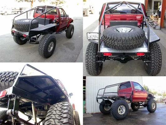

I was thinking something more like the Allpro bed.
Any ideas or input would be great.

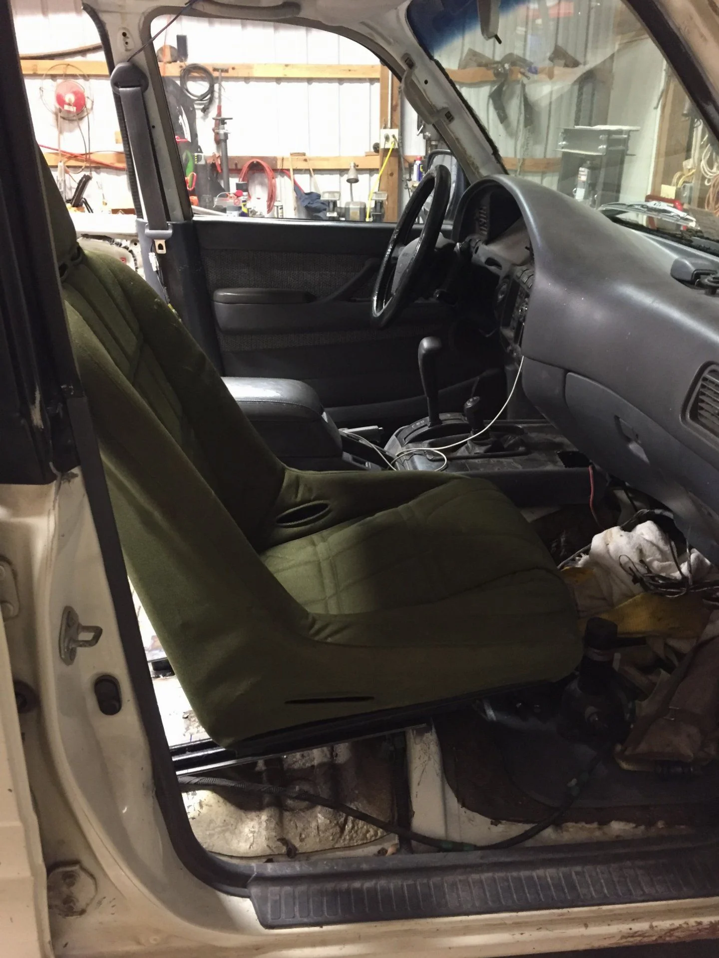

Picked up these seats. Pretty comfy and very light. Came with sliders too. I was going to adapt some '91 manual seat rails to my leather seats but this looked easier. And it will give me more room if I want to shorten the cab up.
Anyone interested in some manual seat rails shoot me a PM.
These photos were taken with the seat slid all the way forward. I'm 6'3" and with the seat slid all the way back I can't reach the firewall with my feet and it still fits within the confines of the "cab".
Nice seats -- look like the PRP I just bought.
I forgot to take a pic of our ute project from above and reply to your questions about what to do for a bed. If you look down from above on the exposed frame, basically right behind the rear axle, that space is open (previously was space for the spare) to do whatever you want. Depending on how much you bob the back for your rear departure angle, I would put a lower deck there or weld in a storage box there low as you can, basically between the frame rails.
The "upper section" above the fuel tank and axle can be a spot for your spare.
