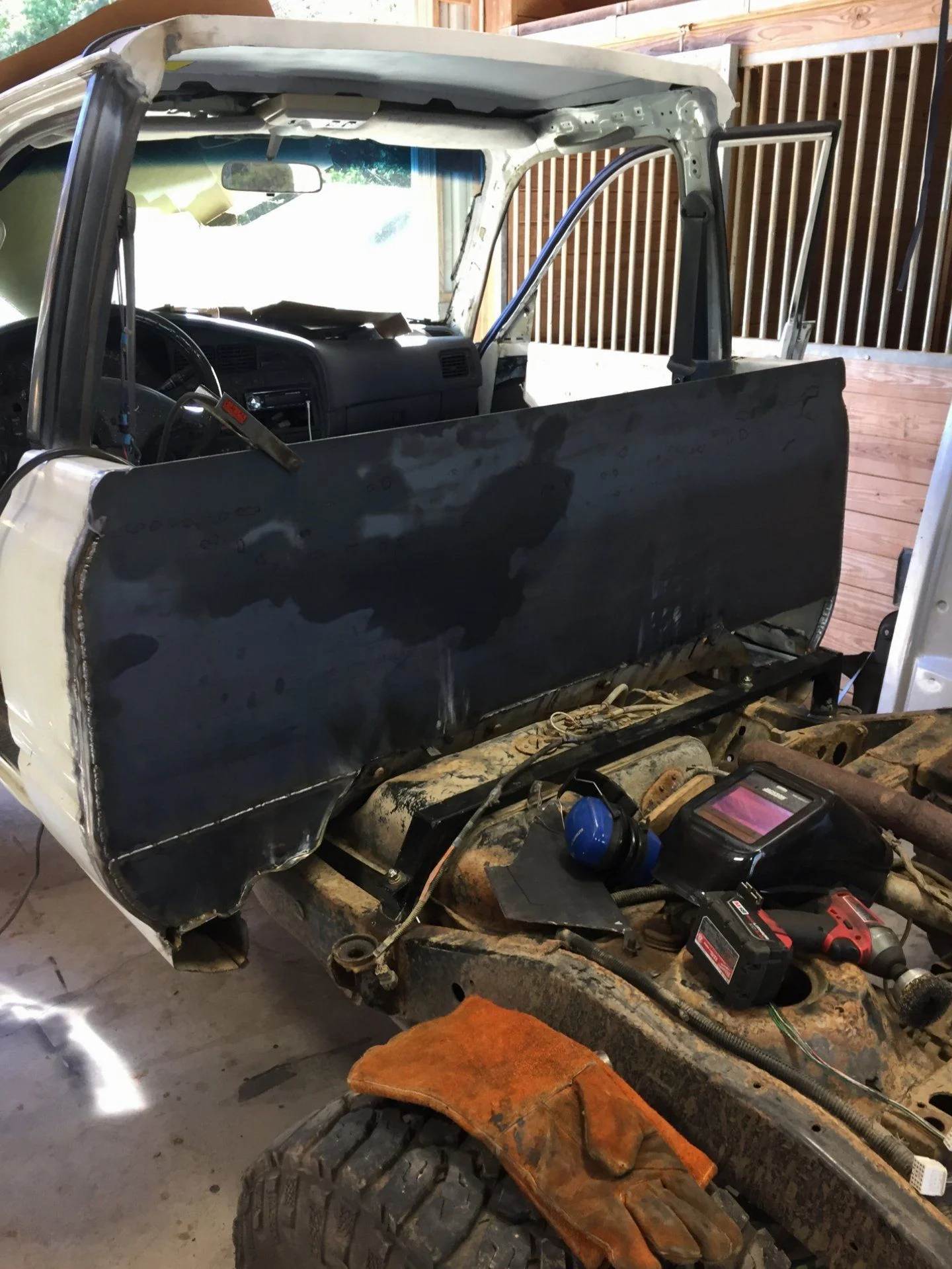

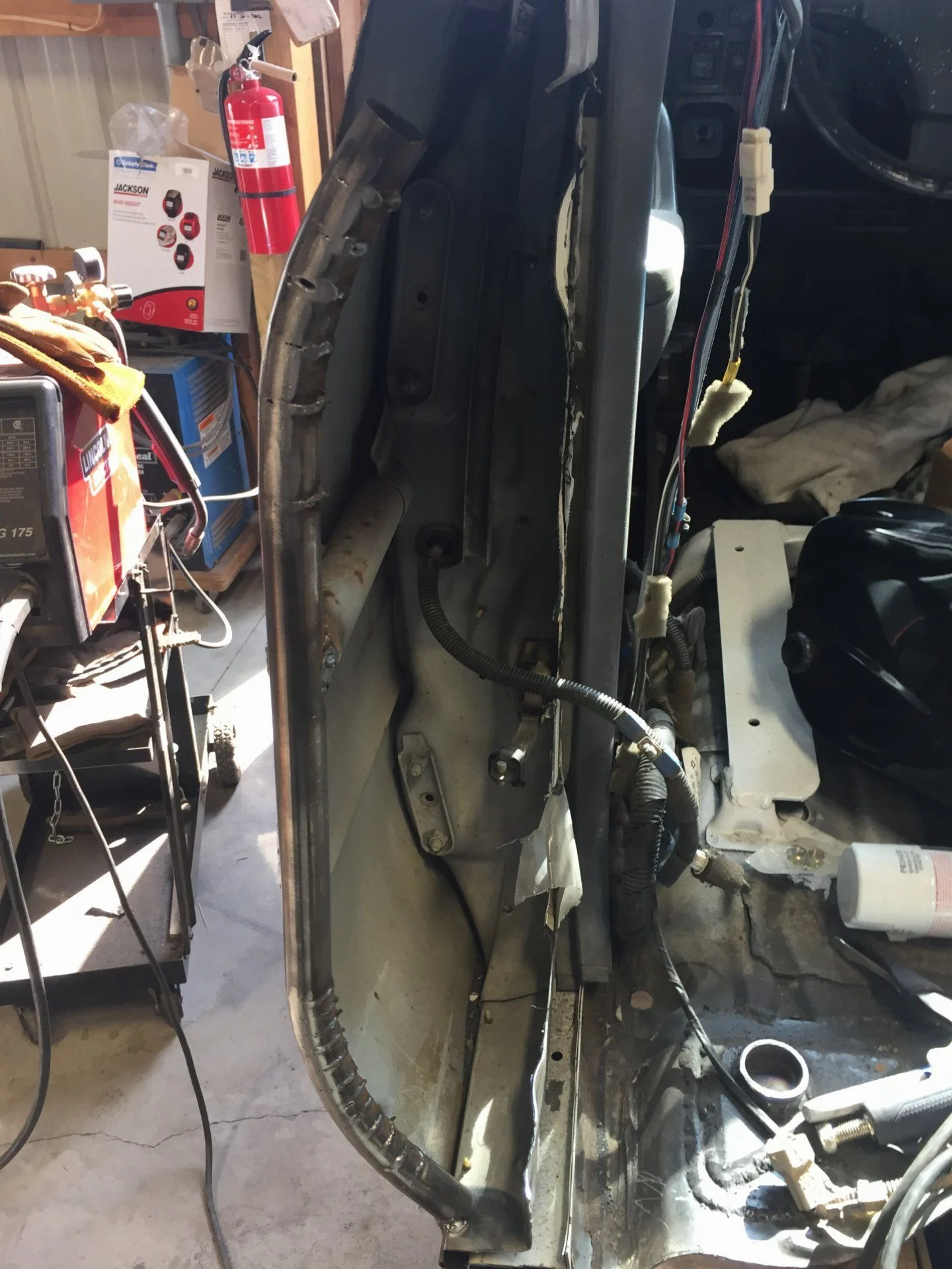

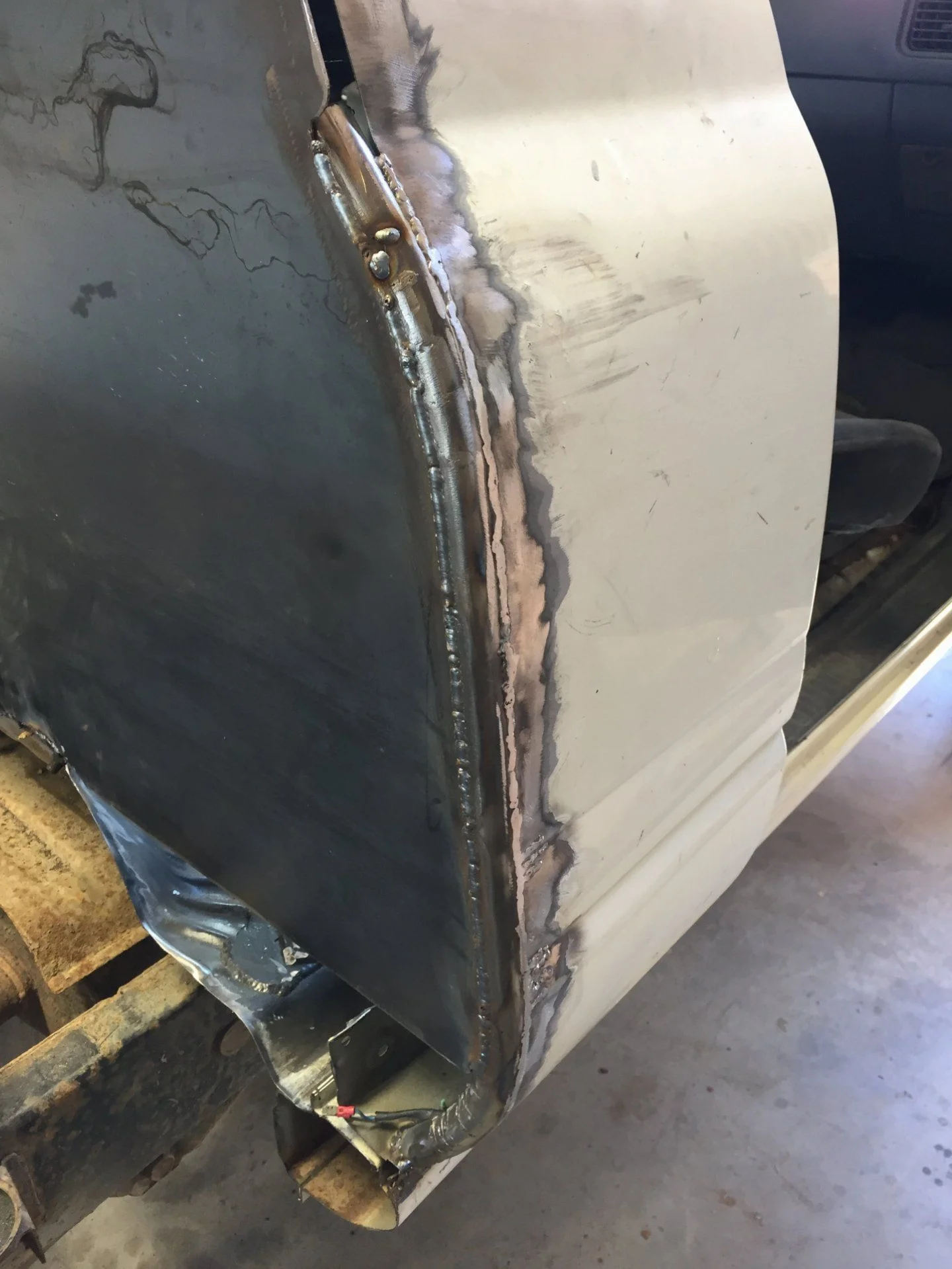

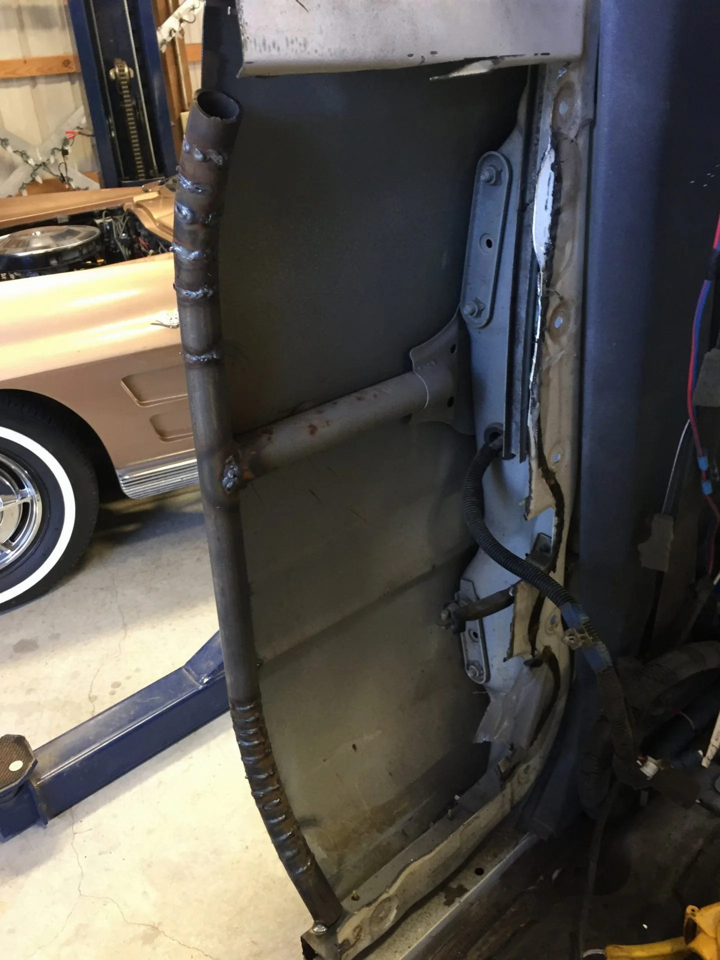

Got some 1" thin wall tube to bend around the body lines and make a nice round "corner" where the back panel is going to meet the body. Welded the original crash bars to the new tube to add some rigidity - it was pretty floppy.

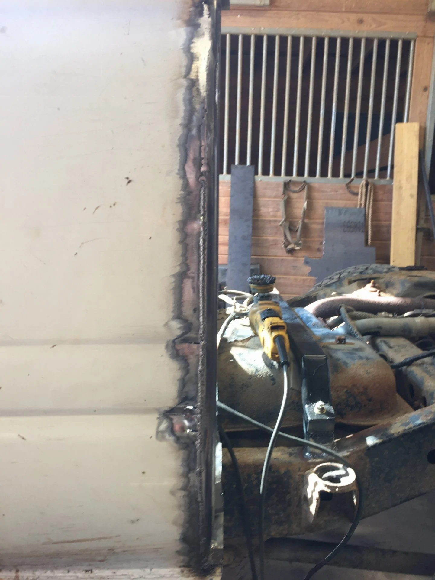

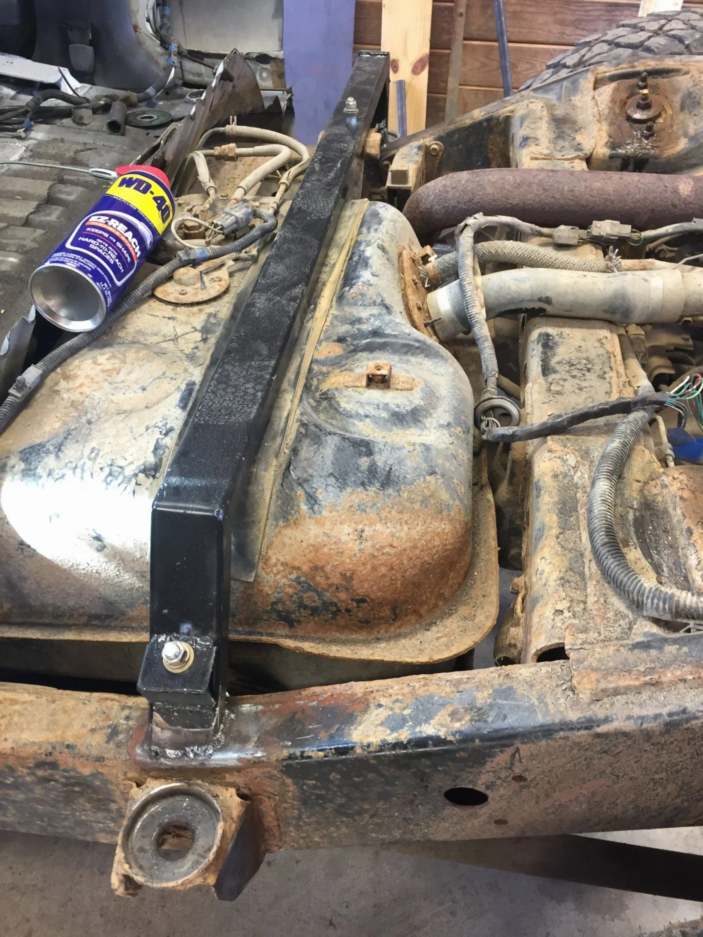

Depending on how much you remove you have to add a fuel tank support back in. 1x2 11ga tube and some booger welds took care of that.
I have been struggling with how I was going to do my corners on the upper section, cant decide if I do this, or bend some 14 gauge with a similar radius, then cut/shrink to get the profile I want. This looks much easier to accomplish and you can look at it and adapt it easy before you tack on the sheet good. The standing back and looking is important!
How are you going to box and seal in the front side of the door?
Doing the corners this way was super easy. I made a cardboard pattern and just kept slicing/bending until it fit then welded it all back together. It was waaaaay easier than trying to use sheet metal like I did on the 60. I can't really speak to what will give a better finished look, though.
For the front of the door I'll probably just use some sheet metal and lots of seam sealer**.

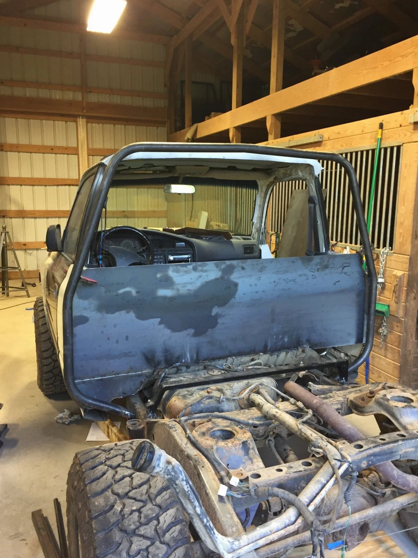

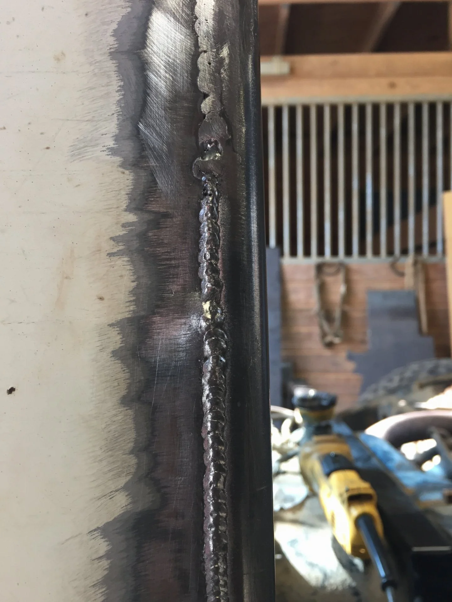

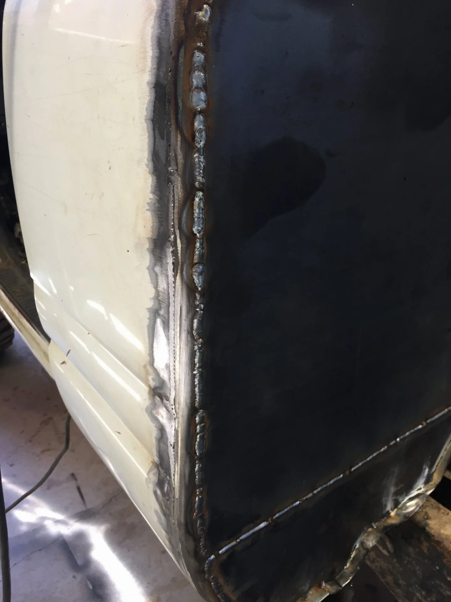

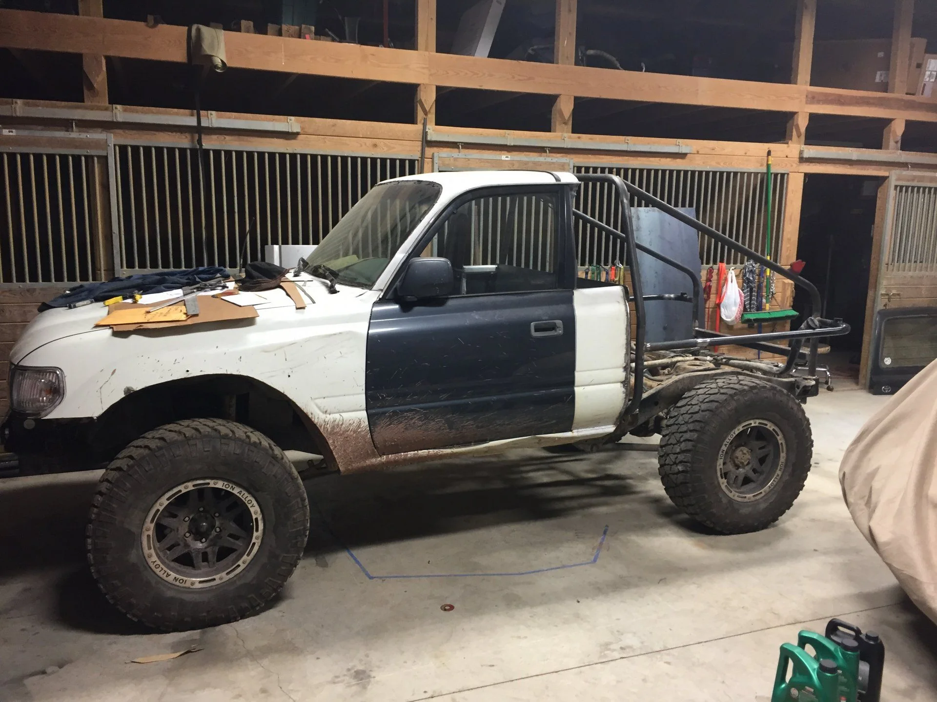

I got the bent corner tube welded into the other side and the lower rear panel partly welded on.

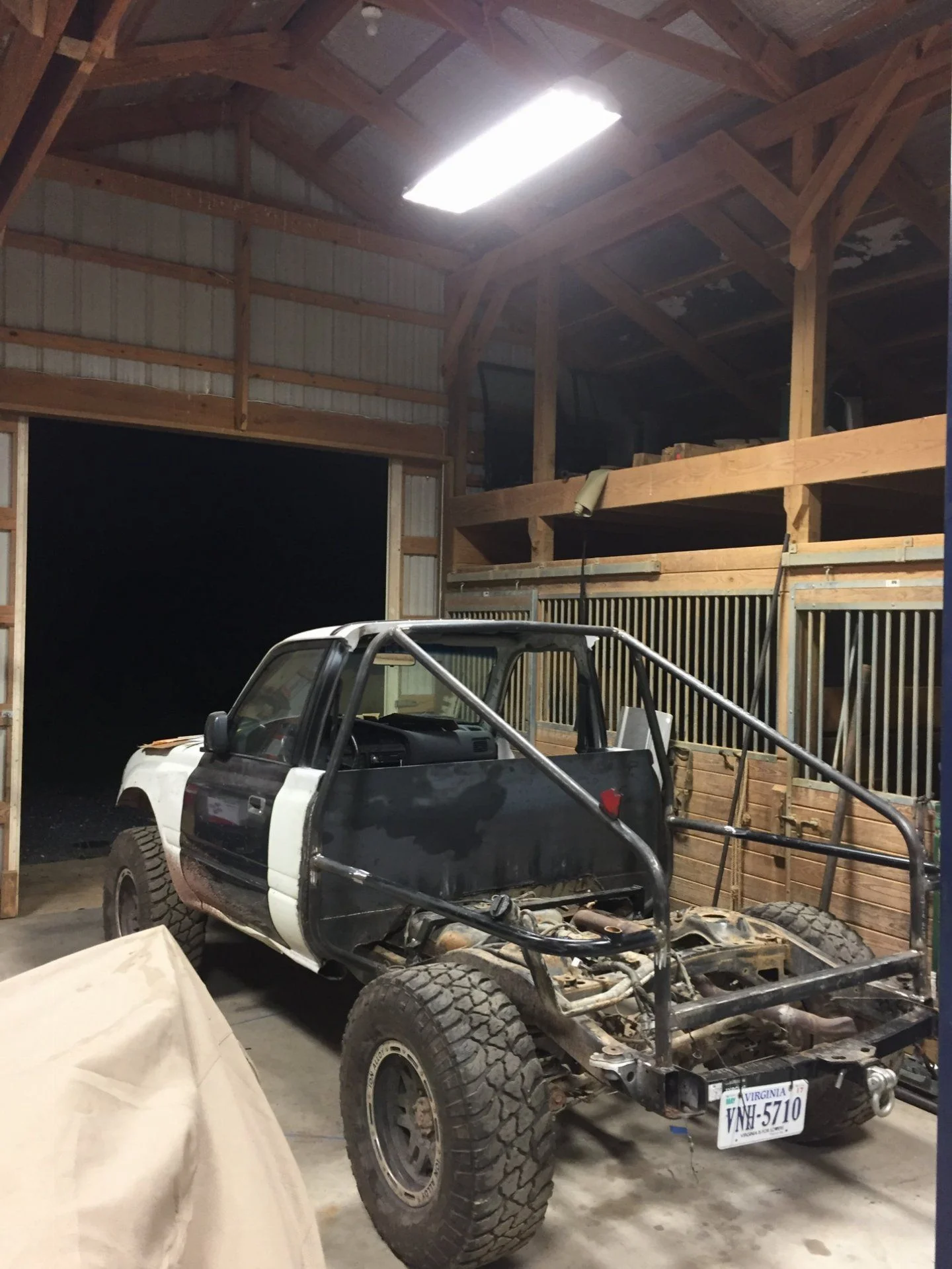

I need to add a framework to stiffen up the rear panel and "finish" up that part of the cab. Then I need to start on the bed to get a little roll over protection.

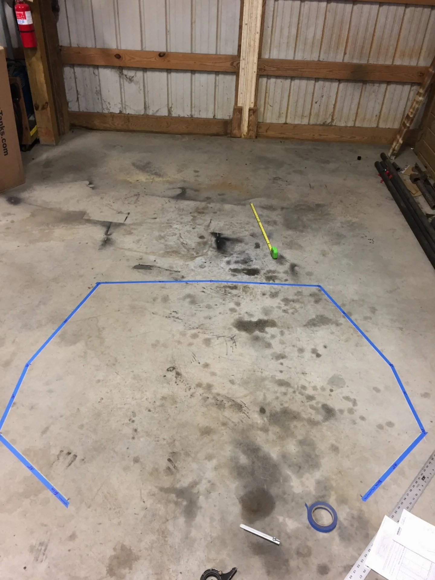

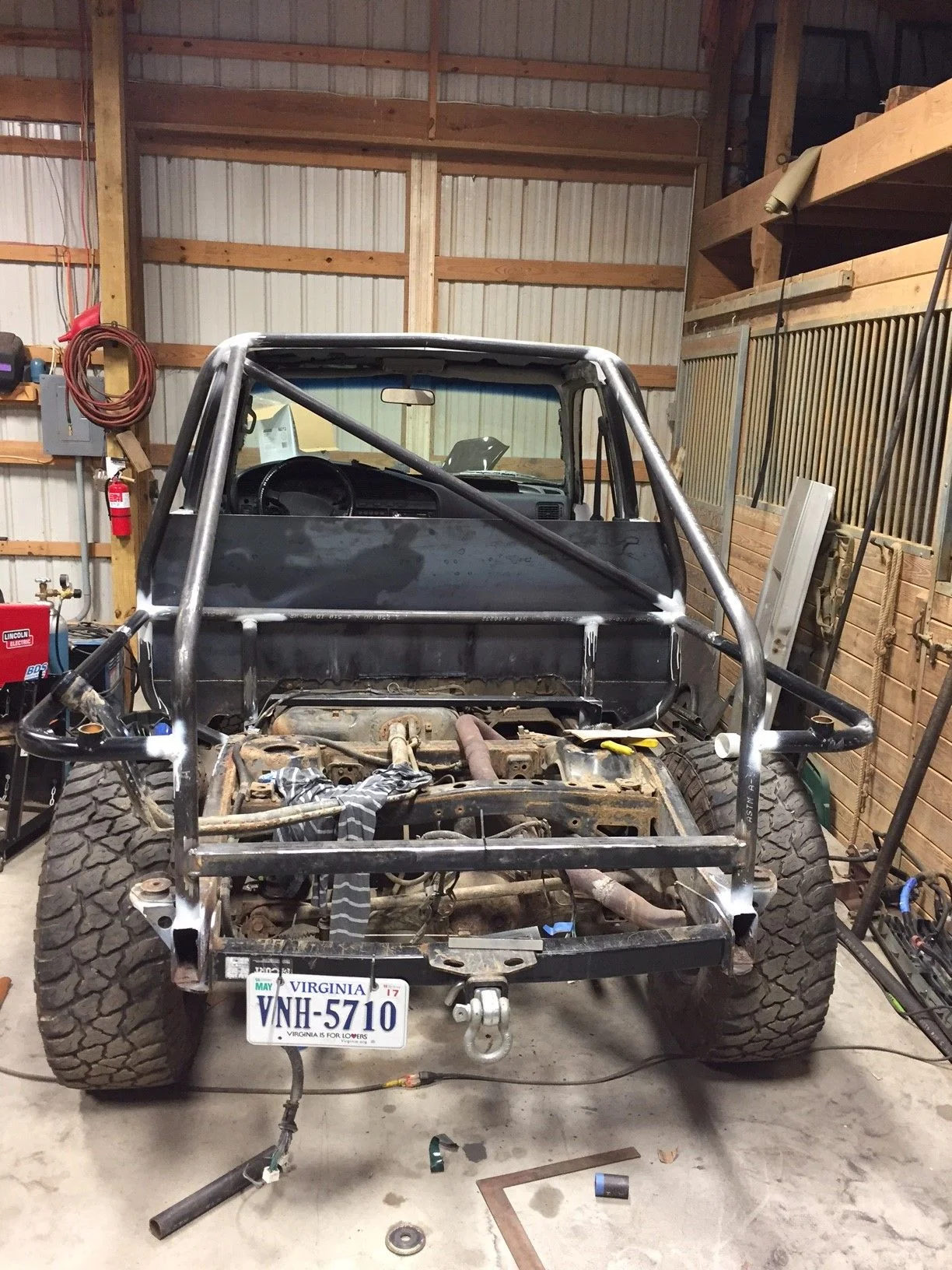

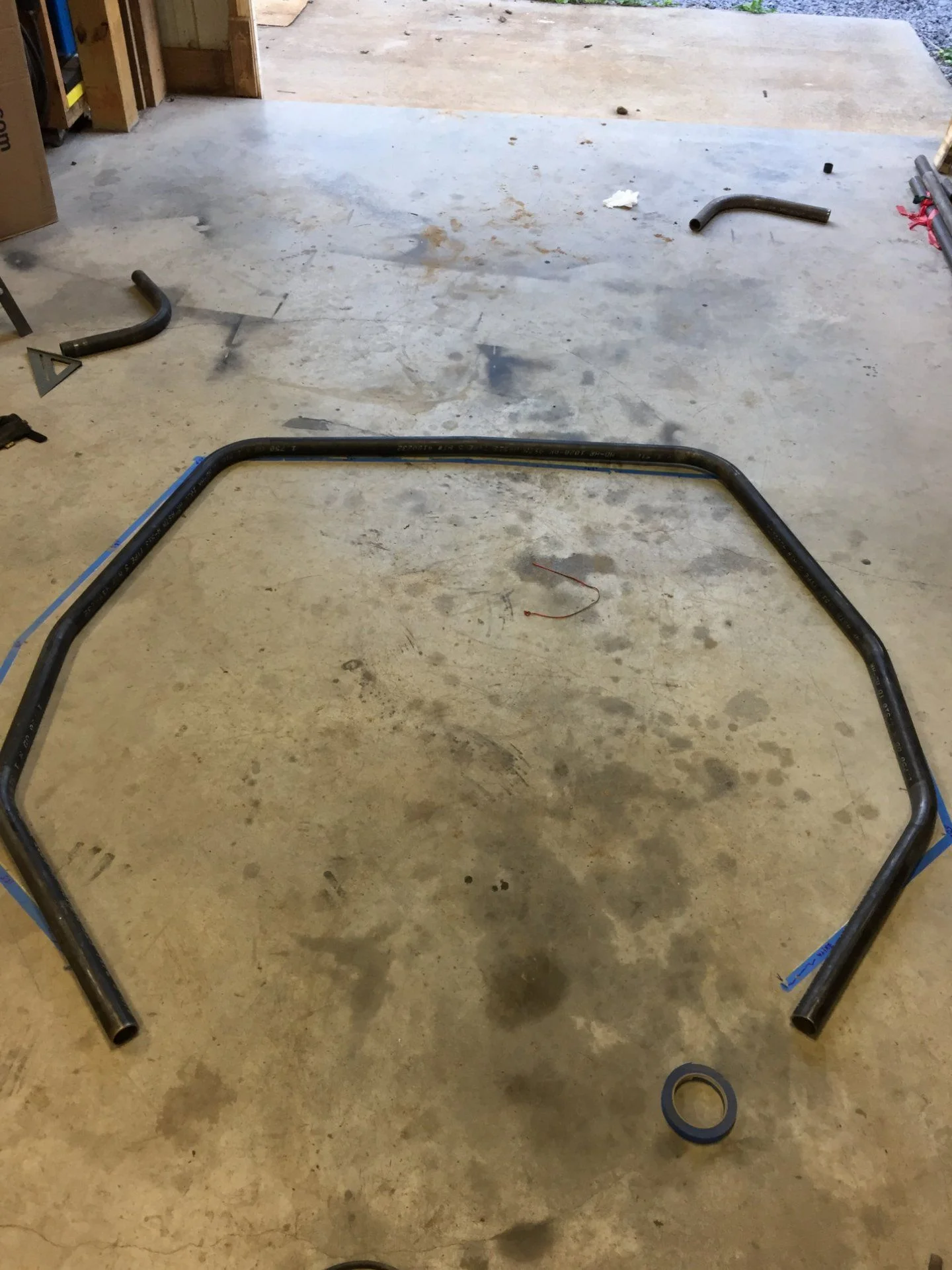

So this took forever. Probably 12 hours in this main hoop. I don't bend enough tube to remember how I did it. Every time I bend a piece I have to relearn how to lay everything out and set the bender.
Never mind that it looks like it doesn't match the layoUt.
Super pleased with the end result. I had to adjust some things and it came out a little unsymmetrical, but for my first complex bend I think it turned out fine.
And pics to prove progress. Gotta say I'm very pleased with how it's turning out. Usually I have an idea in my head and the end result never looks the way I pictured, but in this case It's all going to plan.
I've got a wheeling event next weekend so I'm in a bit of a time crunch. I work much better under pressure.
