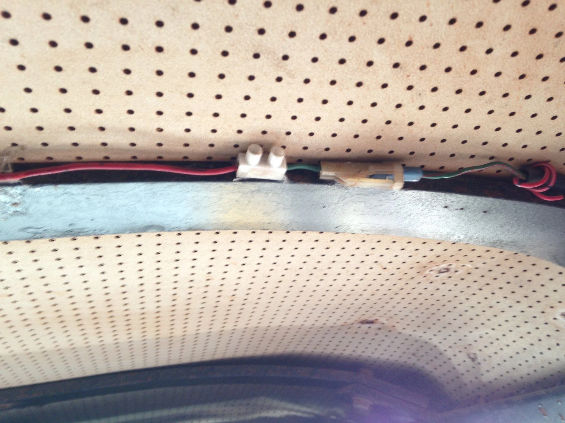

When I first bought my truck I wanted to take it down to @FJ40Jim, so he could give it a once over. It was the only one I had ever driven and wanted to make sure everything sounded the way it was supposed to. One of the first things he found is pictured below.
We took it for drive and when he put his foot on the gas peddle he was like “what the hell”. I never notice but he sure did. He said he didn’t think you could even get full throttle with it cut like this.
