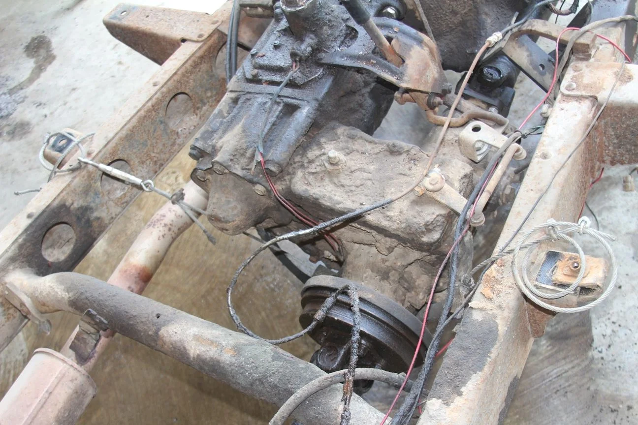

A little bit of steel cable with a tensioner should hold the tranny and transfer case in place just fine. . .
You can see where it was wrapped around the frame to body mounts before the body was removed.
:eek::eek::eek:
What to do with an engine swap and minimal bell housing mounts?

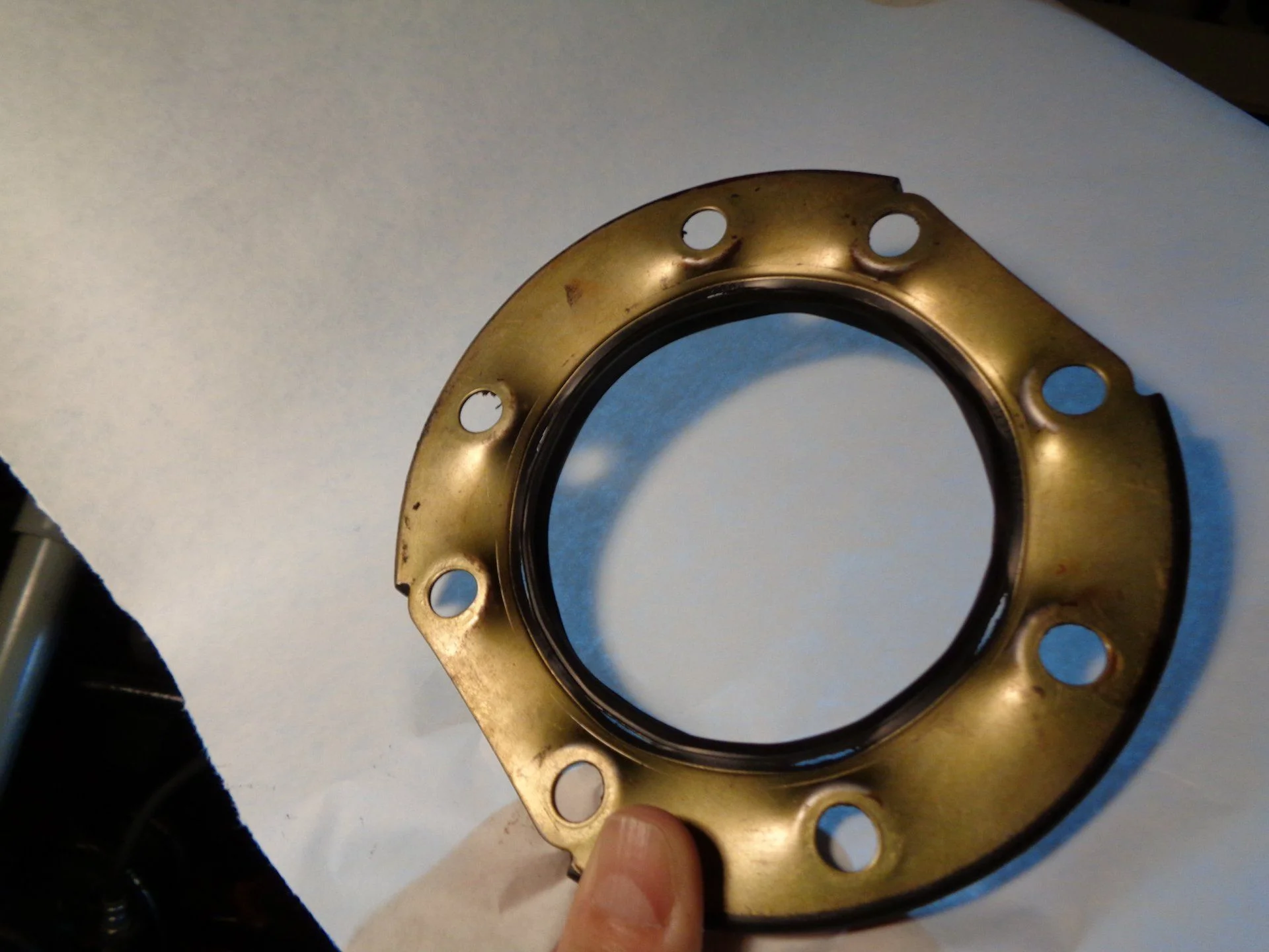

Front knuckle dust seals bolted in place with the caliper dust shields left off.
The metal around each bolt had to stretch to make up the 3mm difference, tearing the rubber seals near each bolt.

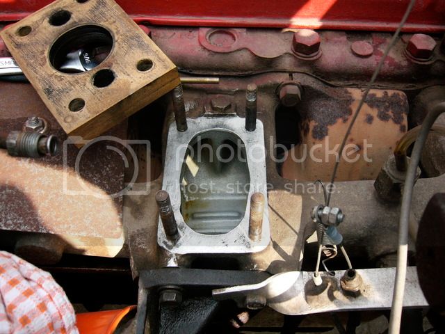

My old 67 had a wood carb insulator... Wow
