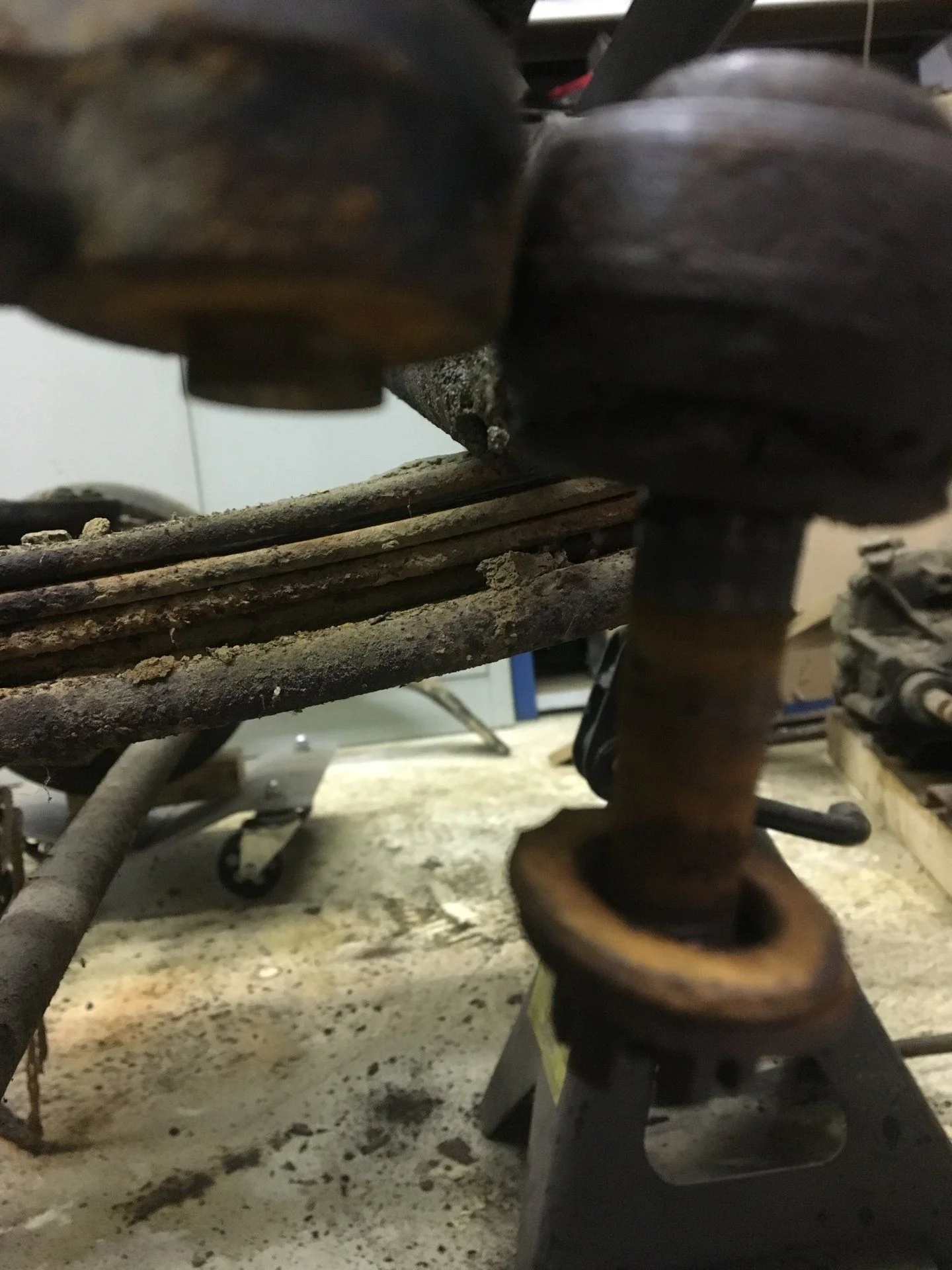

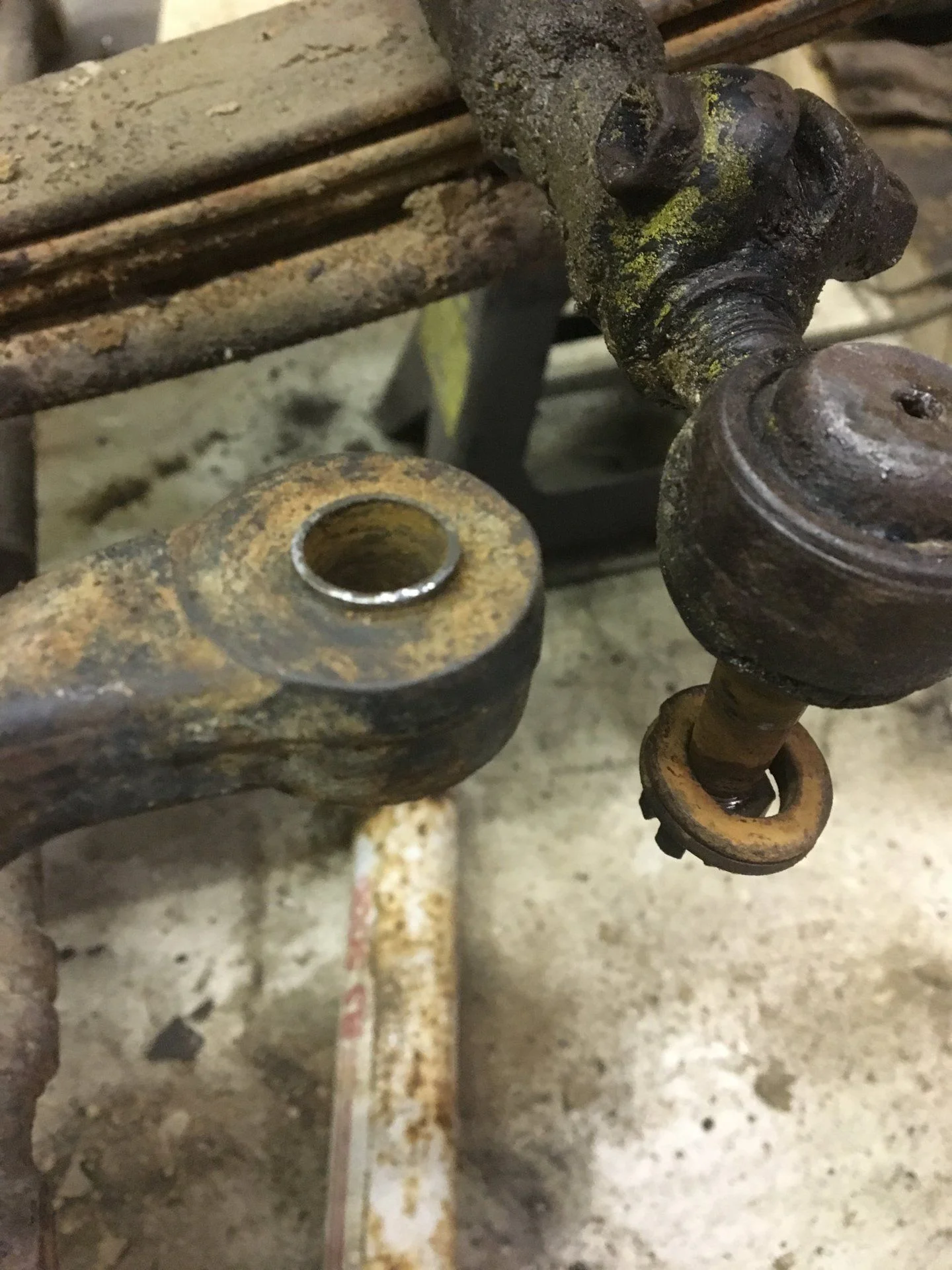

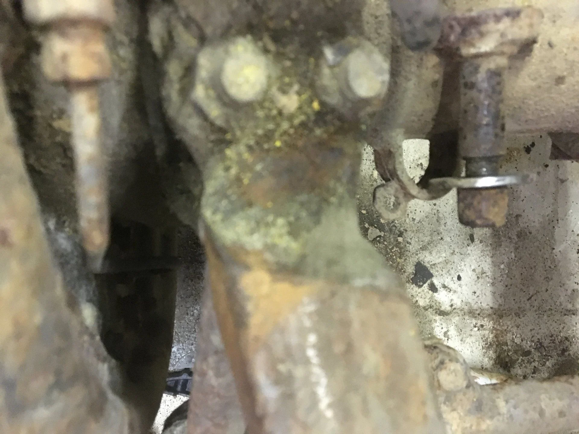

Isn’t this what everyone does when converting to large pattern steering knuckles (maybe without the washers)
The ID of the washers is almost the OD of the nut.
But none of that matters if the booger welds on the steering arm fail.

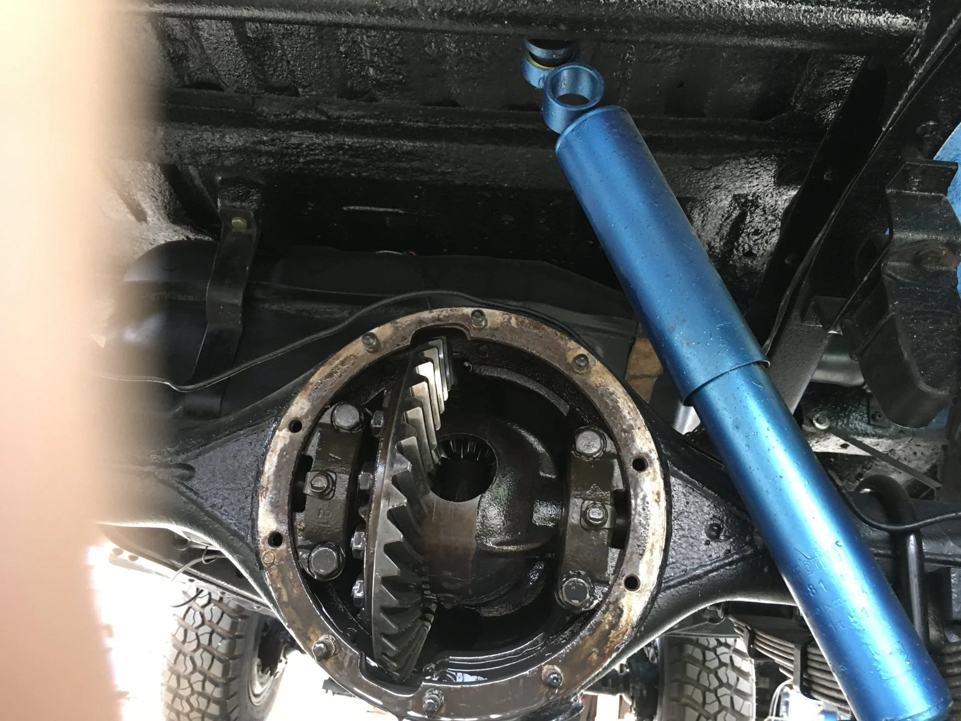

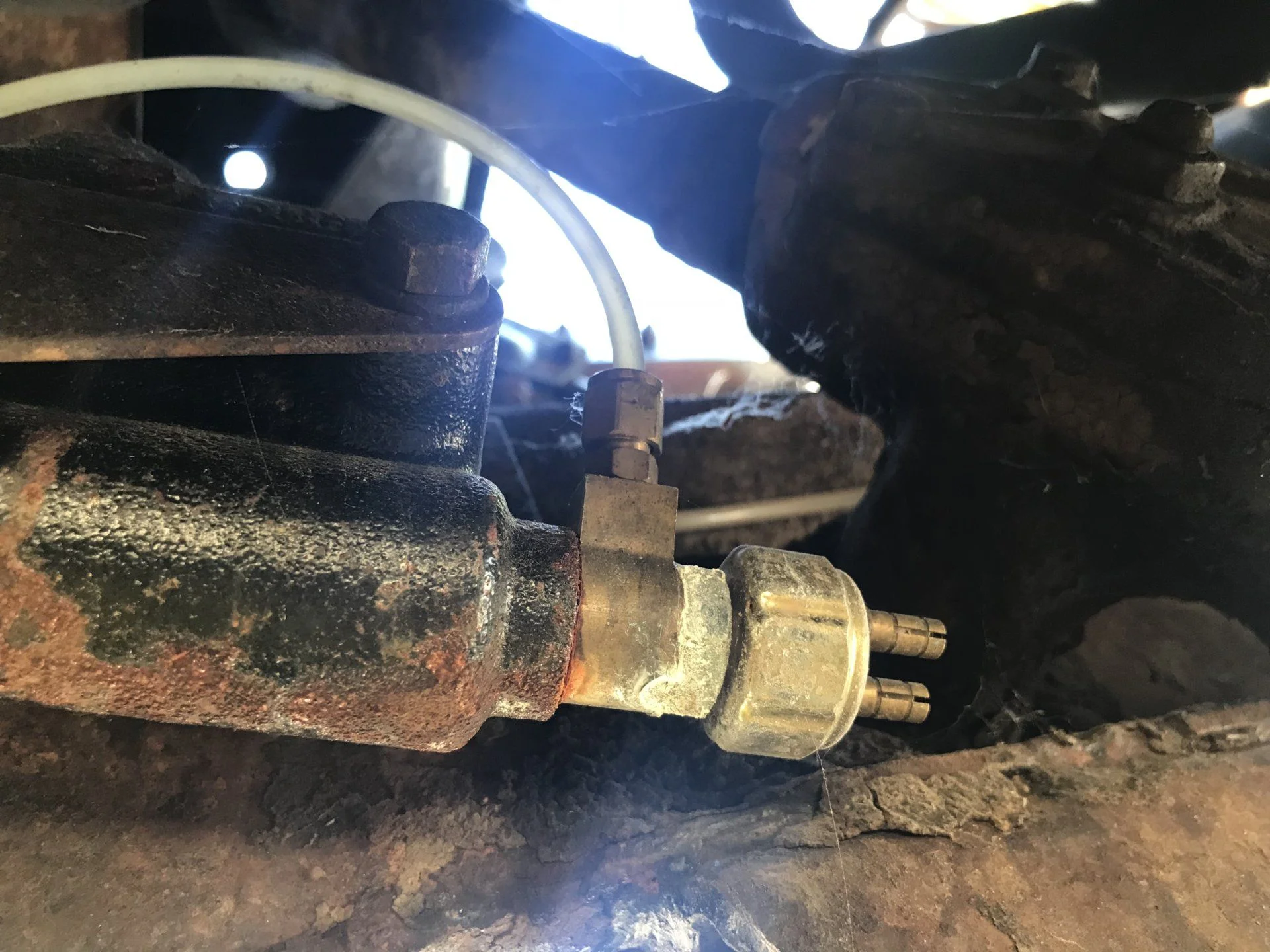

Same SA truck, now in the shop for axle overhauls. Got under the rear end first. SURPRISE! Custom shock extenders!
And yes, three of the cover studs had been replaced with 17mm head bolts. A fourth decided to jump ship when I unscrewed the 17mm nuts. :rolleyes:
Cover off, I fish around inside and pull out two pinion roller bearings! :eek:

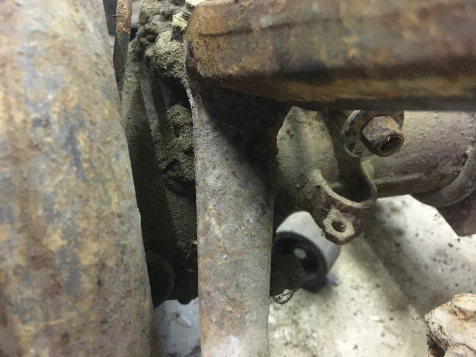

One wheel stud was already sheared off, so I only had to do 11,right? Except two of the 11 were not amenable to metric or SAE sockets. Not a special locknut, but I still ended up having to beat a socket on for those two.
Wheels off, oh great. Never seen a brake drum with neither a set screw hole or a weep hole for gear oil.

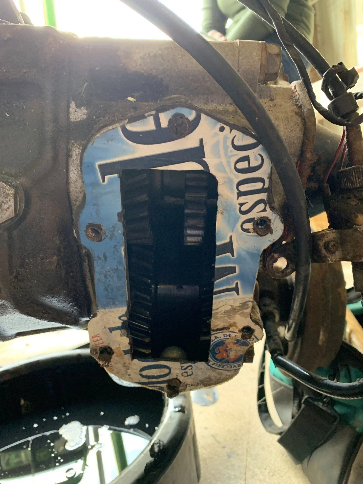

Wish I knew how to post video for what I found next!
