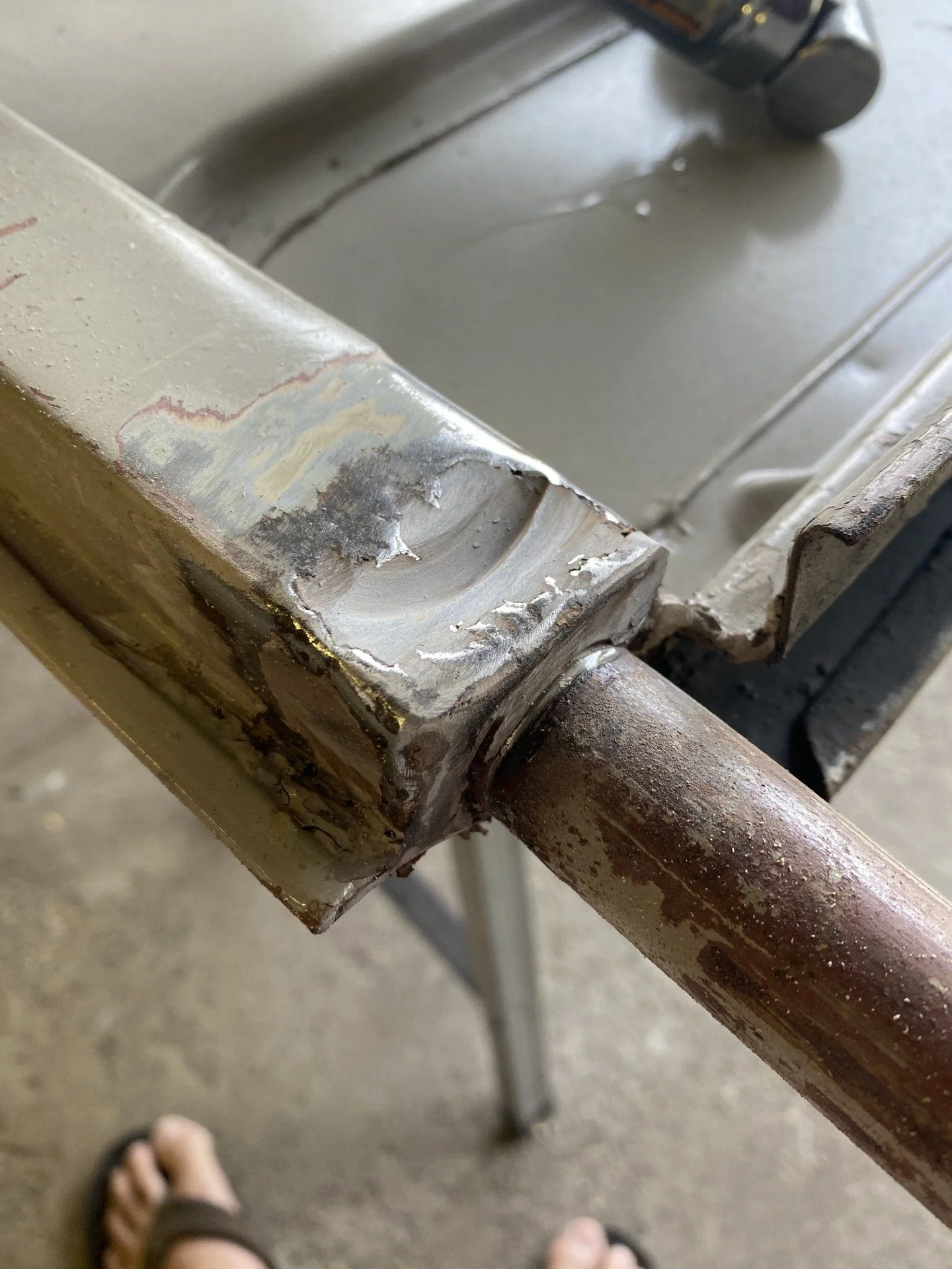

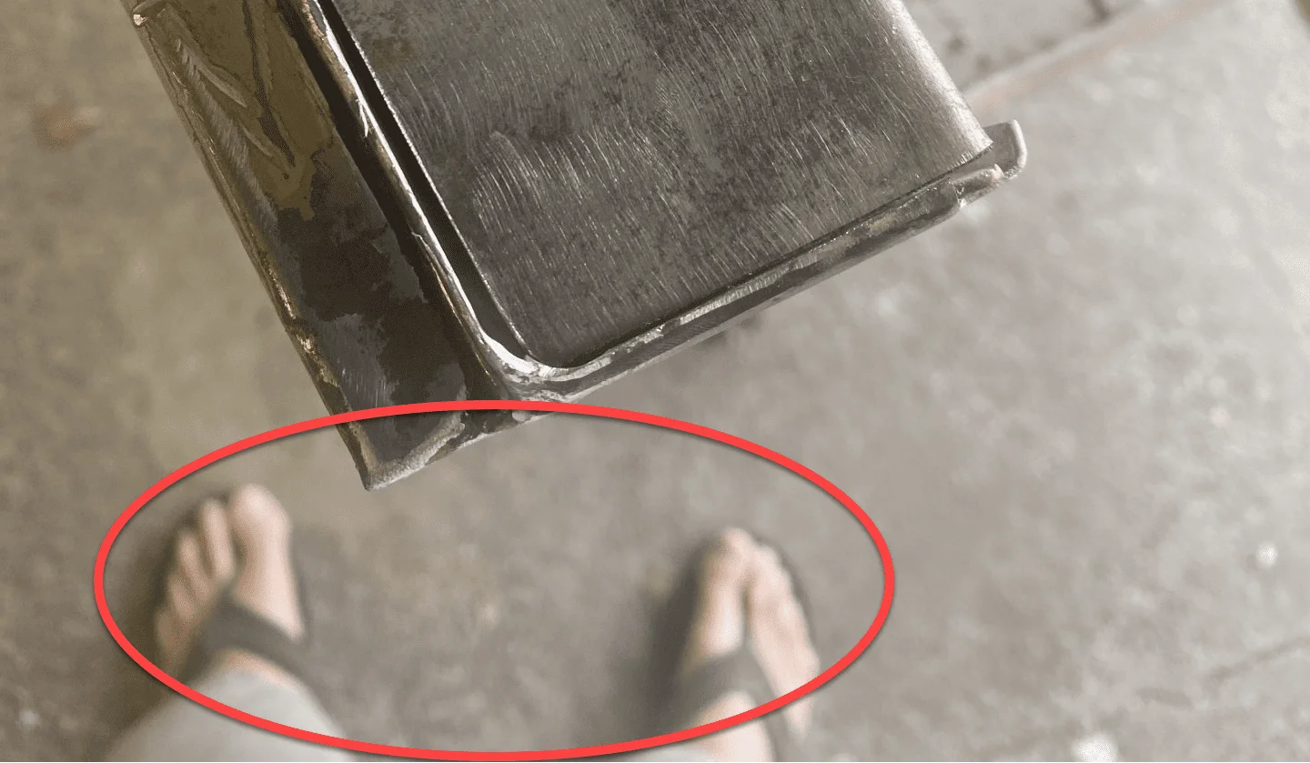

I always love OSHA-approved welding footwear. ;)
I was scarfing plate off a structural steel frame and had a piece of slag burn through canvas top work boots and land between two toes. Hurt like hell and took a long time to heal. I got the boot off FAST, but not fast enough! Yeah, it's funny until it's you :mad:
Bet sandals would have come off quicker 😜
In all seriousness I've had welding sparks cut through my sneakers and lodge in my socks. No fun.

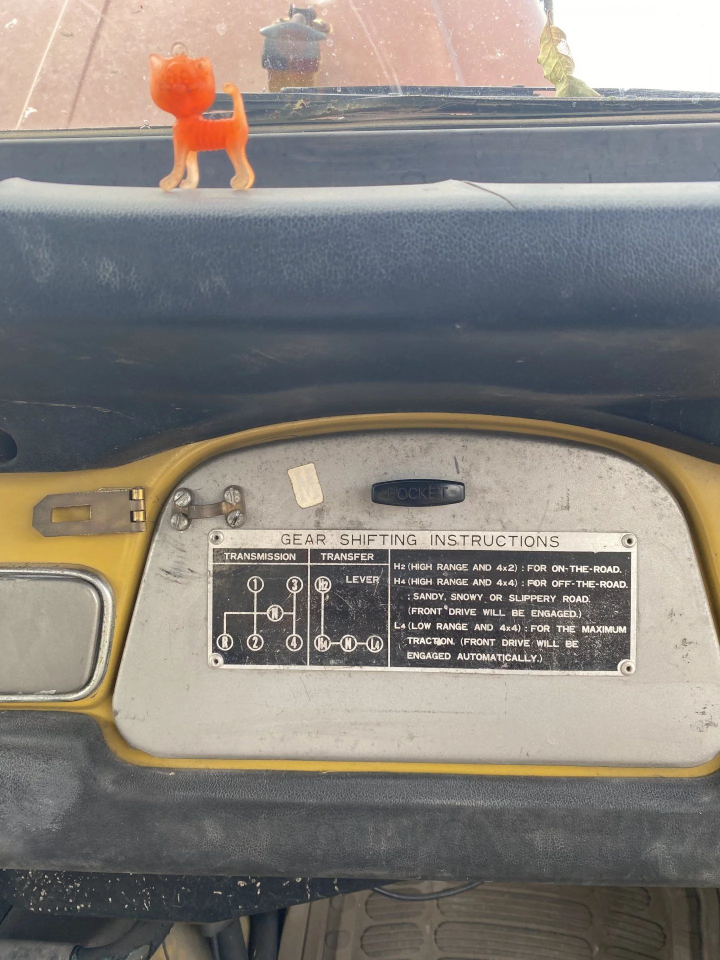

Locking glove compartment. Niiiiice.....View attachment 2443247
Should be thankful didn't cut a hole large enough for a lock. Had at least one of those. Screw holes are easier to fill. Down side it the dash has holesn as well. Any 40 series owner who has the sickness would just grab another glovebox door from their stash. Dash itself has to be repaired.:(

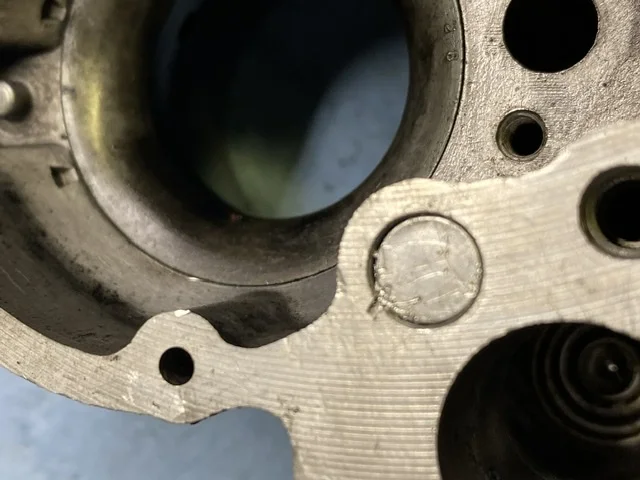

PO used a stamp of some sort to hold down the plunger for the accelrator pump. Anyone got any ideas to get that out? Ive already tried a dental pick to try and pry it out.
I use an exacto knife to clean the edge, and a 1/8” drill bit on a slow setting down the middle of the stopper. The whole operation usually takes less than a minute. :meh:
